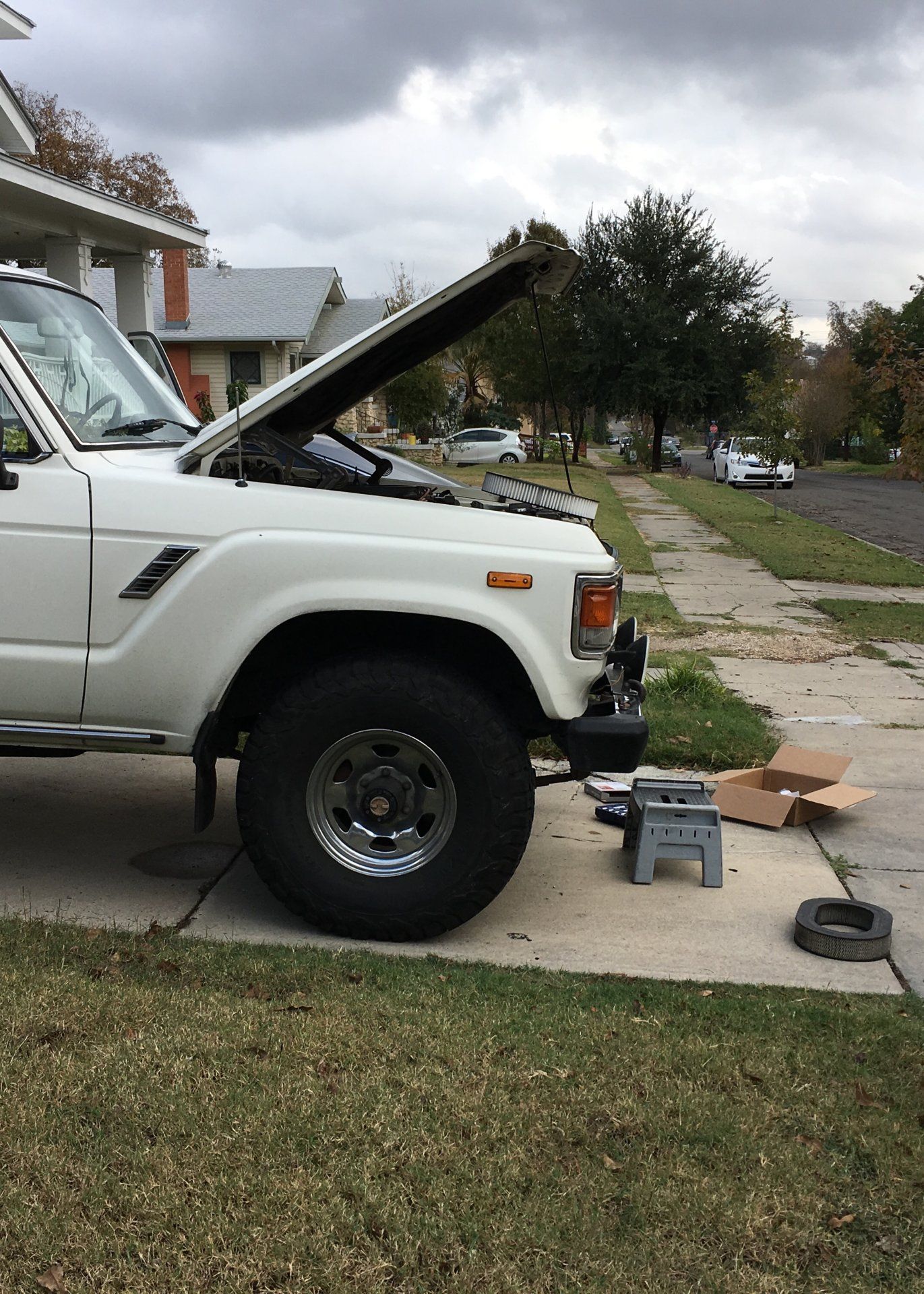

Also had some goodies waiting for me when I got back from Cruiser Corps. Toyota air filter, hood prop grommet, hood bumper stops, carb-to-air cleaner gasket, and and new speedo cable. Will be doing research tonight on how to install the new cable. Any pointers are welcome. I also have a new horn contact that I’ve been holding on to for a while that needs to be put in. One step at a time!

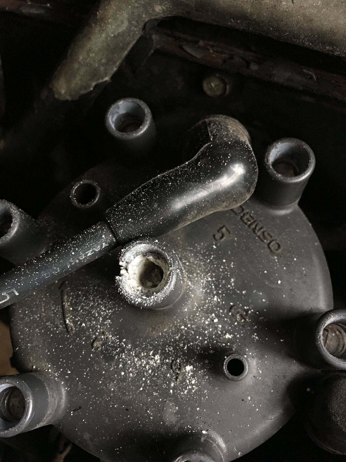

Never seen a dizzy look that bad. So what is the current status on your truck. Is it running better? Did you ever get your carb dialed in?
It’s still my daily driver. I’ve got a big vacuum leak at the intake manifold. It’s hard to commit to removing it to have it machined because that means my wife and I will be down to one car til it’s all put back together. I think the carb is fine. It’s a freshly rebuilt carb from Mark’s Off-road. I did notice that I’ve got excessive carbon build up on the choke side of the carb from fuel that’s not burning. This makes me think I might have a timing issue.
Dizzy cap, rotor, and a Denso wire kit are all in the mail, so it’ll be back on the road by Tuesday or Wednesday.
