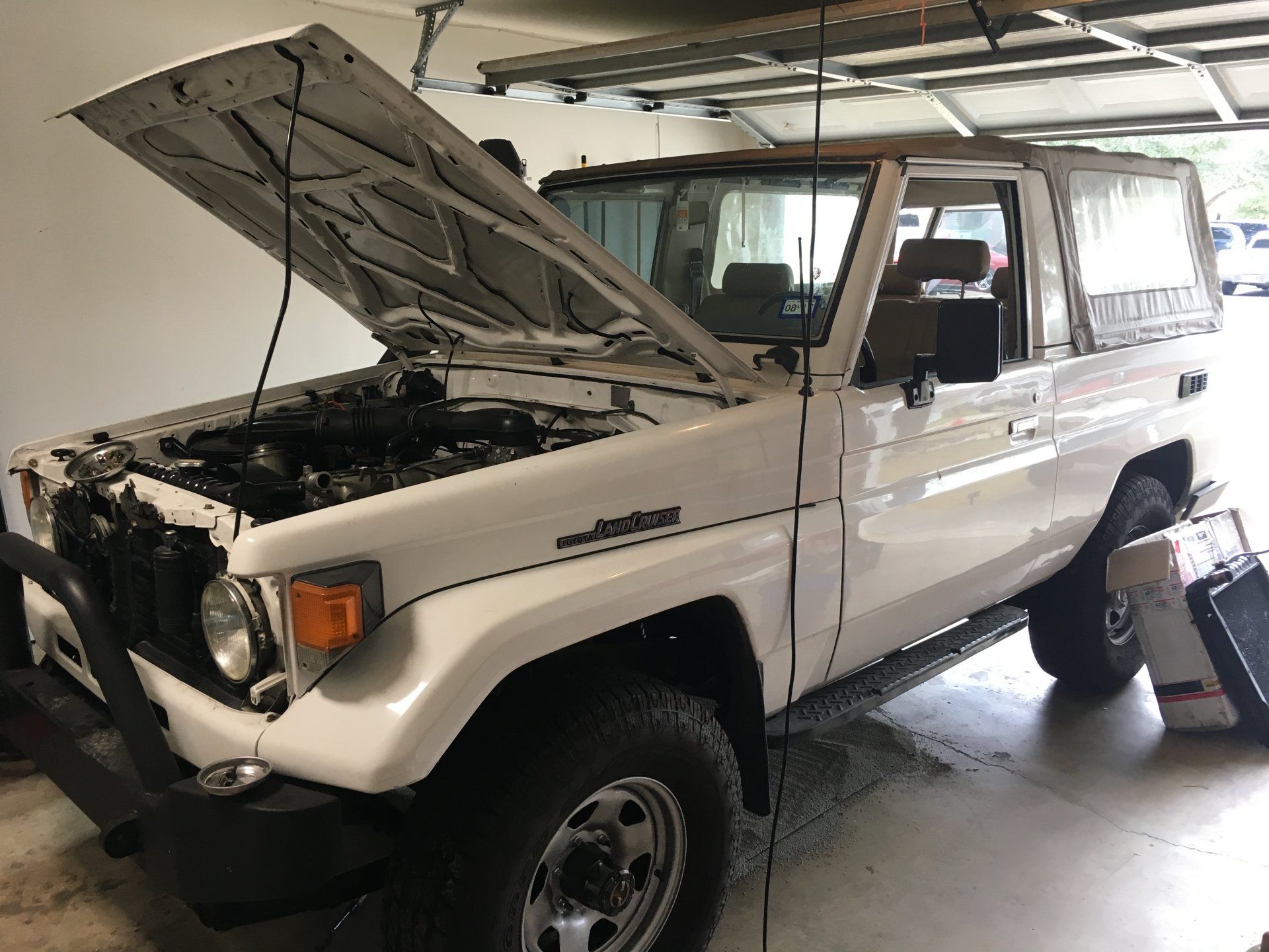

All OEM parts except for the THC, vac lines, and spark plugs. Also cleaned a lot of stuff "while I was in there." Last week I did the valve lash adjustment. Did it cold and added .002" to the FSM specs. Got some help from Ryan (@CaptClose) the next day figuring out the vacuum lines with the TH carb. It's not perfect yet and there are still some lines I'm going to add once I get a VCV in the mail.

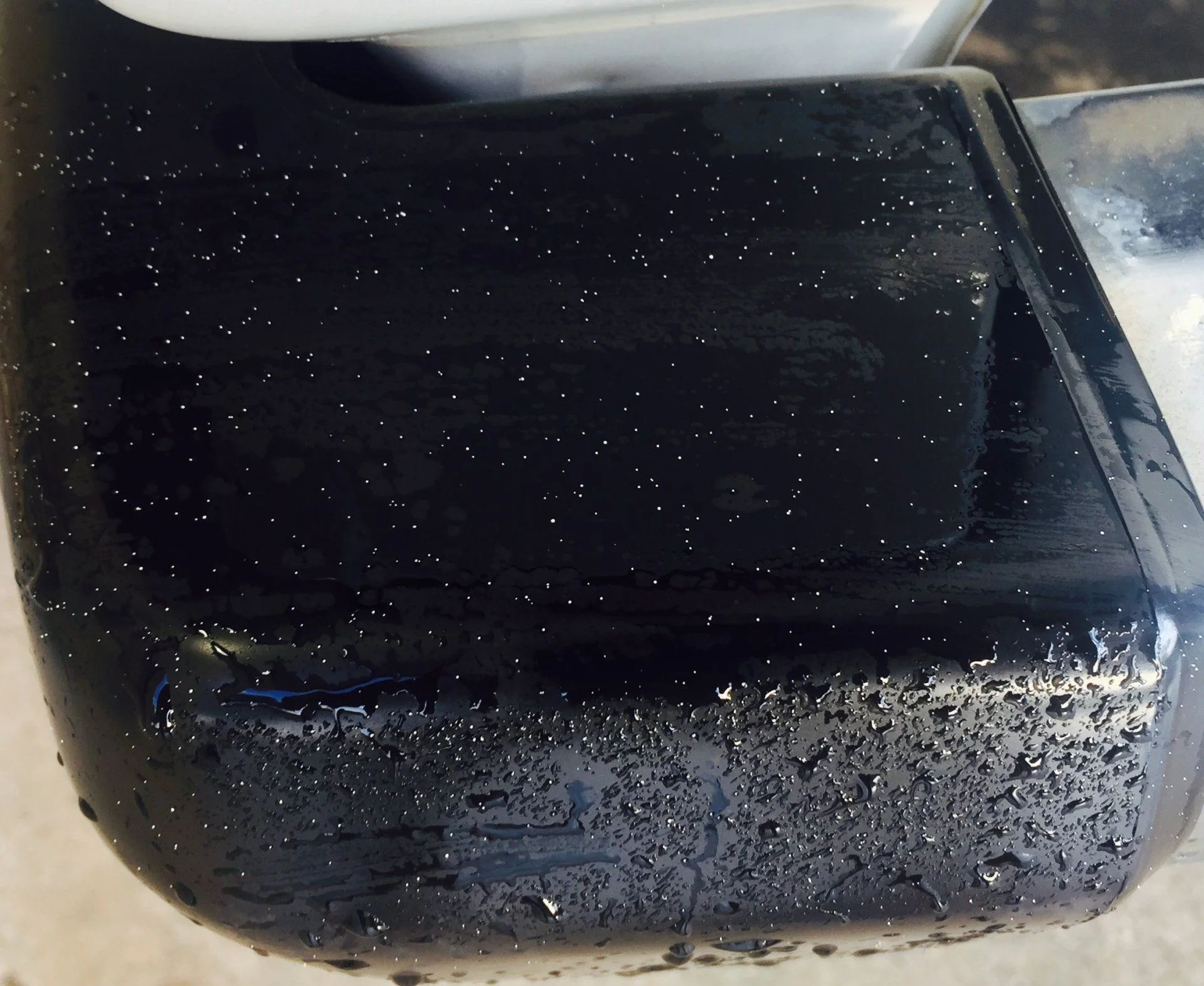

Also, last week I noticed some stuff on the end caps on my rear bumper. The house next door is getting renovated and they recently painted.... and now I have overspray ALL over the 60. I didn't notice it at first because it's white paint and my truck was dirty. Tried pressure washing it off today at the car wash, but no luck. You can't really see it on the white paint, but the whole truck feels like 220 grit. So, that will be a fun talk with the neighbor.

Made a couple tweaks to get it running better, but something is still off. I need to call Marshall at @Trollhole to get it sorted out. The engine just won't run very well without the choke pulled to at least half way.
That paint will definitely be on them. They were doing something on their property that caused your property harm. Take lots of pixs and let them know that if you have to call your insurance for the claim then they will then go to their insurance for payback. Betting its a only $500 deductible tho....
Got all of the latex paint over-spray cleaned up and they did a decent wax job. They didn't push it too hard because I still have original paint and it's starting to get pretty thin. Of course, when I took it in the weather decided it was going to rain for a few days. Here she is sitting outside of my office window.
