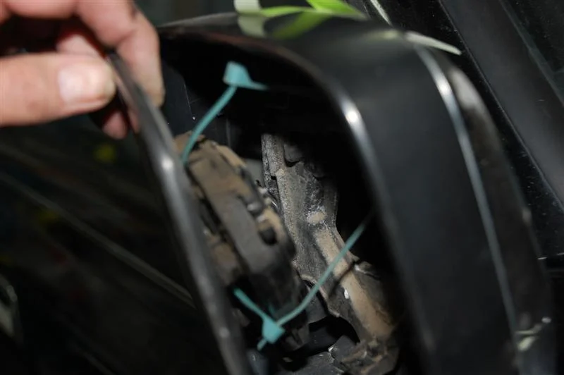

I just did this fix on my '96. I ran the zip tie vertically on the side that had the tab broken. I suppose if both tabs were broken, I could have done two zip ties.
The key for me was to point the mirror waay up and center it side to side. Take out the screw and then lift the assembly off. Assess the situation and put a zip tie through whichever side of the mirror needs it. There is a small hole in either side that a zip tie will barely slip through.

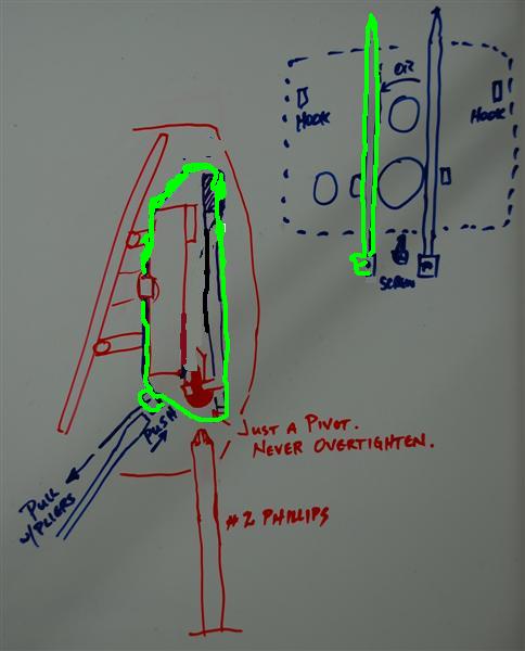

I have added a sketch showing a side view and a face view of what's inside to the best of my abilities and recollection. Some parts may be upside down, but you get the idea. Placement of the zip ties makes it easy to tighten it up. Pull with needle nose pliers and push up on the big end with a screwdriver. A flashlight came in handy.
Also pictured is my perfect example of "if you thought it was in focus, it was't." This is the zip ties on the passenger side. I should have pulled the top zip tie a bit further ~ 1/2 inch. On the DS, I did better and it is nice and firm.

Got it. Well I cocked this up and I don't have screws or the plastic is busted. Could you just wrap 2 extra long zip ties around the entire bracket with them routed through the mirror motor like blkprj80 shows, one on each side of the screw so to speak. Would this hold everything in place if the screw were not used? The problem I had using 2 connected zipties was that the zip end would get stuck between the bracket and the housing.
Changes made in an awful green. Sorry i'm at work and this is the best I can do with Paint and a mouse. but basically i want to wrap the whole thing. not just the top part.
