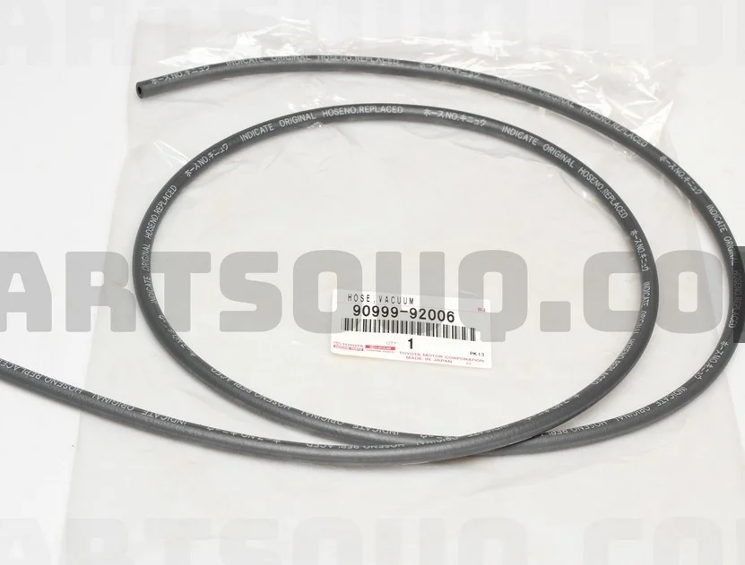

I had to scavenge some vacuum advance hose off the carb to distributor line. Wondering who has that for sale and is it special in any way? Size diameter? I'd like to run it back out of the way along the hard fuel line.
You can actually get OE vacuum hose from Toyota. If memory serves, this application from a 60 series is the correct length-
@kunzma, Here is the size chart copied from another post. 92008 is the longest length available from Mr. T and cut to length

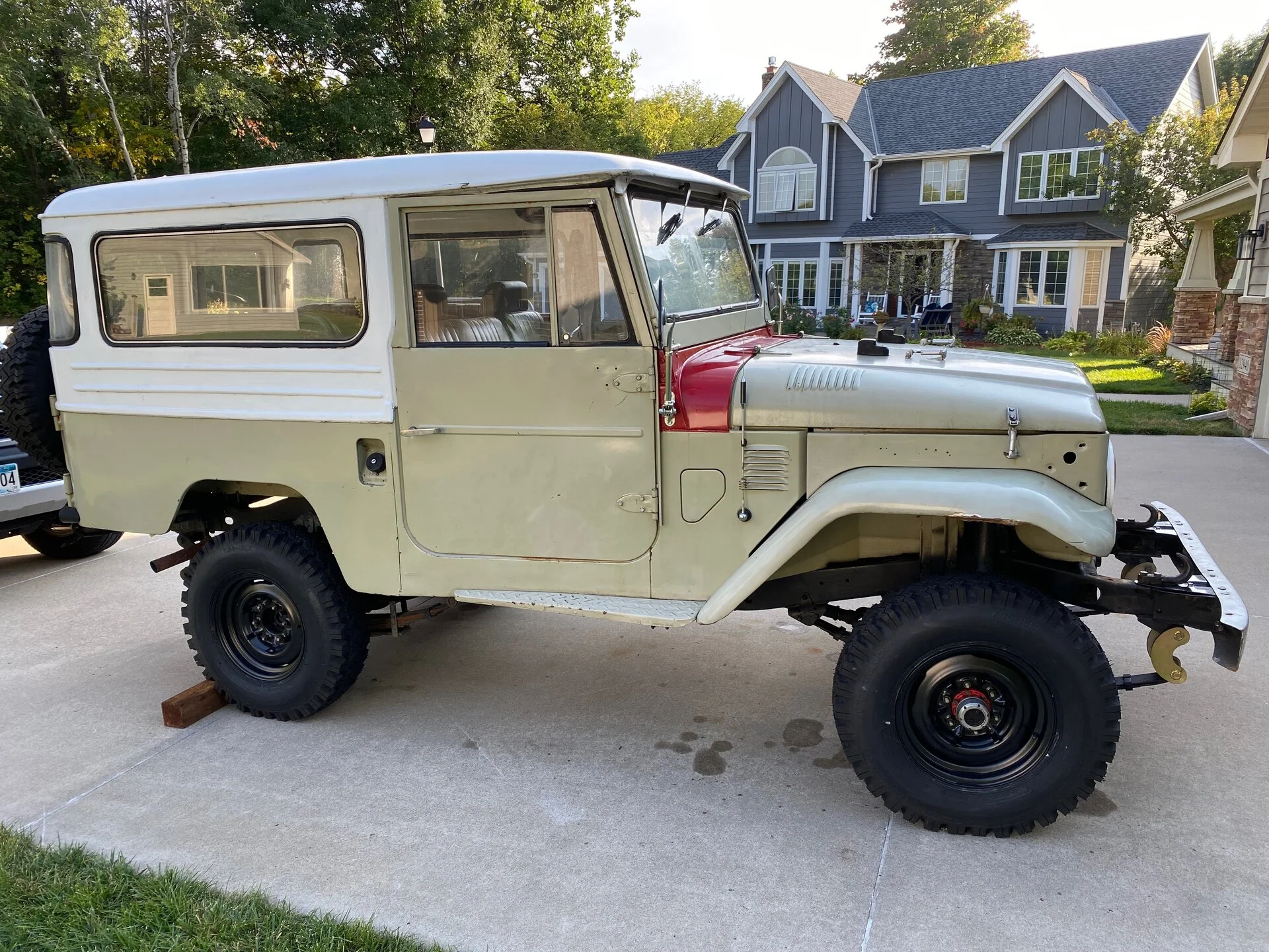

Limped her off the car carrier and up to the garage. Really need to look her over to see what I want to do for her. I have a desire to do a smaller budget version of what the FJ Company has been doing to the Fj43s that they sell. Clean, simple, sound.
Wheels for certain. New 15" rims with tall skinnies. Swap out the front turn signals for some early round ones. I like the original side mirrors more than the 80's version.

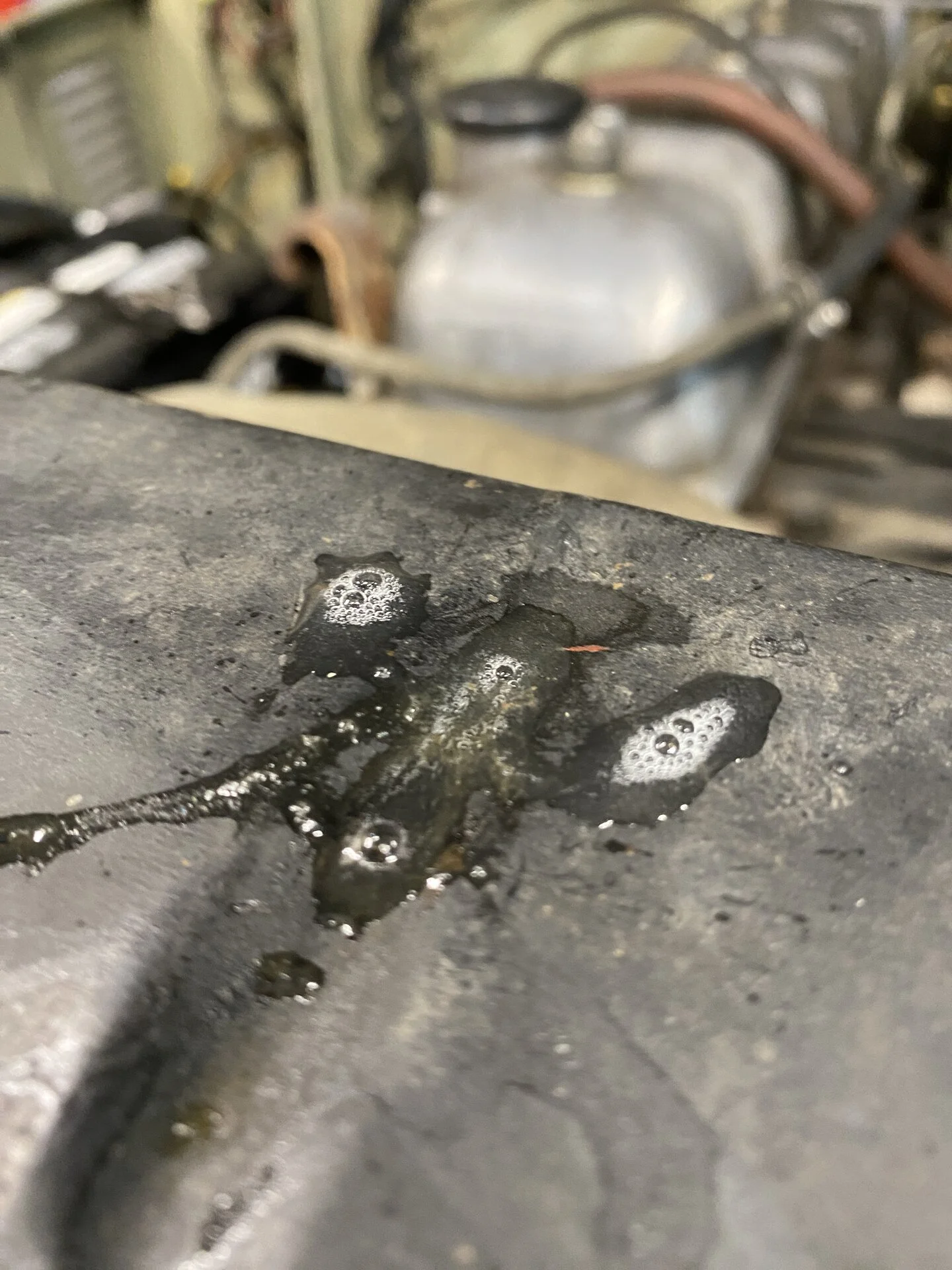

I got the fuel pump running. Replaced some old rubber fuel line. Truck now fires up immediately and runs well. Need to dial it in a bit, but very pleased. Found several holes in the radiator. Thought I might get away with not doing a bunch of cooling repairs, but no such luck.

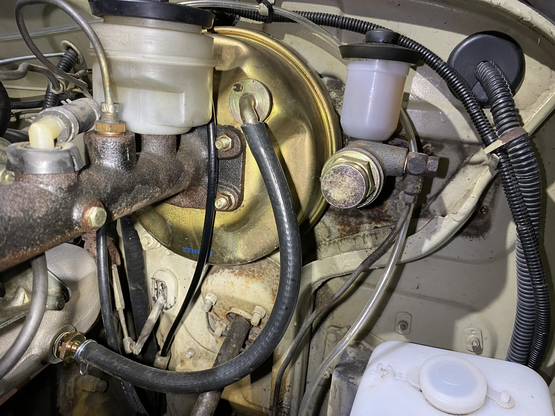

Can you post a wide picture showing the clutch master, booster, brake master etc, and a picture of the pedal bucket underneath the dash (if it has one?)

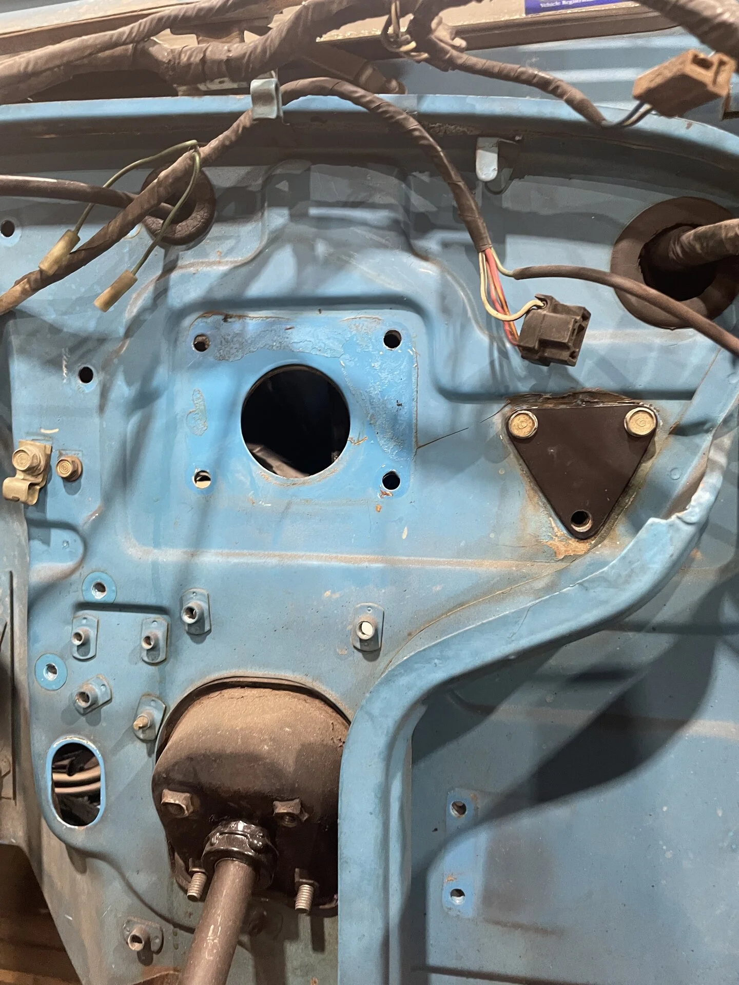

I had this truck at my shop to inspect before it got sold off to the new owner. someone welded a new plate under the dash to make the booster work,

going through this now with a 76 here that came in for a booster/dual circuit conversion.
For whatever reason Toyota moved the clutch master over more then the full width of the master cylinder body, so no regular sized booster fits. Green 40 is Costa Rican 76, Blue 40 is USA 76
If this truck wasn’t actually painted nicely I would cut and graft the firewall.

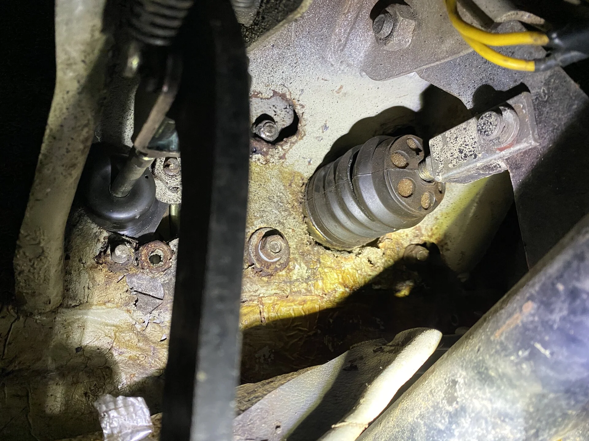

Here are some pictures of the firewall. The booster seems to me to be the root of the problem. I think the booster is an oversized replacement. They moved the throttle linkage over on the passenger side of the booster and moved the clutch over on the driver's side to accommodate the booster.
@cruisermatt
Am I seeing things or has that booster ripped through the corroded firewall?
Double walled, maybe. Or, added a plate to the firewall. Then, cut the inner wall back to get to the nuts and bolts. I will know more when I remove the booster.
