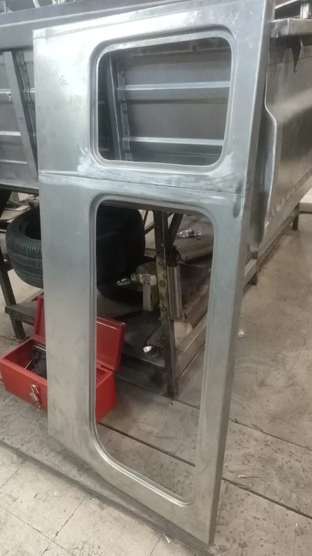

I had some time over the summer to paint some parts with some rattle can paint from the auto supply shop. Painted the running boards, fenders, cowl and the turn signal cans. Starting to come together color wise.

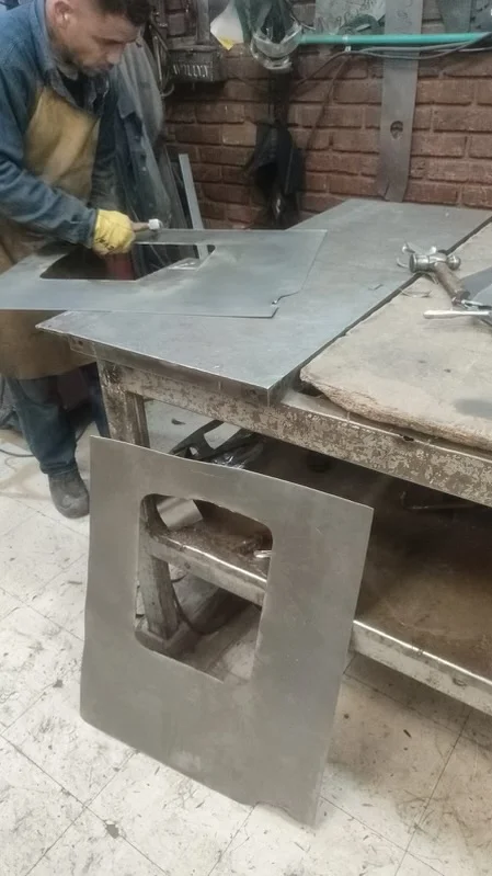

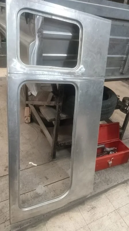

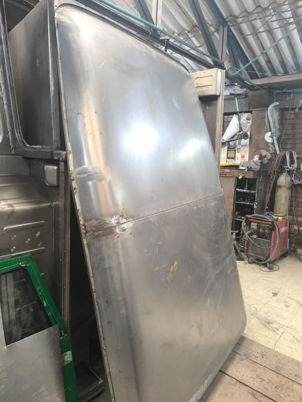

I worked with @youngmanchego to purchase a new metal roof and top sides from an outfit in Colombia to replace the fiberglass top. Hopefully the parts arrive in the next few weeks. Still need to locate a nice pair of ambulance doors to replace the fiberglass doors currently on the truck.
Awesome. Fighting soft top leaks and considering the same. Mind sharing more details on cost, glass sourcing, etc?
