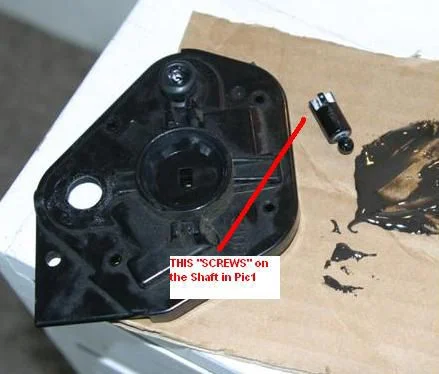

I then cut little notches into both sides so so the JB Weld would have something to "grab ahold of". I let it dry overnight, the plan is to cut the holes tonight and reassemble. I'll post pics in the next couple of days...
(didn't see the screw on the bottom)

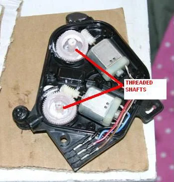

Just thought I would update this thread with some more pics. Here is the internals of the housing.
