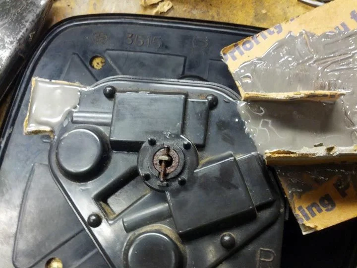

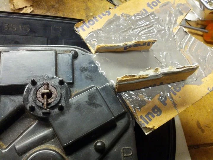

I had this issue, but hadn't had time til this weekend to work on it.
After removing the mirror, I didn't break it down into the two seperate parts, just left it as one. Since the top and side of the mount were missing, I drilled two holes in the plastic and then used 24 ga wire to insert into each hole and twisted it tight.
Once I got the wire in place, I measured and made sure that the wire "rebar" was gonna be centered in my JB Weld mix. I used blue painters tape to tape everything off, then applied the JB Weld overnight.
The fix worked beautifully. Thanks for the inspiration and ideas!
A pic to see how I mounted the wire:

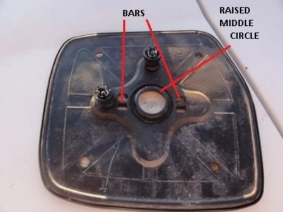

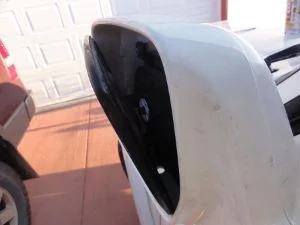

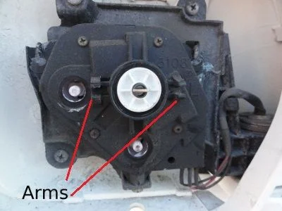

OK i was attempting this fix and pulled off the other mirror to see what it was supposed to look like and now I cant get the mirror back on properly, i even broke the actual mirror trying to reattach.
The two "pivot points" (that extend and retract to adjust the mirror) came off with the mirror so I left them on there. I can get these pivot points back in when trying to install the mirror but the mirror just sags.
It seems that the raised middle circle on the back of the actual mirror doesn't slip back around the white center (that's still on the car) and the two arms on do not come close to going around those bars on the back of the mirror. While trying to get the "raised middle circle" and "arms" and "bars" to mate is how i broke the mirror glass. Any good place to get the new mirror glass?
pics attached, please advise.

please disregard my question, besides where to get new mirror glass. I am an idiot.
You figured it out but I am still an idiot. How do you get the white piece back into the mirror glass? I did the same thing, do I now need a new glass? Any help will be humbly appreciated.
