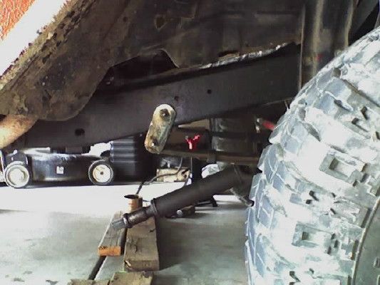

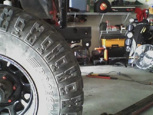

got the springs back on andthe shackles all buttoned up, looks sweet
need to get the driveline extended for sure, i think i got around 3 1/2 to 4 inches of wheel base.

the approach angle is way better now than before. i will have to do something about the shock mounts, due to moving the axle foward the shocks need to be redone. i might go with ford towers while im in there
I would highly reccomend the ford towers, SO EASY AND CHEAP!, just weld em on and at around $8 a piece you can't beat this mod, no reason to mess with the stock ones.
