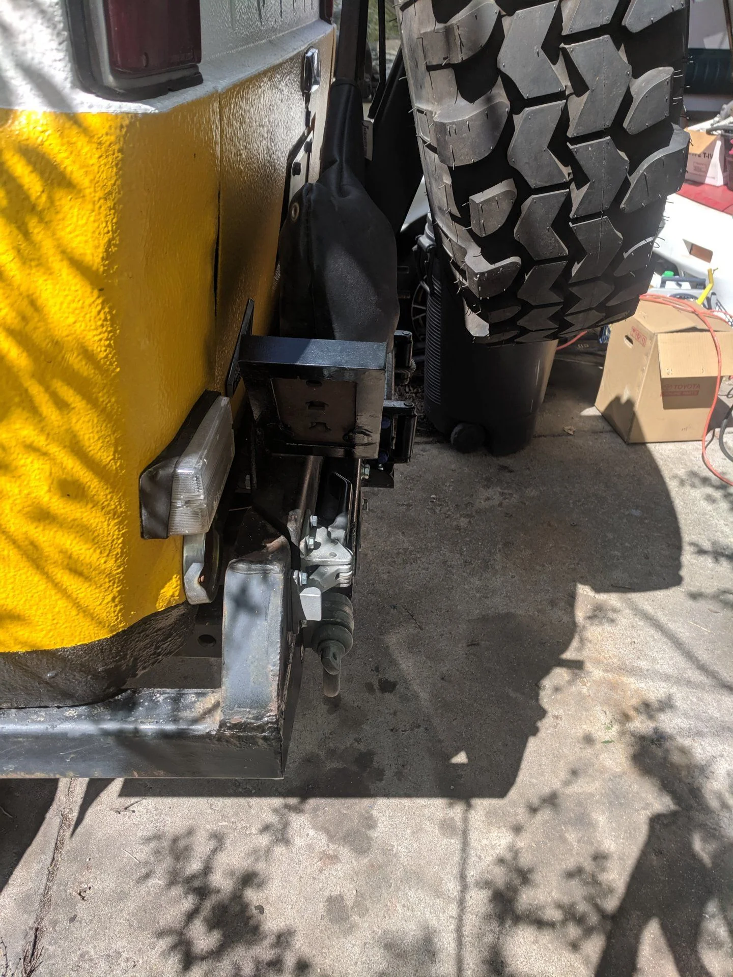

I rewound the rear winch cable and finished the wiring. It works great! I am pleased with how it turned out. It doesn't protrude too far out the back.

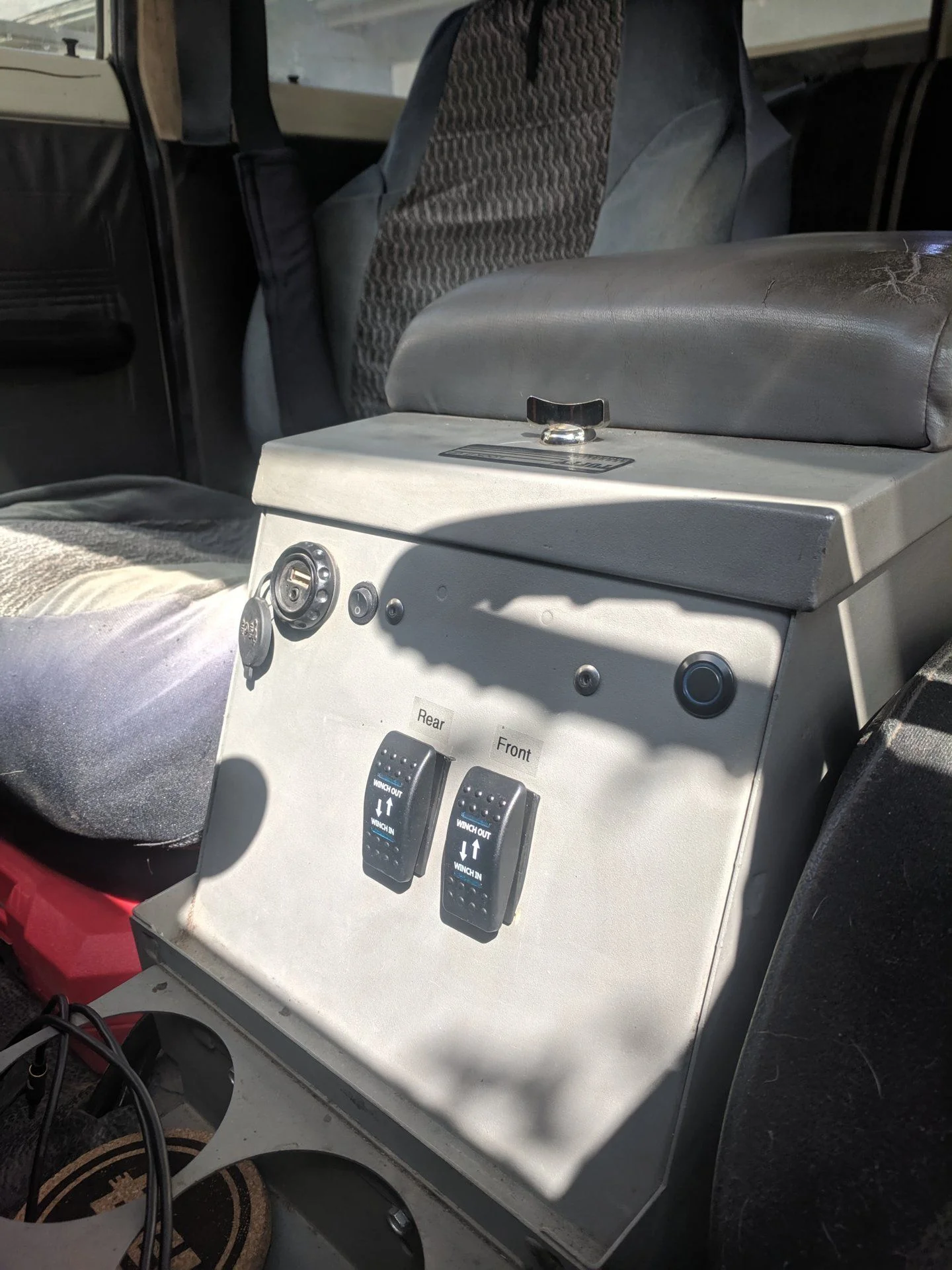

Also, I added in cab controls.

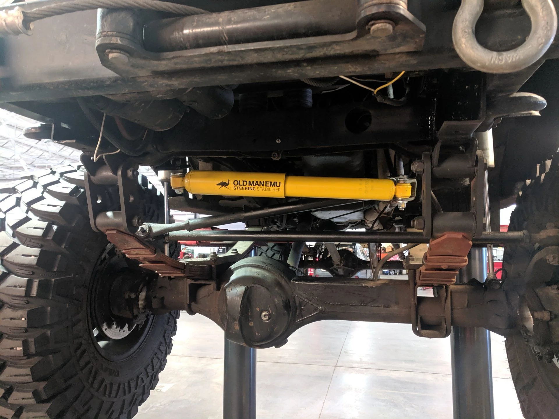

With a 37 inch tire, my opinion is running a steering stabiliser is a good thing. The one I had was stock replacement that was wearing out the bushings and had some play inside the stabiliser itself and you could feel that in the steering at times. Especially crossing a rutted road diagonally. The brackets I made myself as usual.
