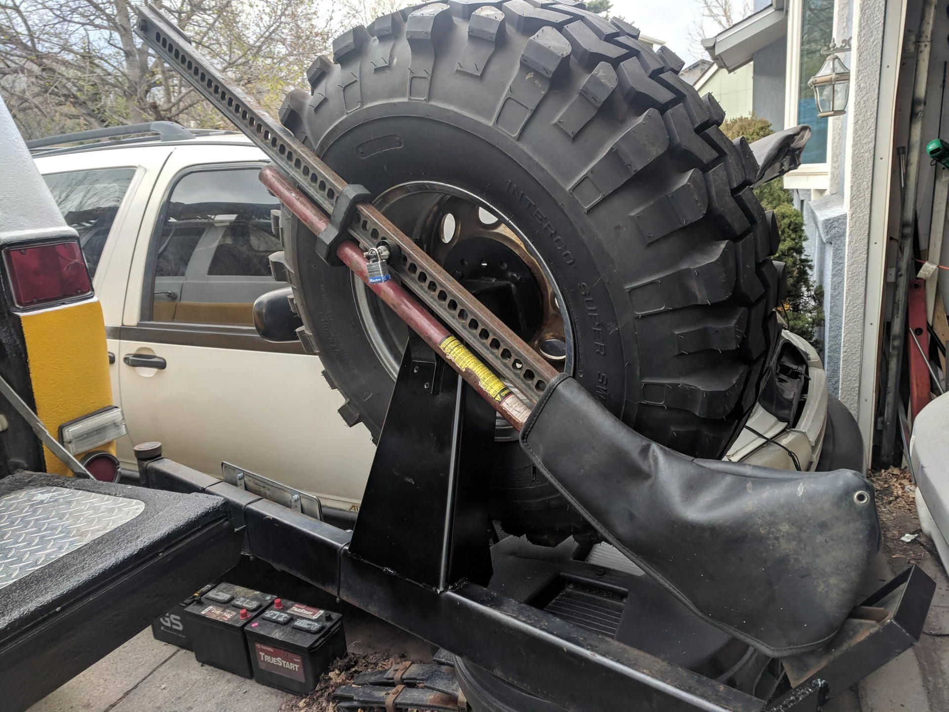

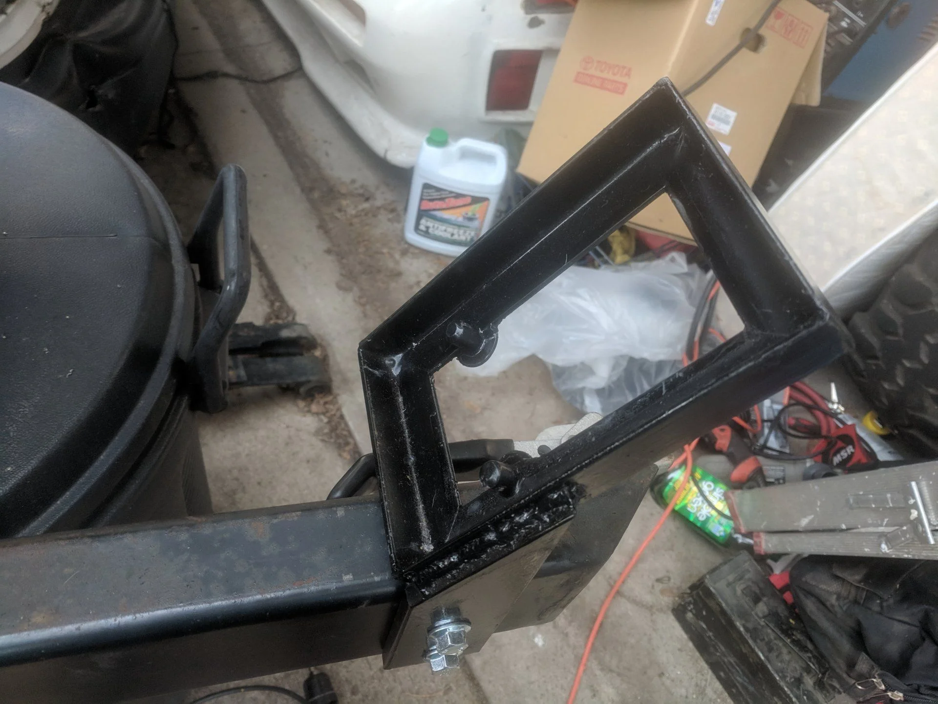

I got another project done! Because of the rear winch project, the hi-lift jack mount I had wasn't going to work. So I made a new one. The best part is that it is made all out of scrap and it didn't cast me anything. It holds it tight so there is no rattling and now it includes a lock so my jack doesn't go to a new home without my consent.
Here is the upper mount:
Here is the lower mount:
And here it is with the jack:

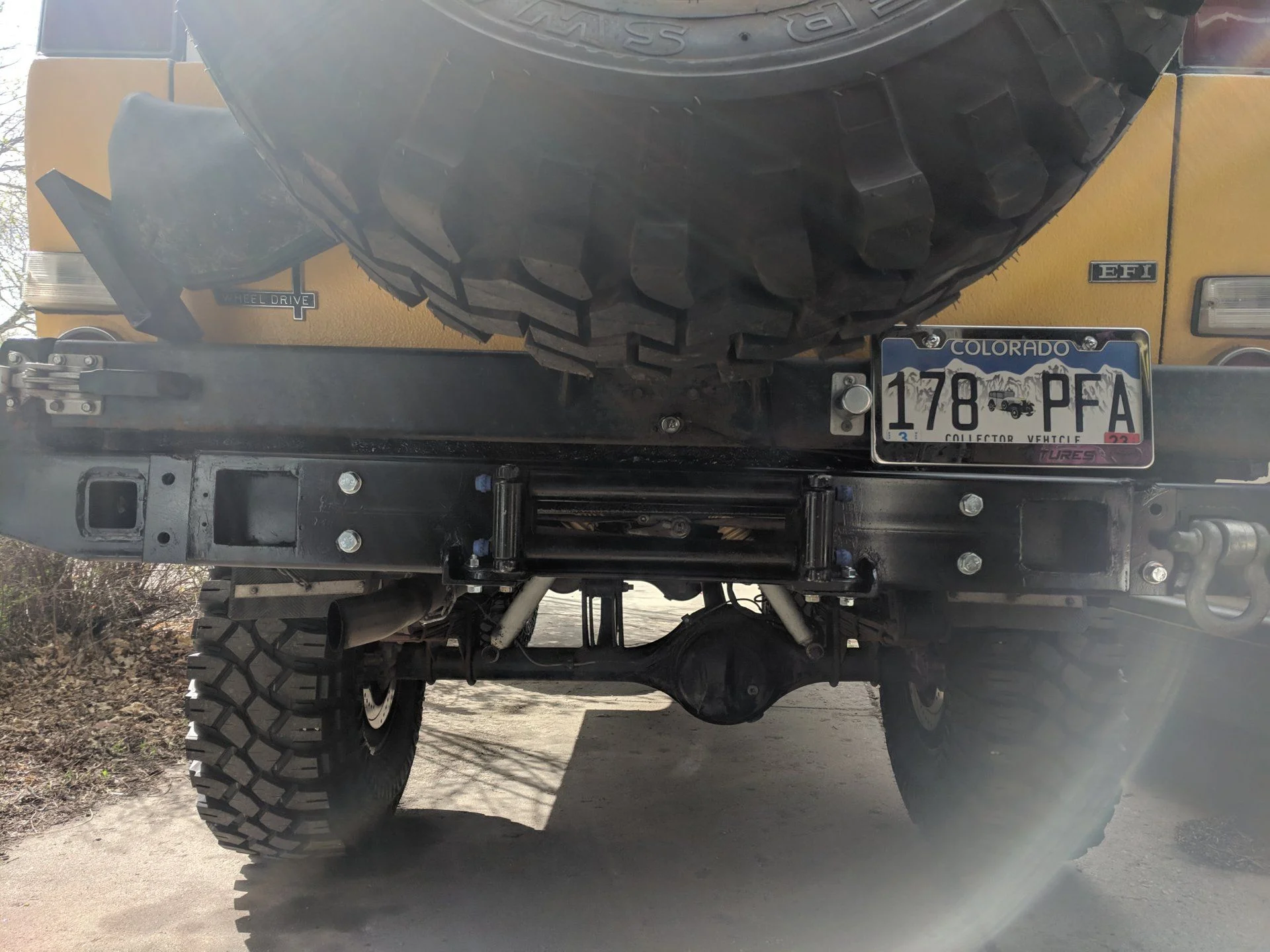

Almost ready to install the winch for the last time. I need to make a 3 more bolts that are a correct length, that is why there are empty bolt holes. I did end up notching the rear body underneath the tailgate so the winch fits higher. I reinforce the channel I stalled a long time ago. It didn't take much since it is 5/16" thick.

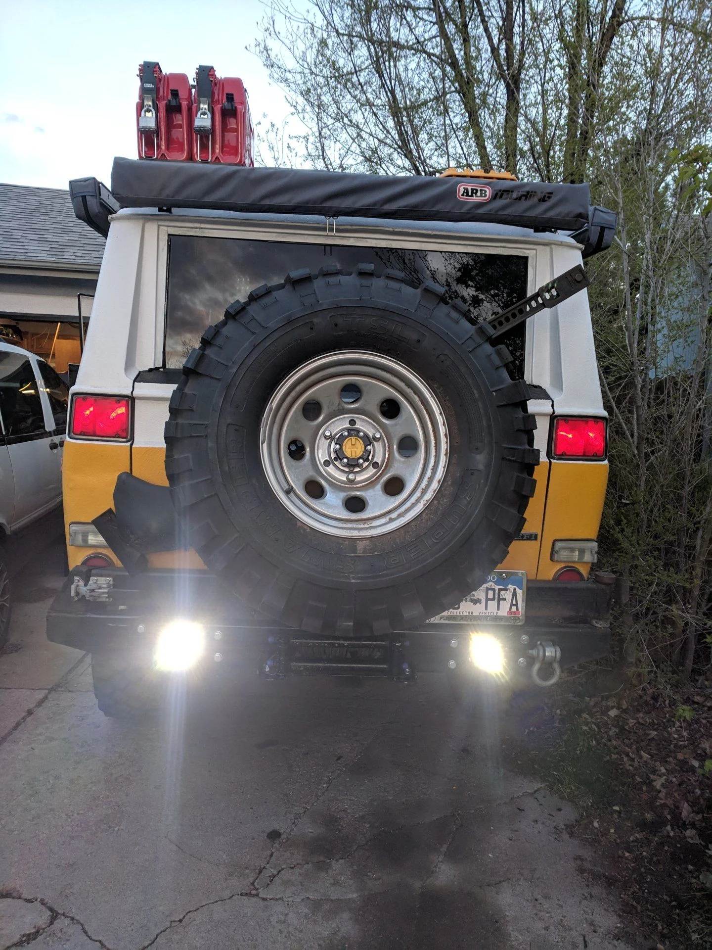

The rear winch is in and the lights are wired. I am still waiting to receive the power cables that I ordered. I still need to get all the cable off the drum and wrap it better in the opposite direction. I also want to run the wire for the in cab control.

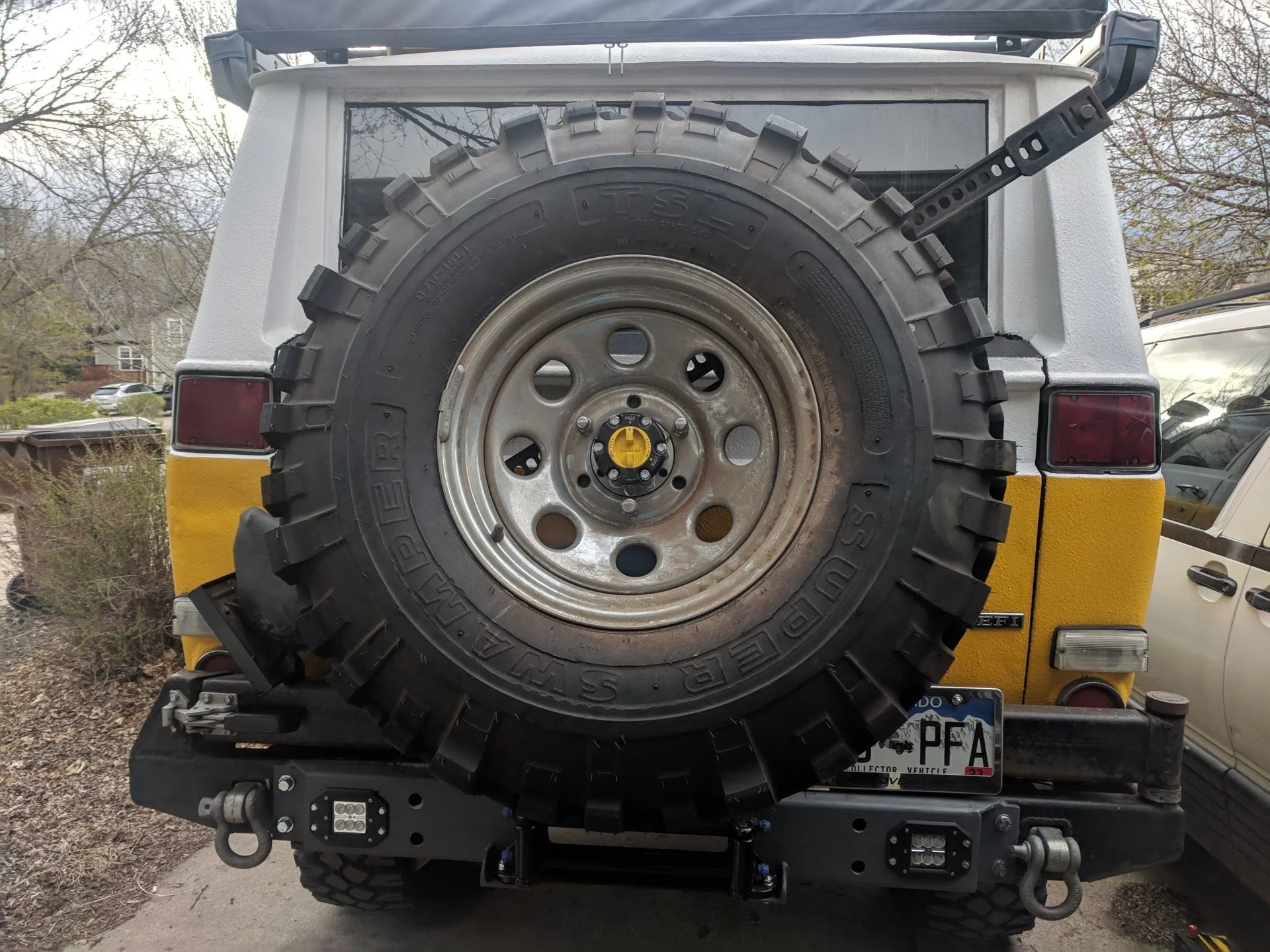

There are a few more things to weld but this is almost finished.
