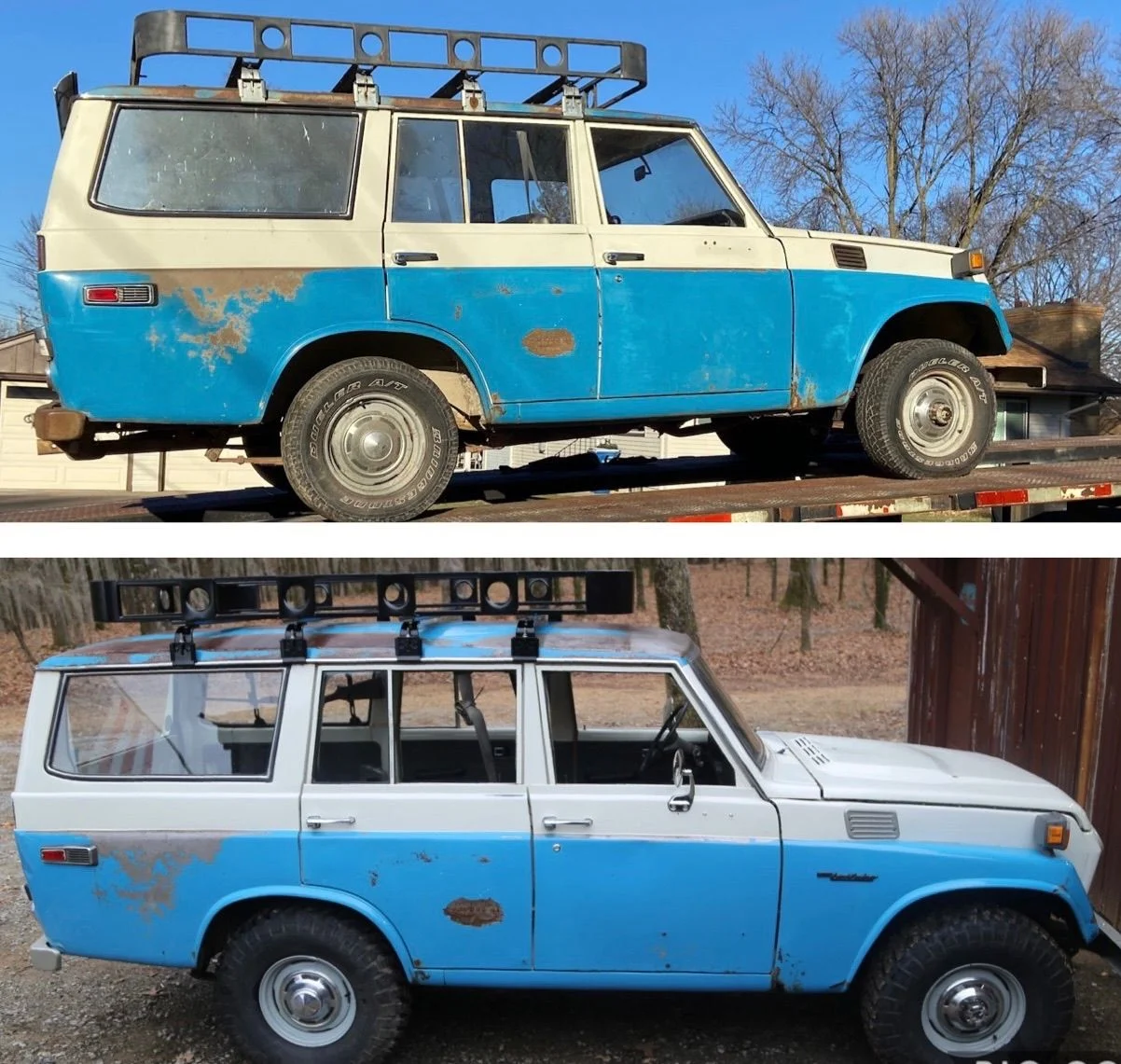

Yes, but for what you are running and planning to run it is about the lowest cost option you can do. Longer shackles will also get you there. But in all honesty, even with flat springs you should be fine running 30-32" tires. Here's a couple pic of mine... first pic shows how flat the rear springs are, second pic shows it with 33x10.5" tires with the exact same springs... after the second pic an Old Man Emu kit from Cruiser Outfitters was put in, but you can see that even with flat springs the 33's fit without any issues.
And here it is post lift with the same 33s on it...

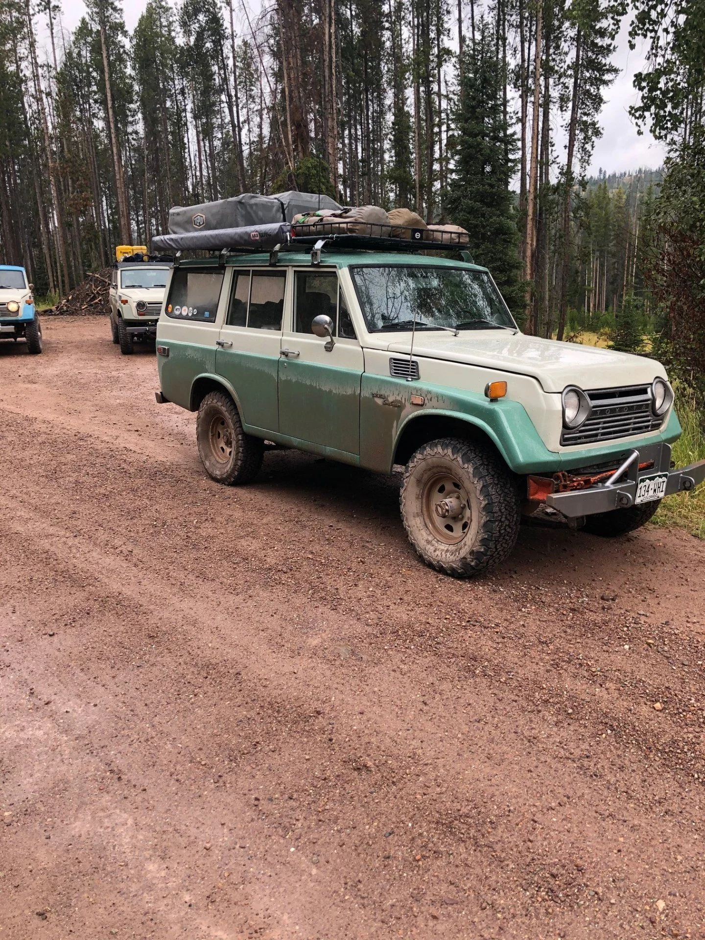

LIke you, I started with 30s and OEM springs. Then I did Man A Fre add-a-leafs on all four corners along with inch longer shackles, mostly because they were an unused bonus in a package of parts I bought along the way. Gave me about a 3" lift after settling. I've run both 31s and 33s since with no rubbing issues. Here's a pic of the current configuration and look with 33x10.50x15s.
