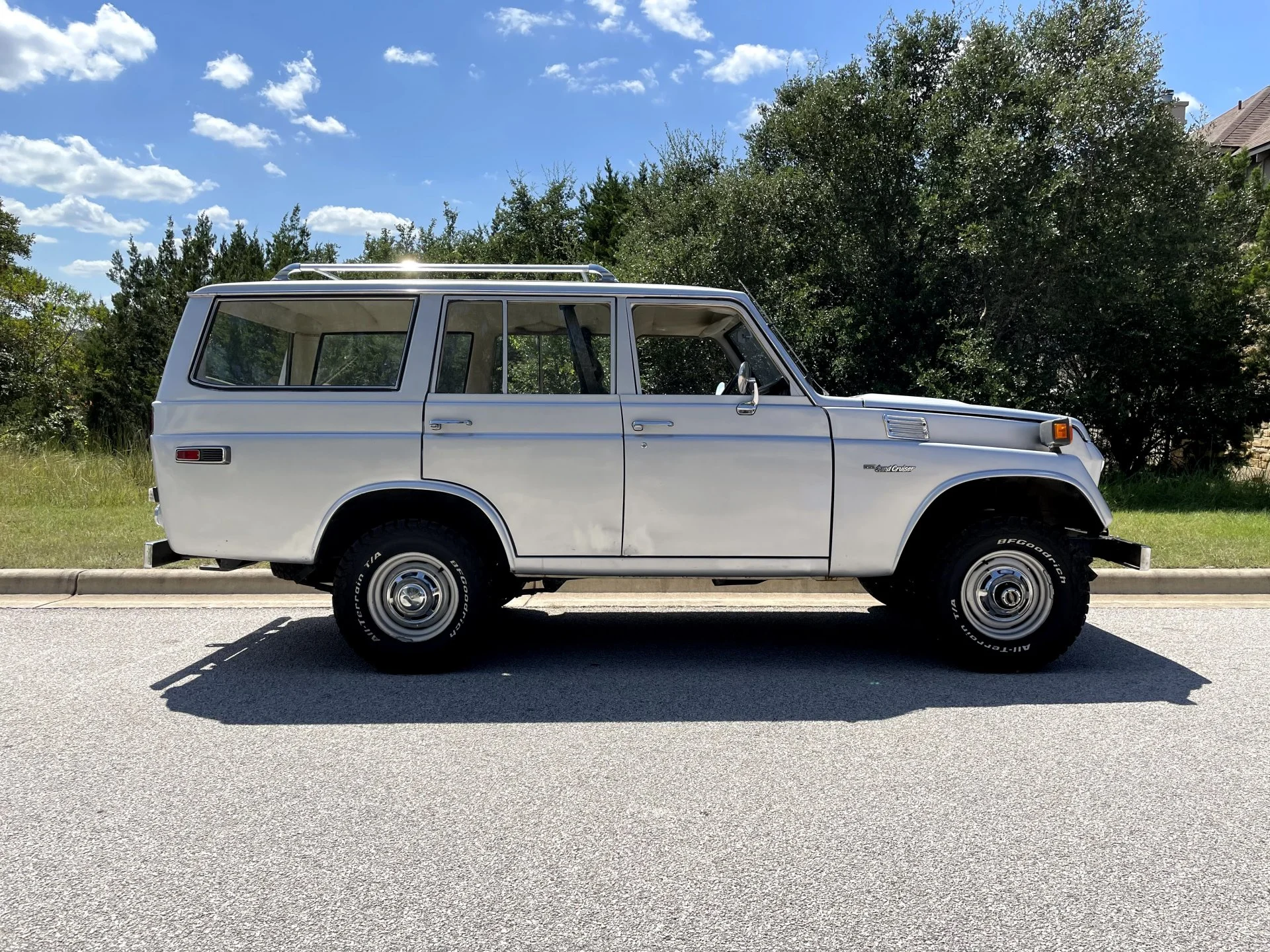

Finally got the alcans and new shocks on, here's a pic. This was 2" lift from the stock alcan setup. The advice i got to go with 2" lift to be closer to stock was valid. Tires on there are 30x9.5x15. Can definitely go bigger on next tire change. Drives like a different vehicle. Now to address the rust and get it back to the orig green/white...
