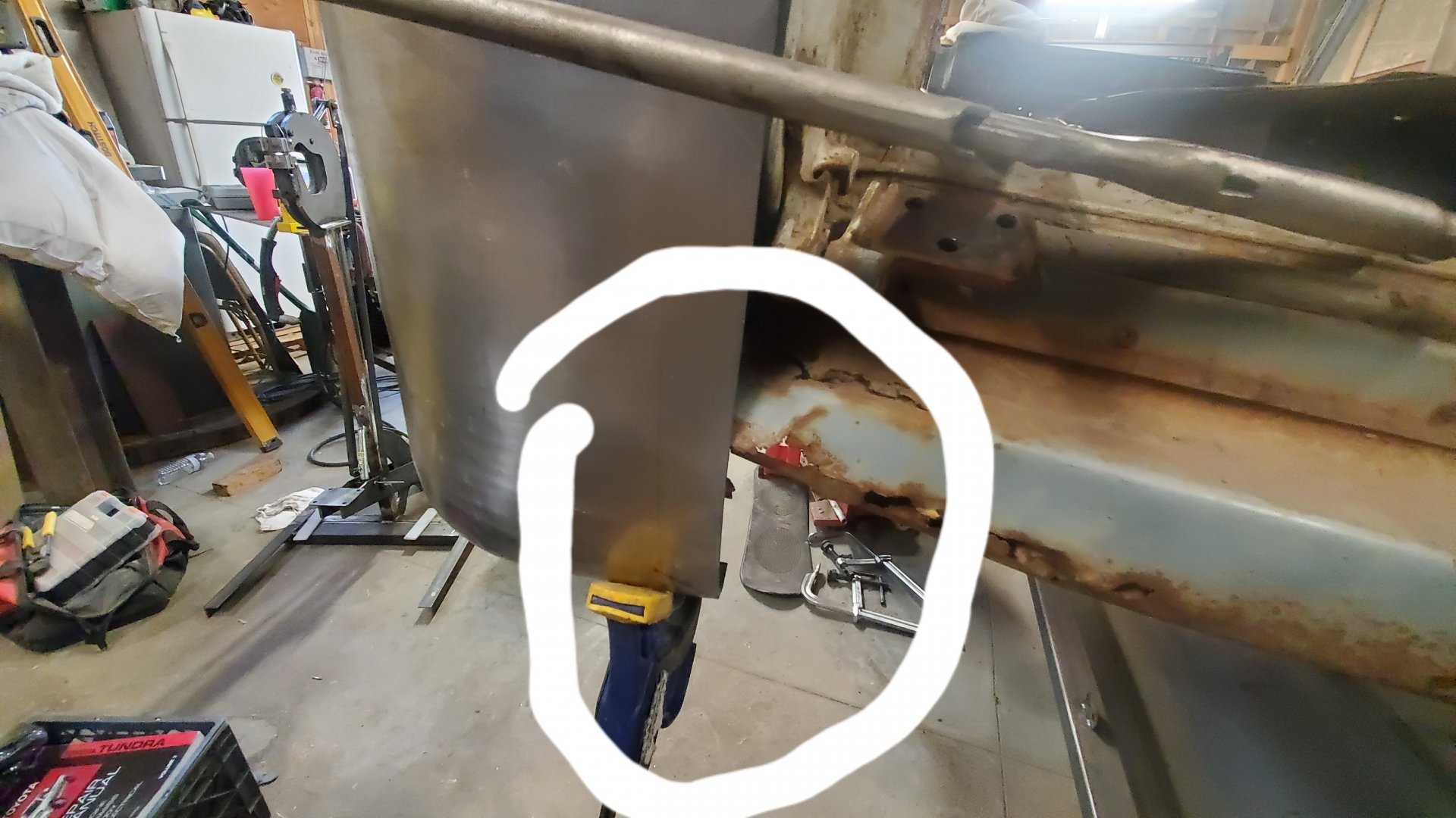

Haven't gotten out to the shop to work on the pig much but I decided to start getting after the rear body panels. I need the dimension from tailgate sill to the bottom of the rear quarter panel, so I know where to terminate the lower section. Neither of my pigs are solid back there. See circled area for reference on what I am talking about. Thanks in advance for any help
@J Mack Thanks, that's great. From what I can tell the bottom of the quarter is also the bottom of the body mount, regarding the elevation?

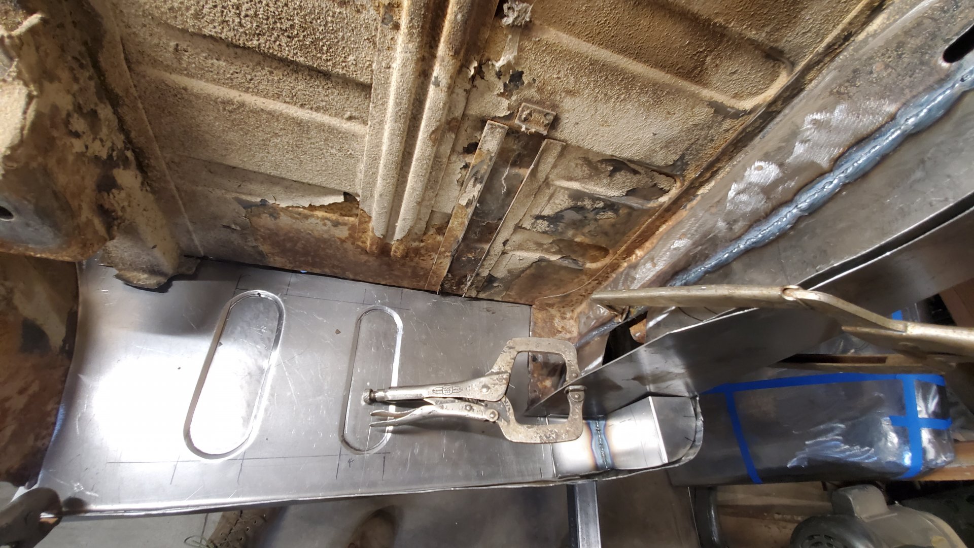

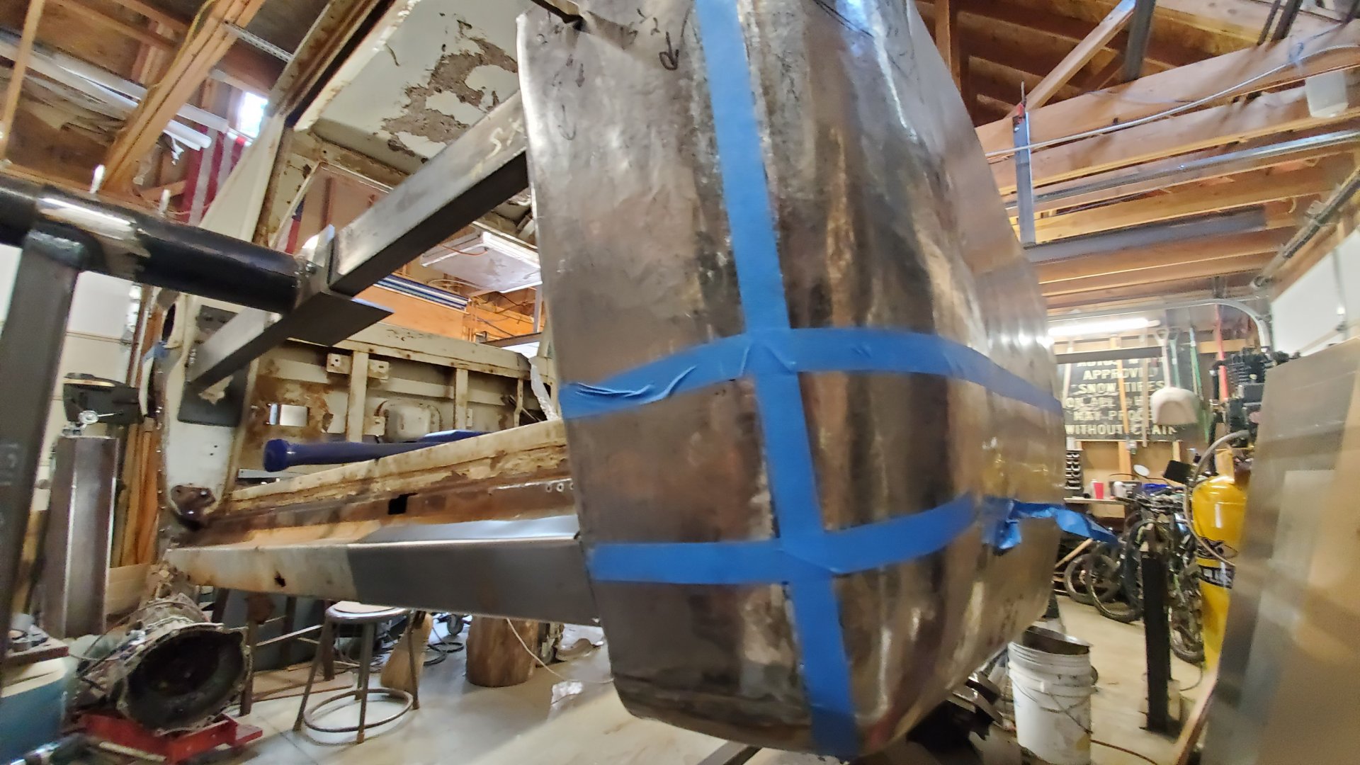

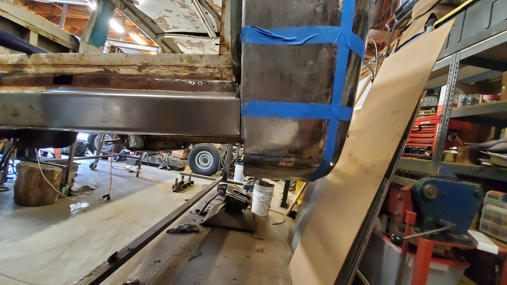

So I have been pretty busy doing some chores around the house and with work, however I decided to get going on this on Sunday. I think I am ok with the way this looks even if it isn't a perfect oem match. Once I cut and weld the two pieces together I will build the refescutcheon? And then of course struggle through making its mirror image.

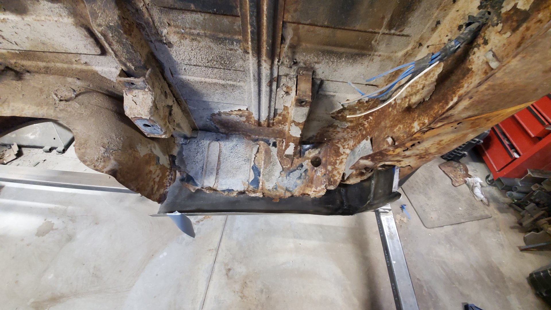

I already have the drivers side bent ready to fit. I think most of the rust seen is only surface rust, Mainly under the torsion spring. Bob does your valance tie in under the floor? I will think about it and let you know, but for now I think I am gonna be good?

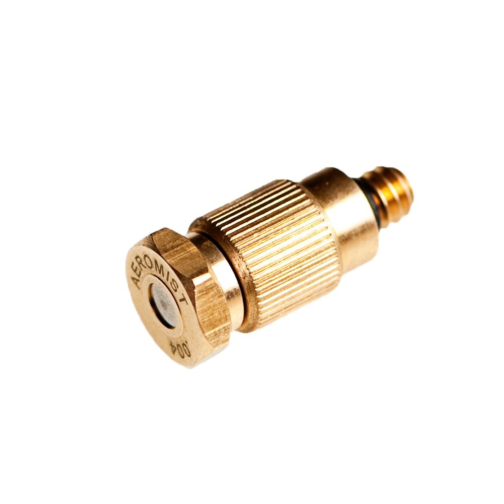

Anyone out there make a good distribution system for the rust converter in the tight areas? I was thinking of using some sort of high pressure misting nozzle like this High Pressure Anti Drip Misting Nozzle .020 x 10/24 Flow .05 GPM - https://www.aeromist.com/misting-nozzles/standard-10-24-nozzles/brass-cleanable-anti-drip-nozzle/anti-drip-hex-series-nozzle-020-x-10-24.html to attach to a standard pnematic air spritzer type siphon gun, either on the end of some hard brake line or a small high-pressure fuel hose.
Not sure it will work, any thoughts?
