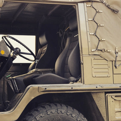

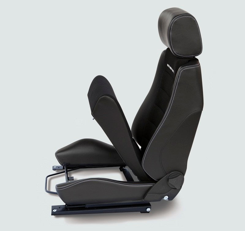

Quick update to an earlier post...
Here is a Bestop Trailmax II seat with some custom upholstery work:
REALLY happy with these things. I’ll be posting more in my build thead soon but they are super awesome 😎
