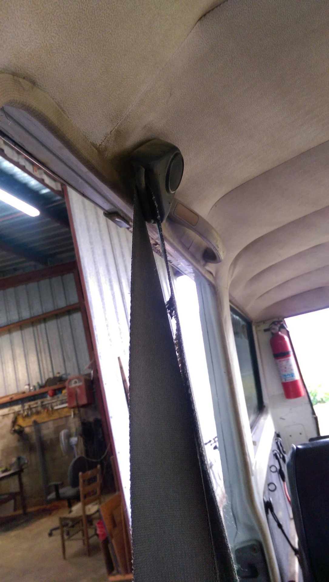

I used the seat back stops, because they seemed to be the strongest anchor points.
Do you guys have pics of where you mounted your retractors with or without L brackets? Can you please share?
The seat back stops are not "seat belt" anchor points.
Your location seems fine I would just add a set of L-brackets as doublers for the seat back stops and use the extra-large backup washers provided in the kit for the inner fenders.
This way every attachment point would have the 7/16” grade five or better minimum required hardware with back-up plates on the sheet metal.

Every attachment point should have the 7/16” grade five or better minimum required hardware with back-up plates on the sheet metal. As far as I can remember the seat back stops are held in with 5mm or 6mm screws and they are made from ~18 gauge sheet metal.
If I was putting my family members in the back seat and expected the belts to protect them in a hard impact I would mount Inertia locking retractor mechanism with grade 8, 7/16-20 hardware with ¼” or better doublers with as much surface area as practical when going through sheet metal, if I needed to change mounting angles I would use ¼” or better angle to accomplish this.
Again I would not rely on the seat back stop material thickness or mounting hardware to save my family members regardless of how many flat washers you stack up on the inside.

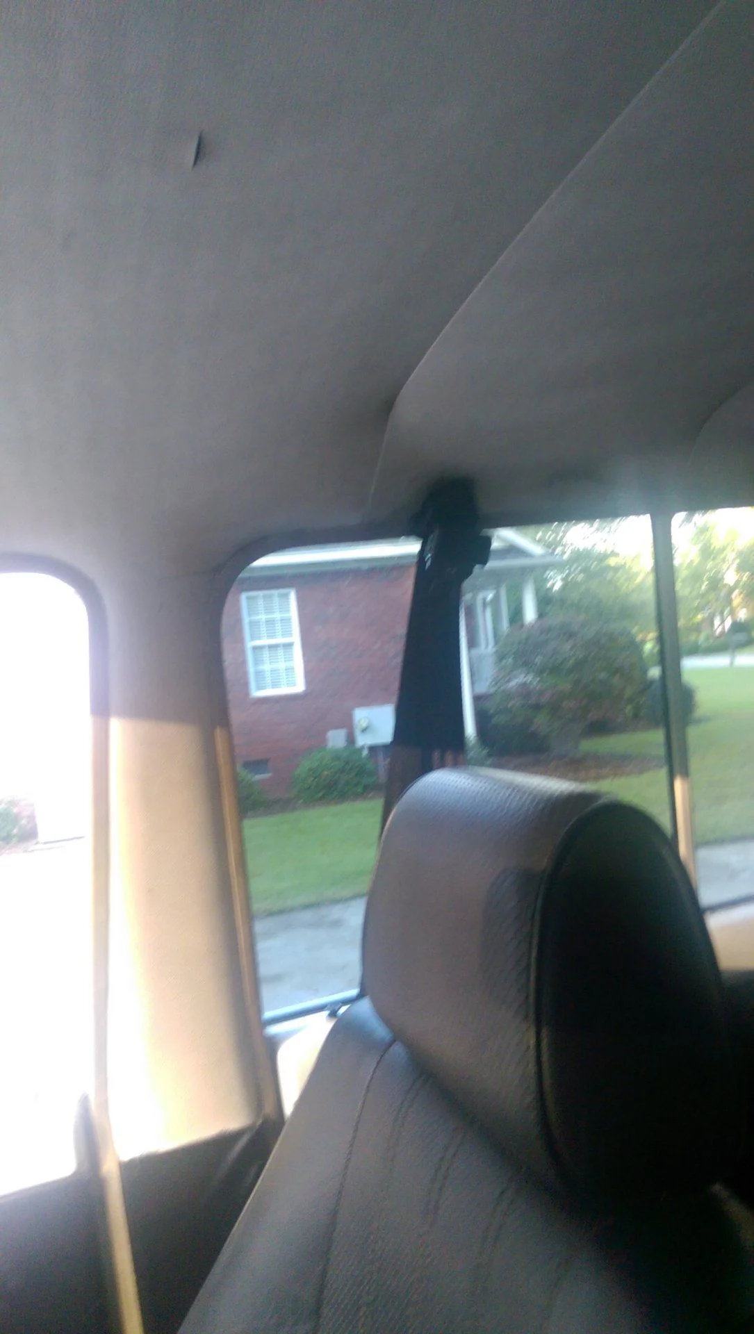

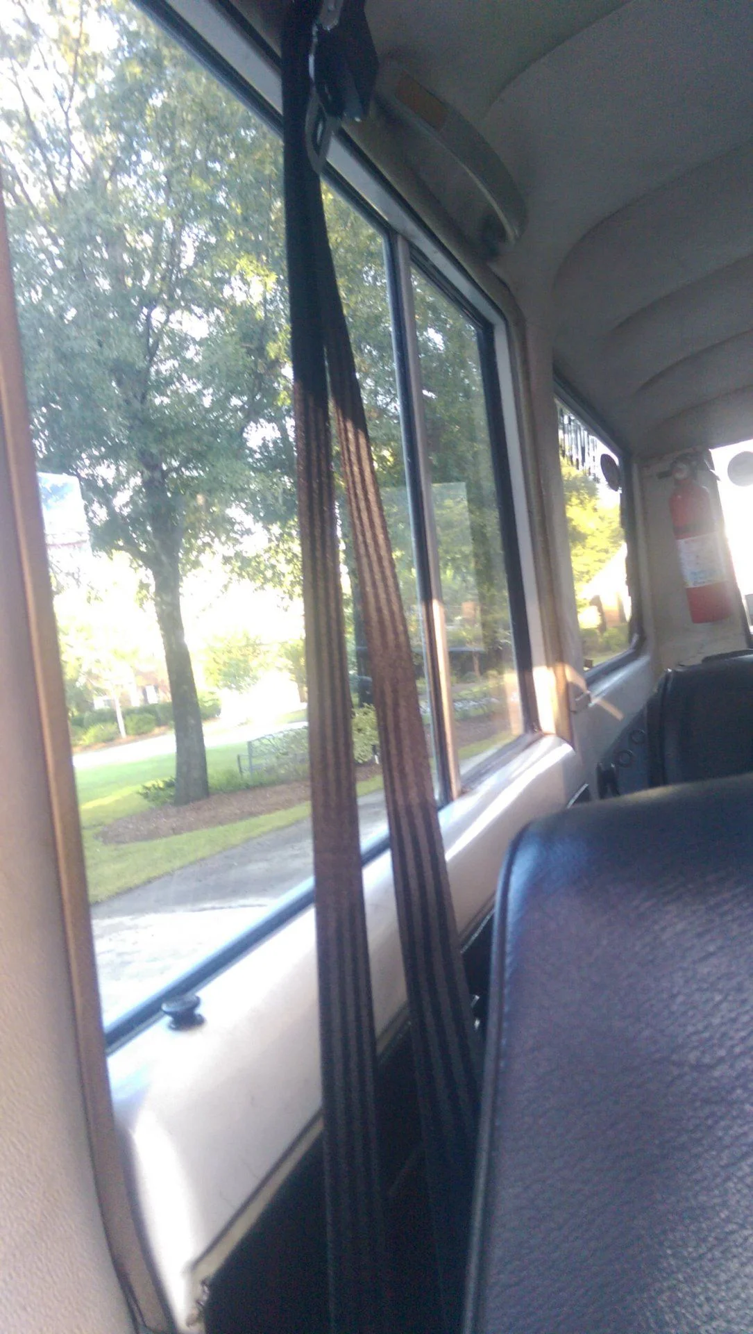

Mud be something in the air. Wife said she wasn't going to cruise with me any more until I replaced the 40 year old originals. Did front and back yesterday.
As far as I know. It was there when I got it.
