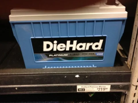

I talked to Odyssey about the difference between the automotive and marine batteries they make. The extra terminals and marine sticker are it. Both are the same starter/deep cycle battery, same deep discharge recovery ability, same specs.
So if you were holding out for the sweet blue colored DieHard Platinum marine to go on sale because you think it is more "deep cycle" than the Platinum auto, wrong... sorry. Warranty on the marine is not as good as well (3 yeas, not 4 with the prorated 100 month).
I researched a lot before purchasing, unless you want the Group 31, extra terminals, or blue plastic.... get the auto while they are on sale, same batteries - better deal, simple as that.

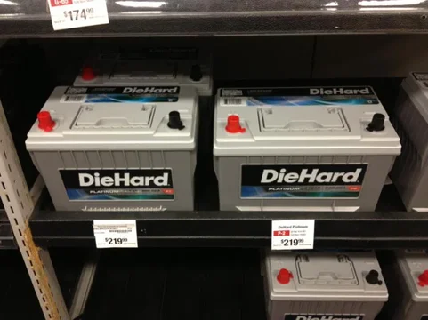

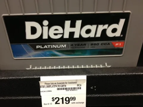

This is what I was looking at last night when I was getting my new tires mounted...there is also a platinum PM1 battery for $280 but it's about twice the CCA as the ones I posted pics of....there were out if stock on the PM1
It seems to depend on many things. Price for one. Sometimes people score these for under $150. All the automotive and marine DHP batteries are the same technology. So, you can go with easy direct fit, reverse posts, or huge and modify the battery tray. Even the smallest, direct fit, is way better than the stock spec battery.
