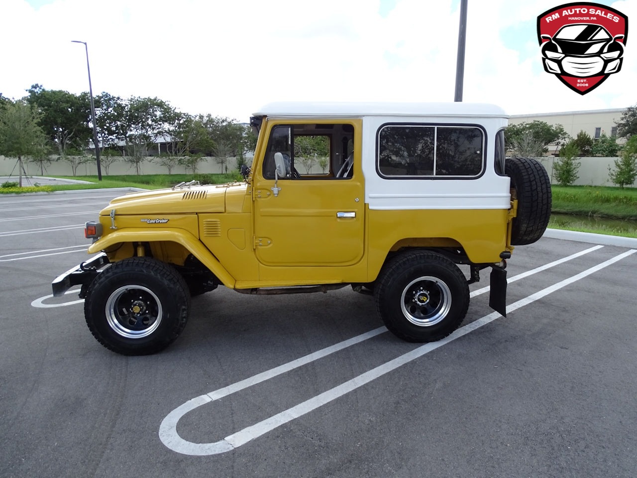

FrankinCruiser. I don't like the rear door one bit. Heated leather seats? For that kind of coin I'd want oil analysis and compression #'s D/W
That has a weird Top . No heater and other things
Definitely South American, questionable restoration, I wouldn't spend $21k of my money on it.

@agingfleet knows what he is talking about- His 40 is a perfect example of a beautiful rolling restoration.
Have you looked in the classified section?
You need to be willing to travel or find someone in the area where the vehicle is that is knowledgeable to look at a 40 for you. There is a clubhouse section that spans the country. Typically you want a solid body and decent mechanicals. Bodywork can become a deep rabbit hole. I believe the 74 could be a deep hole.
Mechanicals are usually easier to quantify and identify. South American 40's usually have been rode hard and questionably repaired. Lipstick on a pig comes to mind. Don't get a caught up on the bling. If it has been restored try and get the b4 pics or buy one from a reputable seller on this site. You're budget should land you a nice driver with a decent body, it may need some body or mechanical work though.

These trucks are really easy to tear down, can be a challenge to get back together the right way. Buying a solid 40 to start is $$ ahead and can be improved over time without taking it off the road for a year or 10.

I drive a Colombian FJ43 and it kicks ass. You could find the same crap right here in a NA FJ40, the home of lipstick on a pig!
Know that where ever your 40 series comes from to look it over completely.
Anyways, that 40 is most likely Colombian because of the MPR hardtop which originated in the Colombian market. The absence of a heater is also a give away to its general market origin.
New lesson, avoid central/south American cruiser like the clap.

Much of it will either come off, or get painted over. The results can't be all that without full rebuild, once you see what is really going on under all that wet paint, but, a fun project car still.
SA front door bug-catcher type driver's window needs weather strip (?). 3.9L not 4.2L (F not 2F?). Does it have a speedo cable? How about some tube and nozzle to go with the windshield washer reservoir? A tow hook on the passenger front side of the frame rail?
