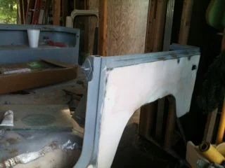

Skim coat and air filed. This sanded through in some areas

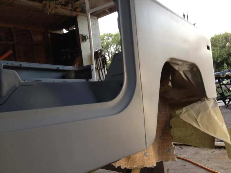

I sprayed epoxy then topcoated with high build epoxy

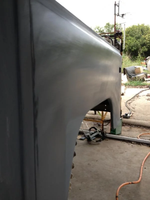

Blocked to 400.

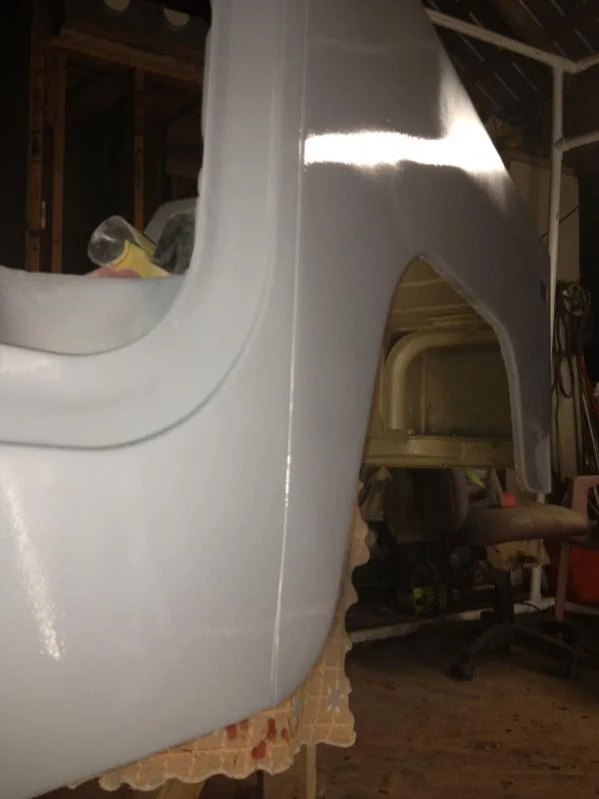

Topcoated with epoxy. I am going to sand one more time to a fine grade and topcpat with epoxy. Reduced 10%
