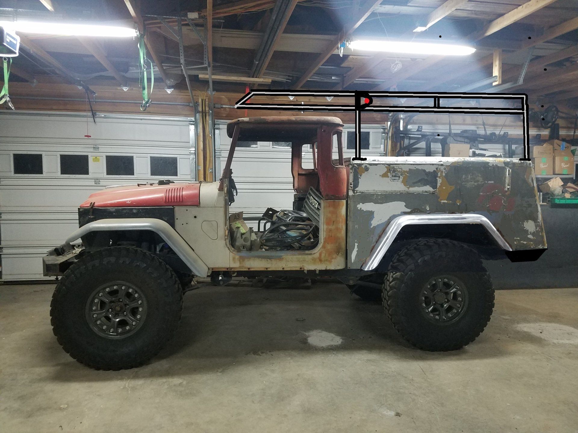

This is nice , perfect for expedition .
it could be nice with a tube rack , with a foldable over the cab section if you need acces to remove the top
Jim,
I had not considered extending the rack over the cab because I want to be able to remove the top. I will have to consider an attachment that can be retracted, hadn't thought of that. I am planning a rack over the box to support a hard sided Roof Top Tent. Although the box offers a lot of storage already so I am not sure if I need the additional room over the cab. I will keep the idea in mind as the build progresses. Thanks for taking the time to illustrate the idea.

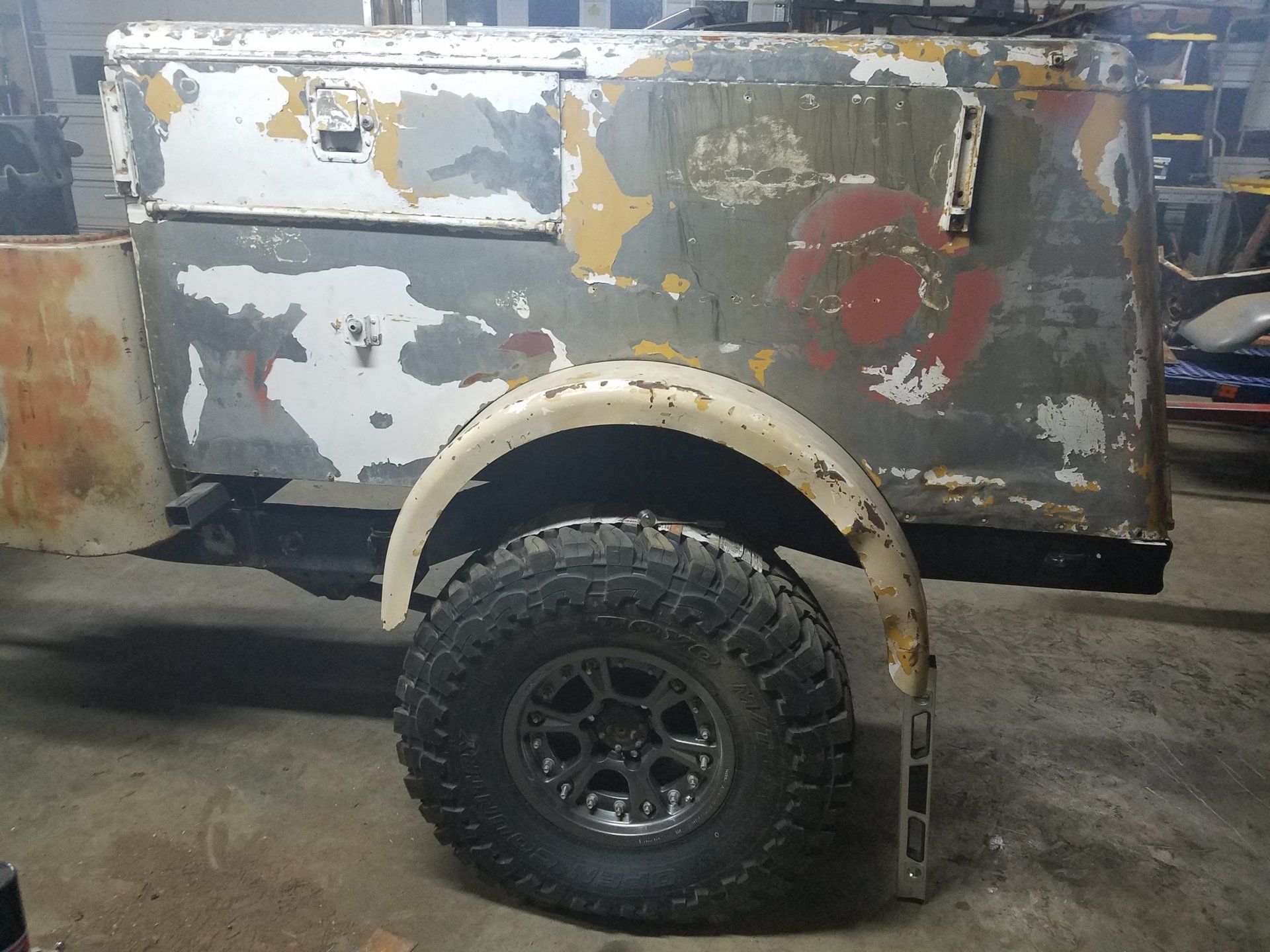

Since I have more time to think about this project than work on it I have been pondering the best way to fit the box. Originally I was just going to cut the fender wells and move them forward about 5 inches centered over the axle but this would require me to significantly alter the utility box door on the passenger side and I would lose the lower drawer use in that compartment.
I am now considering extending the frame five inches to center the rear wheel under the wheel well. The frame extension would also reduce the amount of over hang from the rear utility box. I would prefer to cut and extend it at the front of the rear control arms so I can keep the factory suspension the same. If I go this route I would have it done by a professional shop. The frame would get extended about 5-6 inches.

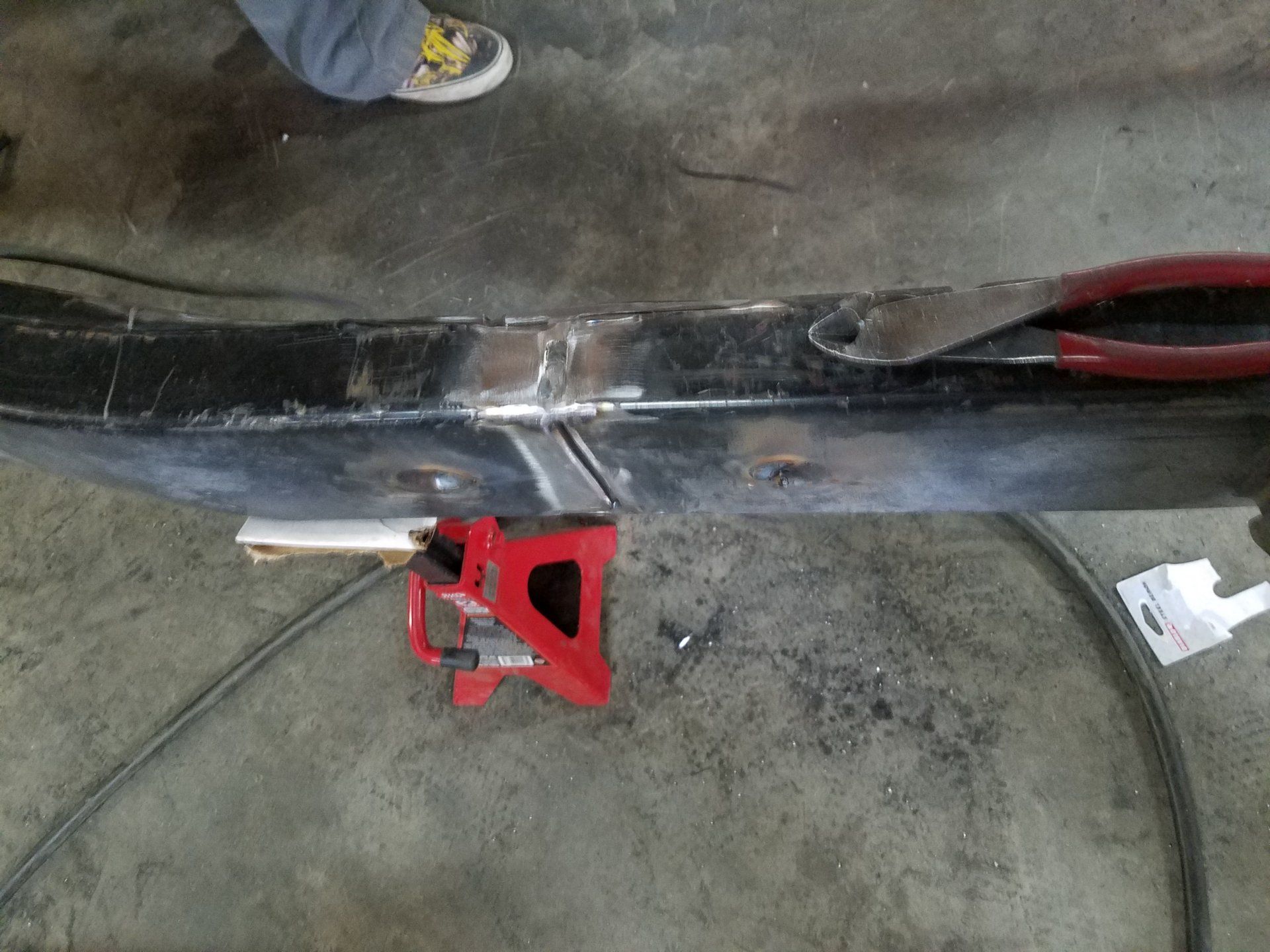

I decided to lengthen the frame 7 inches to accommodate the box.
I didn't want two cuts with a splice piece in the middle so I sourced a second 80 frame.
I had to part this out to get to the frame. Most all of it has lived on in another cruiser even the body.

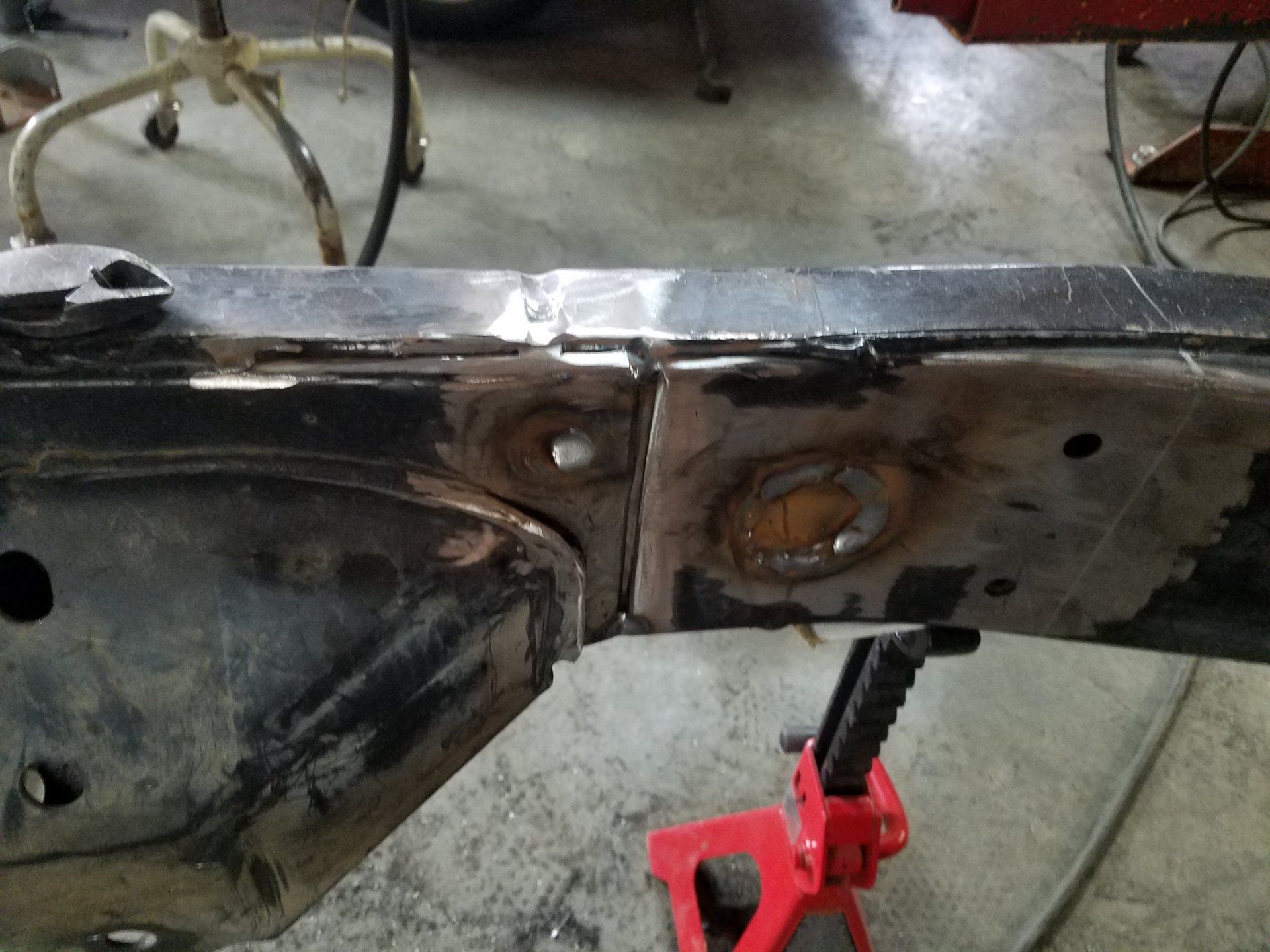

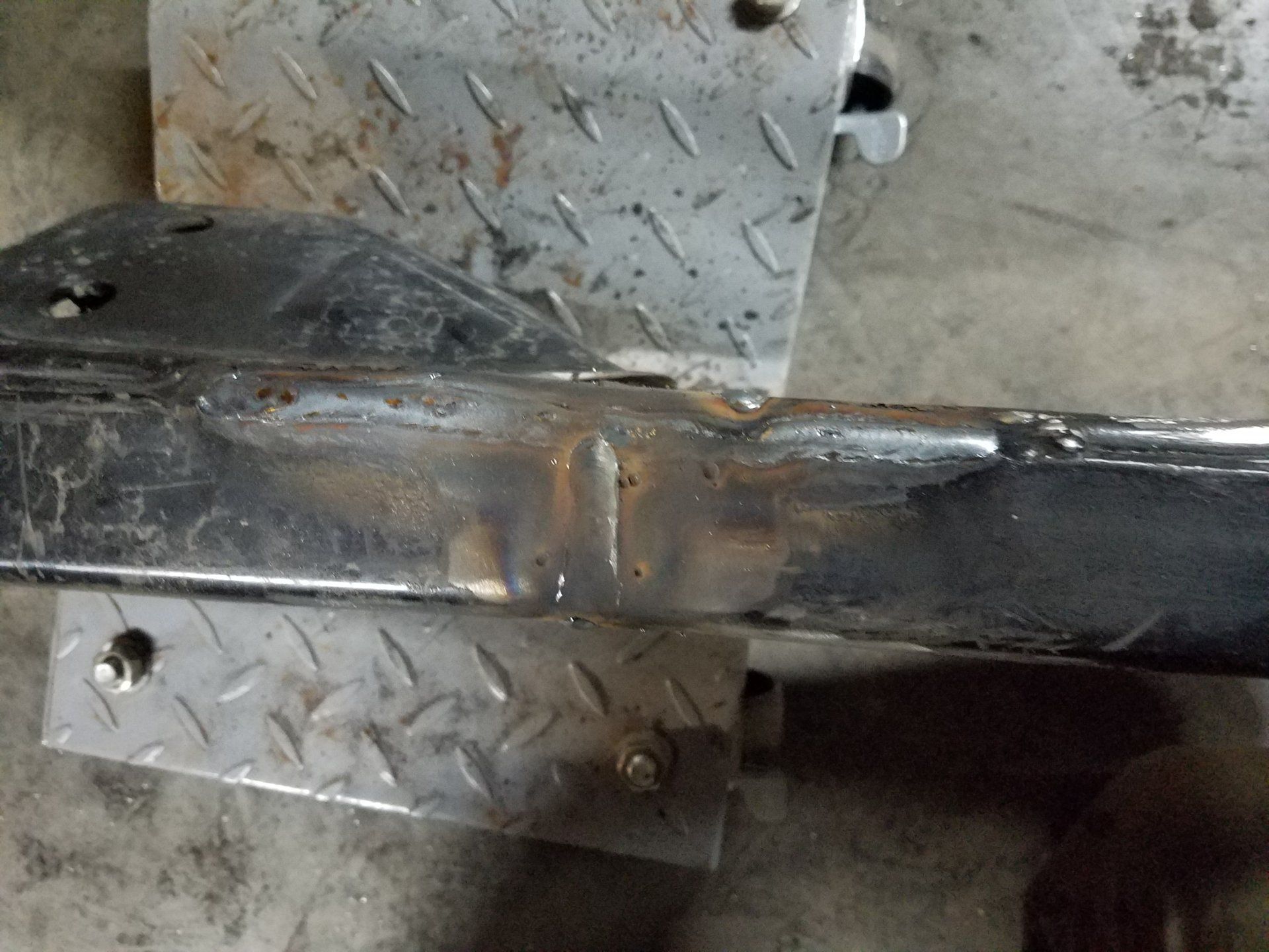

Got down to the frame and made my cuts in the flat strait section at the rear long control arms. I offset the cuts a little but tried to keep one set of the control arm mounts intact. I had a machine shop build a set of 14 inch heavy duty sleaves boxed sleeves that were welded in on each side with large rosset welds and then around splices.
Test fitting the sleeves.
Joining the two pieces. I bartered some professional welding skills for this job. I have no doubts it is stronger than factory with the sleeves inside it. We did a lot of measuring and rechecking as we welded it up. The measurements are nice and square.
Here is where it is sitting now. Just need to fit the box mounts. The box factory fenders mount very cleanly to the box so I am planning to use them. I will end up altering/fitting the front side of the fender some but I think they will work out nicely.

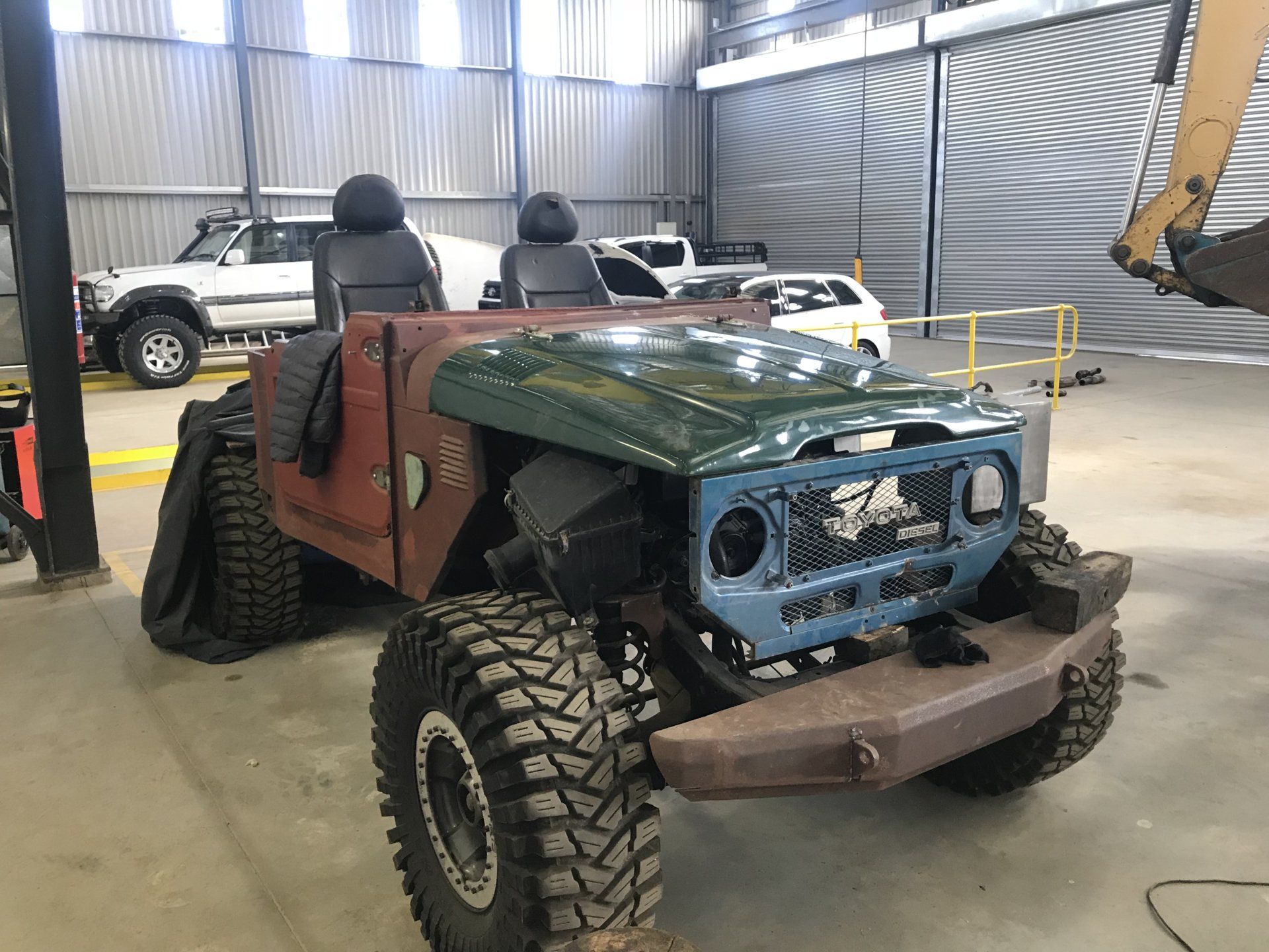

This project has been so slow going that I was feeling a void without a cruiser to drive, so I made a purchase. I picked up this very modified FJ45 SWB from another forum member. There is a lot to like about it and a little that is not appealing but overall I am happy with it. I have some plans for it but they will have to wait. I just want to drive it for now. I didn't like the Iroks, so sadly the first think the little 45 did was steal it's big brothers shoes. That is just temporary until I figure out what wheels to put on it.
