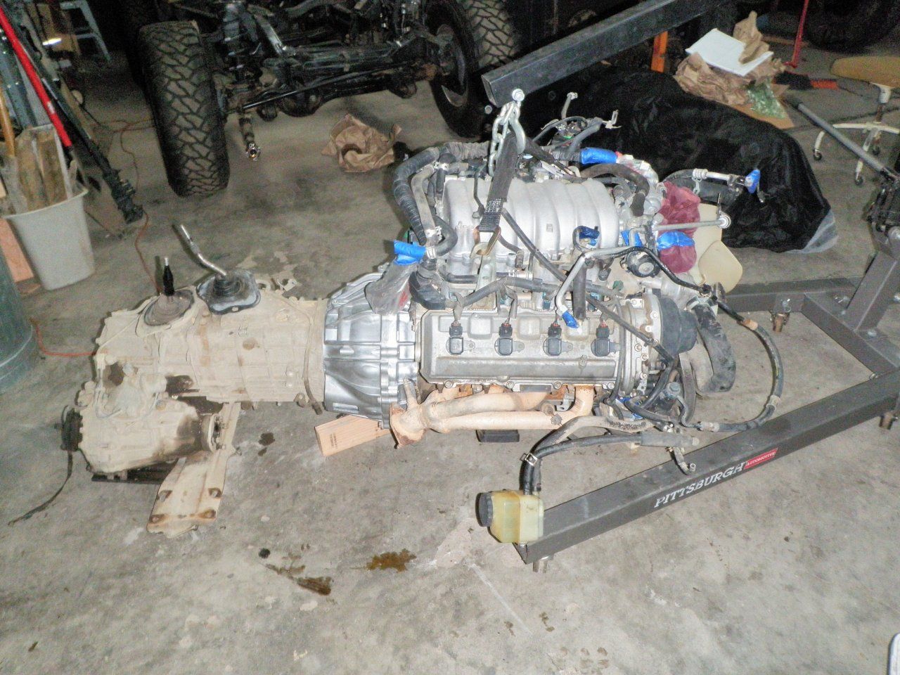

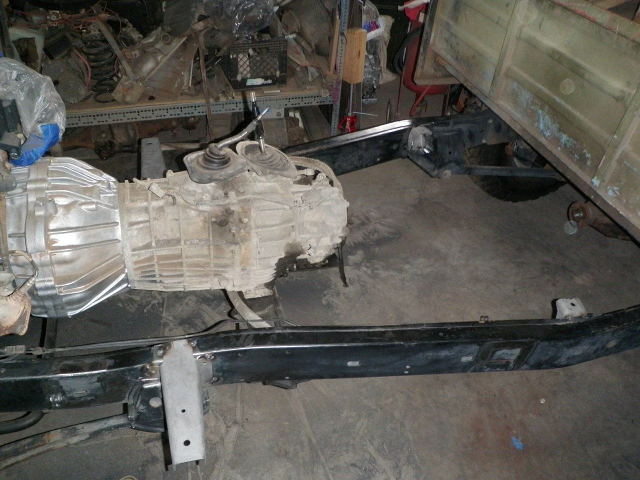

I pulled the h151f and hf1a combo out of the 80 series and mounted it to the 2uz with a new two part bell housing. I still need to purchase all of the clutch guts and a new input shaft because the current shaft is not long enough. I bolted it together so I could start fitting it in the chassis. I had cut the chassis motor mounts off of the Tundra before I got rid of it and was able to use them with the motor mounts from the Tundra, and motor brackets from the 100 series 2uz to mount the engine on the 80 chassis. I was able to use the stock location and cross member for the transmission. The 2uz fits nicely. I am a little concerned about the lack of space between the hood and supercharger, I think it is going to be close but I will deal with it when I get to it.

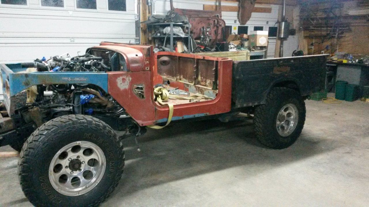

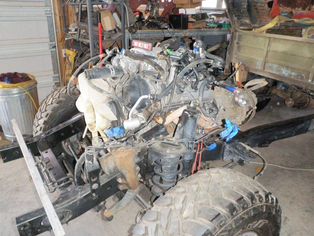

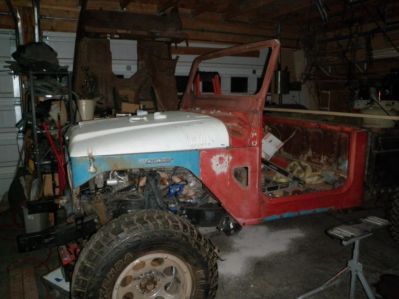

I have started working on the tub placement with the engine in place. I test fit it the tub before I finalized the motor mounts to make sure it would work. I am just fine tuning it now before I place the body mounts. I am trying to use a 40 series cross member to mount the bib to and i think it might be a little more work then just building a cross member that fit the space need. I like the original look though so I am willing to give it a try. Everyone likes pictures so I have added some of the project
It could be because your photo is at an angle, but it looks like your front axle sits too far back. If that's the case, when u bolt the fenders on it will be very noticeable. Redline's 4 door 40 on the 80 chassis have the front axle too far back and it looks funny. I would have just used the stock 45 chassis personally and just swapped the axles and suspension from the 80. It seems like a ton of work from other threads I've read through to squeeze the whole 80 frame in a 40 series body. Personally I think the front axle looks best 1 or 2 inches forward of the stock position. Going back from stock looks like it was in a wreck and never repaired right.
On mine, I ended up sticking the face of the 40 grill as close to the 80-series steering box as possible. That gave me enough room for a 40" tire to go lock to lock at full metal bump.
Thanks for the supportive comments.
In the picture the way it was mocked up I believe the axle was about 1 inch to the rear of the center of the apron. That was the first go at seeing where the body would set. I am planning to at least have the front axle centered or slightly forward in the wheel well. I will have to see how far that will be after I determine the best placement for the cab.
I chose to use a fj80 chassis for my build for a number of reasons but the first was because I didn't have a 45 chassis to start with. I have previously owned 40 series and 80 series landcruisers and I like the way the 80 series handled both on and off road. I like the factory suspension on the 80 series and the full boxed frame. The stock 80 is already very capable and the availability of after market parts is a plus. The 80 series chassis was also a lot more affordable and easier to find. Knowing my own skill set I feel like it is easier for me to fit the 45 body on the 80 frame rather than trying to transfer the 80 suspension to a narrower frame. I do wish I could keep the stock width look but that doesn't seem possible so I am planning to widen the front fenders and add aqualu fender flares to the rear.
The bib as pictured is around 3-4 inches forward of the steering box so I still have some room to move it but I am trying to keep enough room for the fan and radiator in front of the motor. I am looking to use a 40 series cross member in front to support the bib and try to give it a little more of the stock look.
I just put the engine where it needed to go. I didn't have any stock toyota stuff for that. Did you use the stock transfer case position?
That "stock transmission/t-case cross member" is what I am using as my starting point as well. I just put the motor in and have been trying to fit everything else around it, so far it seems like it will all work pretty nicely. I found that the H151f is about 4" inches shorter than stock auto transmission and the rear output on the hf1a t-case is a little shorter than the hf2a t-case. The shorter transmission pulled the motor back more, not that it creates any issues. The 2uz leaves a lot of room to play with compared to the 1fz I started with.

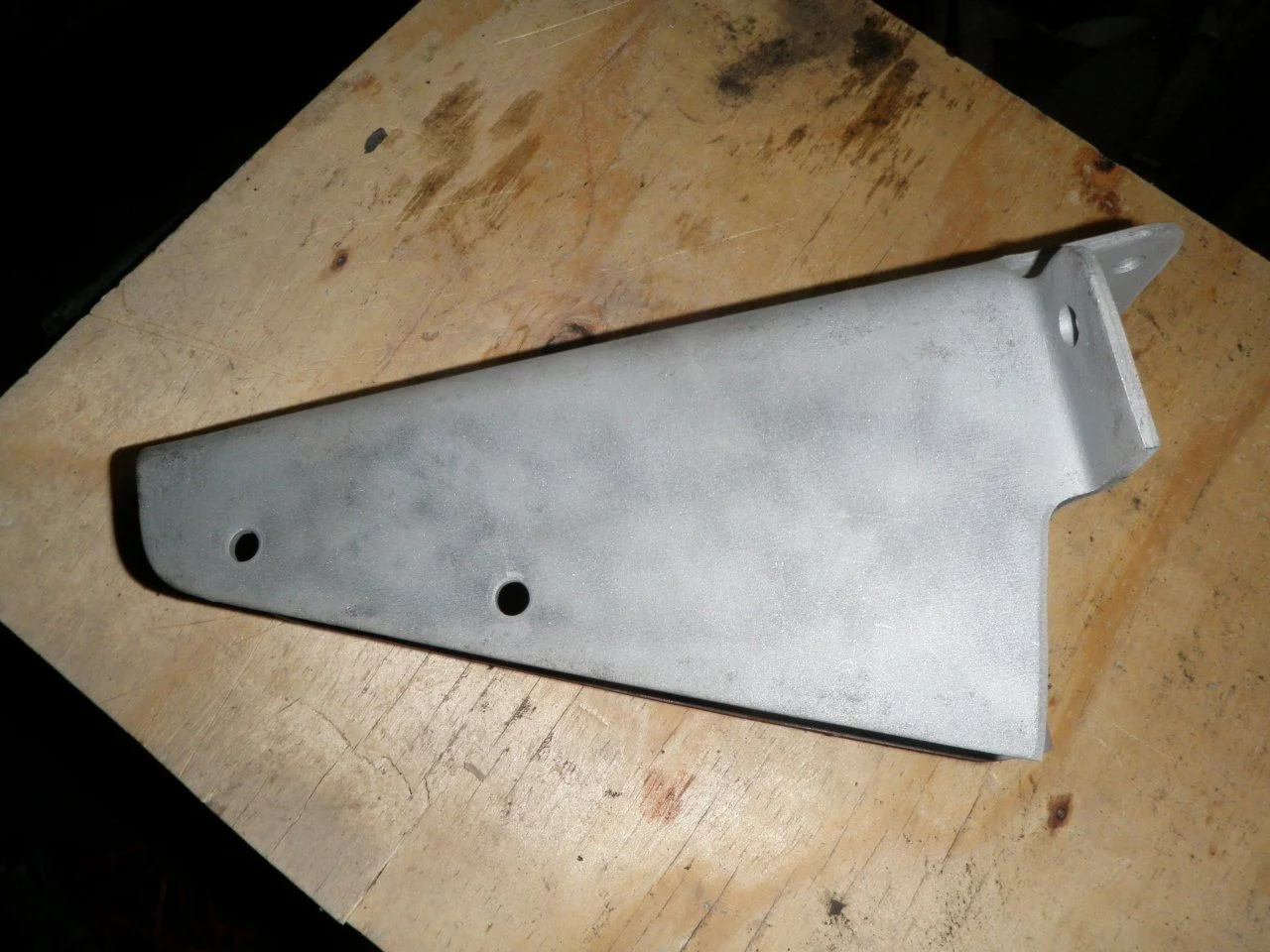

I have not made a lot of progress but I did tac on the tub mounts. I repurposed some fj40 mounts. The front and rear mounts sit over the control arm mounts so I had to notch the front mounts to fit the contour of the control arm bracket. The rear mounts I cut and formed to fit the contour of the control arm bracket also.

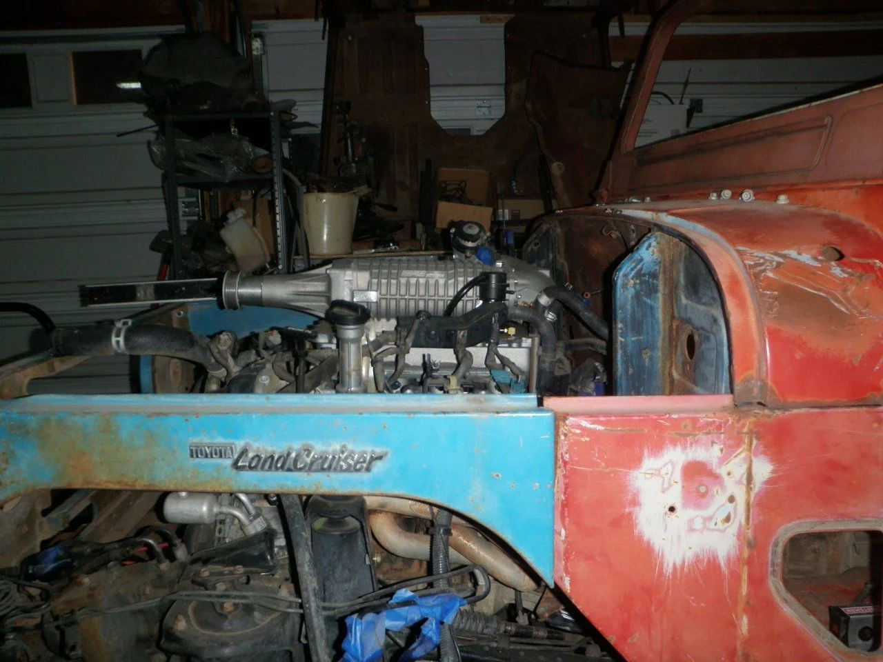

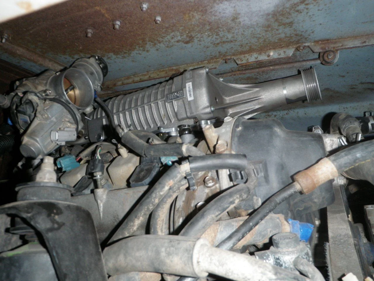

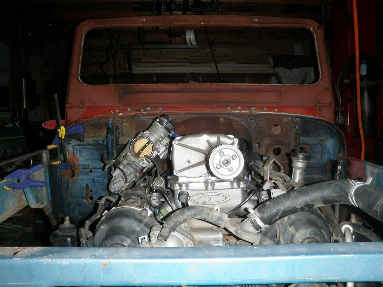

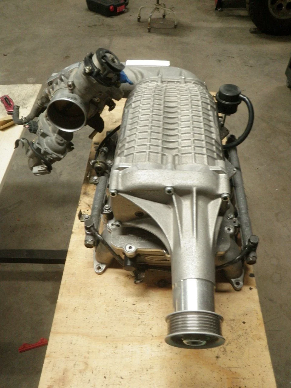

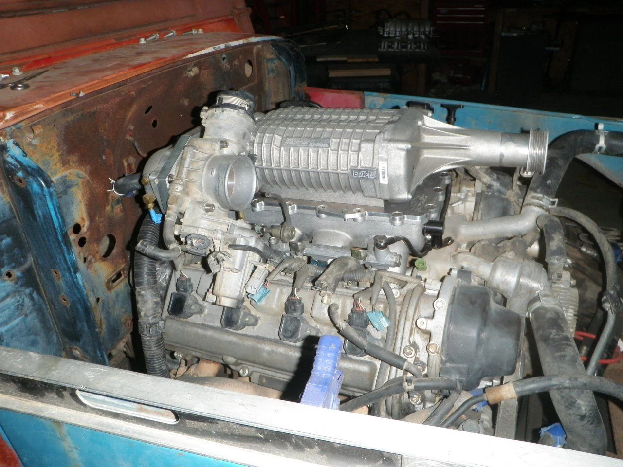

I set the tub back on the new mounts and have started trying to figure out where the bib cross member will sit. I started working through it and realized the supercharger sits higher than the stock intake, so I decided I should test fit the supercharger to figure out if there was going to be any clearance issues with the hood.
The bullet supercharger was made to work with the drive by wire throttle body but I am planning to use a cable operated throttle body. I had to have an adapter made that would allow the throttle body to mount at an angle. This added some additional height to the SC setup and put the throttle body really close to the hood. I just installed the SC on the engine tonight and have not had a chance to put a hood on to see if it clears. The nose cone pulley might not clear either as the hood slopes down. I do not want to raise the tub any higher. I could lower the motor more but it would make servicing the alternator tougher. My hood is tough to get to I will not get a chance to get to it until Sunday maybe.
Anyone see anymore issues I might have missed?
I set the hood on it tonight and found the SC does not touch but it is very close. I would feel better with a little more clearance. I am think my best option will be to lower the motor an inch or so as long as I don't run into any clearance issues underneath. It is cold in the garage tonight so I will likely wait for a warm weather window before I get to it.
