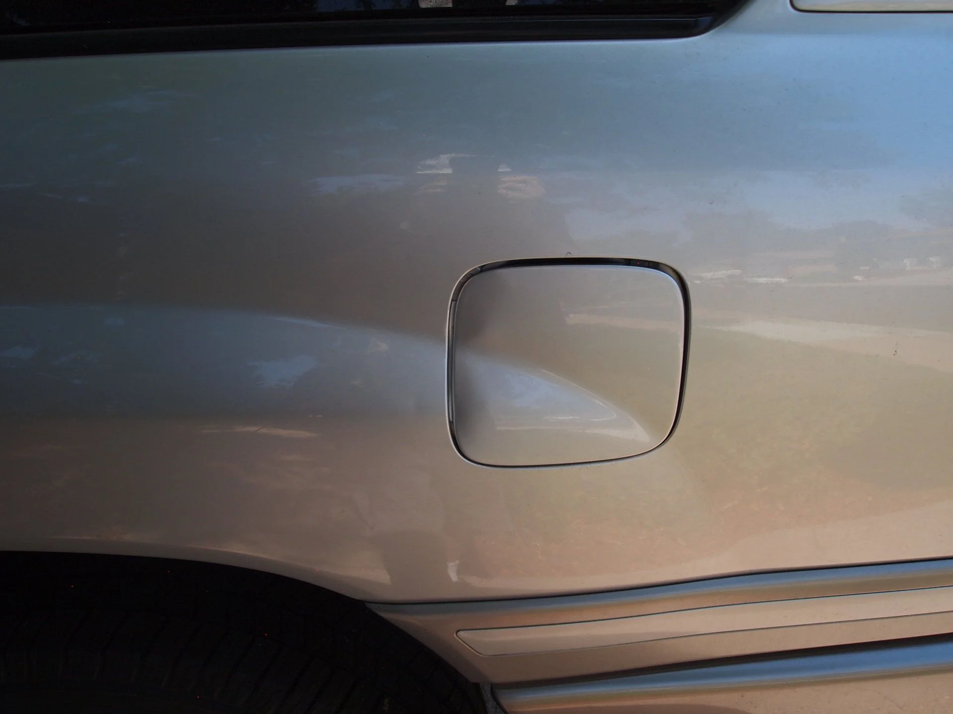

Body fuel door.
I've been looking for this used, to color matching. I have a new OEM, but it must be painted. To paint this is a big issue. As matching color is not possible. So I just need to find a Classic Silver (1F7, 06 or 07 Land Cruiser) being parted. Tomorrow I'm going to a PDR (paintless dent repair) to see if they can make it look better. Sooner or later a used one will show up. I had similar issue with The Whitelady (01 LX470), where it took 9 months to find a white hood locally.
Used will give the very best color match. I've spend ~12 hours on this to date, still no good solution. So will see how PDR does.

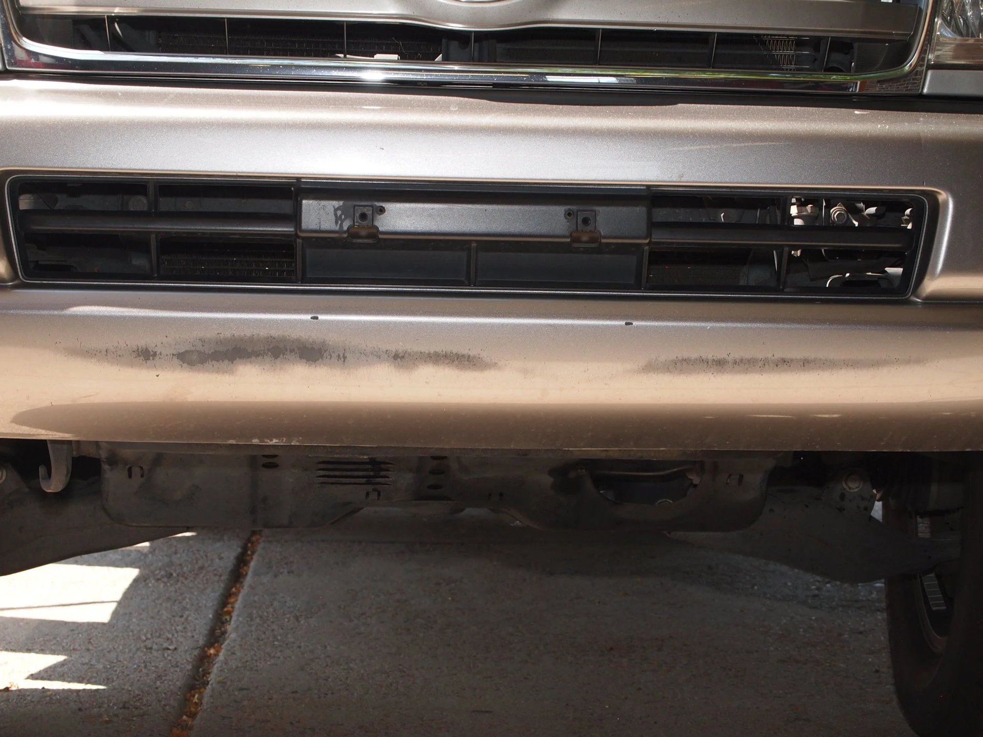

Anyone know of a front bumper skin 06-07 Classic silver (1F7 body color, bumper is 1D2 Thunder cloud Metallic) around?
I know someone has lying around after putting on there iron bumper.
The transporter from GA had bumper riding on steel plate at front of his trailer, rubbed the paint wrong:mad:

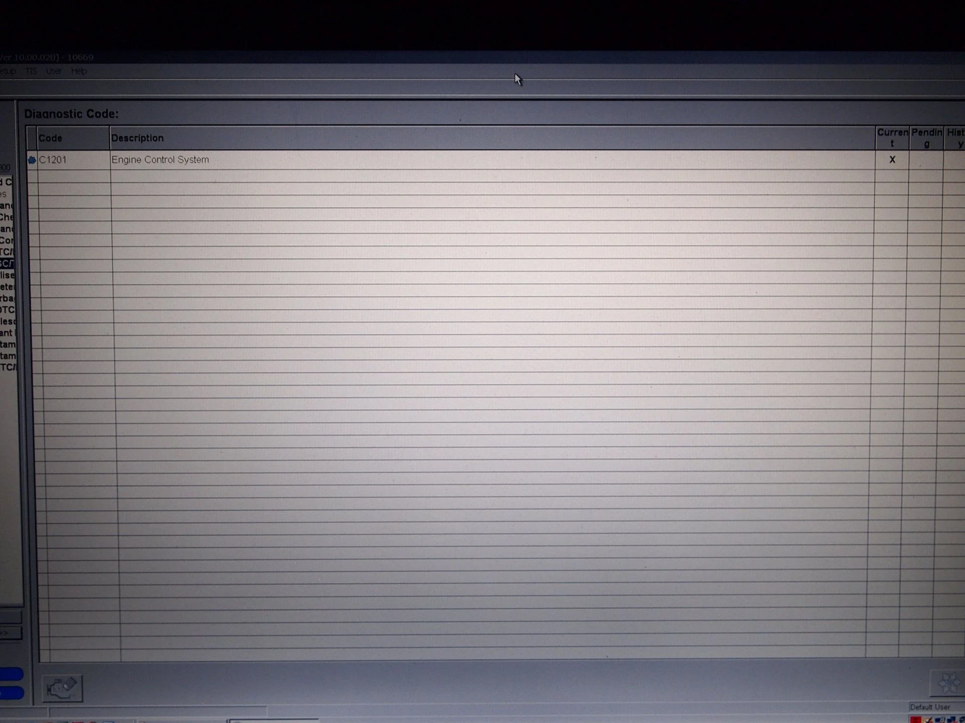

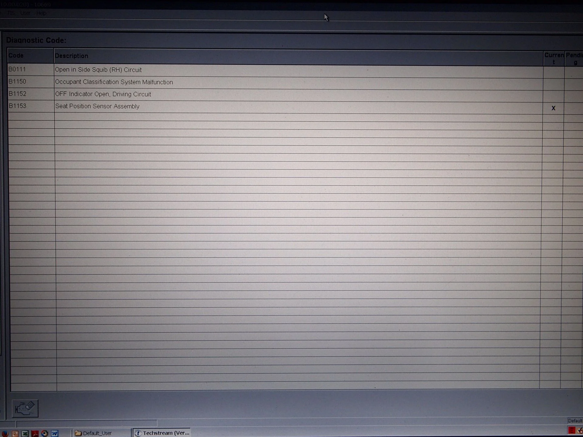

Running rough (bump) but no CEL on dash or DTC in tech stream!
So I was driving across town to look at some running boards (RB) with AC on and OAT of 88 f. While sitting at a red light I felt a bump then another. It felt like AC pump cycling on then off twice in a row but with a kick. I'm thinking a possible issue with AC compressor. So I turned off the AC. Nothing happened again until after I'd parked engine off, while I looked at the RBs. After loading up the RB's and again while stopped at a red light AC off, I felt a few bumps in a row again. RPM dropped a bit to ~500, then picked a bit high to 1K and steadied at ~600. I slipped into N and all seemed fine.
Since AC was turned off and bumps came back, AC is no longer a concern.

So this meant I needed to get my mine VCI cable working. It had been give me issues disconnect then not making connection sometimes asking for password a real PITA. So I uninstalled the software and reinstalled starting with oldest version, then bring update to newer until it worked. I'm now thing it's not a software issue, but a bad mini VCI cable. Tool issue :bang:
Anyway I did get my ATF temp read out after turning tech stream on and off repeatedly. It was necessary to shift between gears and load engine/transmission by holding brake as I raised RPM while in gear. Finally reaching the required ATF temp of 115 F (116.5 f) I pulled the transmission fluid level plug. Nothing came out so I added .4 qt and retested. Now ~.2> qt came out. So I was just a tiny bit low, certainly not enough to cause any damage to transmission from my test drives.

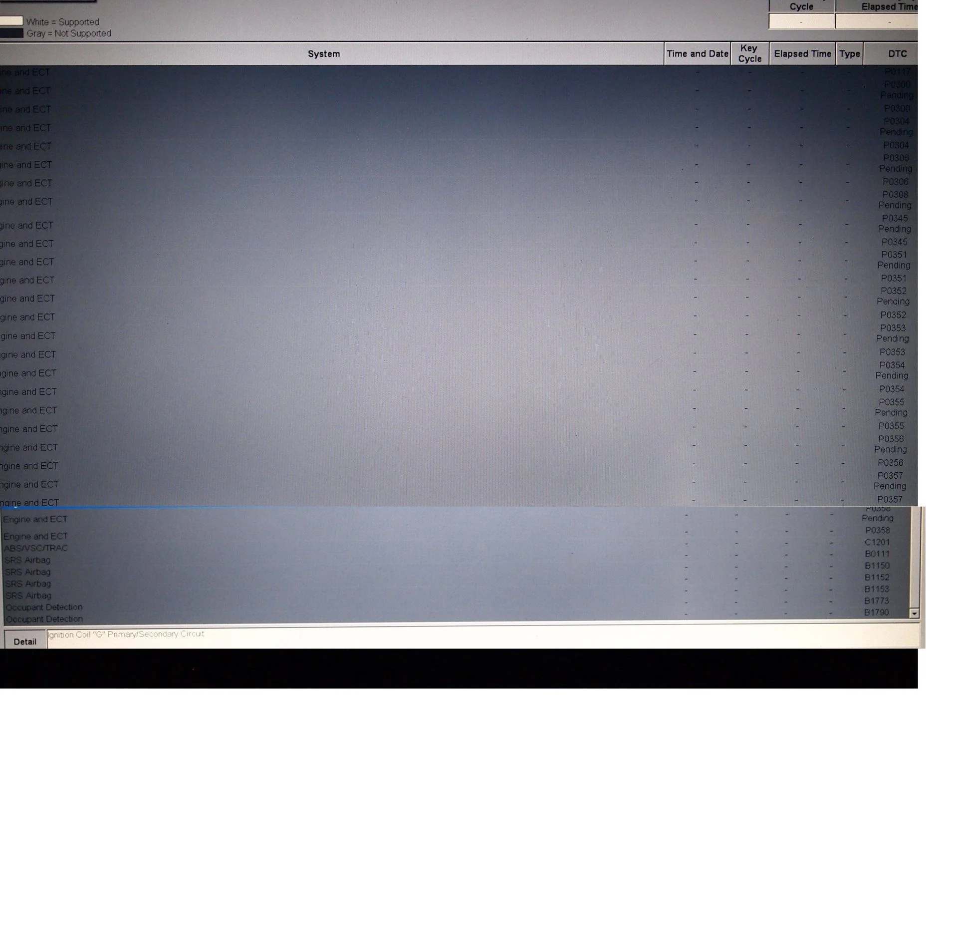

While loading engine/transmission while in gear I spotted #1 cylinder indicating a miss-fire with the associated bump.:hmm:
I suspect a weak coil. I didn't get a CEL or bad coil DTC, only a miss fire while under load.
To confirm it was a coil going bad and not some other issue like compression, fuel/air, ECM or wire harness issue I swap #1 coil with #3. Fantastic, miss-fire moved to number #3 cylinder now. I grab another used coil of the shelf and installed it.
In hindsight, I did have other indications a coil was going bad. i.e. fuel smell and oscillating sound during idle. What I first thought was possibly due to excessive idling, which is not recommended but necessary when working on engine, transmission and AHC testing. I noticed idle was not as smooth, more of a oscillating sound then steady as I like to hear, which became more noticeable with time. Also I noticed a raw fuel smell that was getting a bit heavy in the shop while idling over time.
If the budget allowed, I'd just put in all new coils at this point. But until a DTC states bad, they're considered serviceable. Same is true with A/F (front O2's) and O2 (rears) sensors. They are consider good until failure. But, IMHO they weaken with time and do not perform at peak through their entry life.

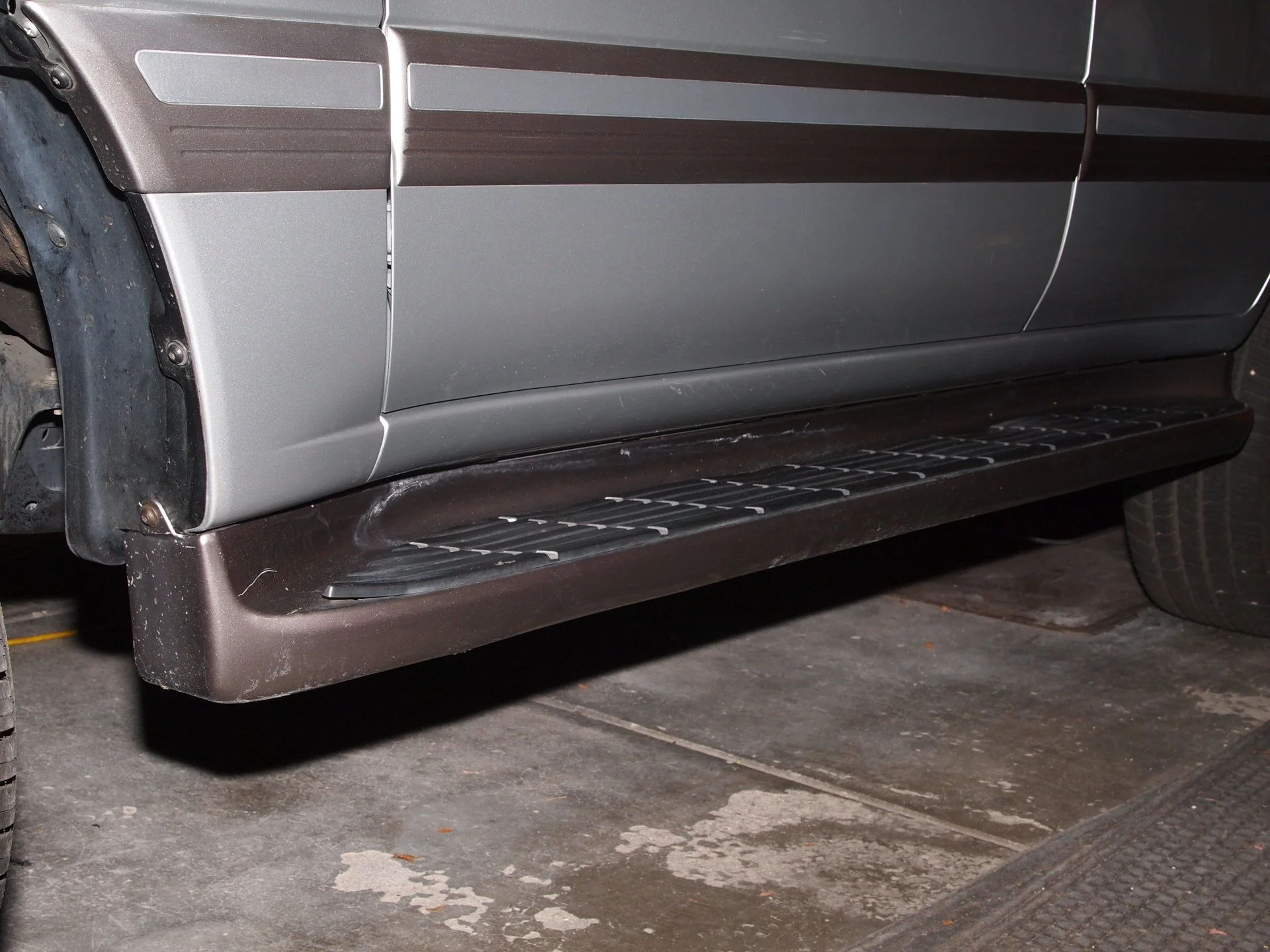

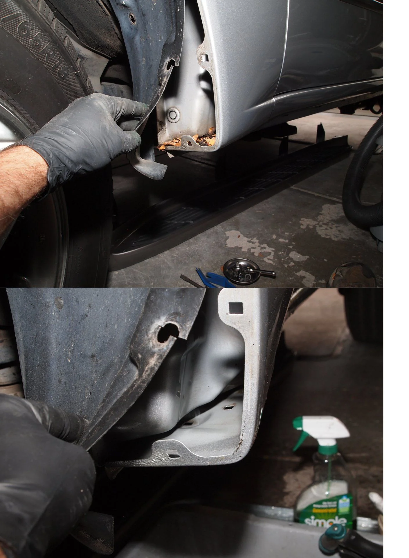

I found some running boards with a perfect color match 1D2 locally. Boards were missing bolts, nut and front screws. I found all except nuts in my loosen bolt box. Picked up some nut from ACE, and boards are now on. I know many like look without, so do I. But I like to step up to roof and protect side from rock chips from tires.
Before adding running boards I clean out the leave traps.
Need to clean and buff but looks good.

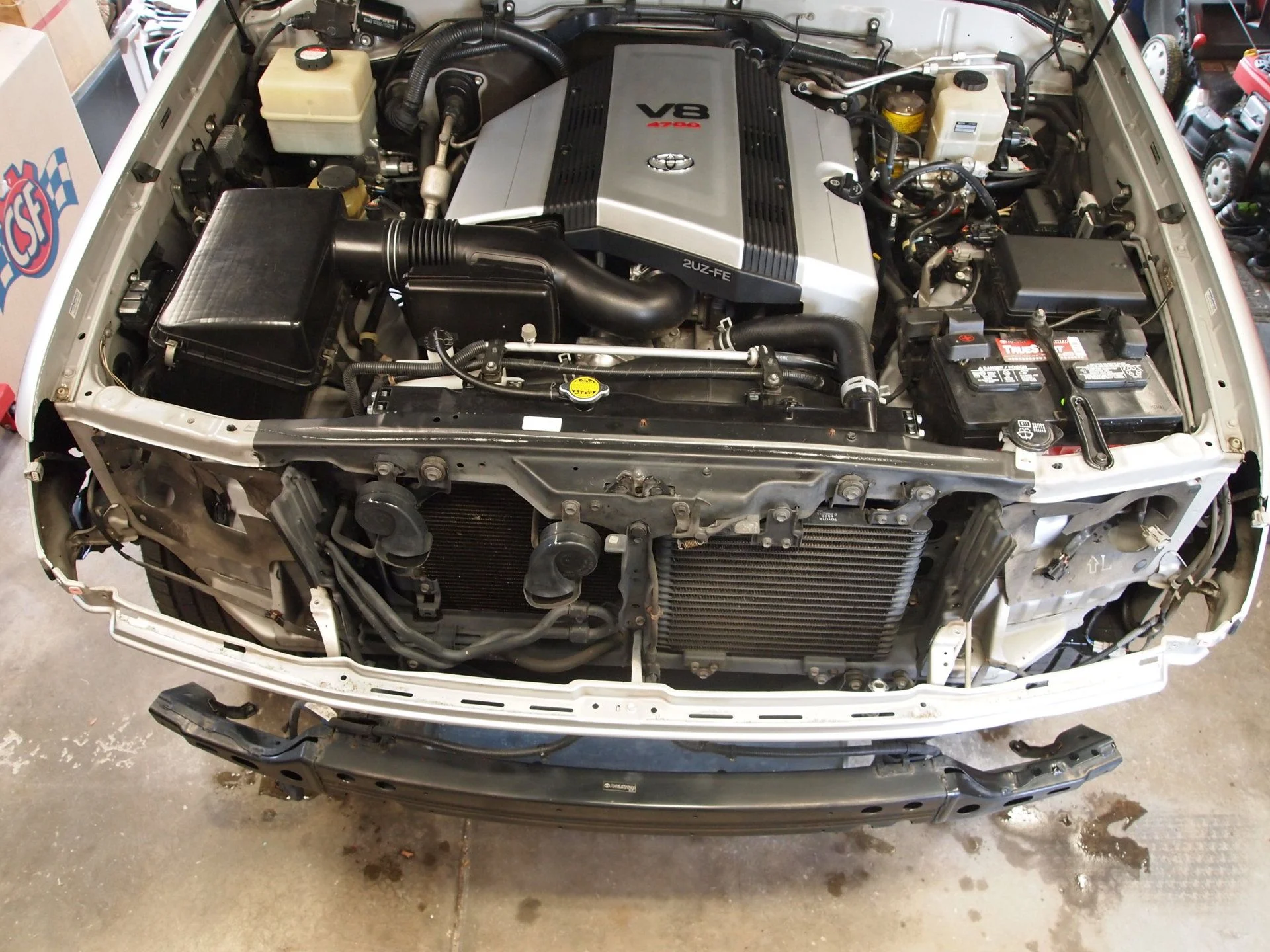

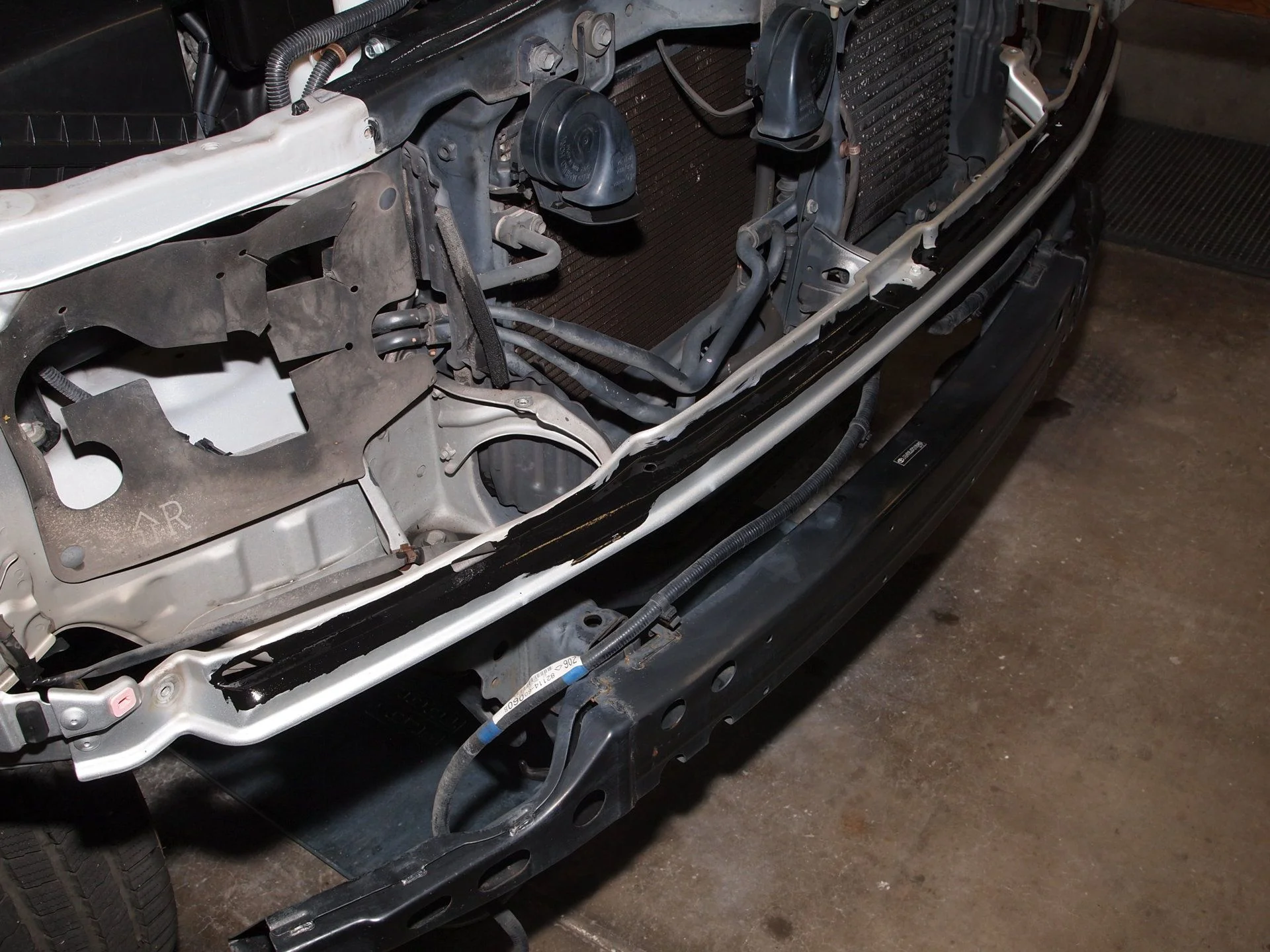

While bumper skin, off I painted the upper bump support as a PM with POR-15. This area like the lower windshield mold gets grit acting like sandpaper. The POR-15 should protect. A lite sandand cleaning with paint prep the paint.

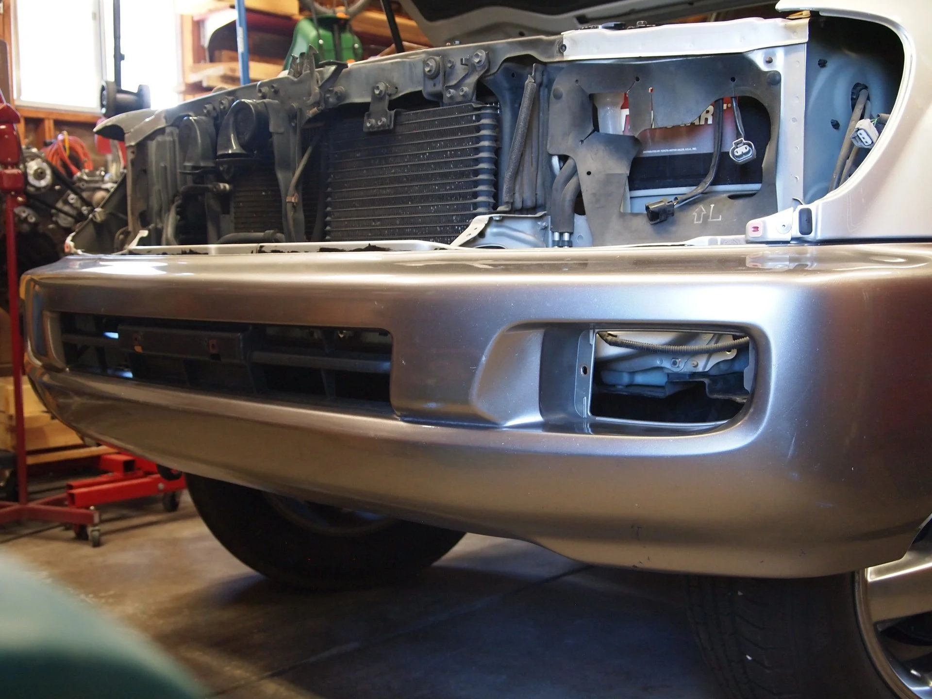

Then I remember I picked up a front bumper passing thought Salt lake City ~6 months ago. It match and fit as well. Sweet!
Paint condition of bumper skin and running boards is ok, not perfect. I suppose better than one would expect for age.

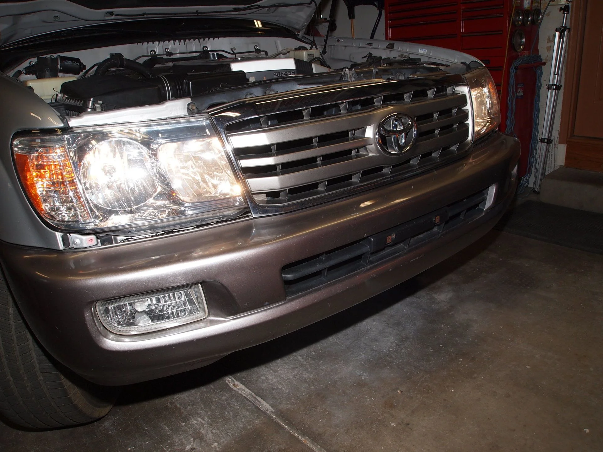

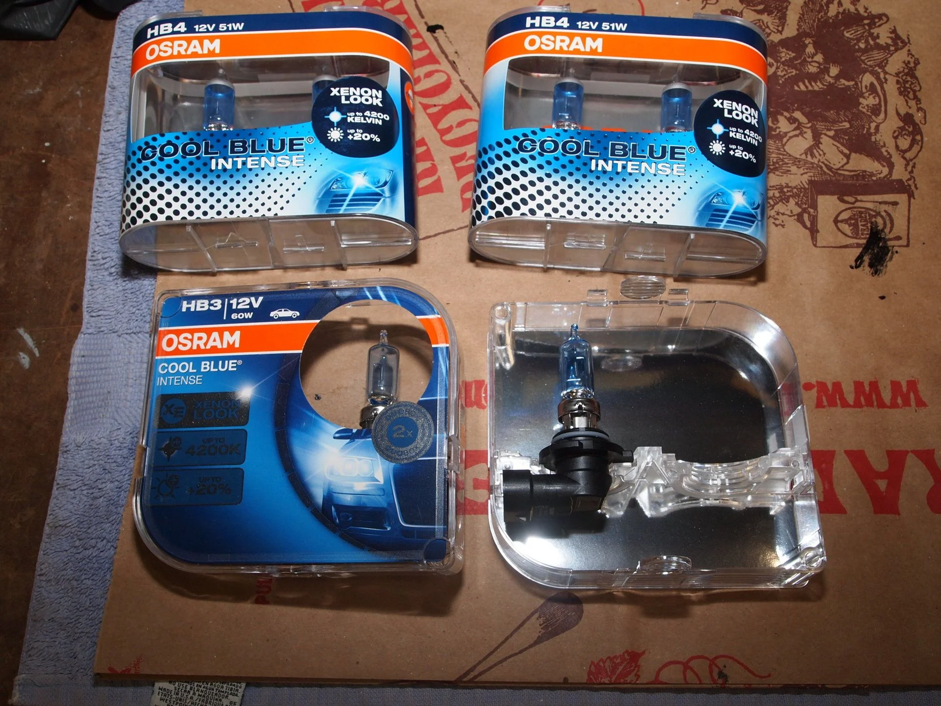

While headlights out I replace Bulbs (Low beam, Fogs, High Beams). This is a set @benjawi4 gave me for payment of work I did on his rig. I've never tried this brand, should be COOL...Blue...LOL
I just saw this. I was peeking behind these on my truck today and they were half packed with dirt and leaves. I had no idea these were collecting debris.
BTW The OSRAM light bulbs are excellent.
Yeah the front fender "leave pocket" have plenty of small water drain holes, just not large enough for debris to fall out. The debris collects and holds in the moisture. So cleaning once in a while is worthwhile.
Tried out the OSRAM, not bad. I just got back from short drive on HWY. It was nearing dusk, so still fairly light out. I hit the high beams, man they really illuminated all of the road signs and in daylight...WOW. I could have used these on my trip back from CA. You could really piss off oncoming with these!
