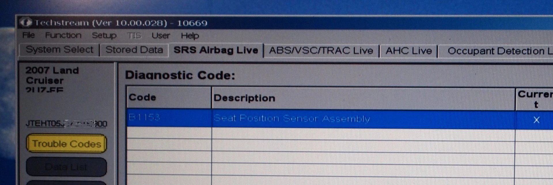

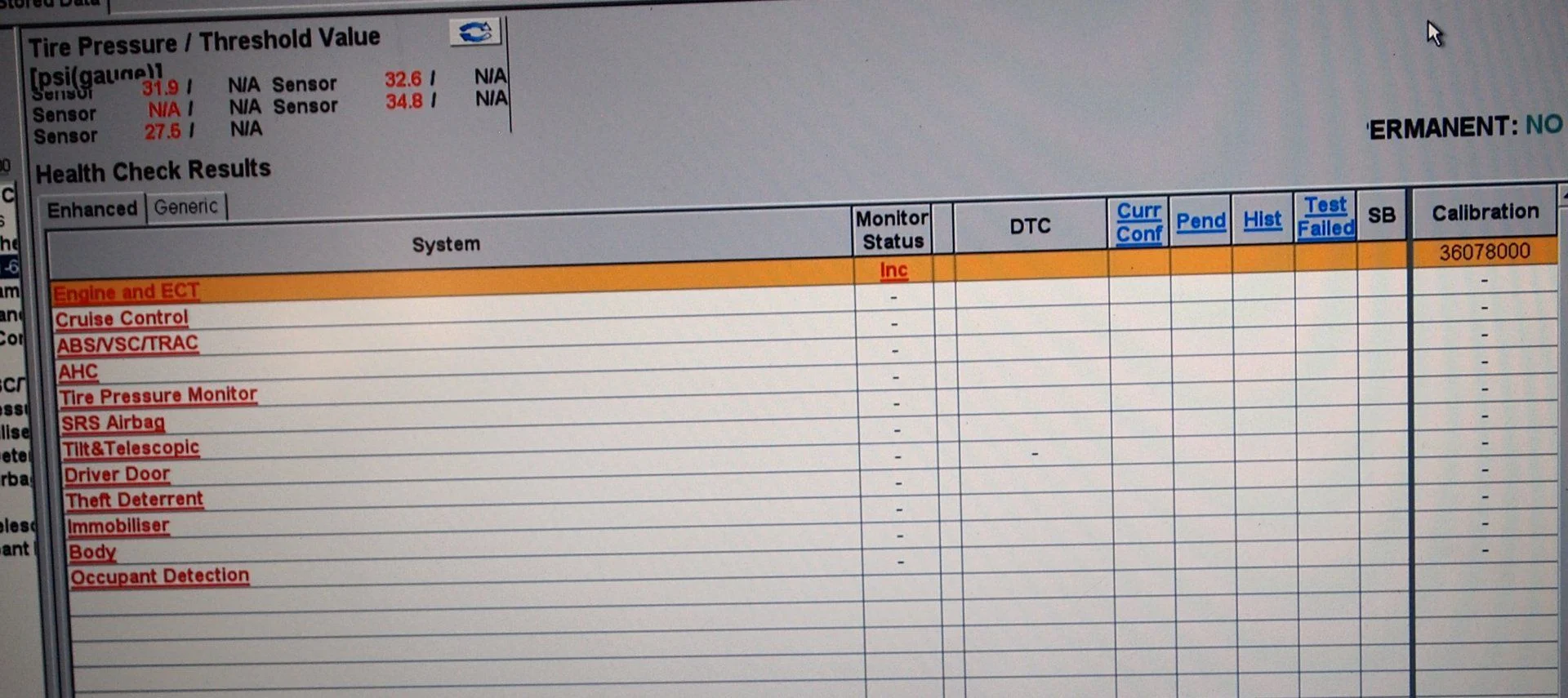

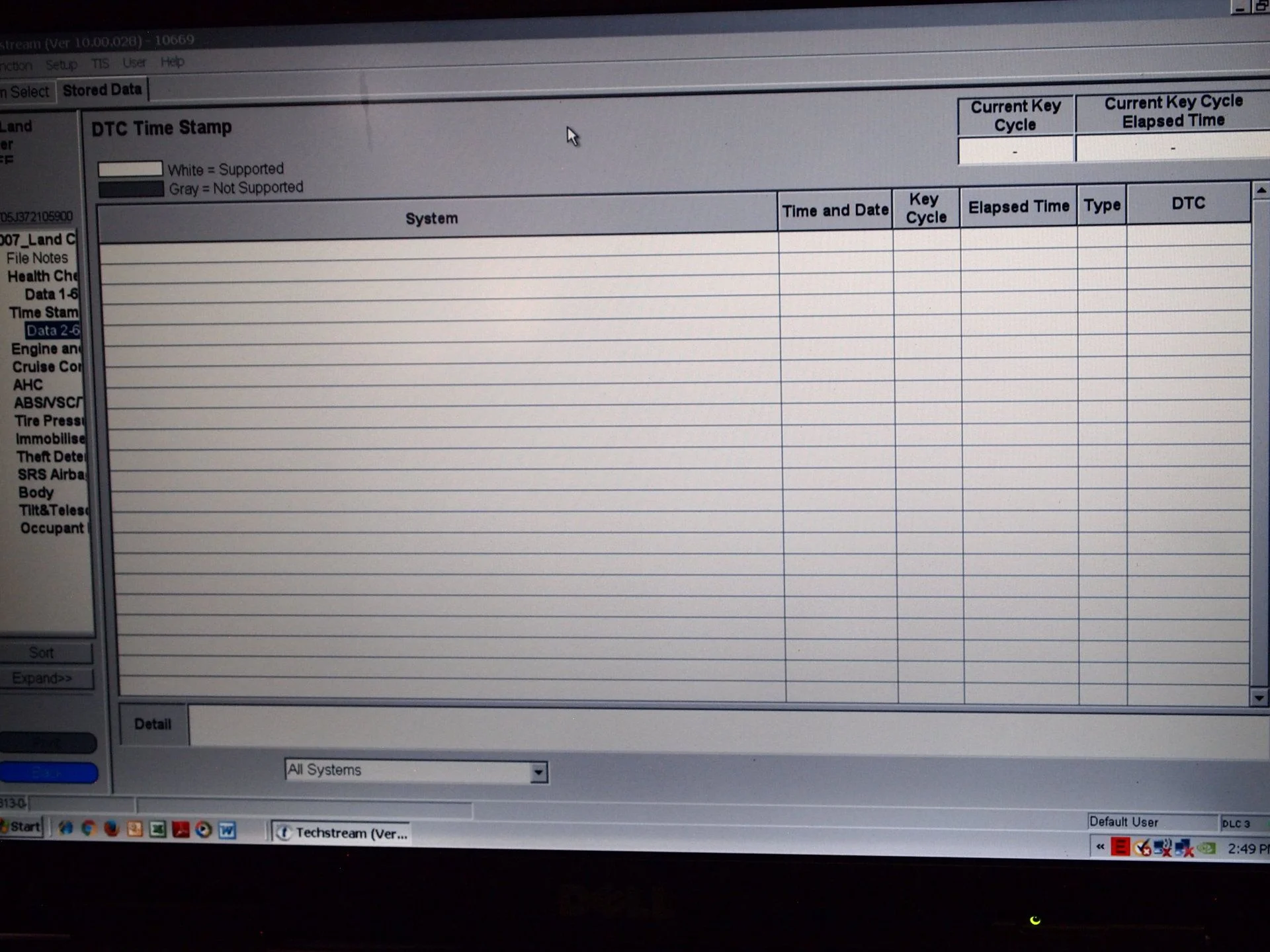

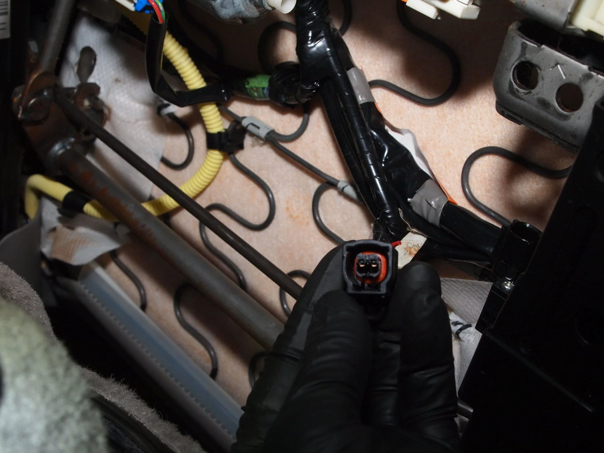

B1153 DTC. I had one last DTC to deal with; "seat position sensor assembly" wire repair.
The airbag SRS dash light would not go off. I checked DTC's and found a B1153. In looking at my original long list of DTC this one was there. But was it there because some other issue, or was it the switch's wire all along, IDK. But for some reason the red wire was broken away from switch housing that plugs into seat position sensor (driver side outer switch). In searching mud I see others have had this issue as well, and mostly this red wire. The wires have very little slack and will move a little each time one sit in the driver seat. I suppose it just wire loosen over time and eventional breaks away from terminal. My Toyota Dealer keeps many terminal with pigtail on hand, the housing is special order. I decide to see if soldier would do the trick, it did. It may have been better to just replace both wire terminals adding some length, but only time will tell. So if air bag LIGHT COMES BACK ON, this is first place to look.

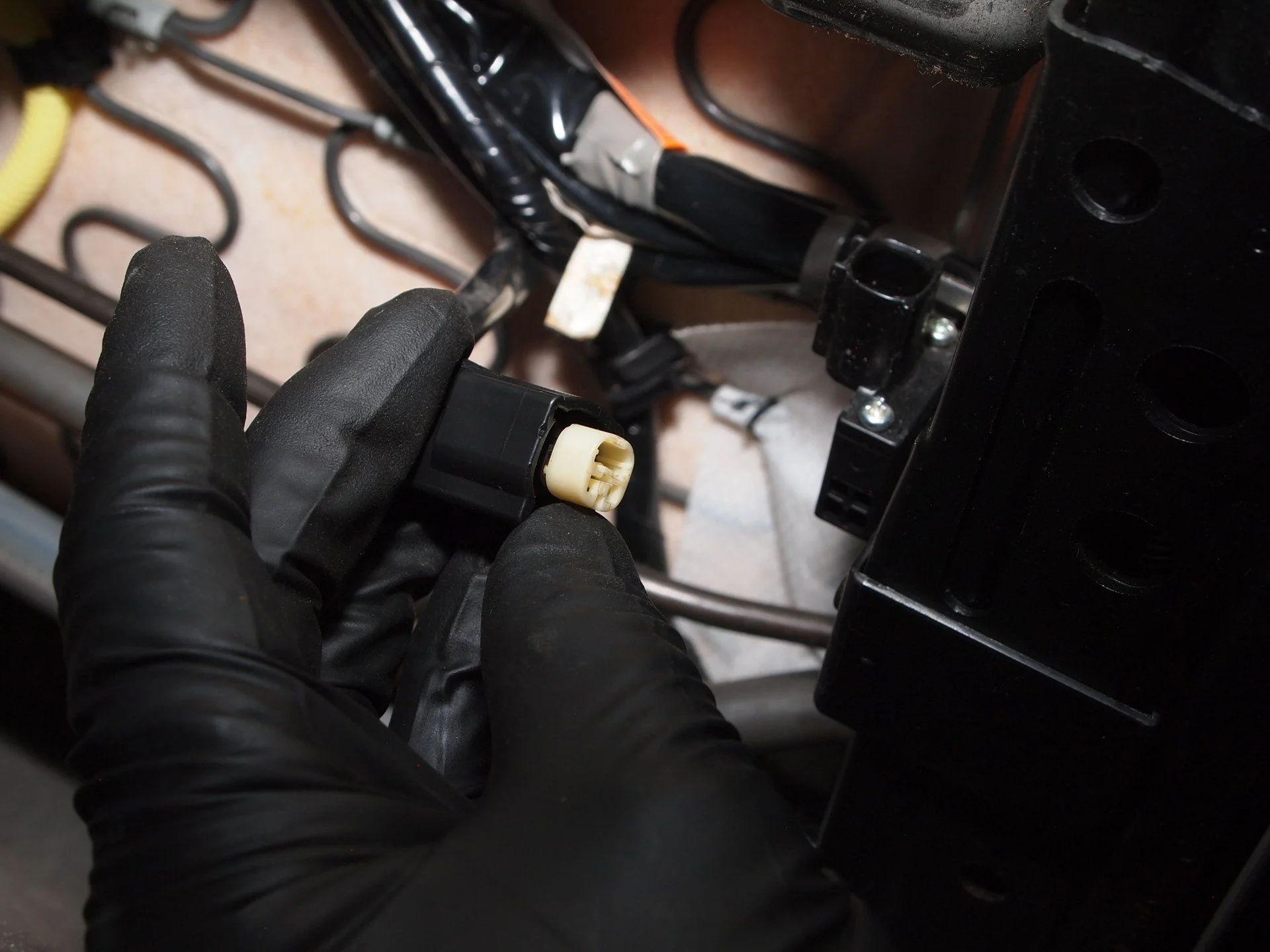

Like all wire housing I've come across, a plug must be pulled from center. This releases lock of wire terminals from within. The trick is then seeing how it's locked. In this case there is a small plastic catch half way in, that I used a needle to hold out as I pushed terminal through (out the back side).
After soldering, I plugged housing it back into Seat Position Sensor.
Each time we sit in the driver seat, the cushion springs push down. This releases tension on the wires at first. If seat spring pushed down further by sitting on side of seat or more weight added, it may take up slack again pulling on wire. In any case each time we sit the wire moves. I call this a design issues.
Note: When removing seat wires, disconnect battery 90 seconds before hand. After i fix wire and installed seat, I zero calibrate the front seats in tech stream.
No more DTC..... hurray.:bounce::)

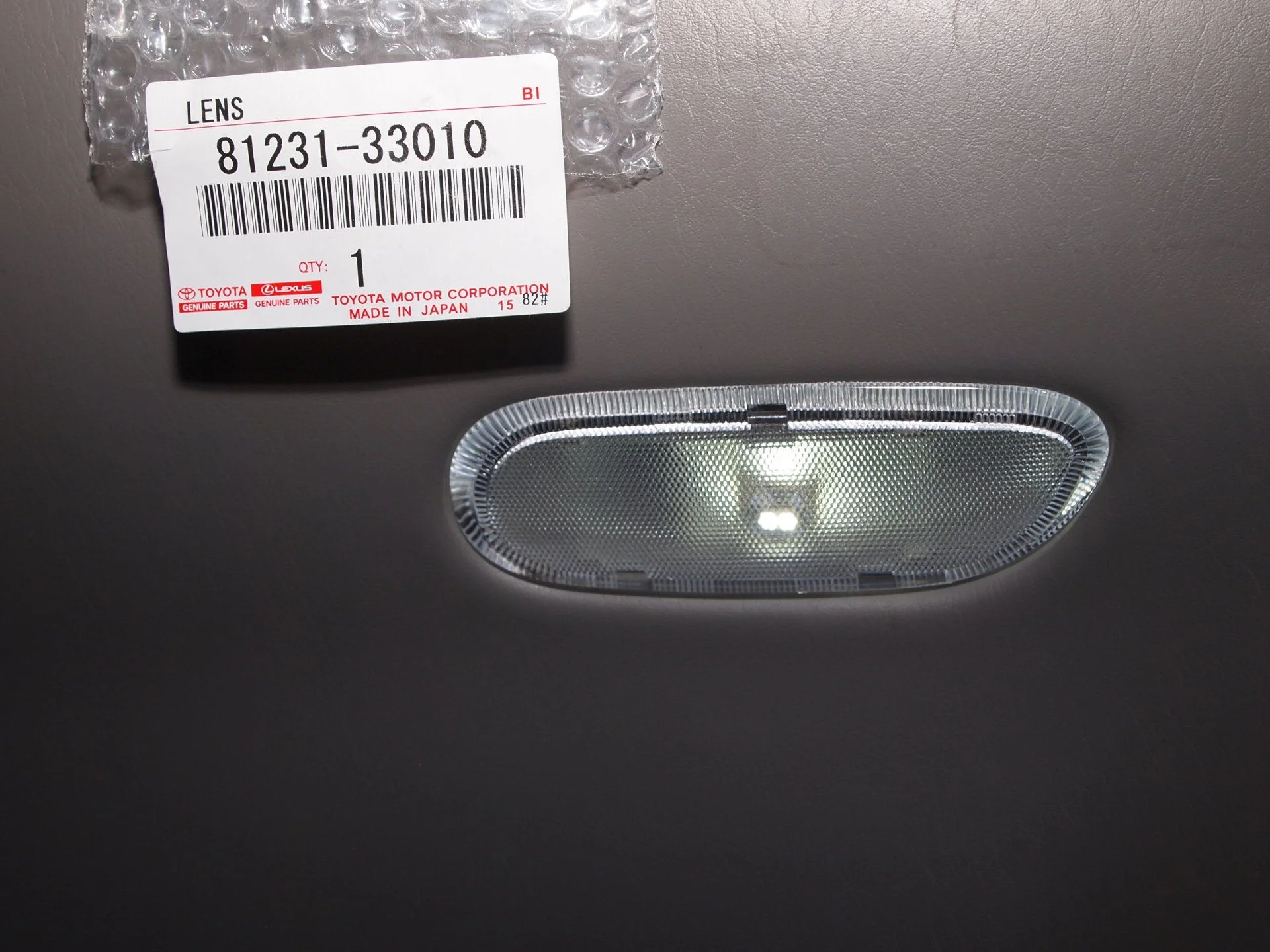

LH rear door interior courtesy light lens replaced.
81311-33010 Lens, Courtesy Lamp LR
81231-33010 Lens, Courtesy Lamp RR
Front doors probably the same, IDC.

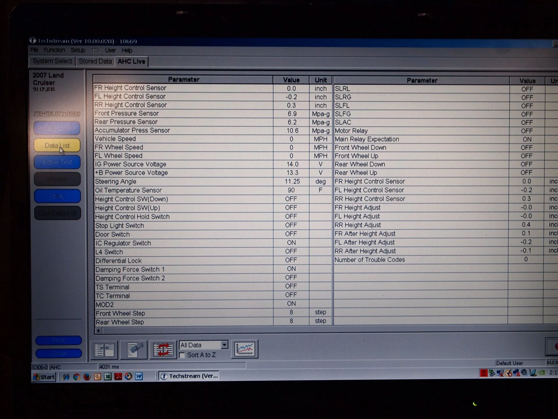

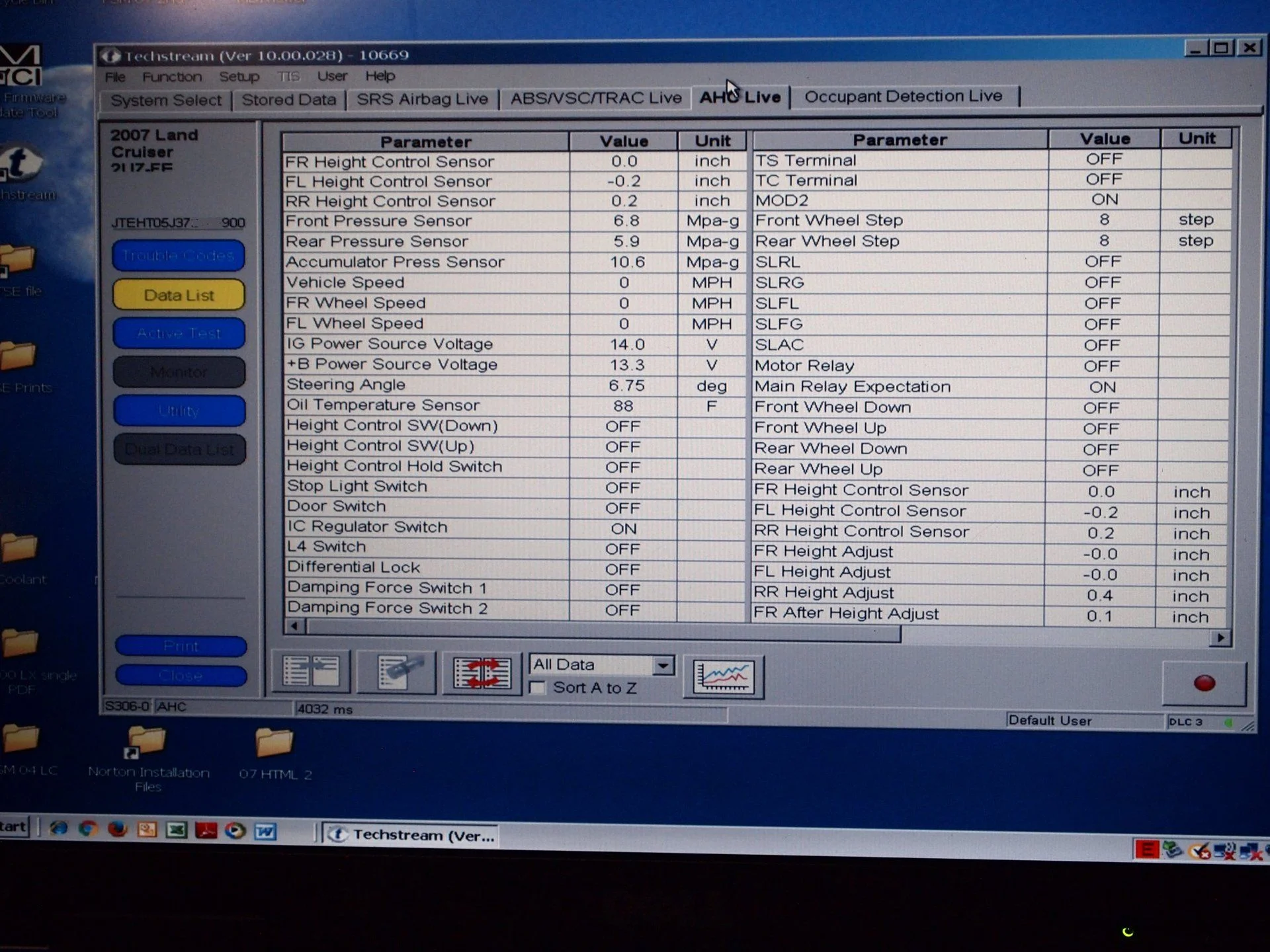

AHC check up:
AHC reservoir is indicating about 12 hash marks from H to L.
Checked AHC pressures, while techstream hooked up and running. They looked great with:
Front Pressure Sensor at 6.8 and rear at 5.9 Mpa-g.
I'm sure the rear coil spring spacer I installed helped to rear, and will add to life of rear globes. But I've only 1/3 tank of gas, so I'll come back and check again then adjust heights (if needed) after topping tank.
I rechecked with full tank of gas:

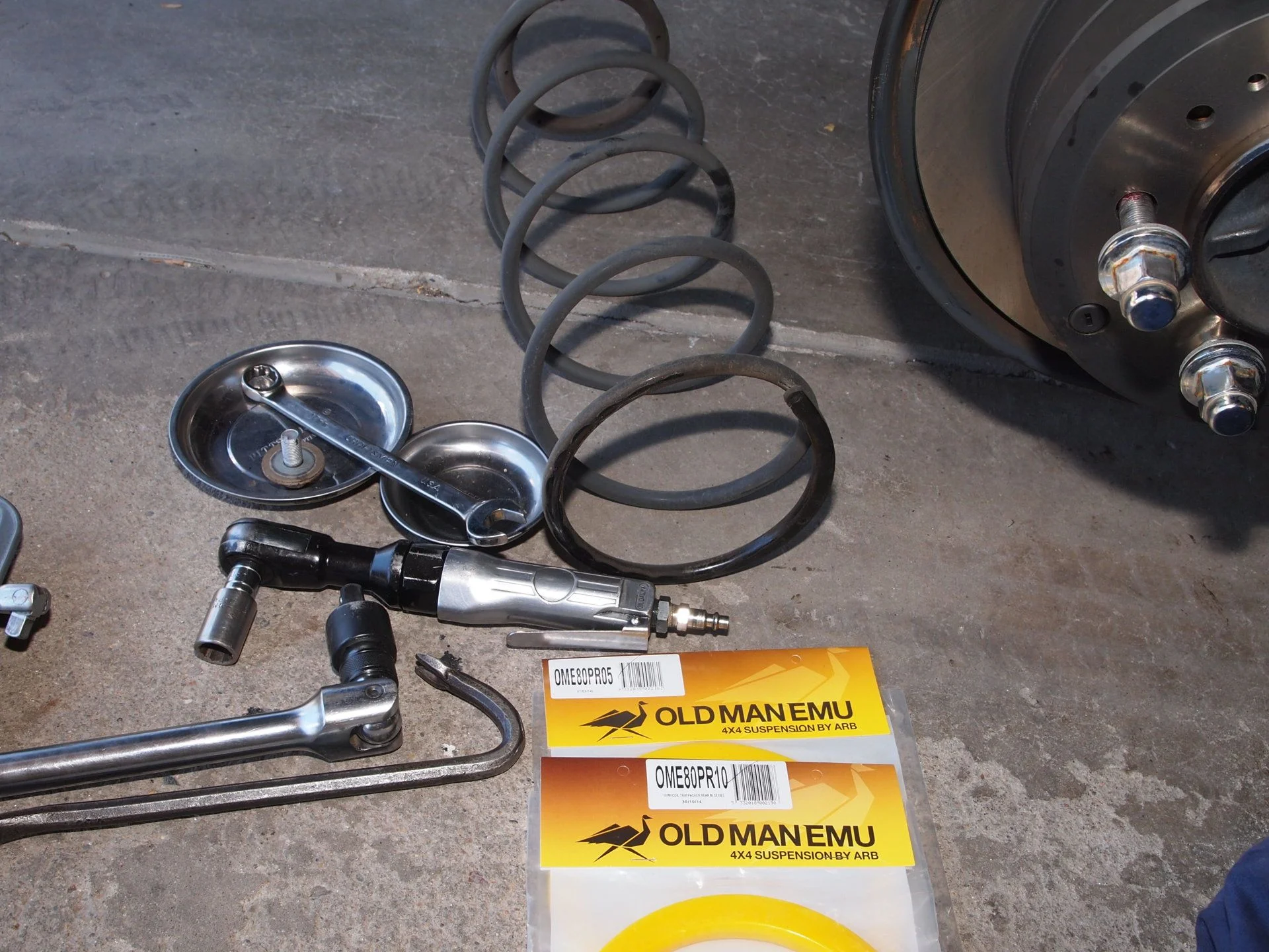

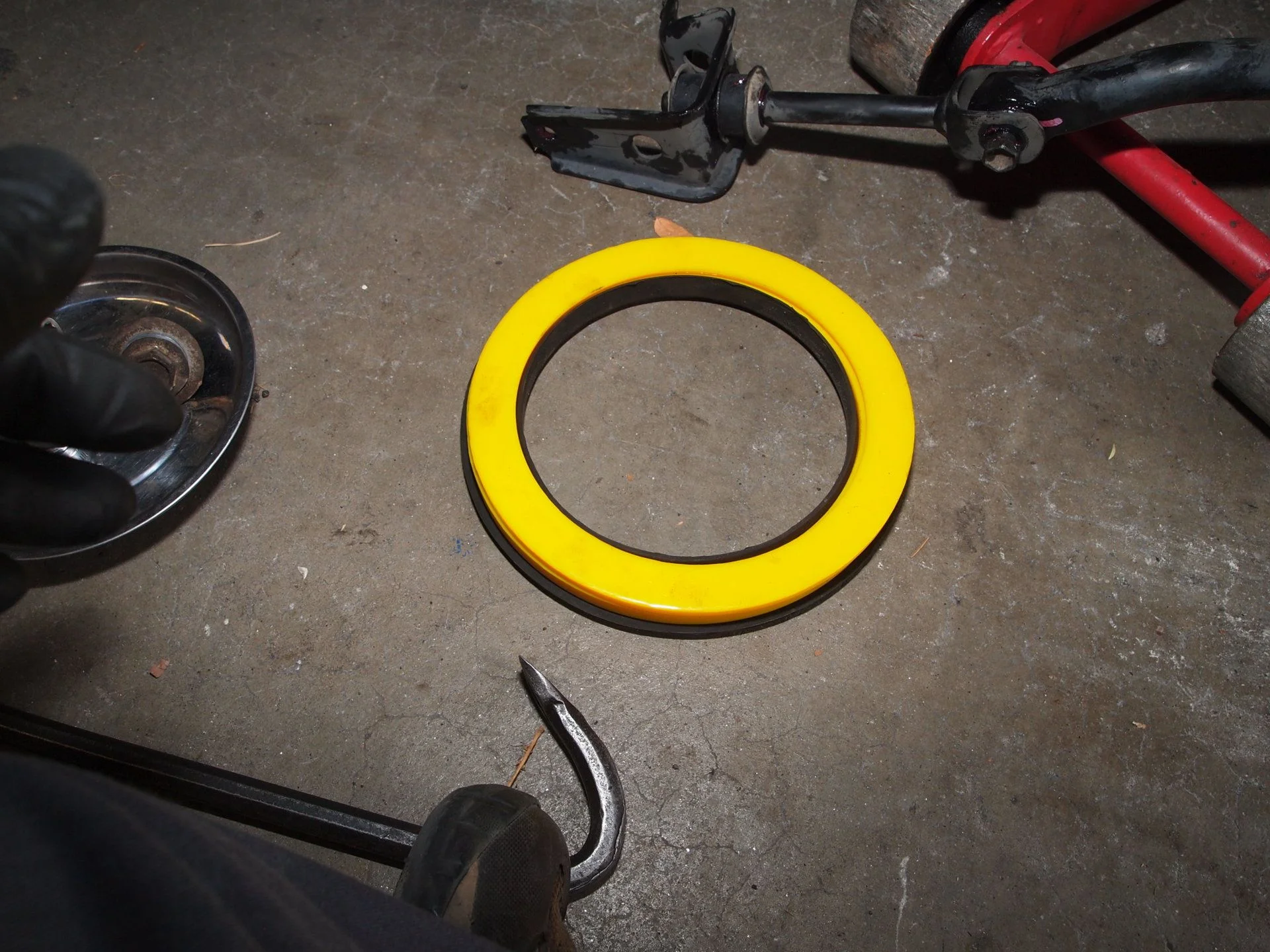

Coil spring spacer installed.
As noted in test drive post, I actually did this some time ago. While doing the rear bushing I installed two OME coil spring spacers totaling 15mm (10 & 5mm spacer) on each side.
Start by releasing rear links and lower end of shocks.
Greasing make assembly easier and reduce chance of rusting in.

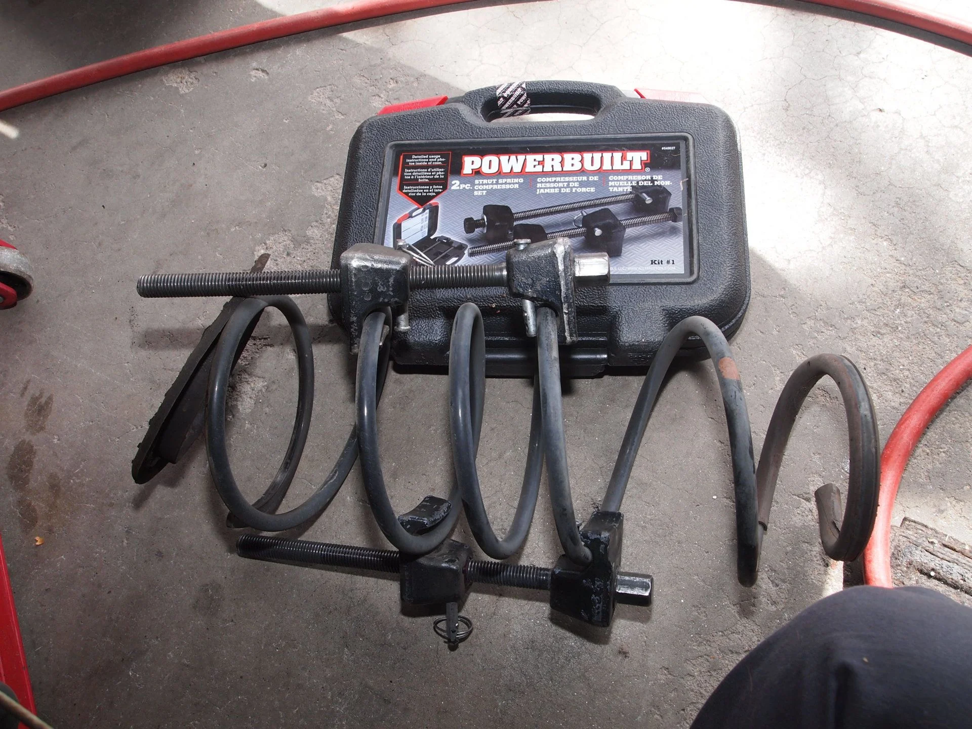

I find it easier to compress DS spring coil, than to disconnect AHC high control or risk to much stretch on rear upper brake lines. This power build spring compressor set from Advance Auto, really worked well. The PS I just press down on rear axle as I hold DS of axle up with a jack. PS spring then just drops out, without use of spring compressor.
Factory installed a thin black rubber insulator which goes on top with spacer between that and coil spring. The the assembly (coil spring, spacers & insulator) fit around a large bump-stop.

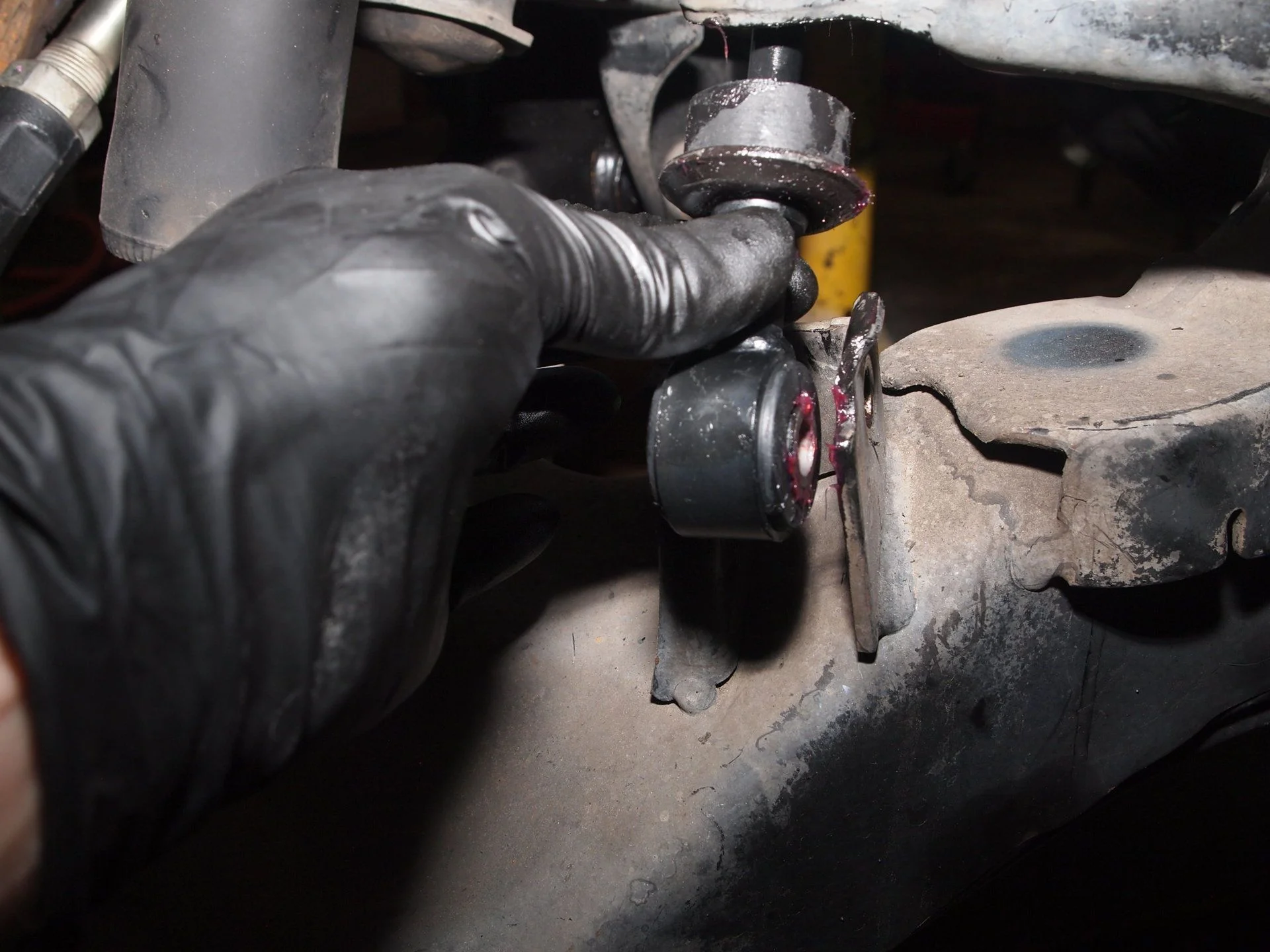

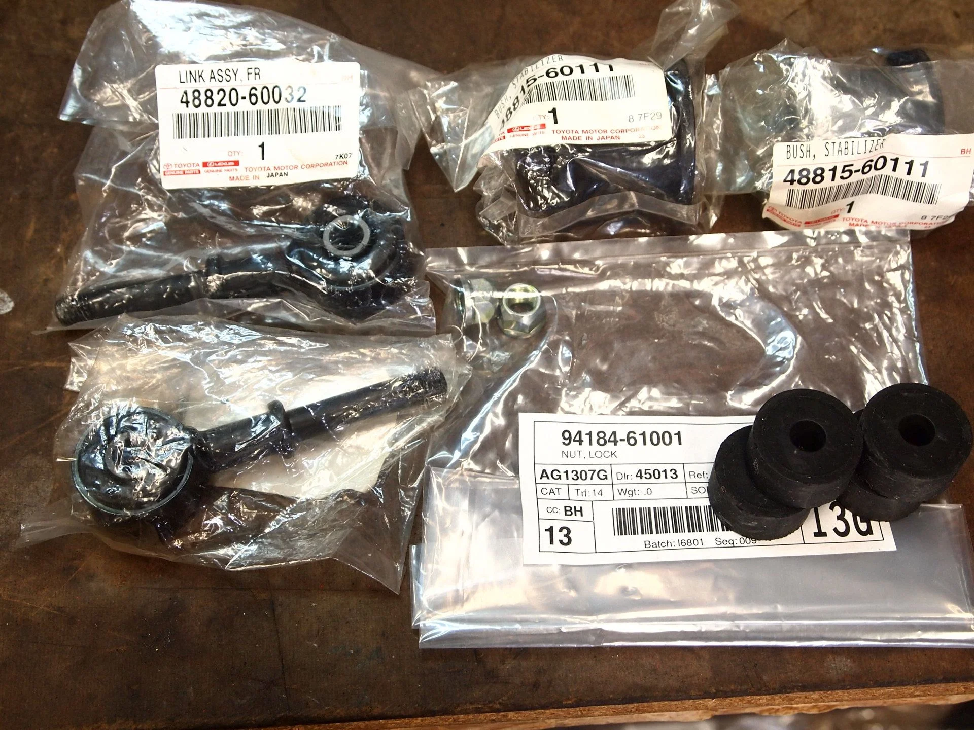

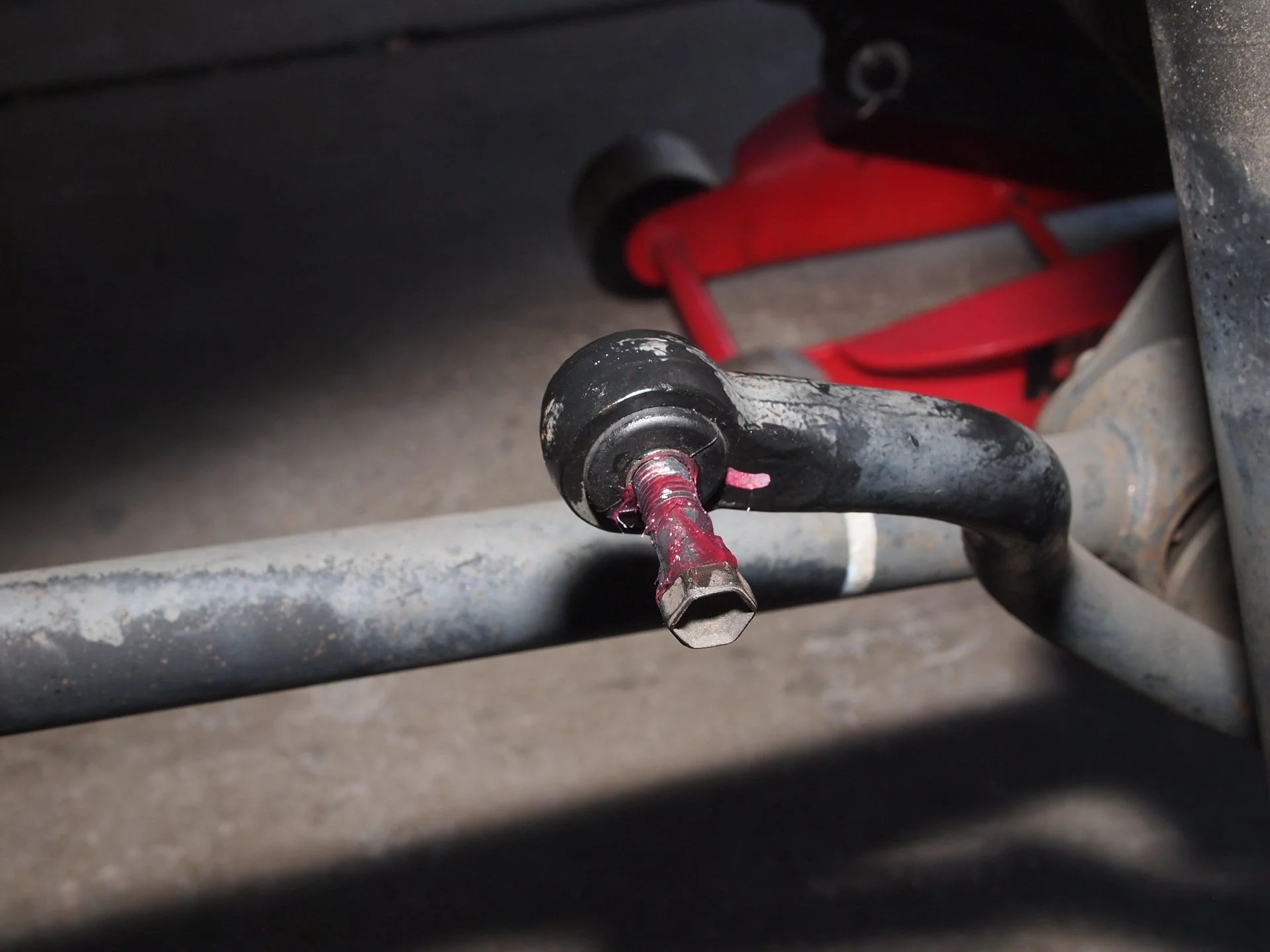

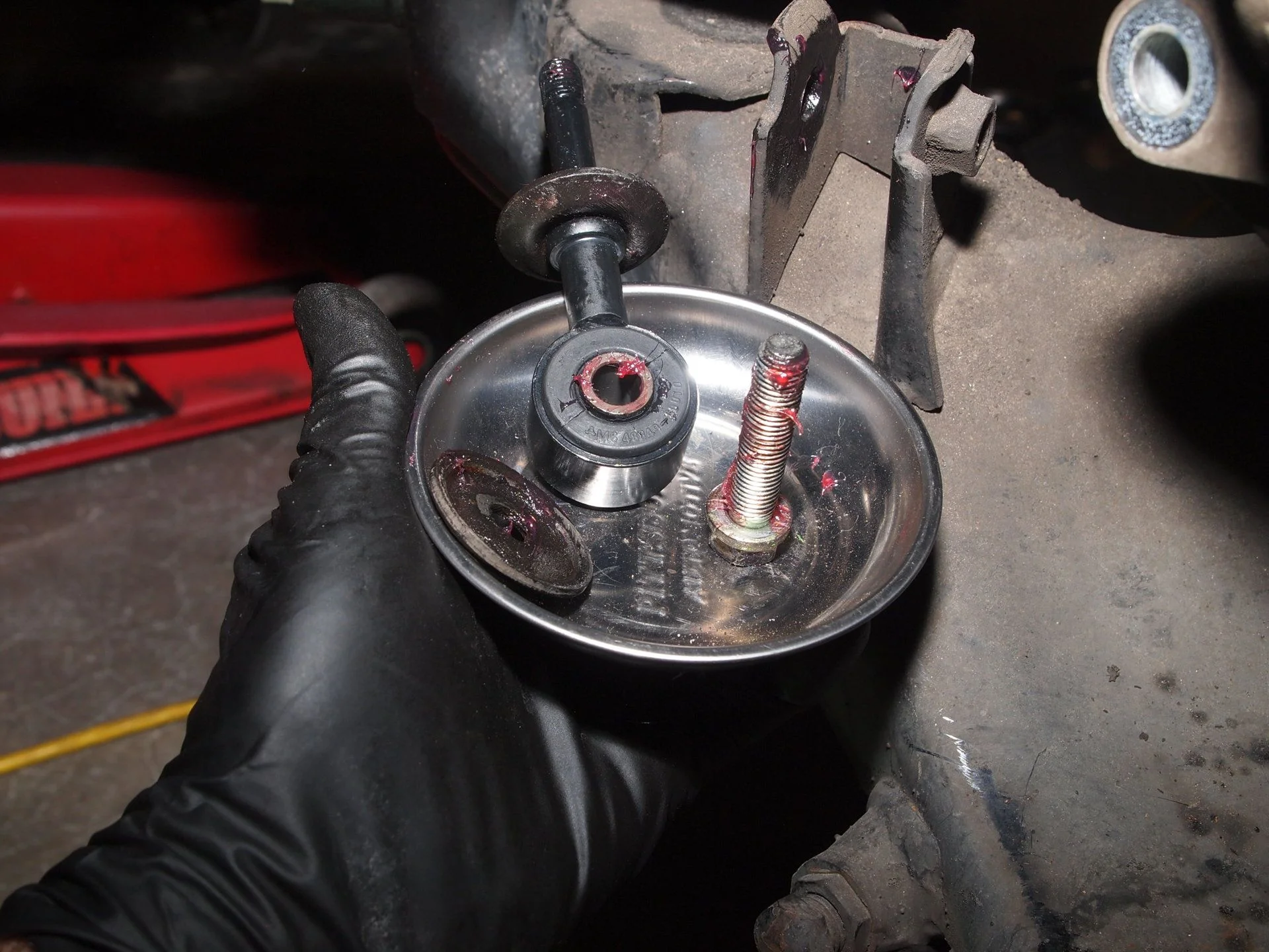

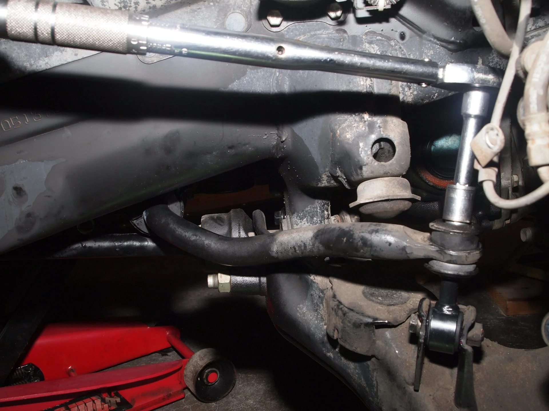

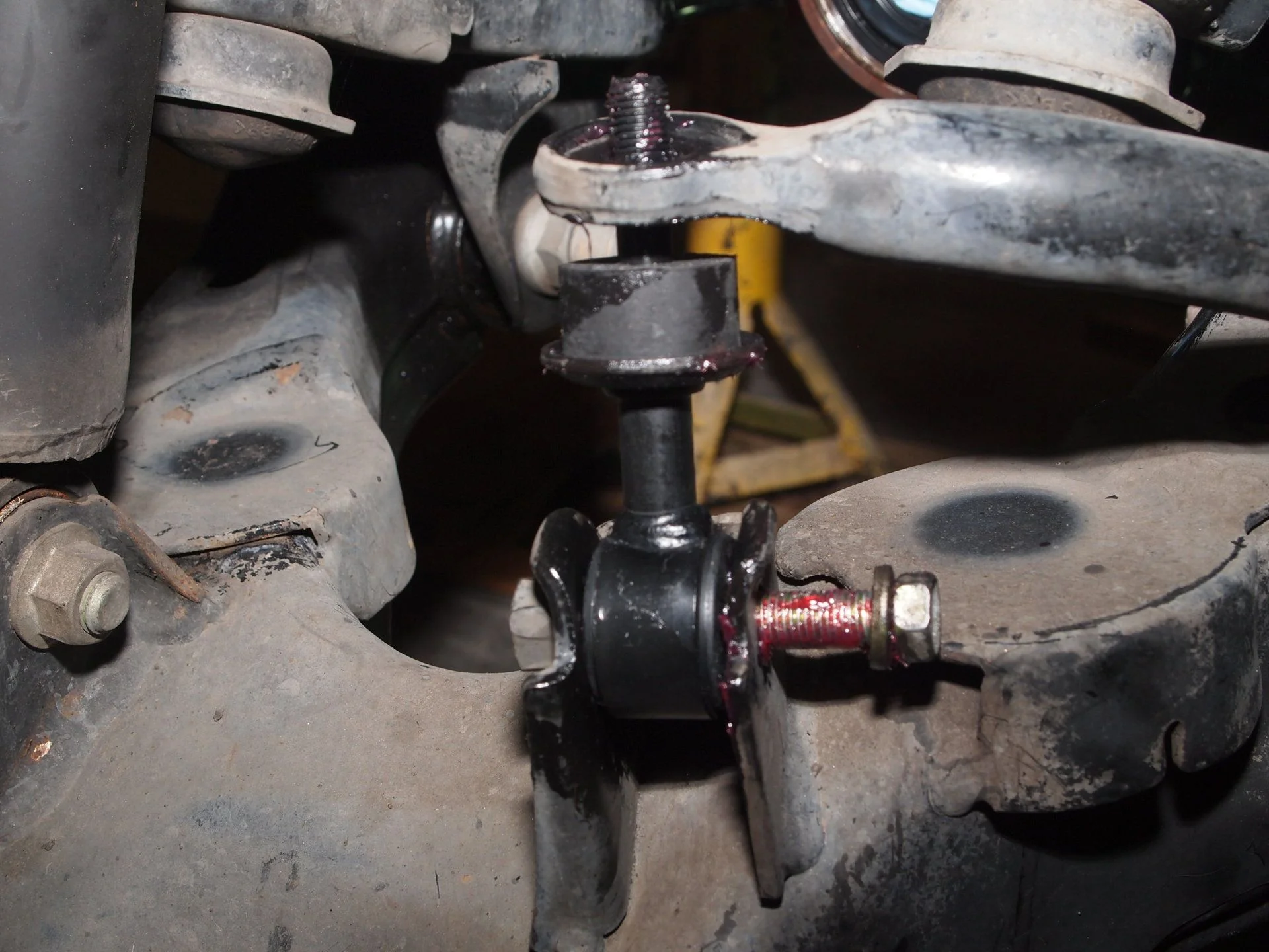

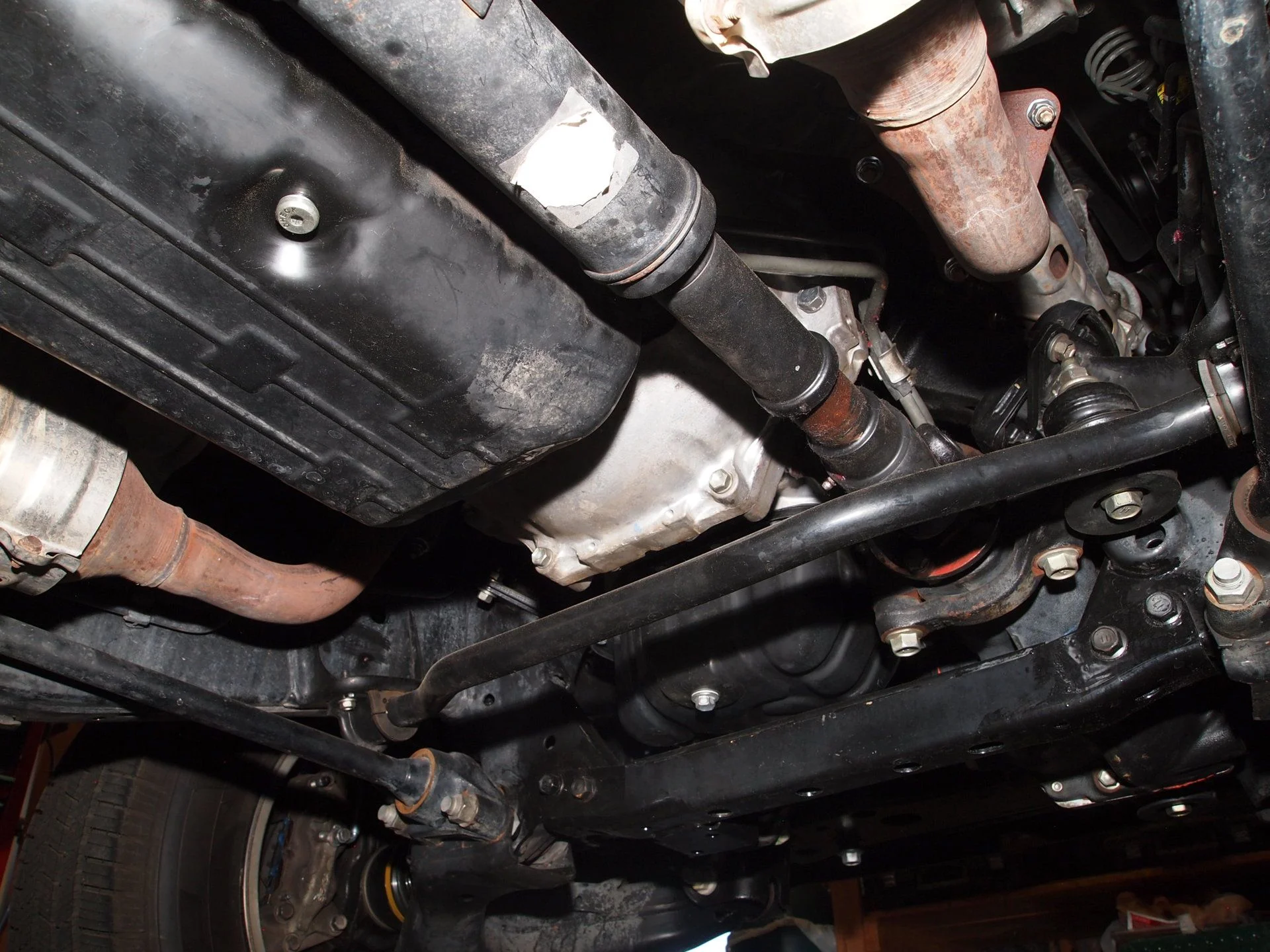

Stabilizer links and bushing installed, front & rears. Replacing these really makes a difference in the turns, More so at high speeds, as it reduces sway increasing stability.
Not waiting until stabilizer bar and brackets on LCA are worn out, keeps in new like condition ..SWEET!
Usually we wait until the links break, putting up with excessive sway in the turns. But then we see the stabilizer bars link mount holes worn out and link brackets on LCA worn through into metal.

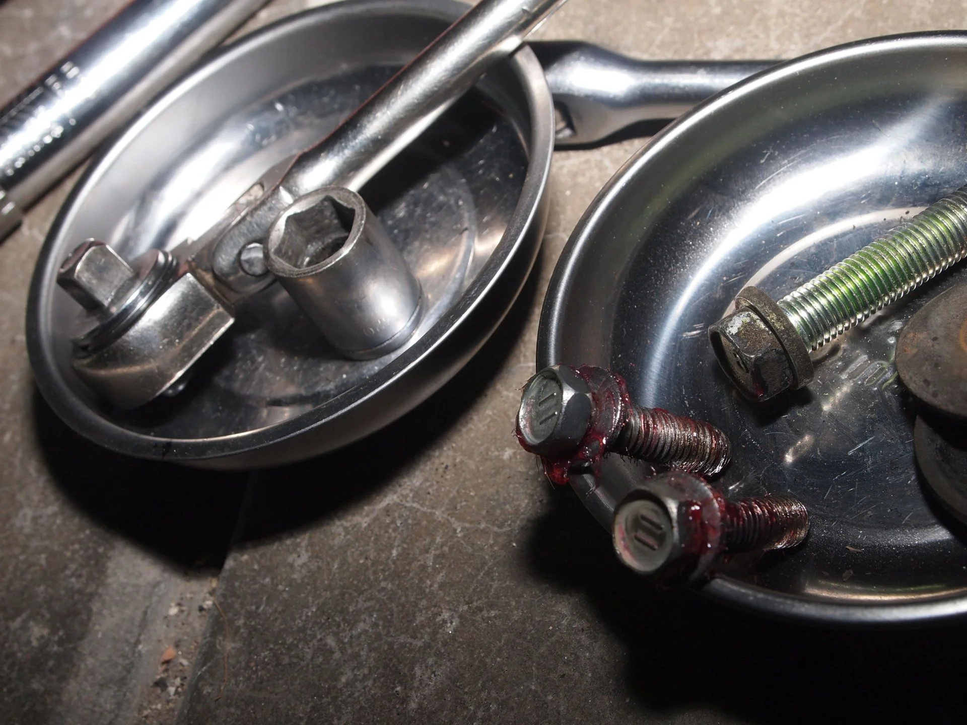

The bolts holding links and the bushing sometime rust in. So I add a little grease after cleaning as a PM.
I find it best to assemble both side loosely installing links and bushing. Then come back and torque to spec.

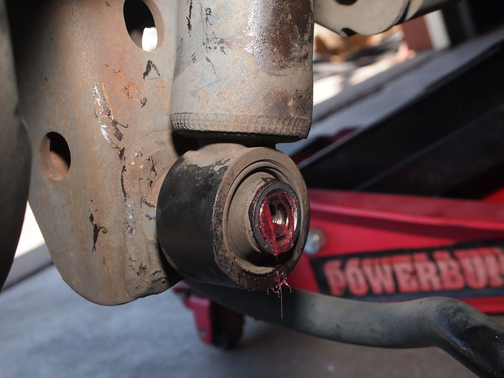

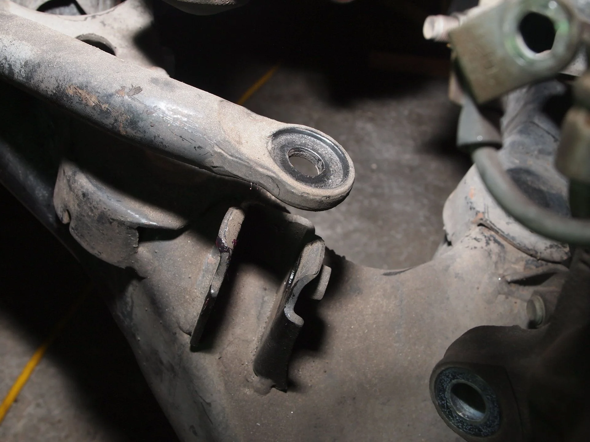

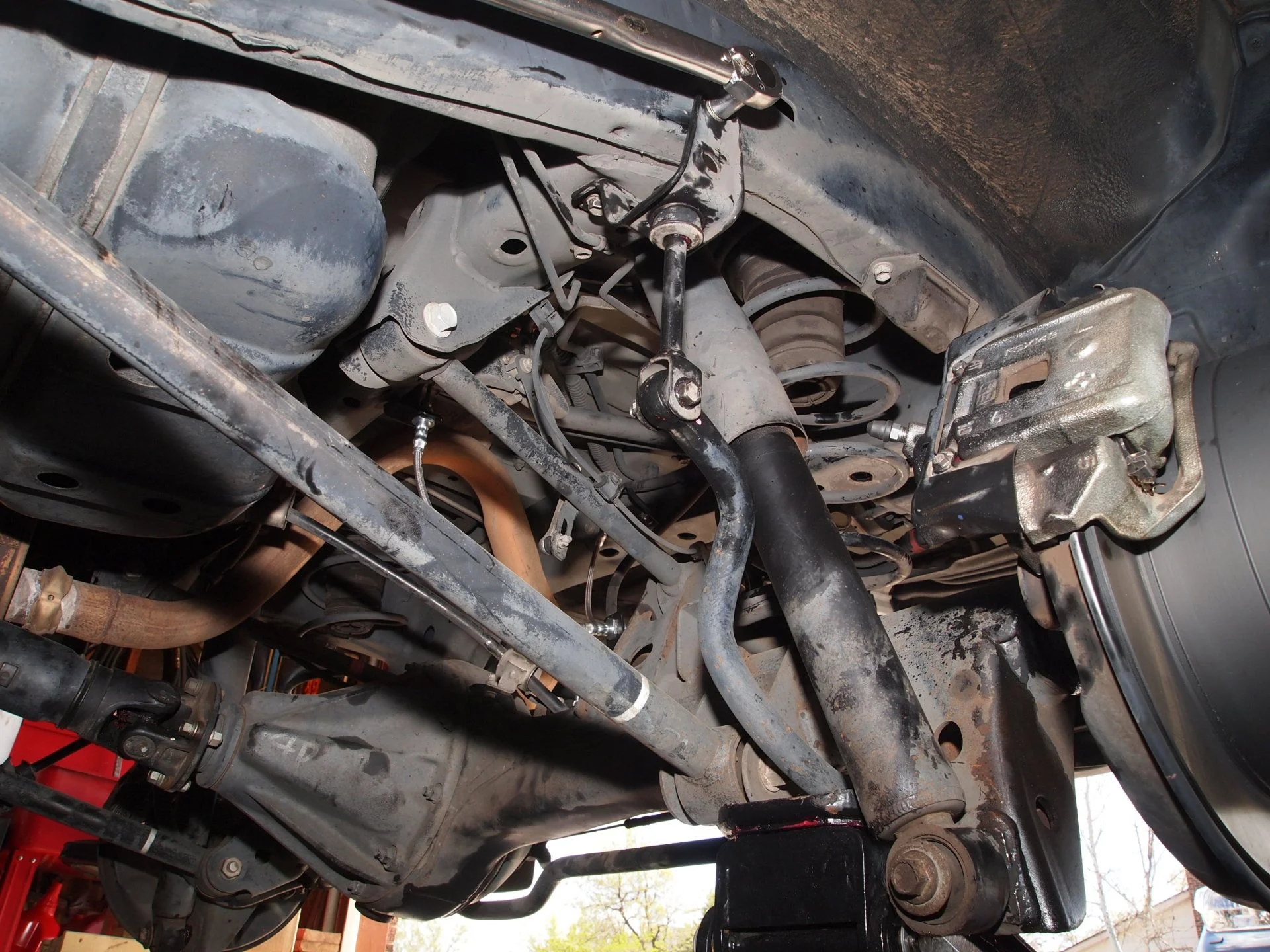

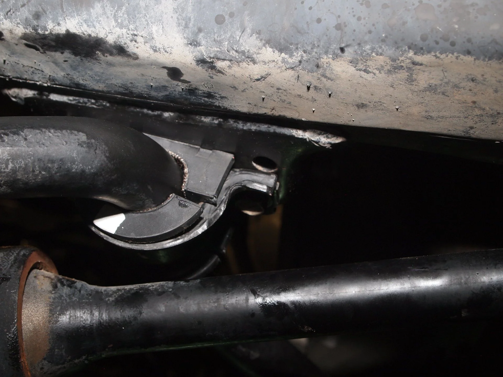

Rear stabilizer links, spacer & bushings.
I use bolt as a tool to grease inside walls of spaces as a PM.

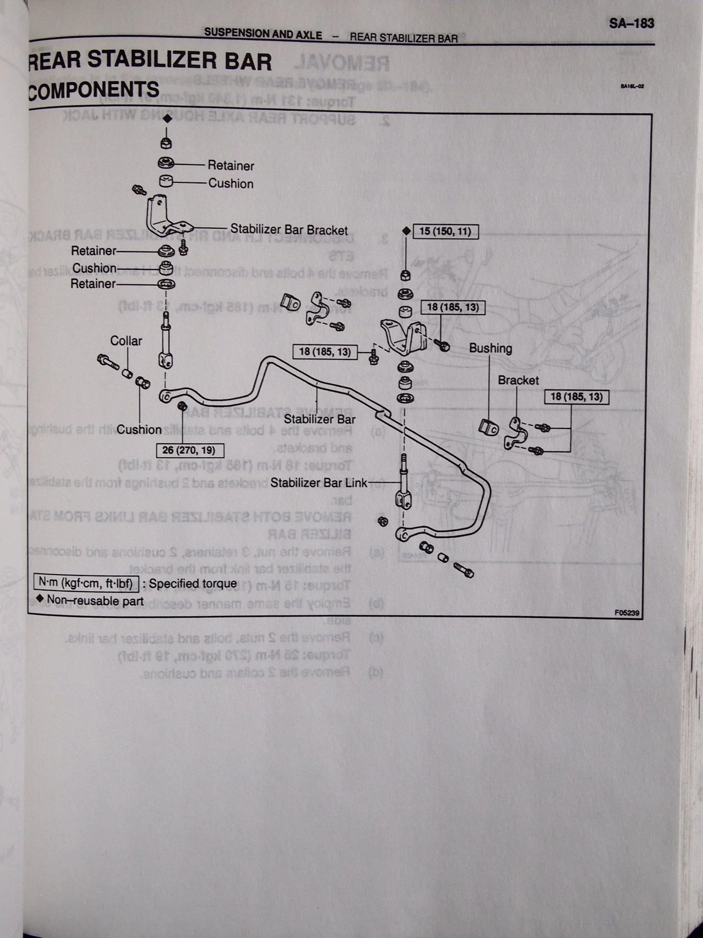

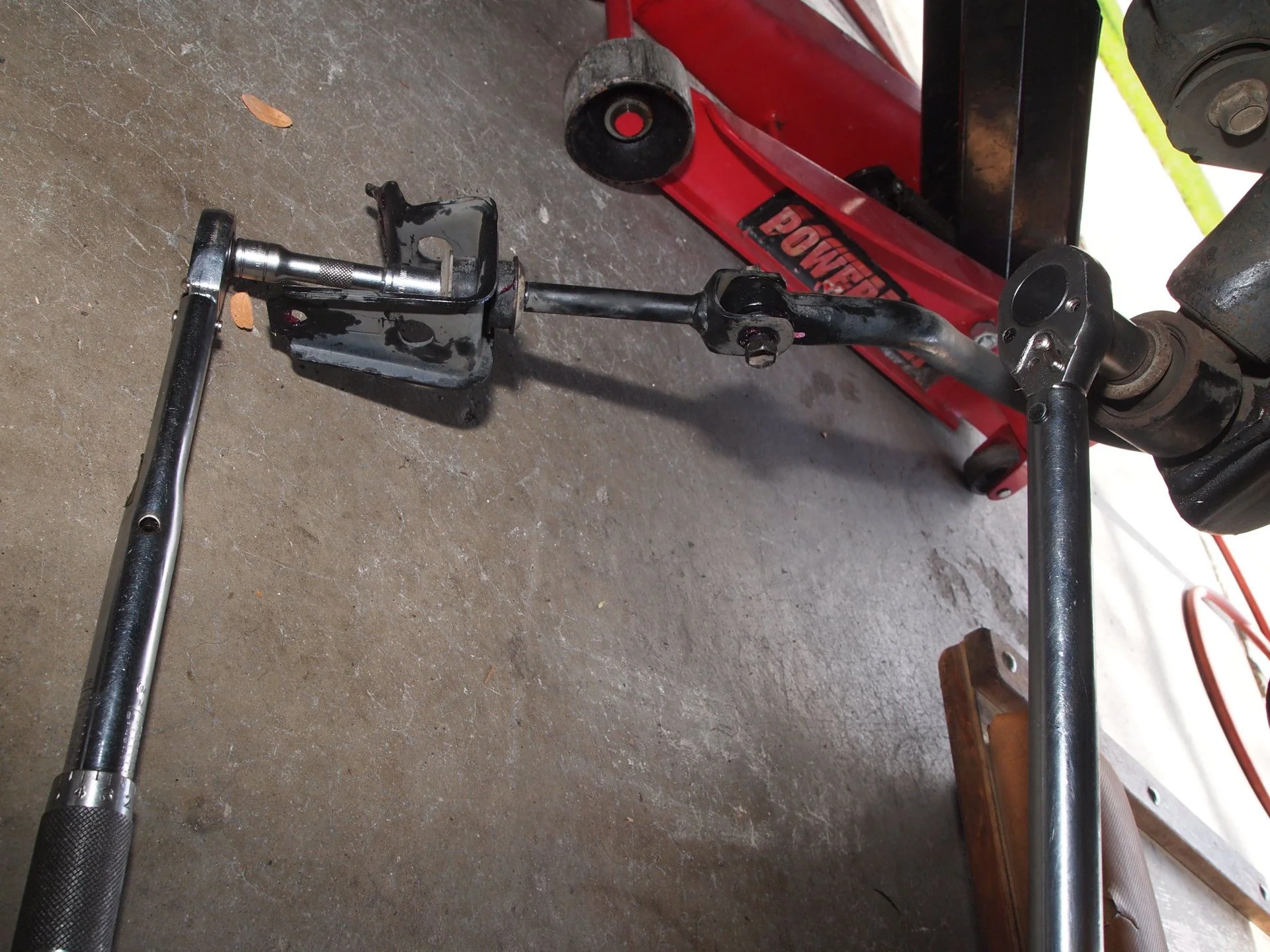

With rears, I torque links as I go.
After torquing link in bracket, I put in place up assembly torque bracket in place.
Rear bar bushings & brackets are placed in loosely and torqued after complet assembly is in place.

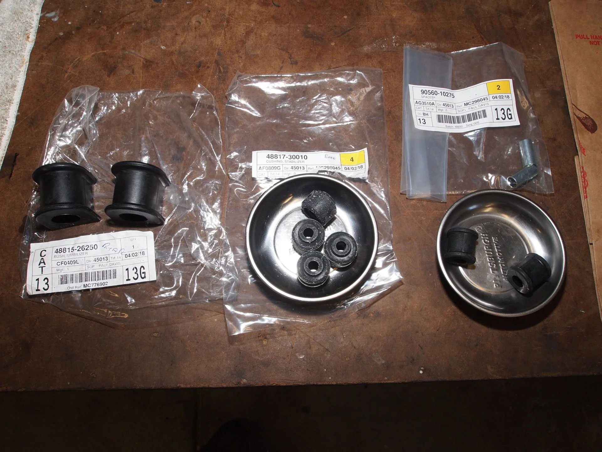

Note: AHC rear bar rubber bushing are different size with AHC.
For the bushings, you used the rubber grease, and then regular synthetic for the bolts right? Does the rubber grease seem to be that important? Worth the hefty(I'm assuming) price tag?
No grease is called for.
That said;
I used the rubber grease, because the collar was being difficult to press into the rubber bushing. I had purchased the grease from Toyota for ~$10 for brake calipers, and decided to give a try here.
I've been finding these collars worn out and bolts rusty on many rig (although, not this rig). So used the Red-N-tacky grease inside the collar and on bolt shaft as a lube to reduce wear as a PM against rust.
I also put some Red-N-Tacky on the brackets at points they contact frame as a rust PM. This again is a spot(s) I typically see rust.

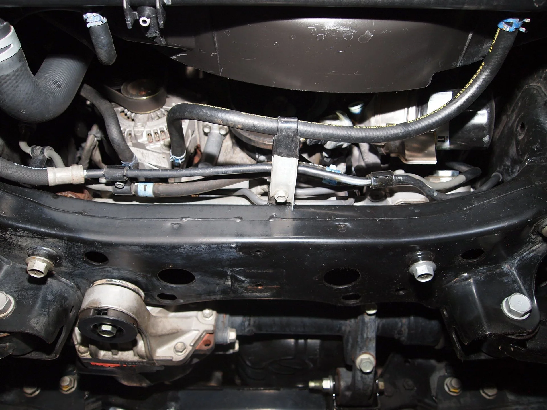

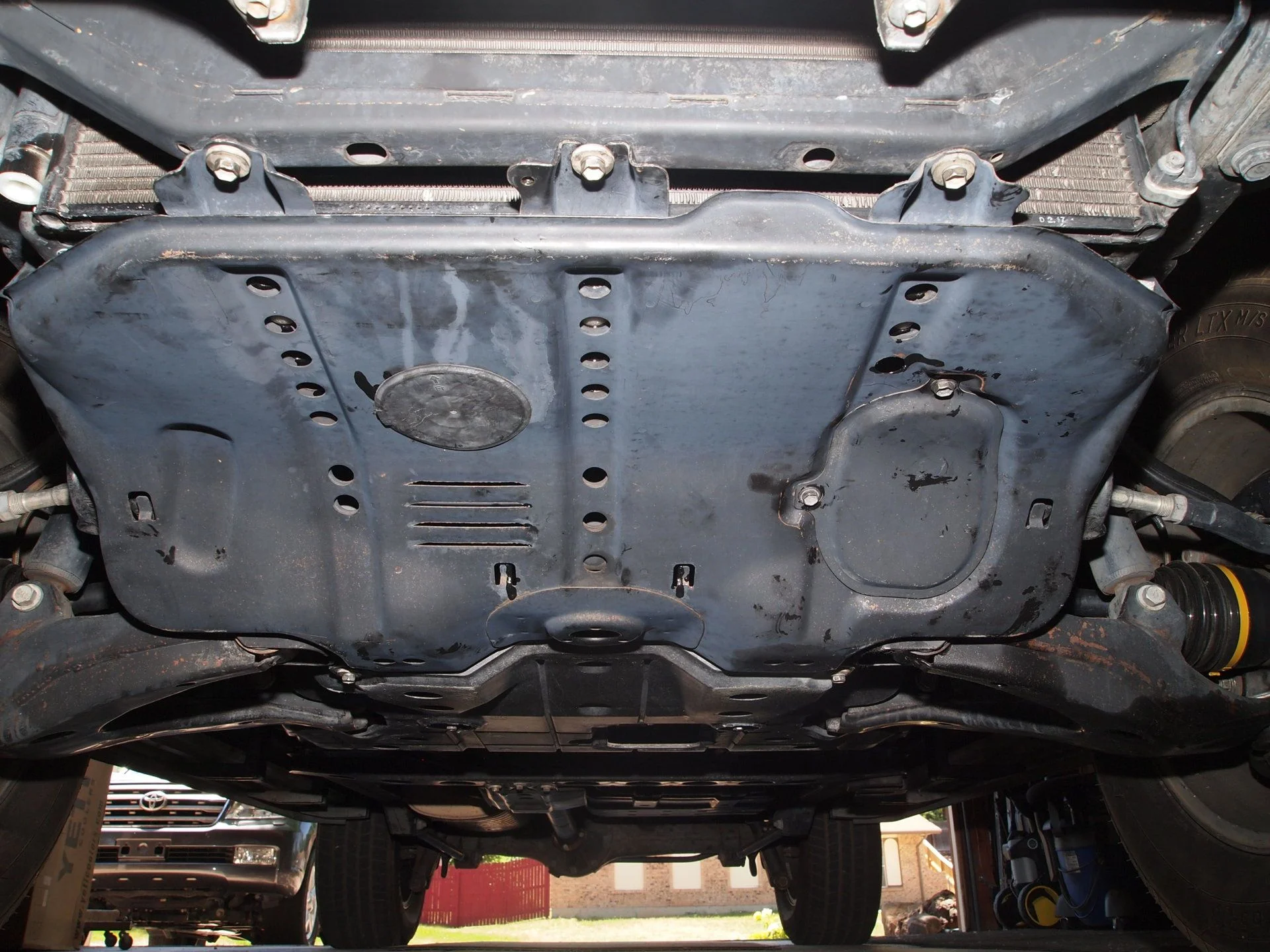

No leaks so buttoning up by installing shielding.
I driven a few hundred miles and had idling more than and hour. Not good idea to let idle for prolonged periods, but no choice when working on some systems. After each drive or idling I inspect for leaks. All looks good!

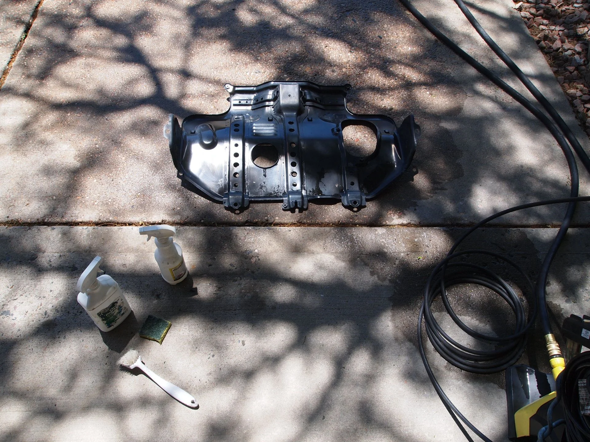

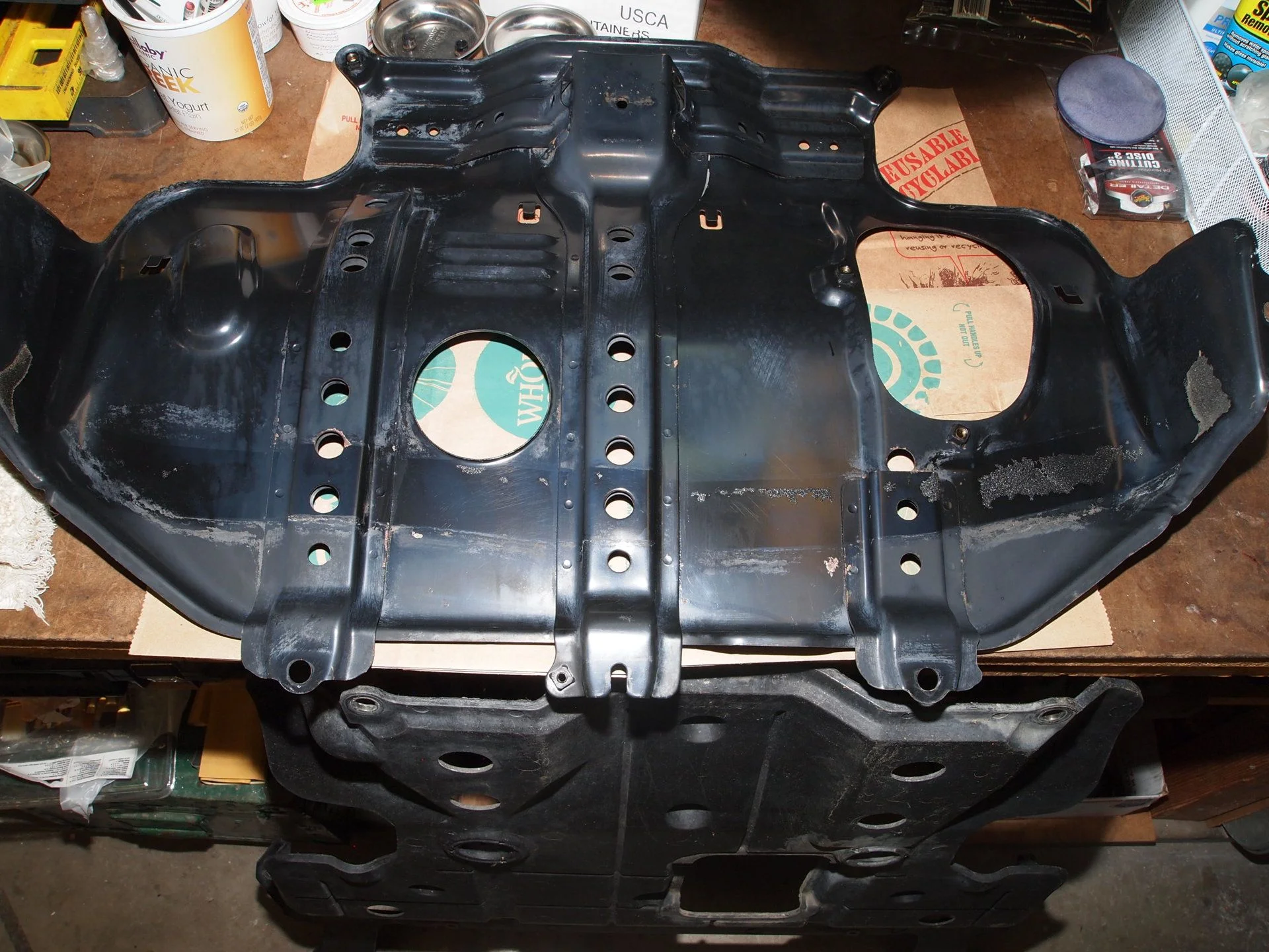

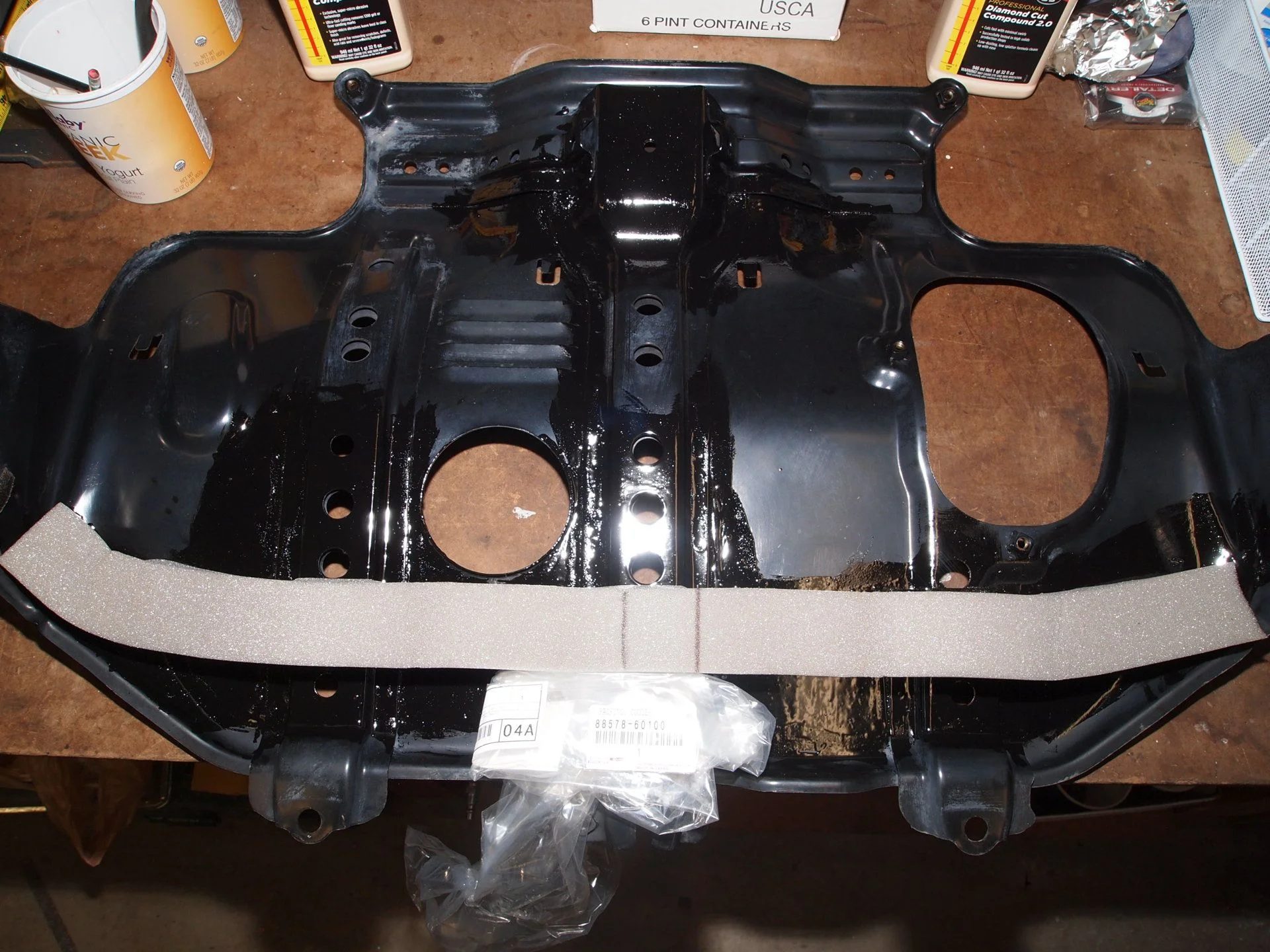

Skid plate rust PM and bottom radiator foam ("cooler pack") pad install.
The radiator has foam padding all the way around it. This is the bottom piece that fits between it and skid plate. It is the only one that I've found needs PM (replacing).
Toyota support tells me the foam is a vibration damping device. IDK, my thinking is it helps divert airflow through radiator.This foam goes bad. When it does go bad, it soaks up moisture like a spunge. So inspecting every few years and replace once it doesn't repel water.
I found where those two extra bolt go, oil filter hatch..DUH.
No extra parts, nut, bolts, fasteners or clips....NICE;)
#1 and #2 undershields installed. Only missing the little oil hatch that goes in #2 shield, as it didn't have one. I may have one in a box somewhere I'm looking now. But these get misplaced most any time some shop changes oil.

Stabilizer systems'
4/6/18 4 90948-01003 Cushion, link
4/6/18 2 94184-61001 Nut, link top
4/6/18 2 48820-60032 link w/bushing lower pressed in
4/6/18 2 48815-60111 Bushings, Stab Bar
4/6/18 4 48817-30010 cushions, link
4/6/18 2 90385-11021 Cushion, Bar to link
4/6/18 2 90560-10275 Collar, Bar to link
4/6/18 2 48815-26250 Bushings, w/AHC
5/4/18 2 OME80PR05 5mm OME spacers
5/4/18 2 OME80PR10 10mm OME spacers
