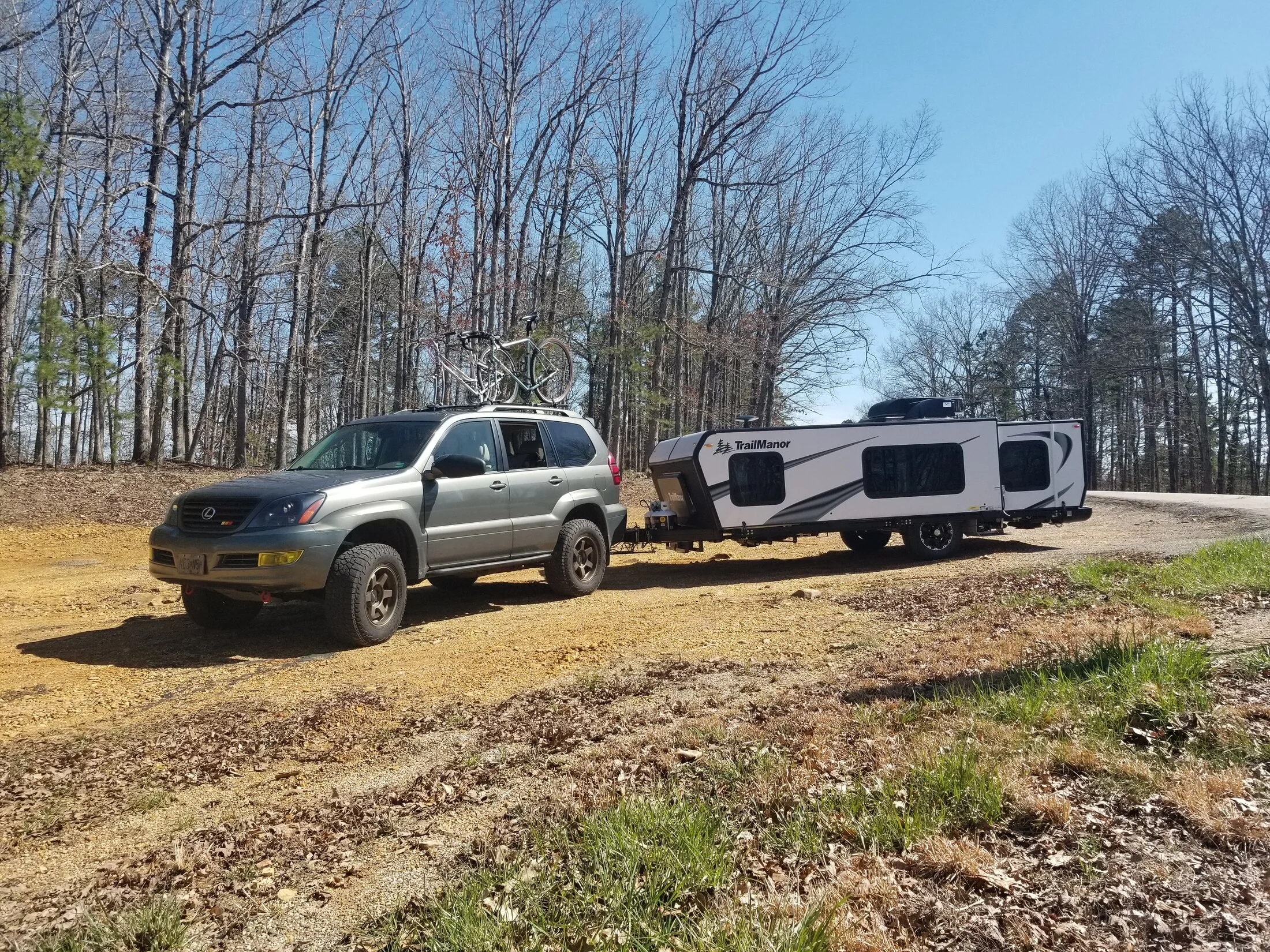

I have a 470, rather than a 460, but can confirm that the GX platform will pull a TrailManor just awesome. The camper compliments a GX very well. I get 11-12 mpg pulling it 70-75, 12-13 mpg going 60-65 mph, and up to 14 mpg on 55-mph 2-lane backroads. We've logged multiple 700-mile days with this setup. I would recommend upgrading the trans cooler and either using a WDH or retaining the stock airbags. Later this summer we are planning to pull ours all the way to Glacier.

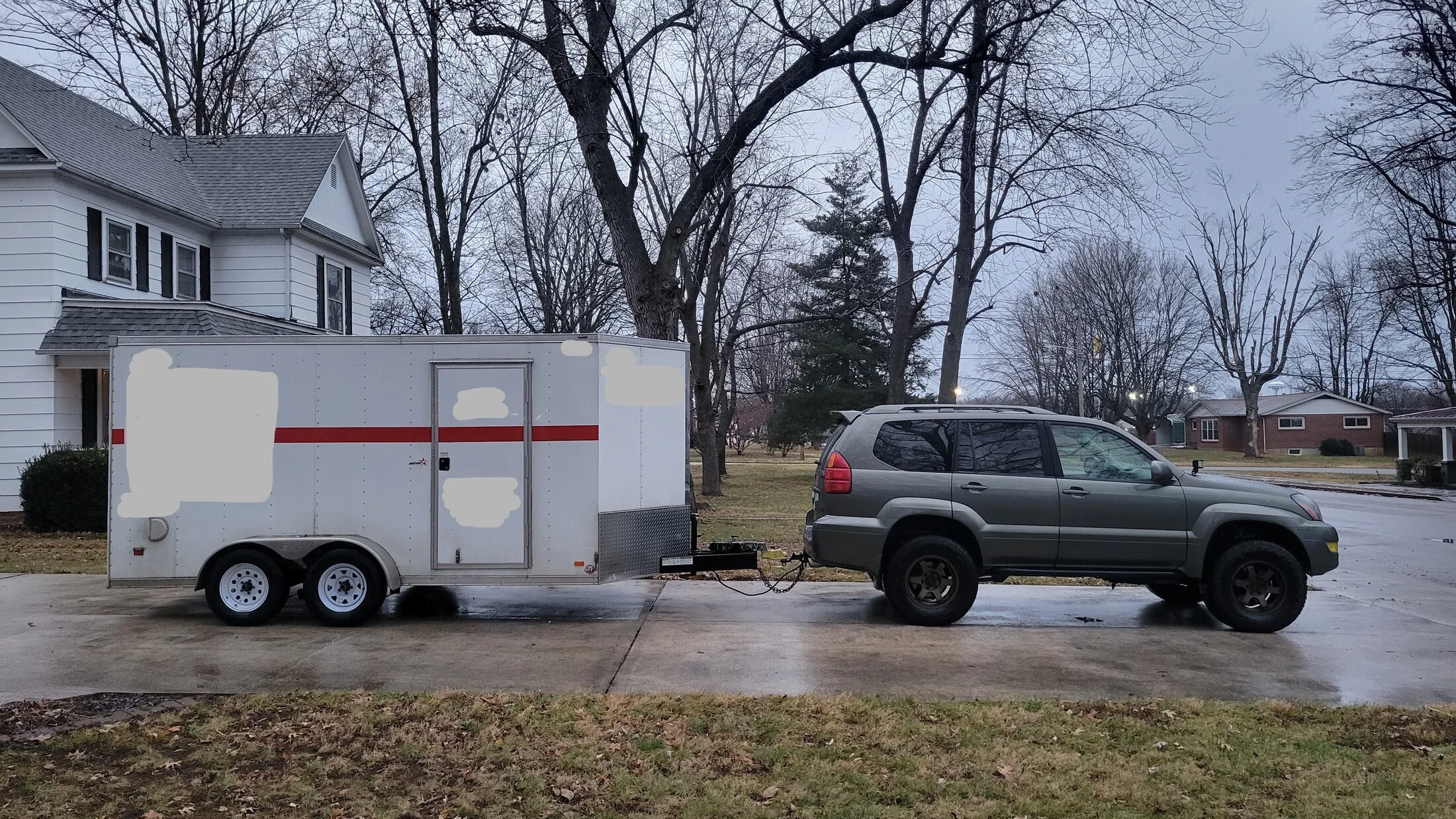

It also handles a ~5,000# loaded enclosed trailer quite well. We moved our family of 4 in ours (across town, but still).

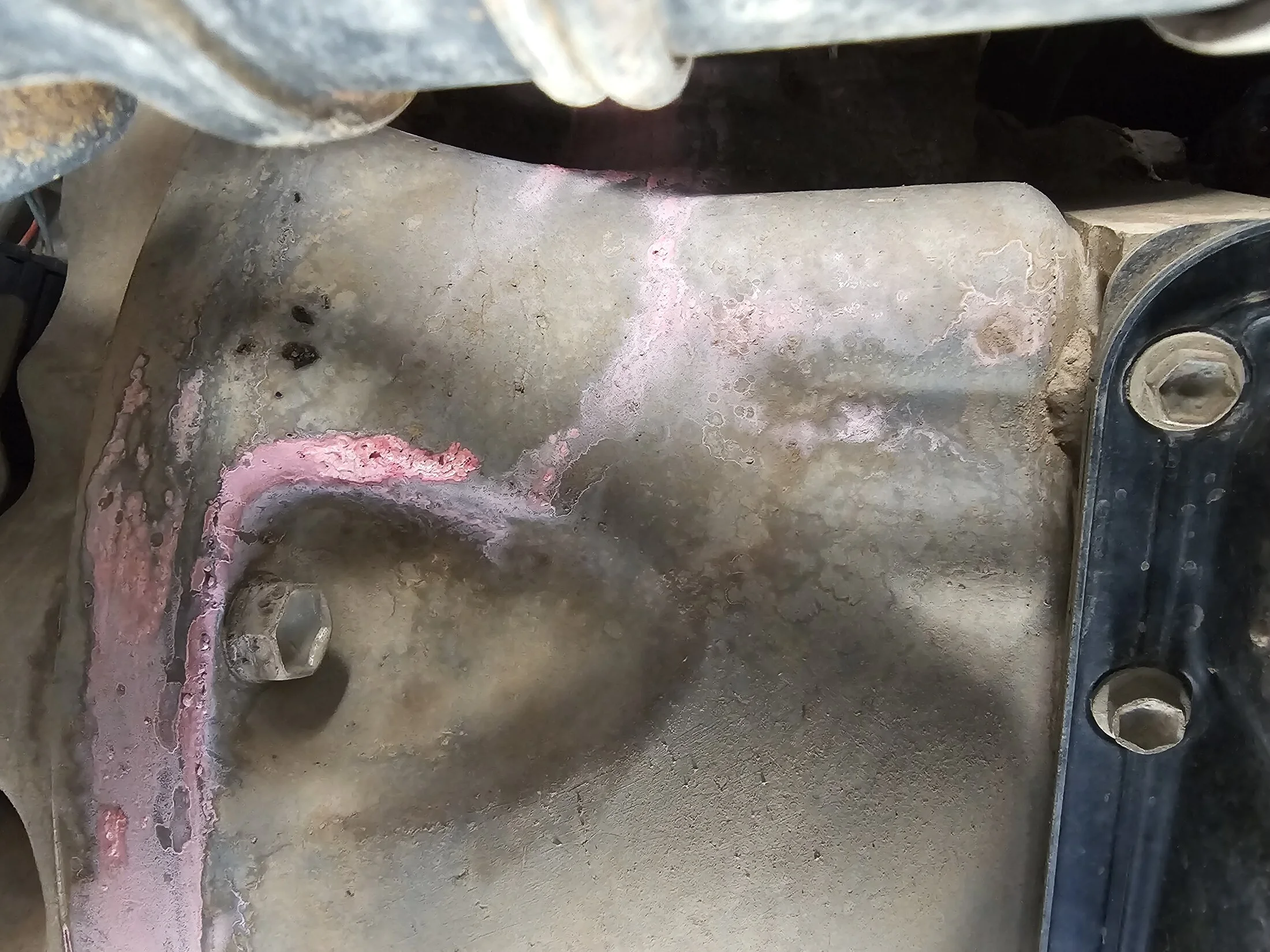

Coolant valley plate can happen on newer trucks. I just diagnosed it on my 2015. Looks for pink stains on bell housing. Radiator will also probably need to be done around 120k as well. Make sure fluids have been changed, especially coolant.
Yep, happened to my '15, had it resealed at around 120k miles. At this point, I would consider it a service item for all GX460s, it's going to happen eventually.

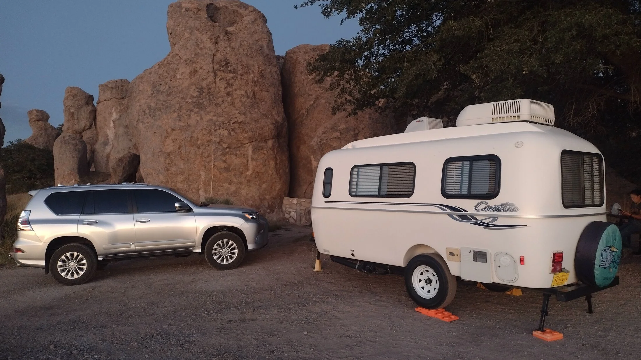

We have a 19 GX that currently has 50k miles on it. Had it for about 4 years and so far has been great. We have a Casita trailer that we've pulled a few times with. It's about 3500 pounds. You should be fine with your trailmanor. I'd add a trans cooler if you get one and tow with it. I added a mild lift from Dobinsons and GX 470 17 in wheels so I could ride on 70 series Wildpeaks.
