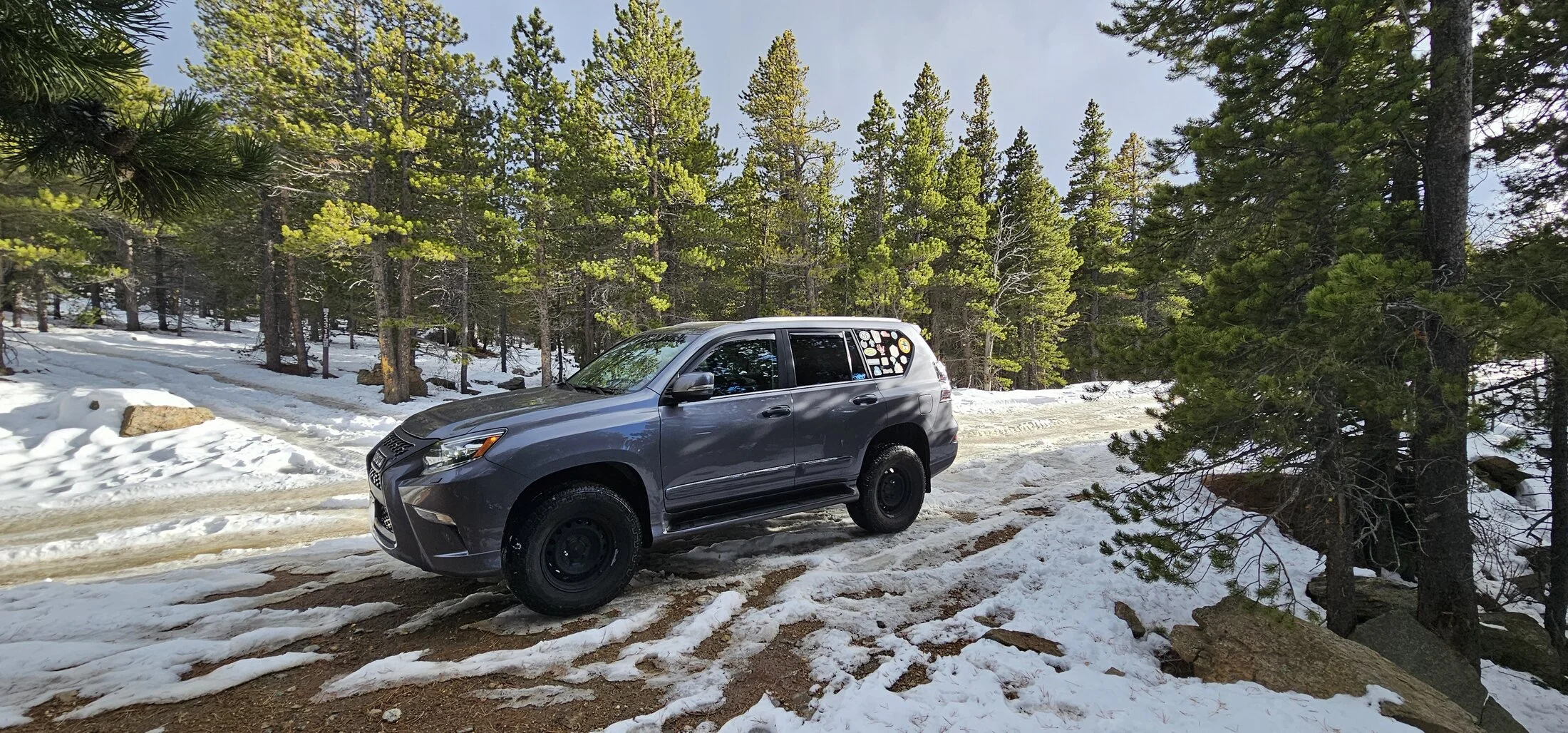

There are still 17"x7.5 oem steelies showing up as take offs on ebay for less than $100 shipped, each. They are ~30 lbs and piece so about 4-6 lbs heavier than comparable oem alloys.
Bilstein 5100s set to 1.75 up front. 1.5" spacers in the rear. 3rd row delete and second row can be removed in minutes.
Arb skids, currently shoping for sliders. 🍔
I love and use the Dr KDSS bypass switch almost daily. Especially great in places with lots of pot holes.

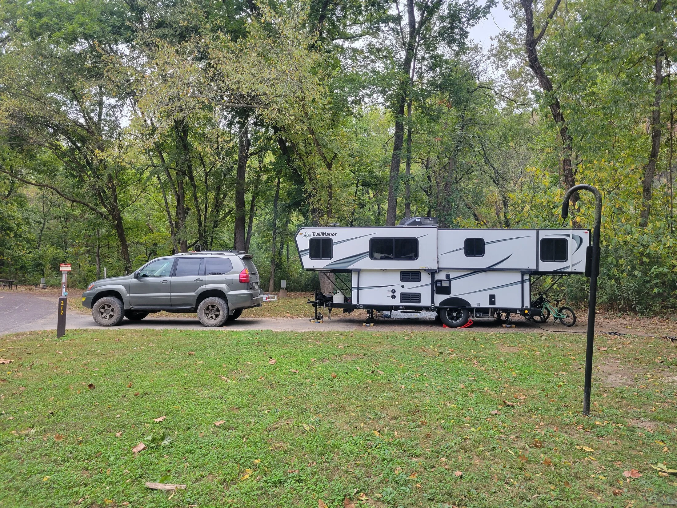

I have a 470, rather than a 460, but can confirm that the GX platform will pull a TrailManor just awesome. The camper compliments a GX very well. I get 11-12 mpg pulling it 70-75, 12-13 mpg going 60-65 mph, and up to 14 mpg on 55-mph 2-lane backroads. We've logged multiple 700-mile days with this setup. I would recommend upgrading the trans cooler and either using a WDH or retaining the stock airbags. Later this summer we are planning to pull ours all the way to Glacier.

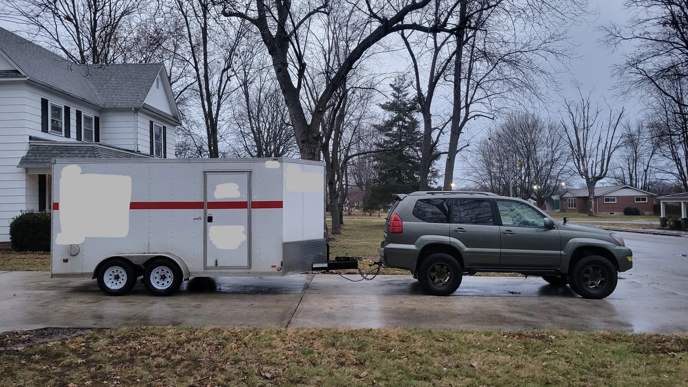

It also handles a ~5,000# loaded enclosed trailer quite well. We moved our family of 4 in ours (across town, but still).
Here is our LX + TrailManor 2720:
