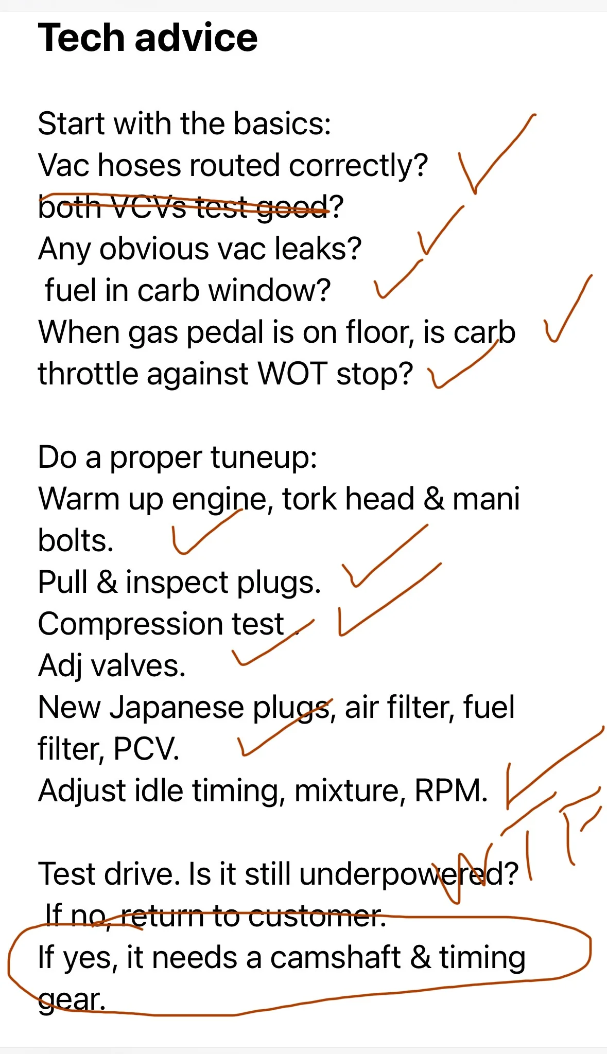

I had sent an email to JimC for some advice last week and I got this email back. Food for thought. Figured I'd make sure this new head was making proper compression. Plugs looked good and check vacuum

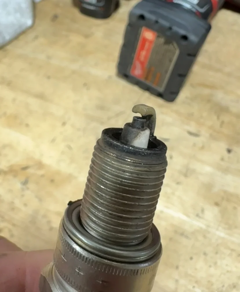

Plugs are new. Only about 75 miles on them.

That last comment in @FJ40Jim comment about getting a new camshaft though has me perplexed.

Camshaft can be worn leading to lower valve lift. Timing gear can be worn leading to slow valve timing. Or both
