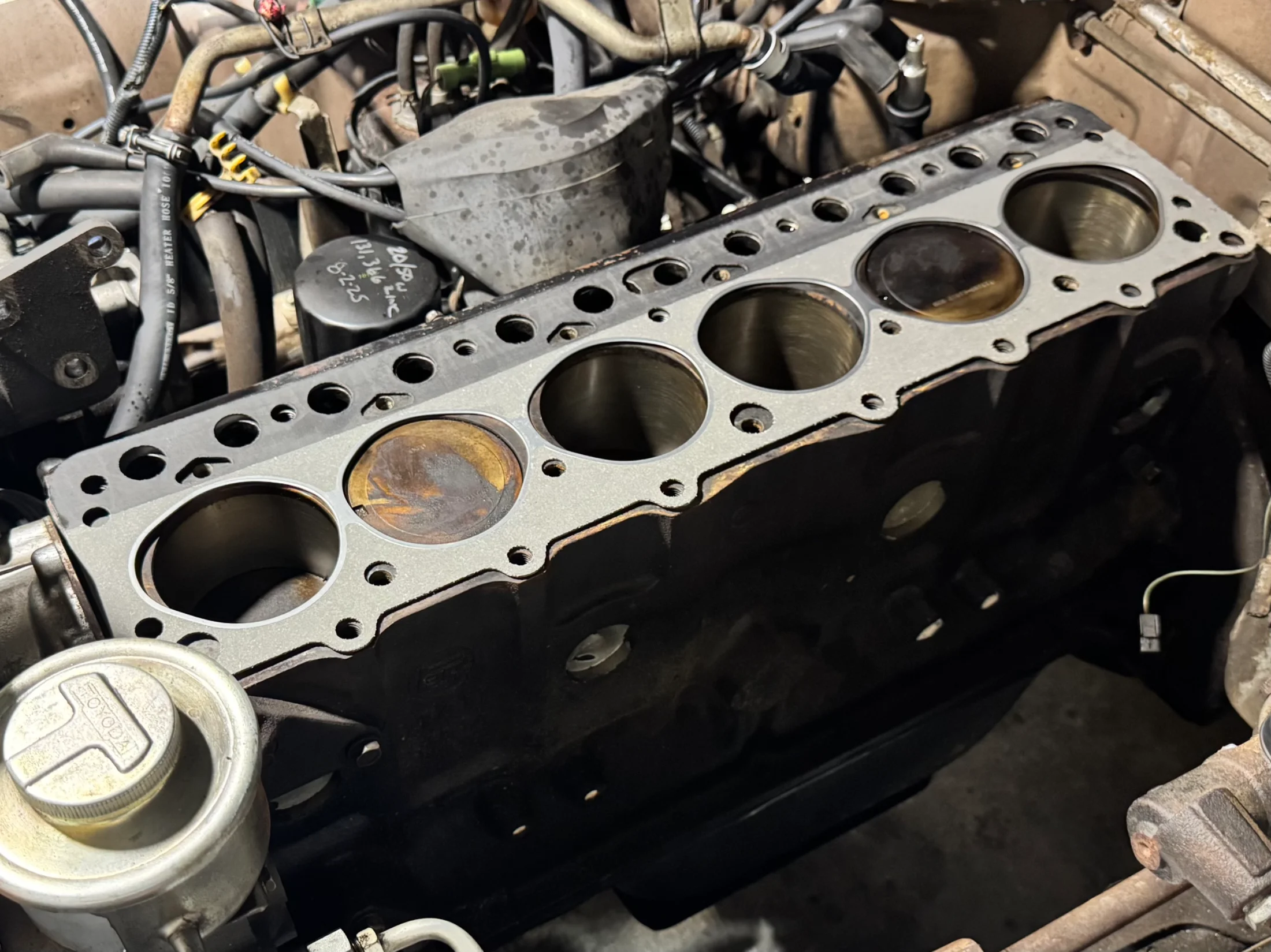

Good save, whew! Dumb question...why are the head gasket holes around the cylinders not round like the cylinders? @FJ60Cam
Think the gasket matches the chambers on the head?
Good save on the F / 2F HG.

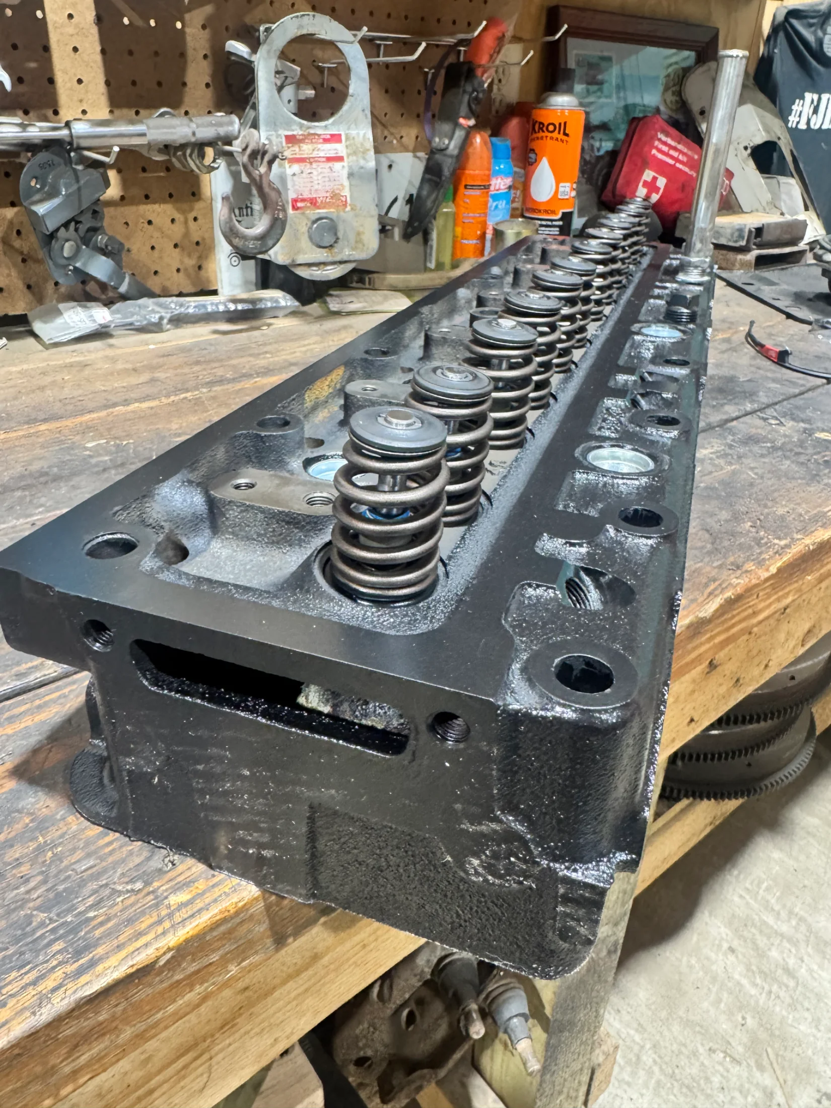

I'm not sure the specs of the HIPo head but wouldn't a different cam also be required to pair with it? I'm assuming the valve train is spec'd different with stiffer spring rates and valve durations. Does the HiPo head have more/less combustion chamber volume? Head gasket thickness (compressed) can be a factor?
To get the full pull out of the heads it's best to have a cam and bigger pistons but I ran one on my blue 60 on top of a stock 2F and it was great.
More compression as he shaves them down a bit as well.

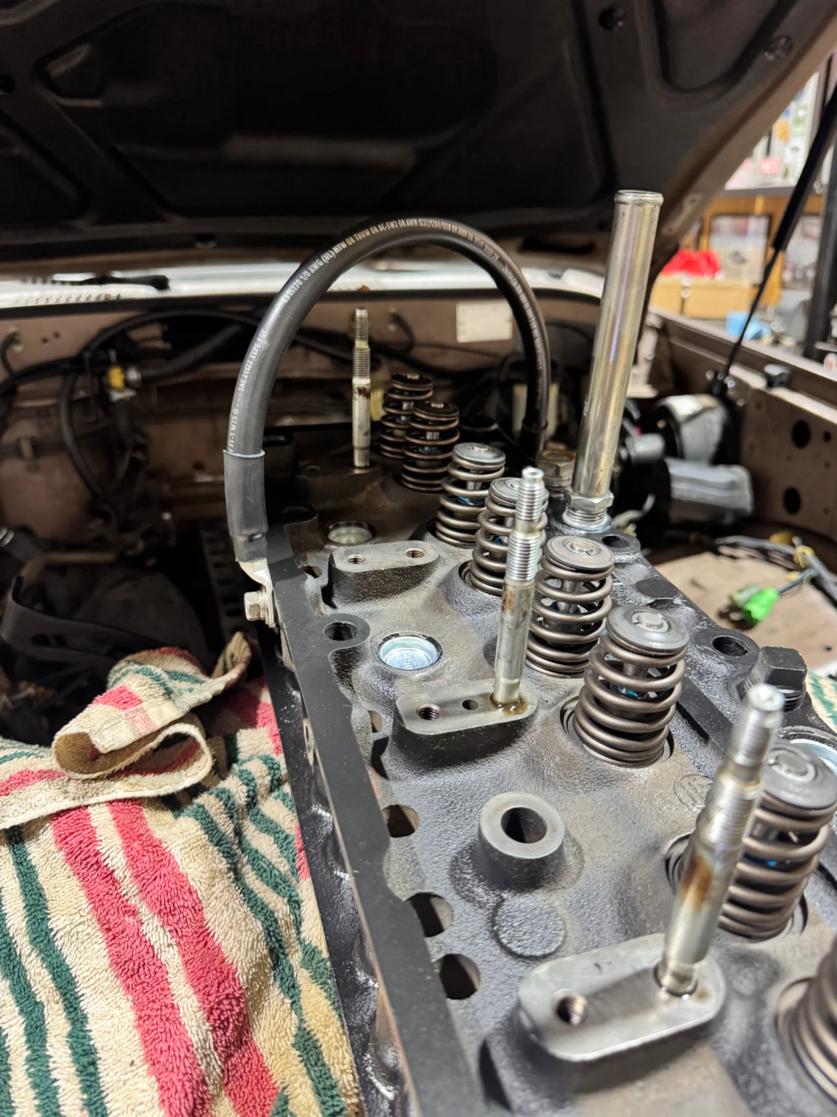

Thanks to @FJ60Cam for letting me pluck a Hi Po head out of your stash. I was able to hit the gym, my favorite restaurant Las Tortugas for a $50 lunch and grab the head drive home and stab it by 6:30. 💪
Pro Tip if you are putting a head on solo. Battery cable across the rear. Left hand in the thermostat hole

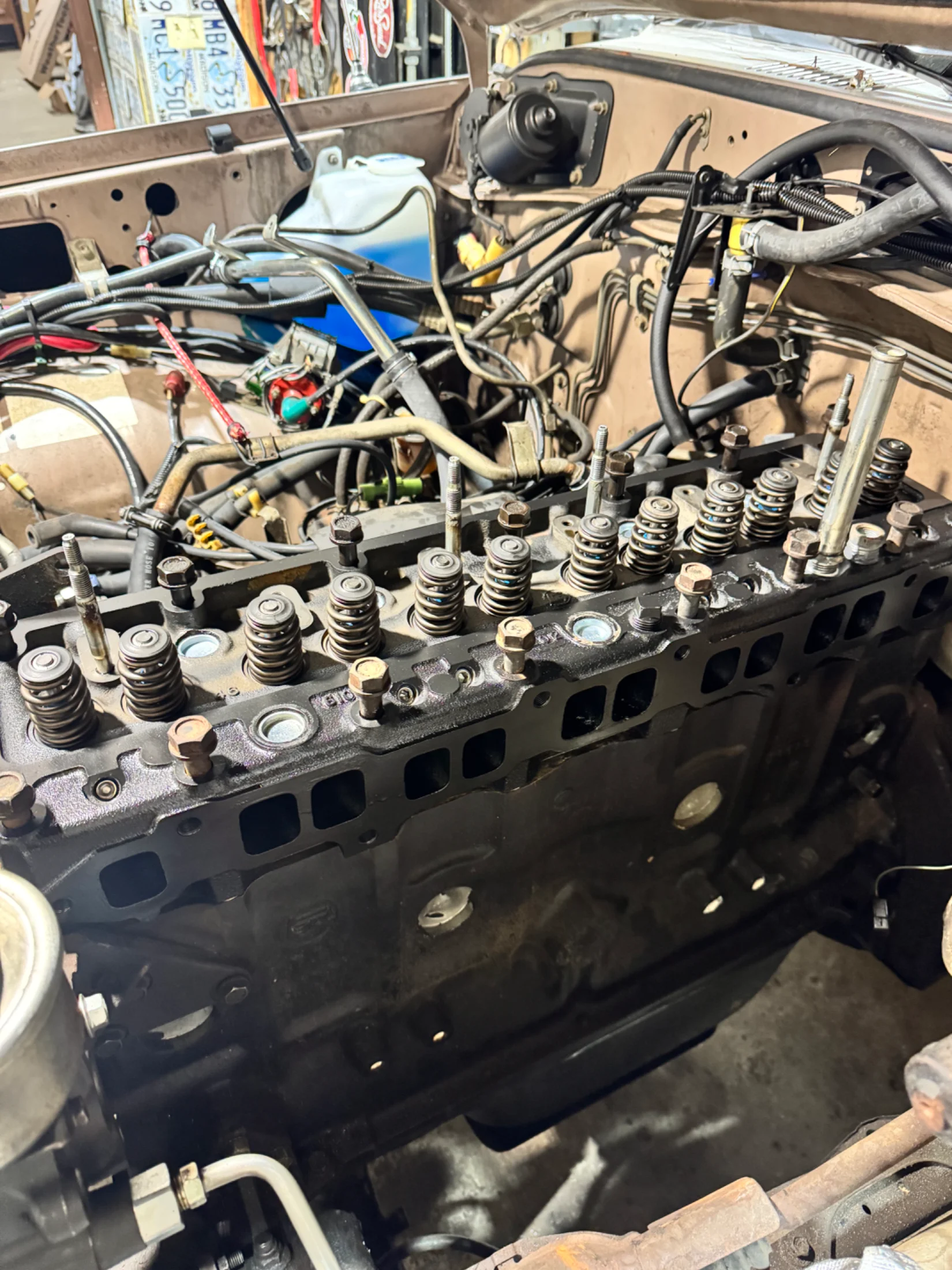

Photo evidence I did not install backwards
In place. Torqued to 90#
Top tip on the battery cable!
Also, is that raised heater pipe a custom unit or stock?
Don't recall seeing that setup before
Next time check the part numbers on the gaskets you use, lol.
It was probably tuned to run with the bad hg and now it's good. Just tune the carb again, lean drop test and whatnot.
VintageTEQ sells them
