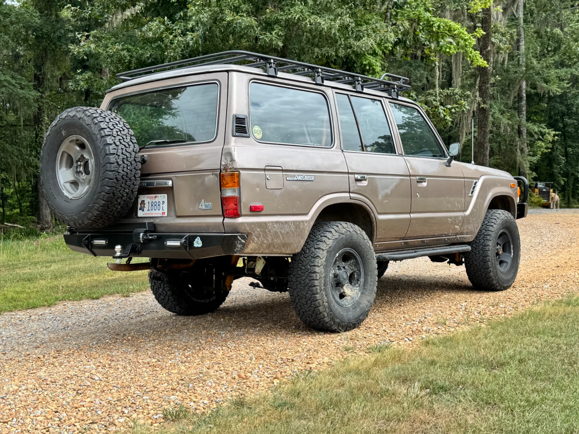

First 60 series I owned. I bought it in 2017 from a guy in the pine straw business in Brookhaven. Seriously, it was almost like he piled pine straw in 10 foot high piles and drove through it all day. There was pine straw in every nook and cranny in that body (including the front inner fenders being FULL of pine straw!) If a spark had ever hit that area, I'm pretty sure it would have exploded like the Christmas tree on Christmas Vacation
Sawbones is back in the house after 3300 miles of smiles.
Another pile of pinestraw has shaken loose

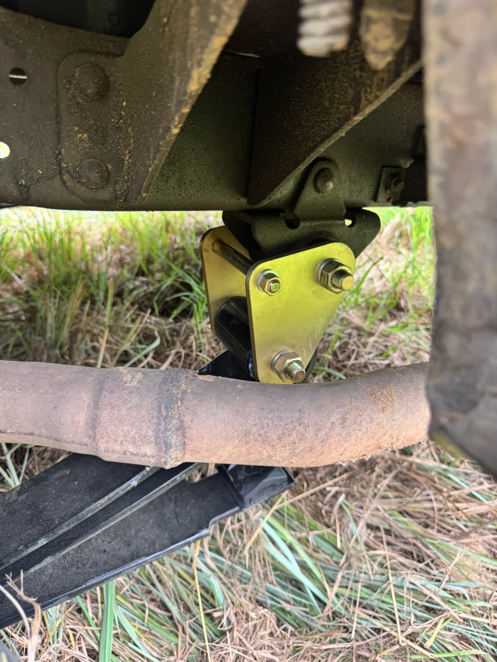

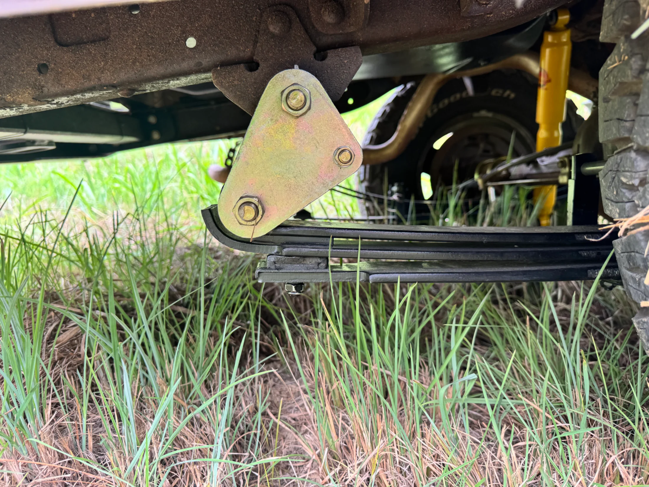

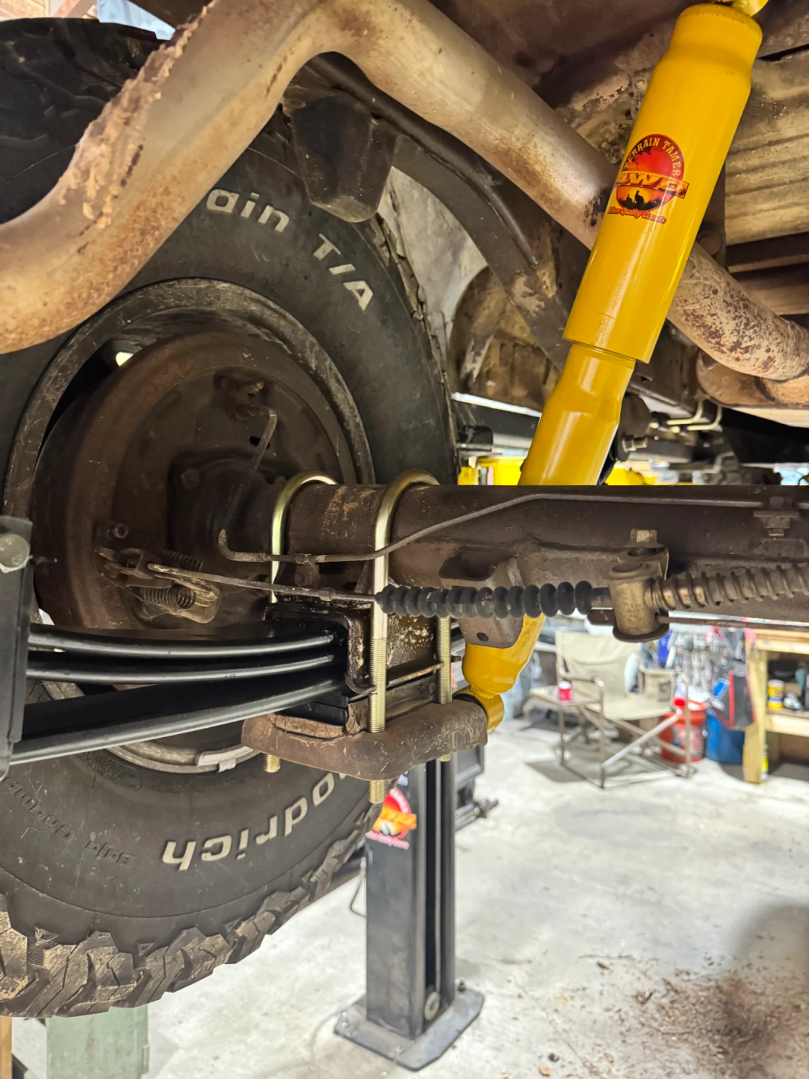

The rear installed nicely. Unlike some others I always install the rubber isolators on 60s.
Done. Looking good. Loving these parabolics.

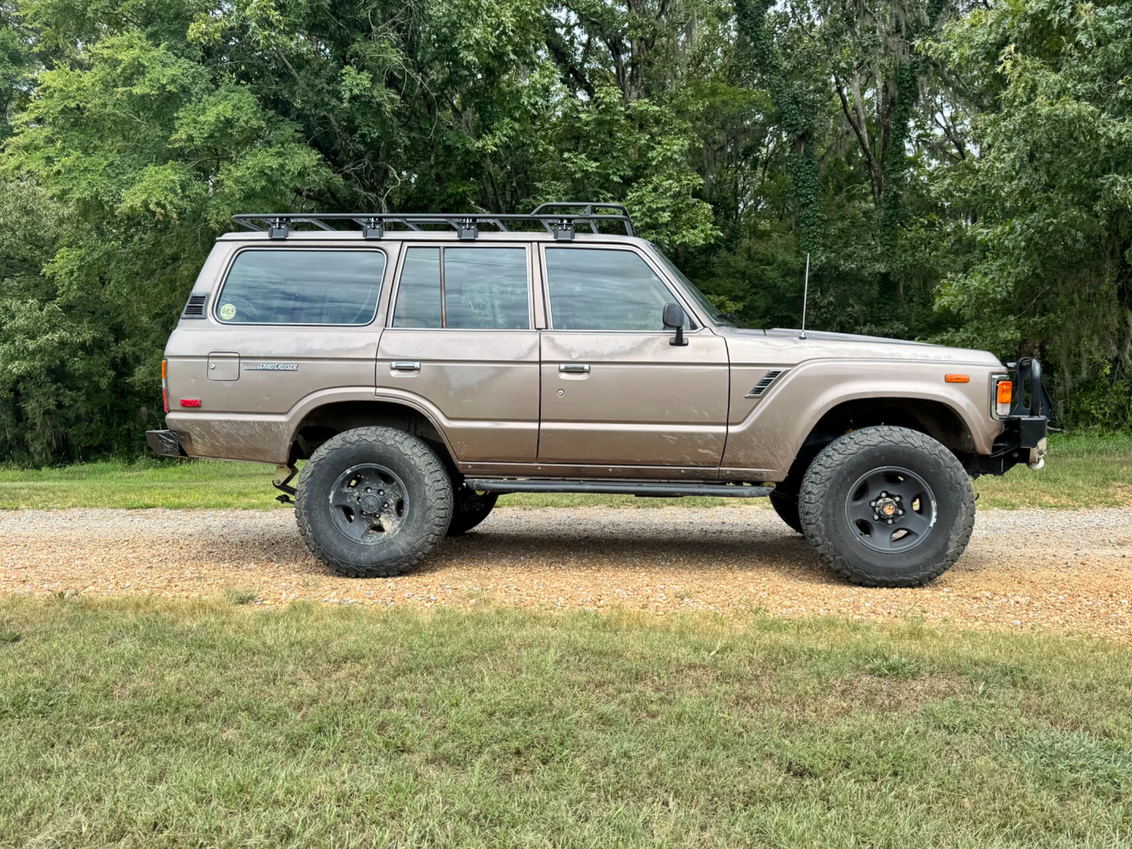

Took the clapped out OME with 2" lift shackles and no caster correction

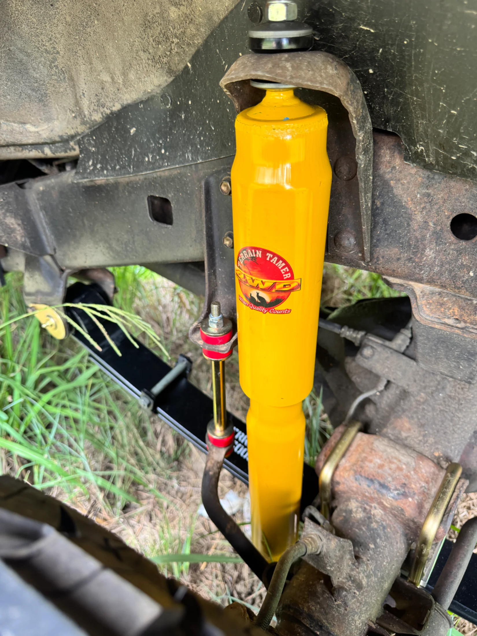

Got the front buttoned up with new sway bar links
New stabilizer

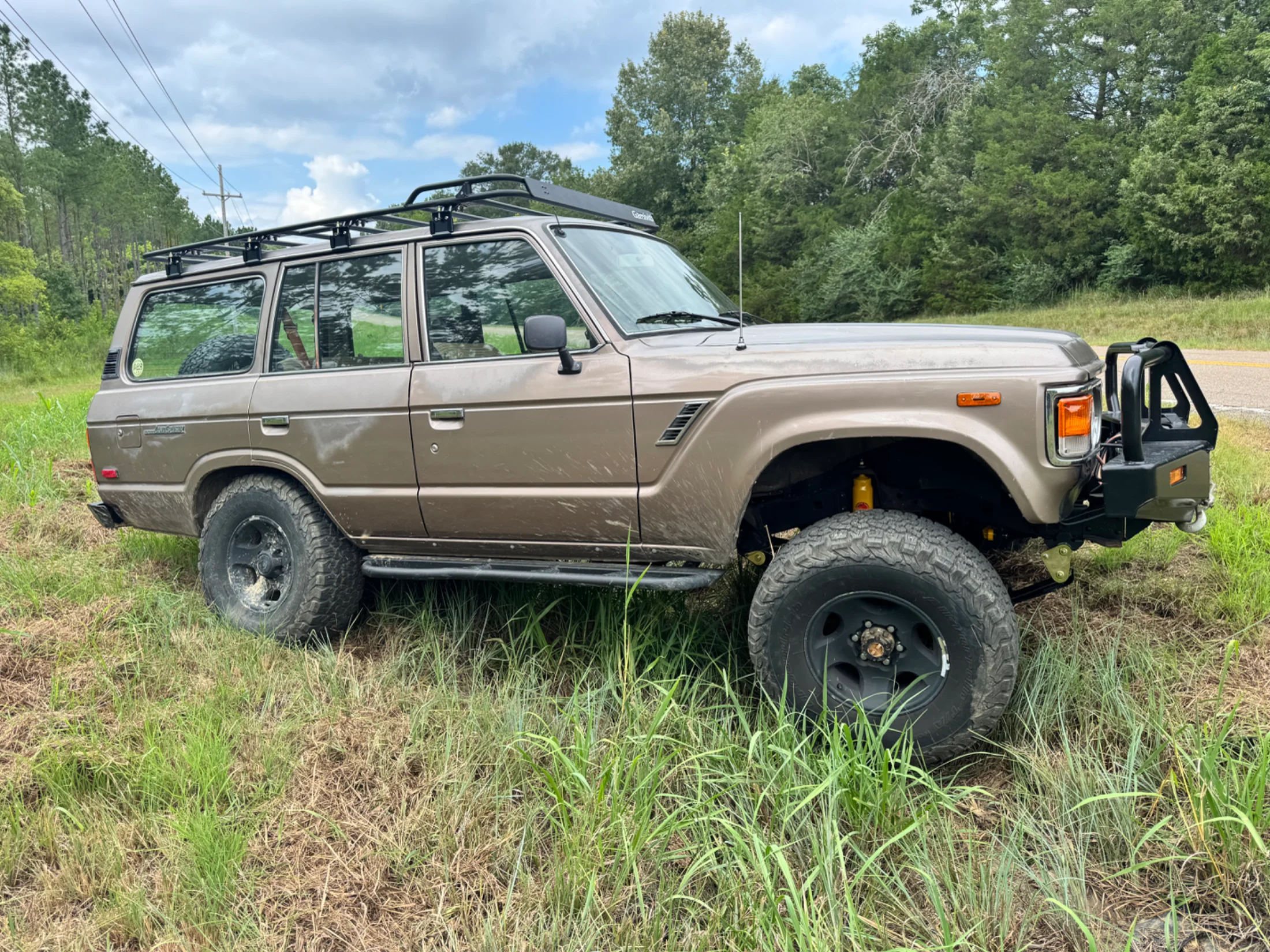

Went and twisted it up and everything cleared nicely.
These things ride amazing. Totally sold.

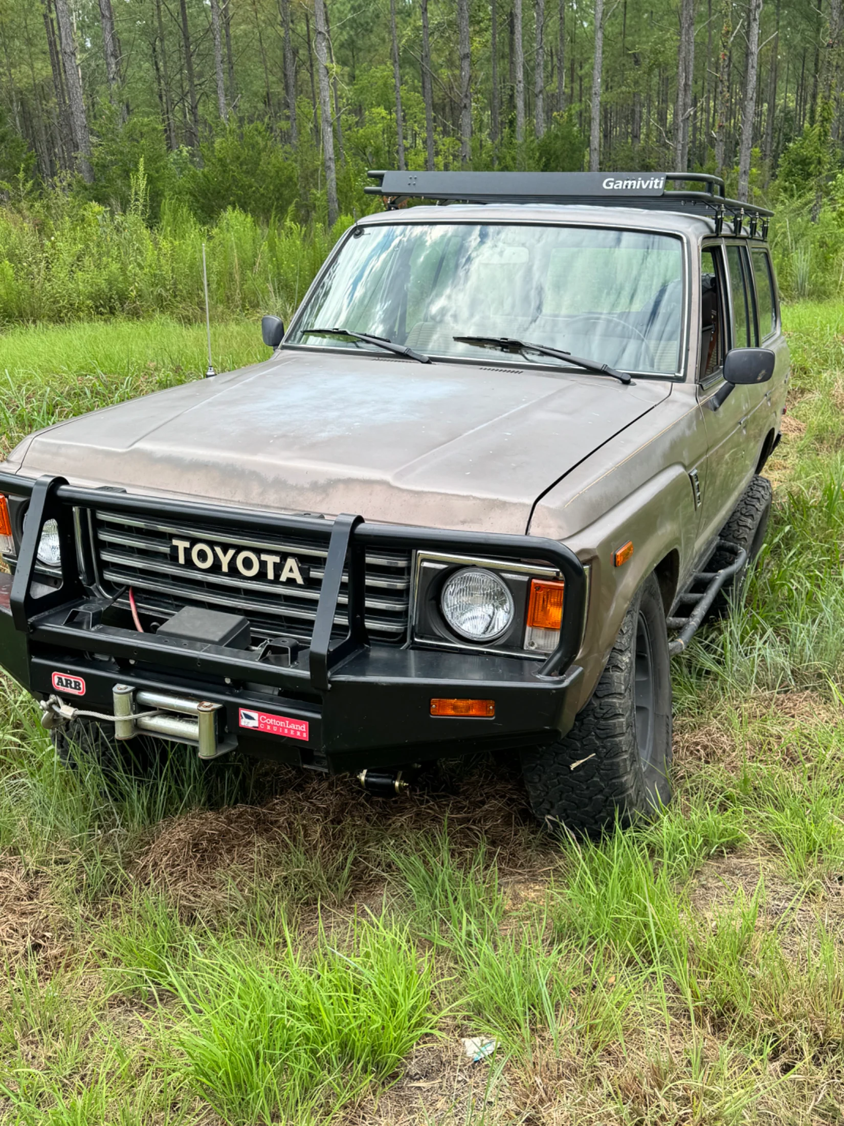

Everyone that follows my threads knows what's what here.......
I actually went into this one so hot I may have gotten a few feet of air

Yea you didn't hesitate on that RR crossing one bit...send! So what's up with the two short chunk plates under the leafs?
The packs are ridiculously thin without them. They are just there to make the Ubolts work.
On the FZJ70 I installed them on I moved them from the bottom to the top to get the truck to sit level
I've never been able to get 90 ftlbs on u-bolts while using the isolators, they just get squeezed to death. Do you have a different method?
I just put full ugga bugga on them with my impact. Never had them loosen up and I've done a bunch of 60 suspensions.

I know you say it rides good now, but from long-ago experiences, I still cringe when I see yellow shocks (without a blue boot) on anything. Makes by back hurt!
Sawbones was a good 'ol truck. Glad to see it's living its best life.
I was planning on hating the terrain tamer yella shocks but they are much better than OME. Much.
That said it's really these springs that are the game changer
