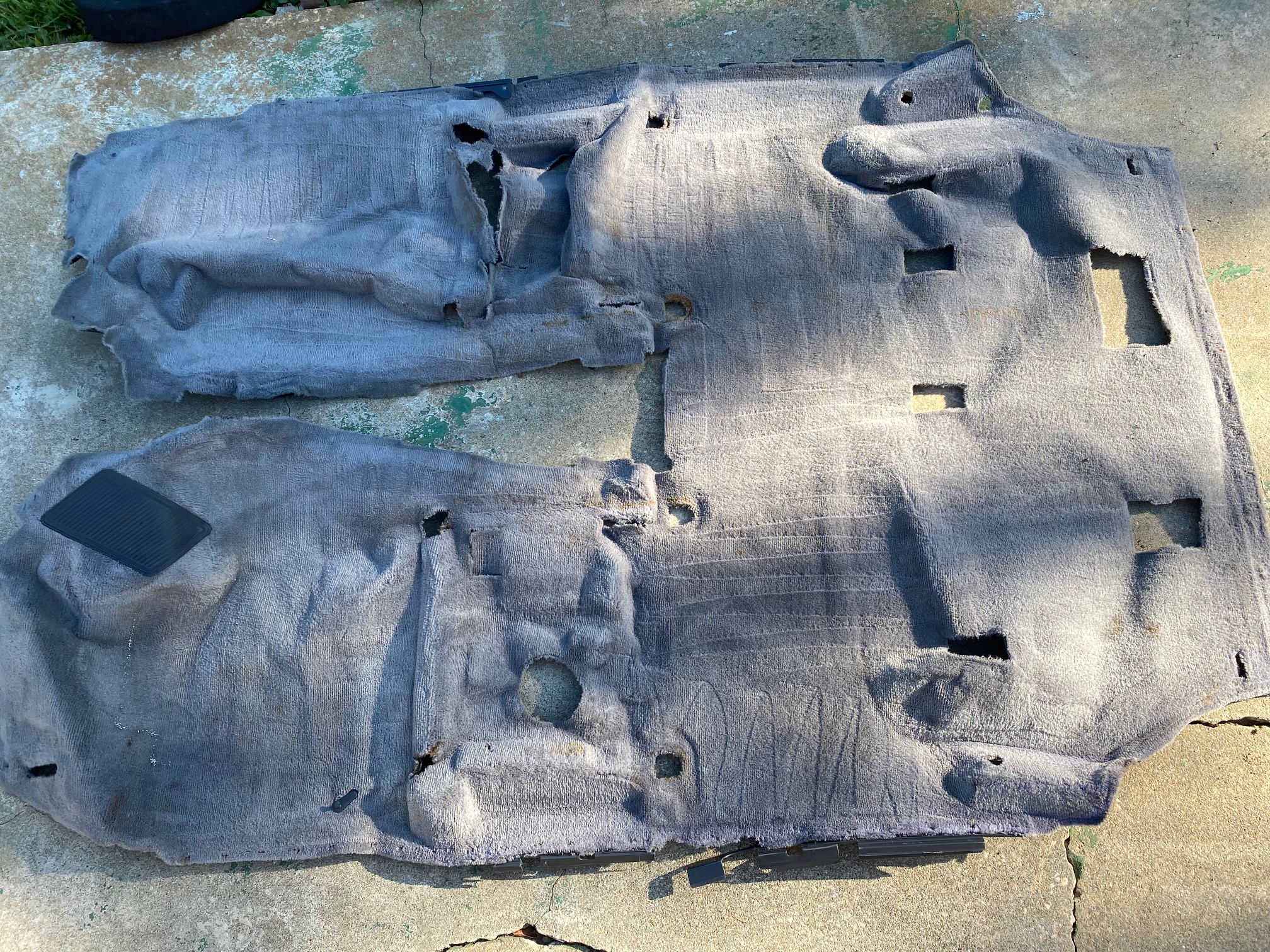

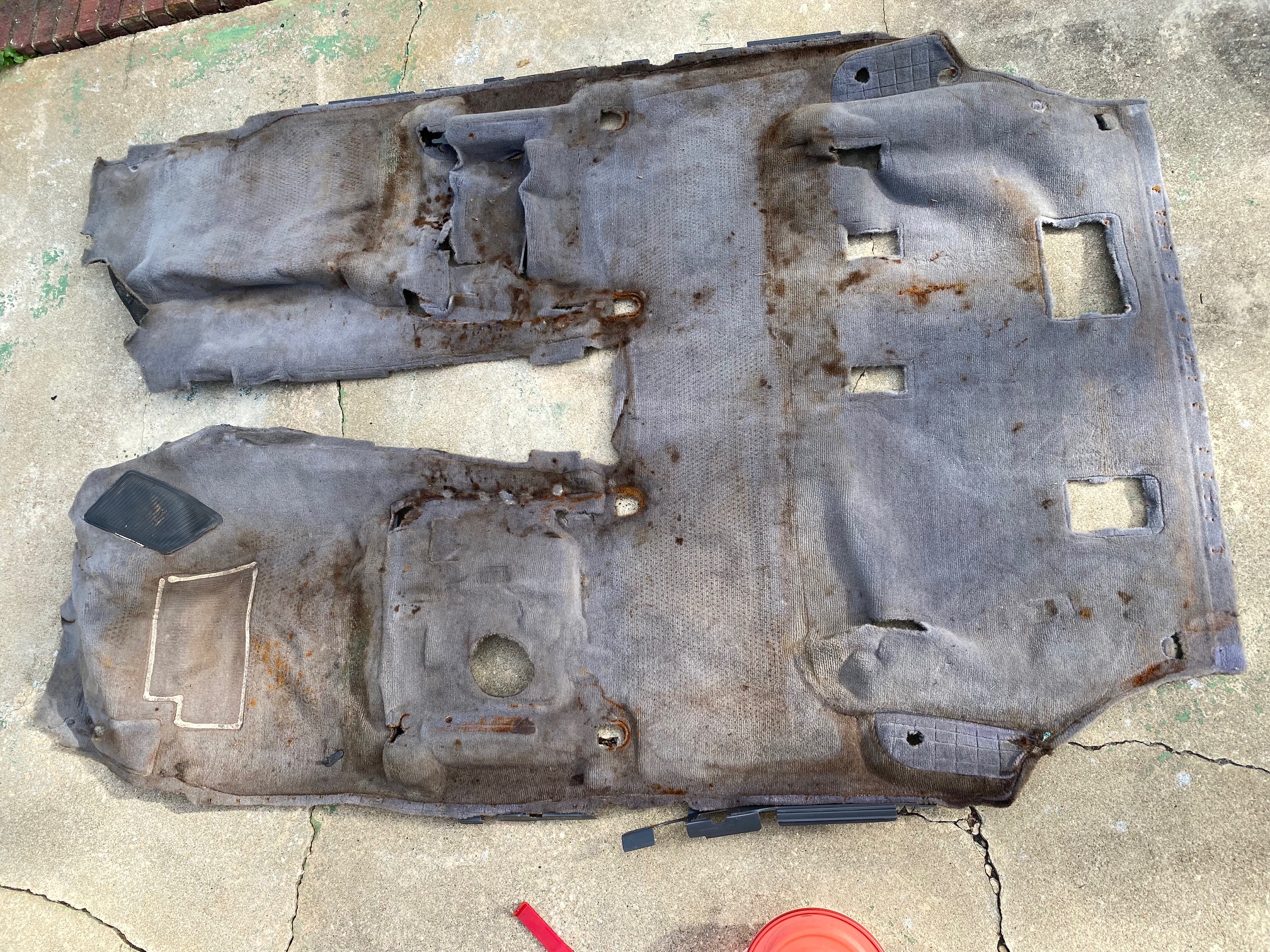

So here's the method I used. I first soak down the entire carpet with water, and then liberally apply a mix of dawn dish soap and powdered "oxiclean". Let that soak in for about an hour, then pressure wash with plain water. I could not believe the transformation! The carpet looks almost new now, and after it dried, has no smell whatsoever. here's the before and after.

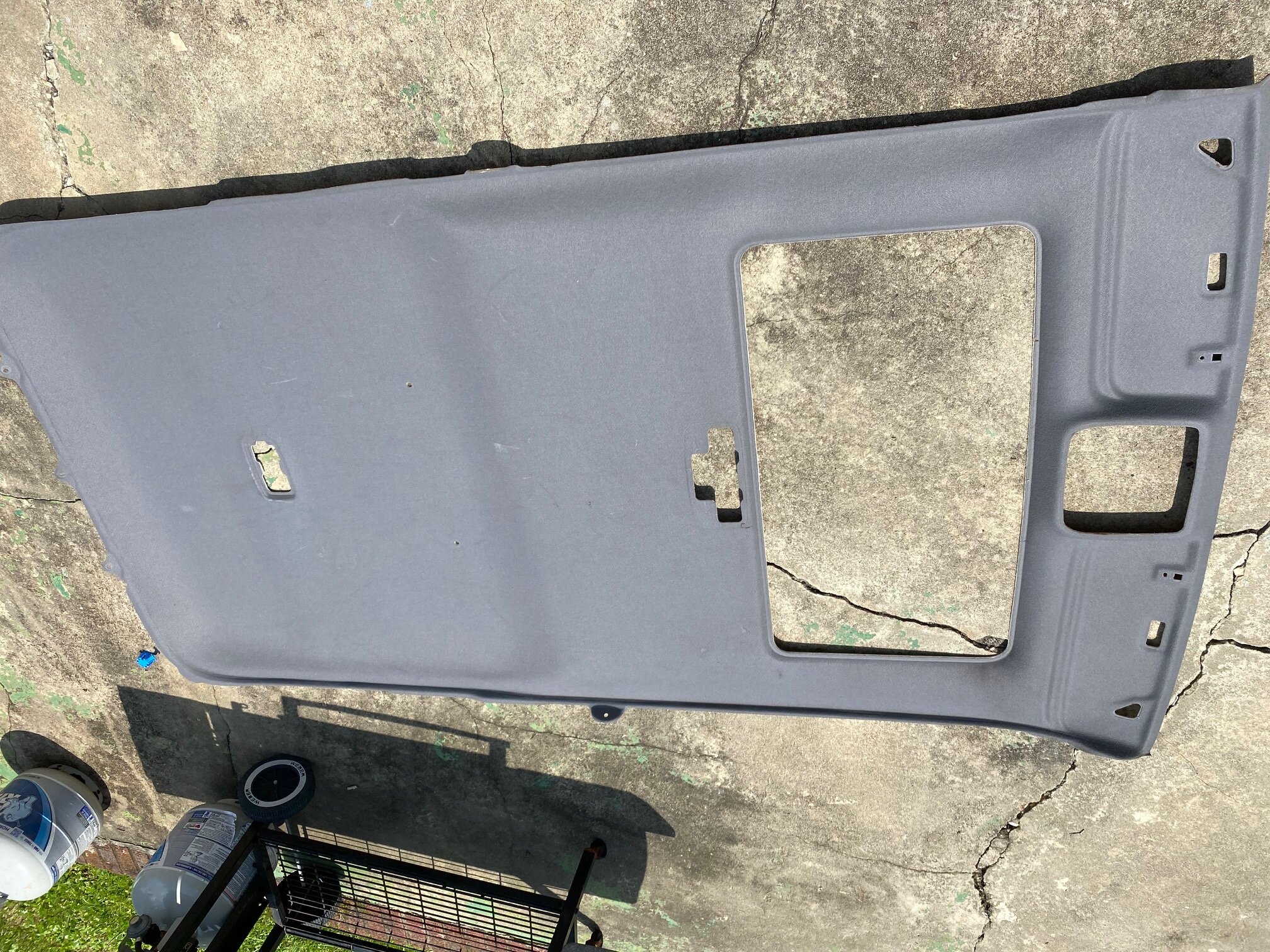

I also fully cleaned the headliner. This has to be cleaned more gently, but it also came out great. It looks almost new. I used a mix of warm water and oxiclean, applied gently.
Nice job all the way around. I did the same in my LC a couple years after purchase and used the same ingredients to clean the carpet.
