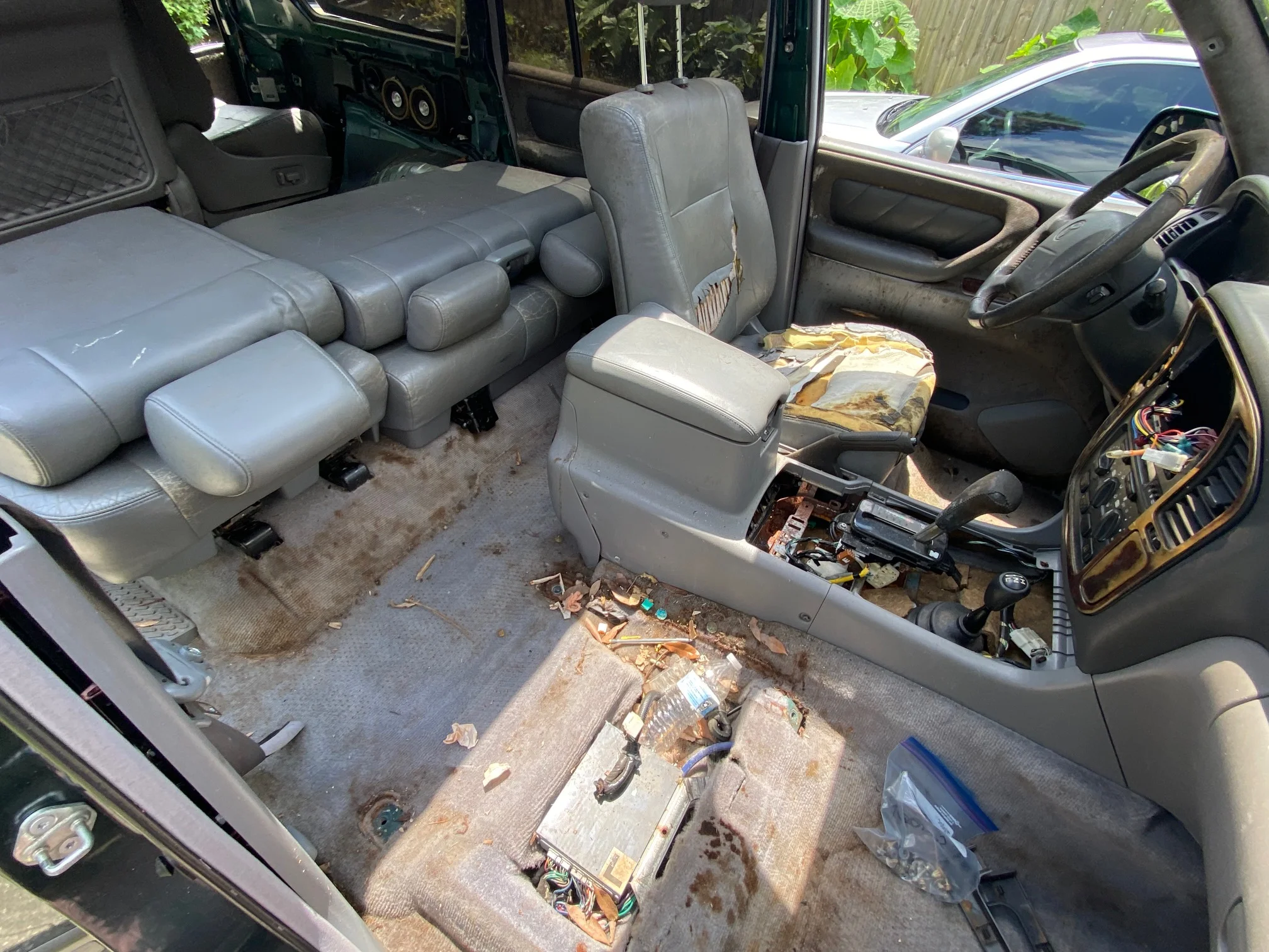

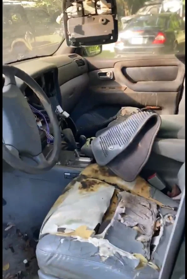

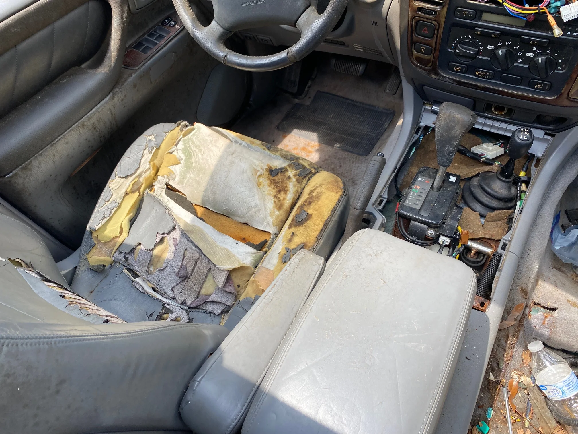

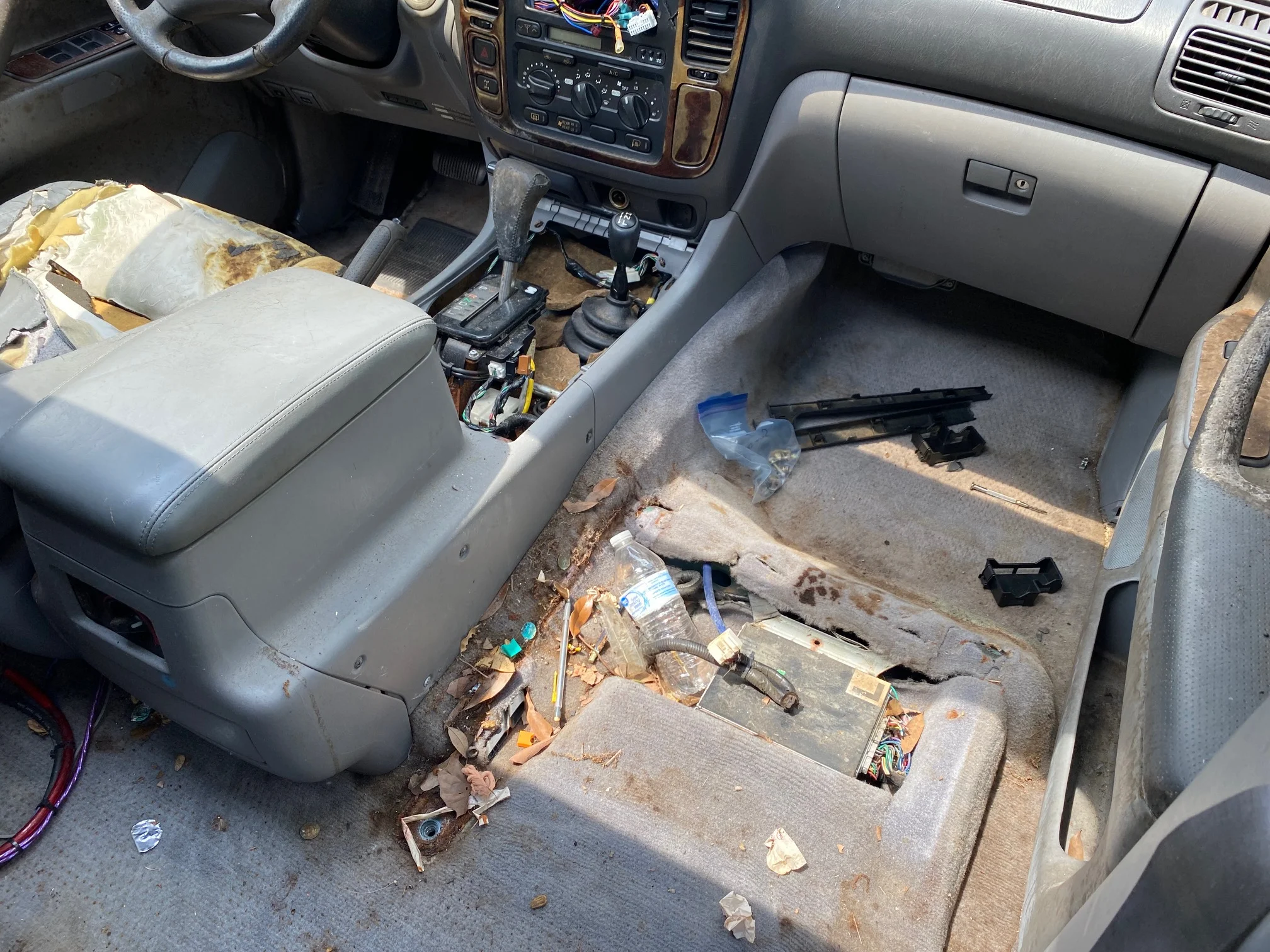

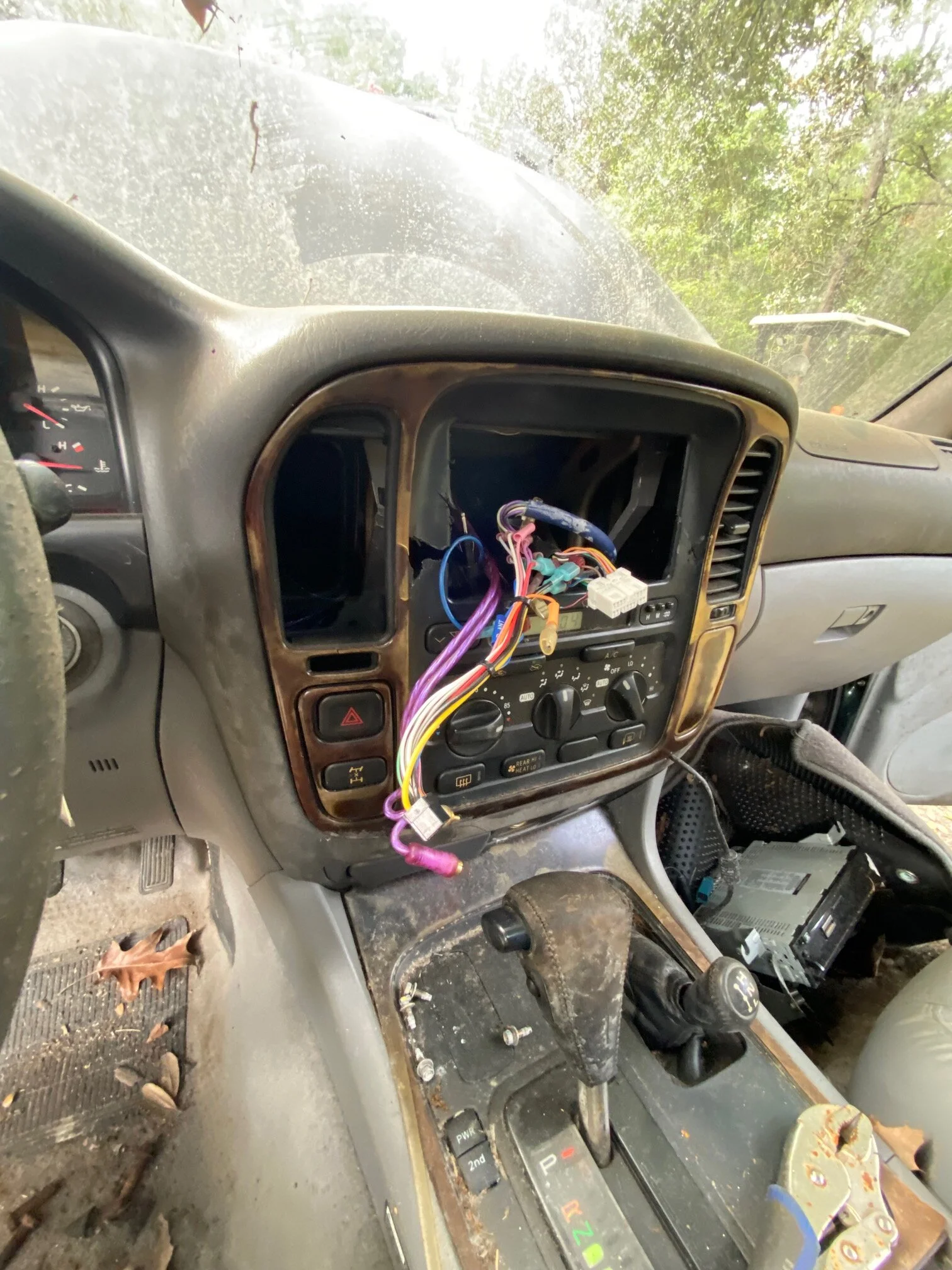

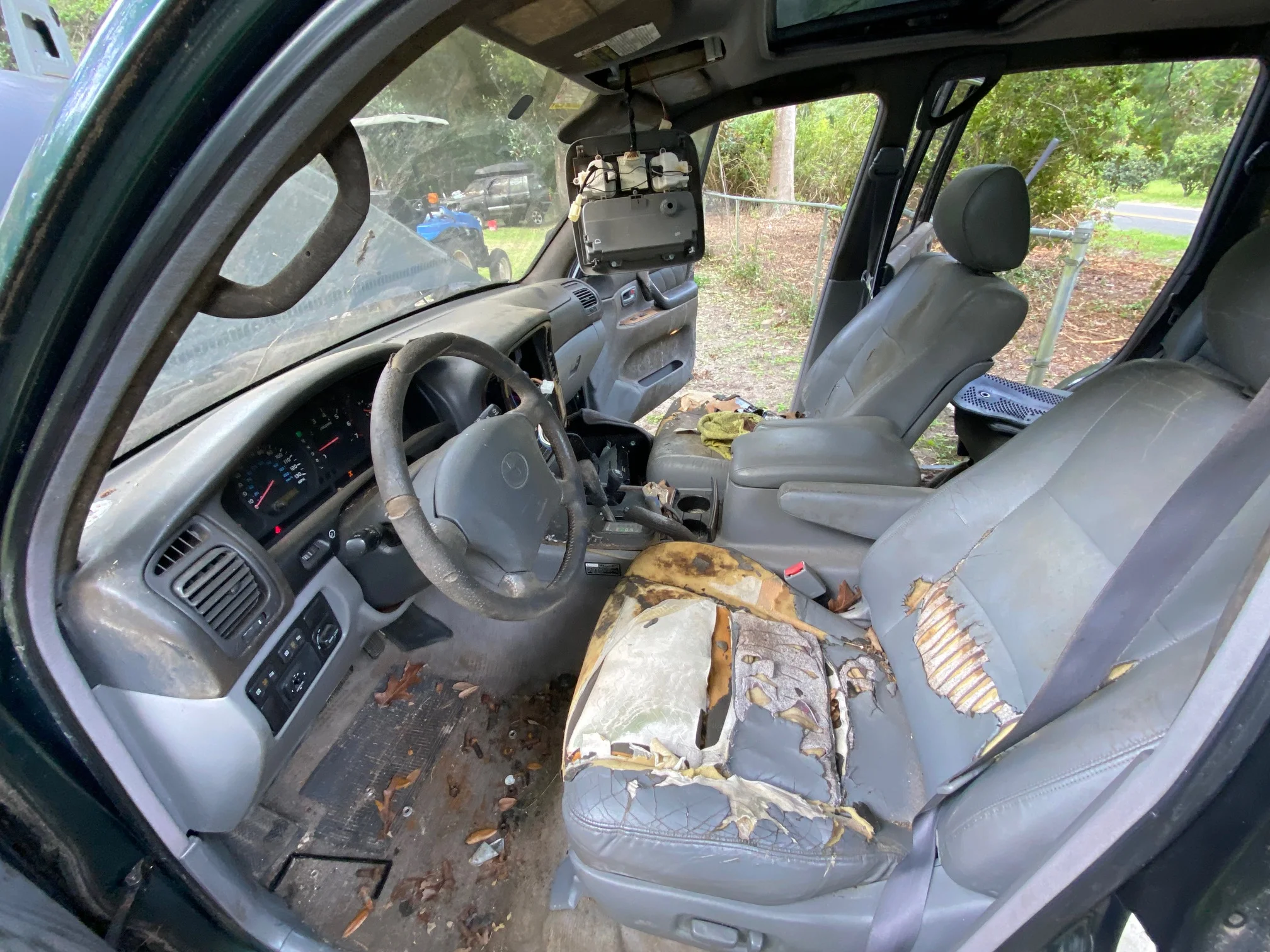

The bad: Well, where do I start? Interior trashed. It almost looked like someone locked a rabid wolverine inside and it tried to chew its way out. Someone had stolen the radio and possibly other things, including the Catalytic Converters unfortunately. The paint has seen better days, the clearcoat is faded on hood & roof. And then there's the engine. After getting it home, I began diagnosing the engine. It has low oil pressure. I don't know exactly what happened to cause that, but clearly there was something very wrong. Now I am seeing why this thing was given up on

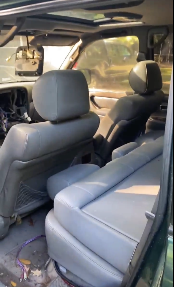

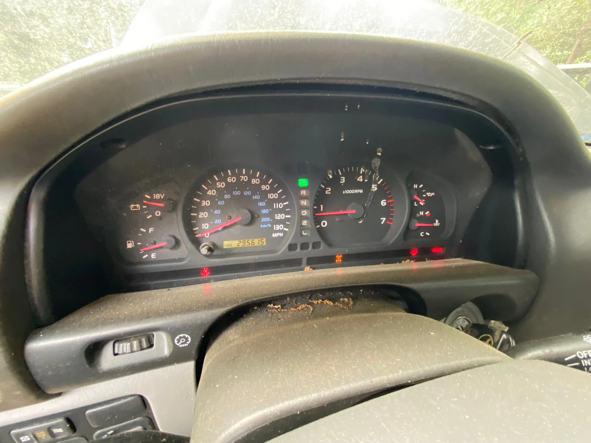

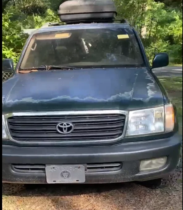

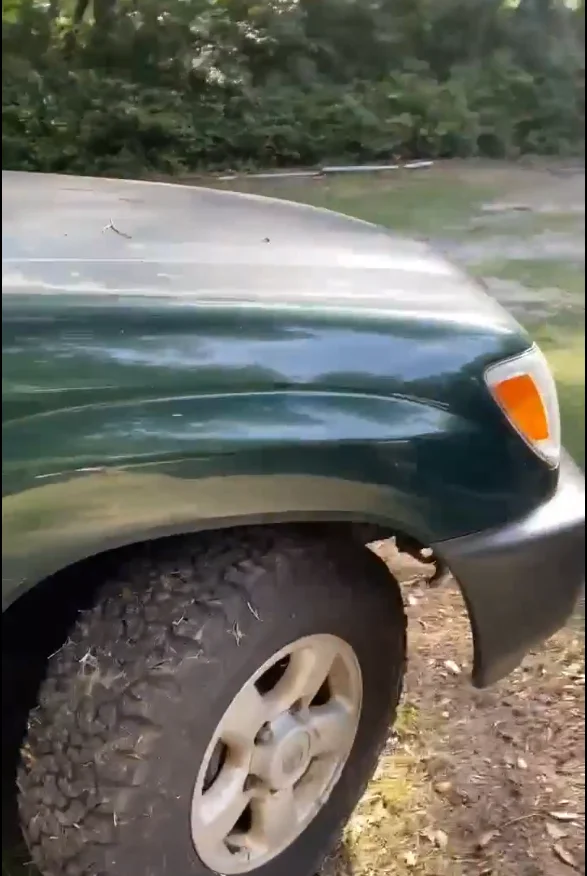

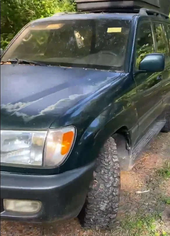

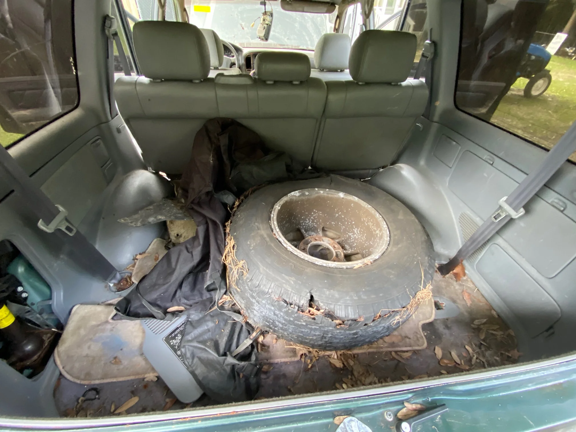

In this thread I will document my attempt to save this truck ! These are few pics from the day I went to look at it.

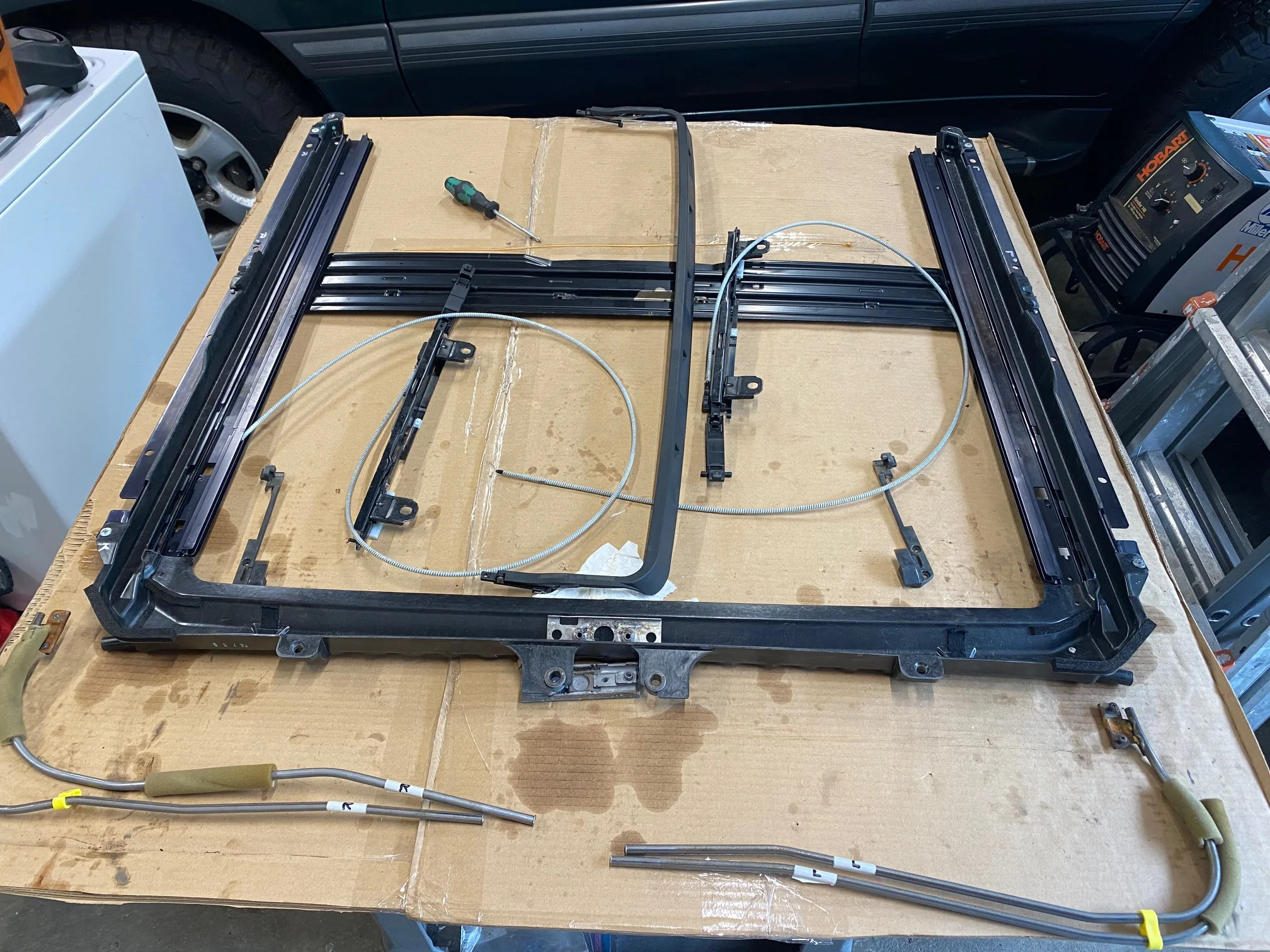

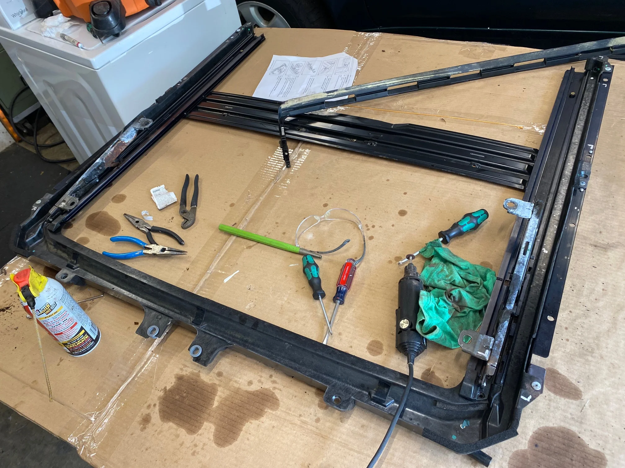

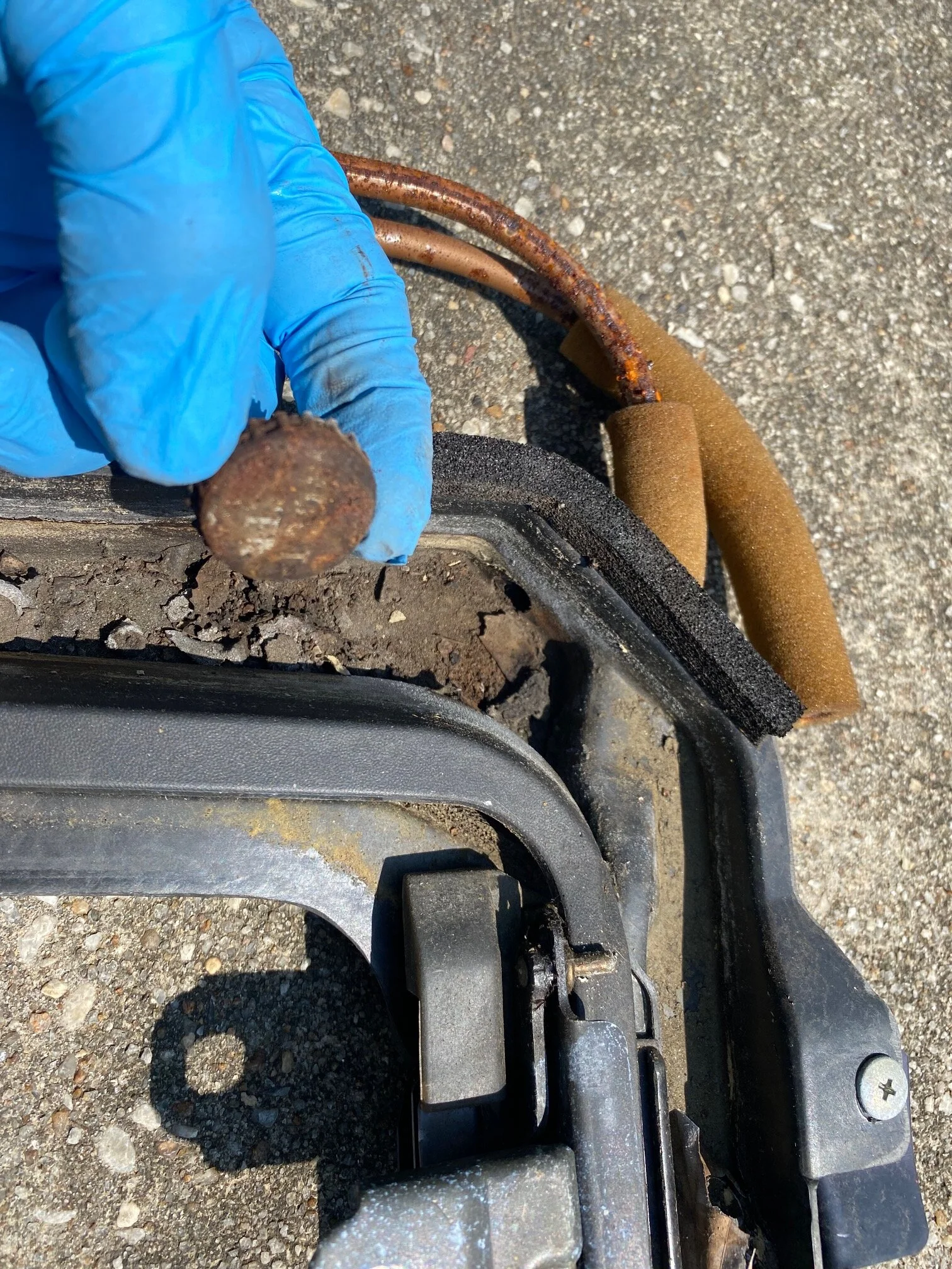

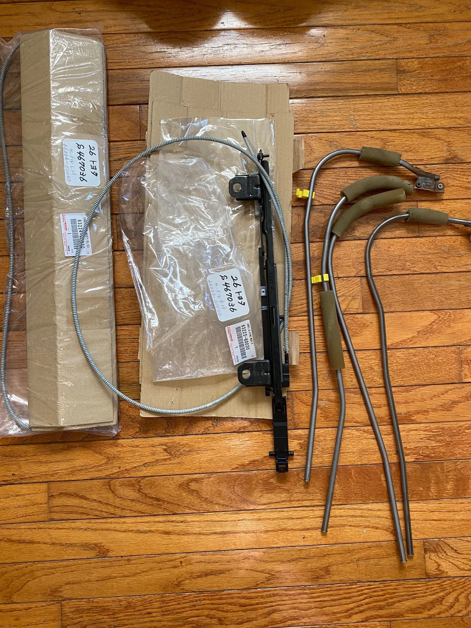

This led me down a bit of a rabbit hole. First, i discovered the sunroof drains were clogged, and of course the sunroof doesn't work. So I pulled the headliner, pulled the sunroof mechanism. I discovered that the sunroof cables were completely frozen. Aamazingly, I was still able to get a new set of cables from Toyota. With quite a bit of work, I got the old frozen cables out and replaced. I found out why the sunroof was leaking, When someone was throwing their beer bottle caps out of the sunroof, they missed and one flew into the sunroof drip tray - blocking the drain. I got this all cleaned out, and re-installed the sunroof. and it works!

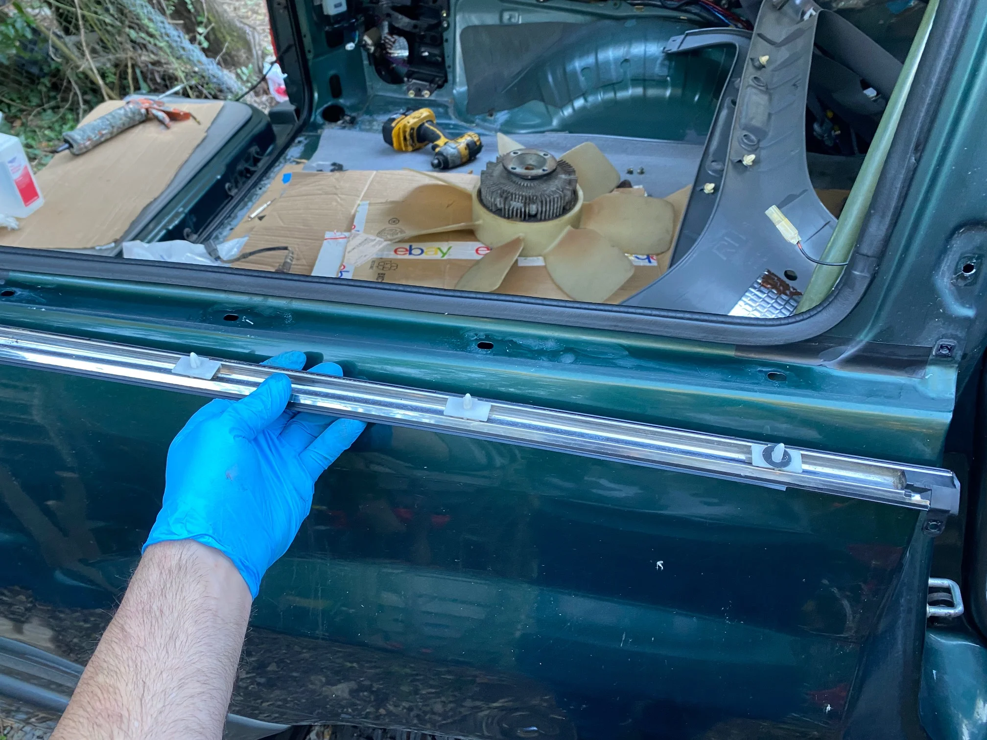

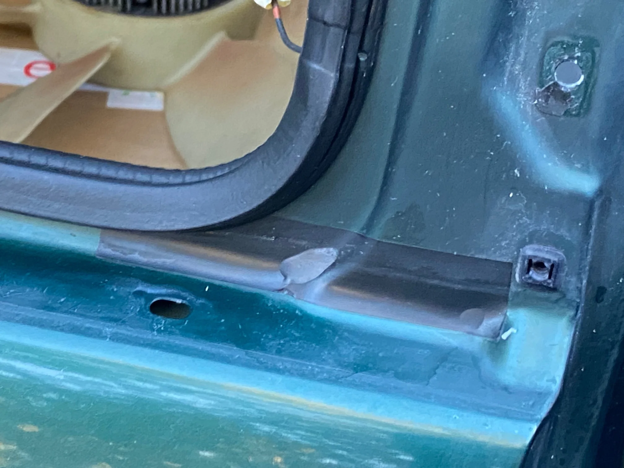

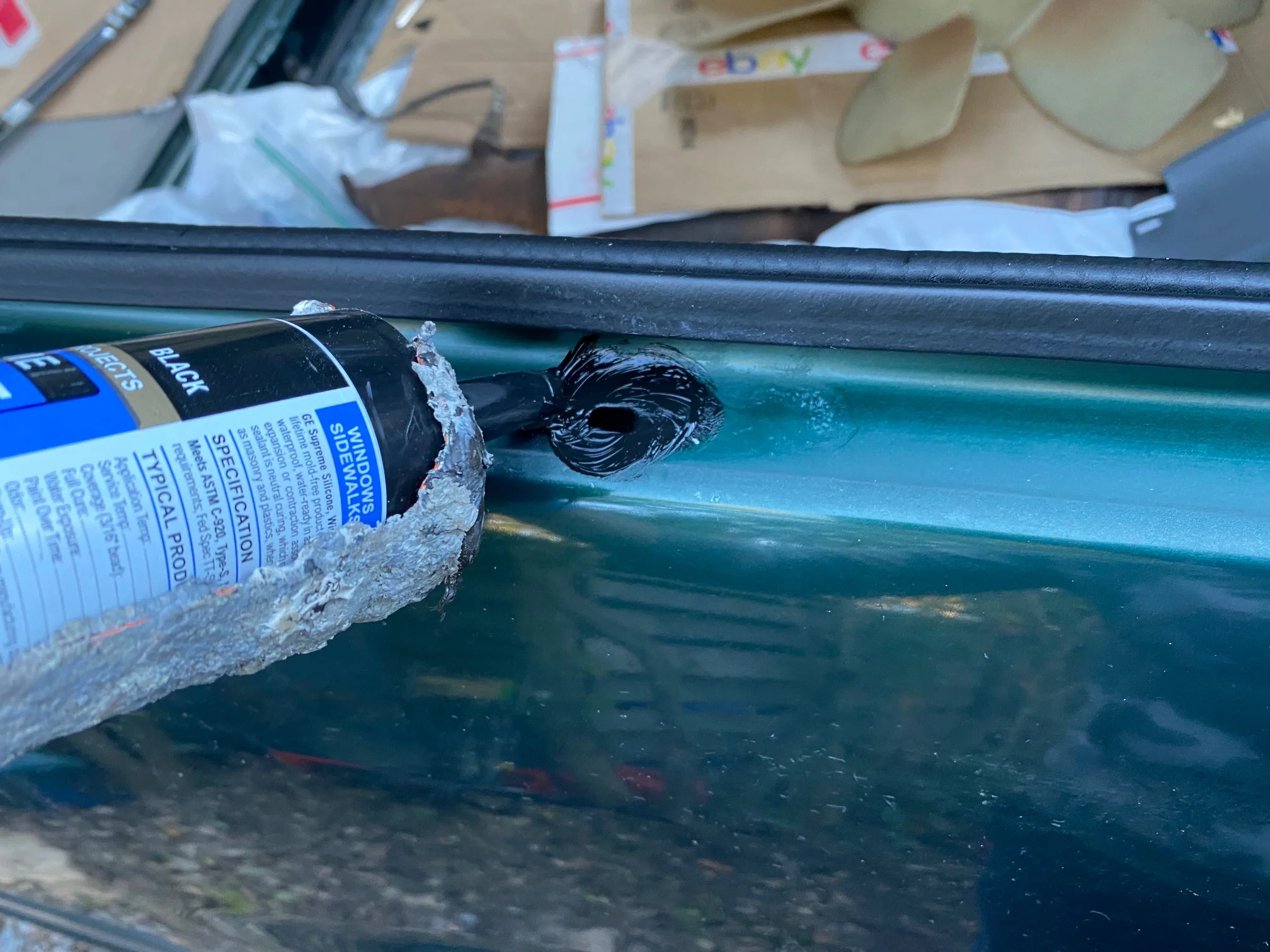

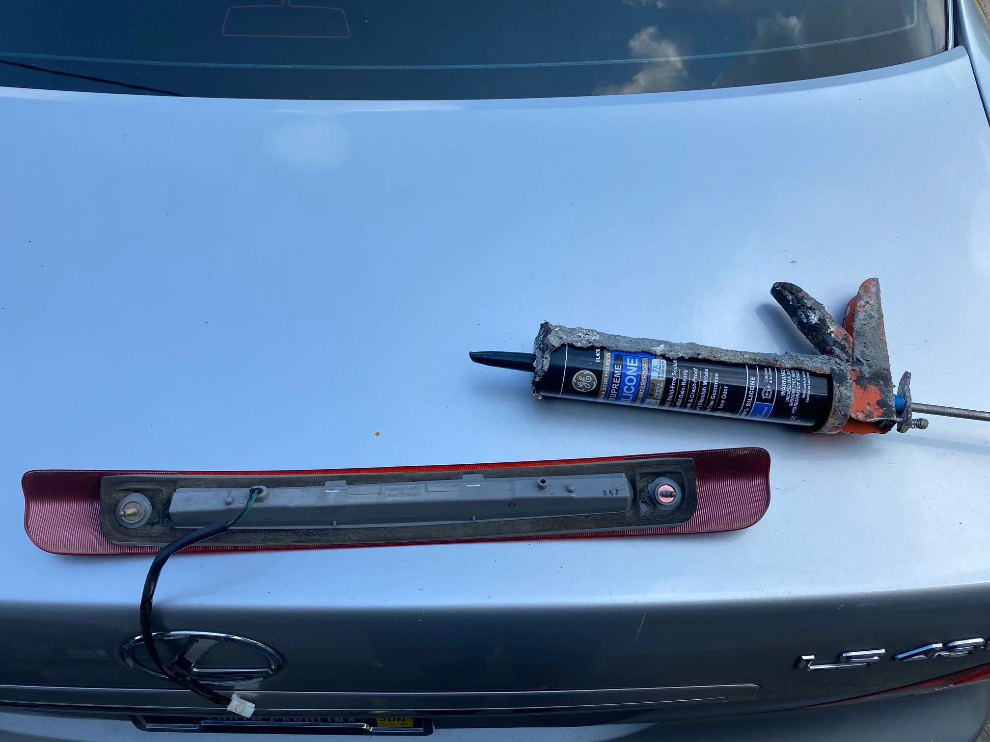

I was still experiencing a small leak in the rear cargo area. First, i tried sealing up the 3rd brake light with Silicone. While the original seal was completely deteriorated, this didn't solve the leak. I next tried re-sealing the drip rails under the rearmost windows. It was really difficult to get at these, because you have to remove the rear glass to access the screw holding in the molding. After all that work, still had a very minor leak.

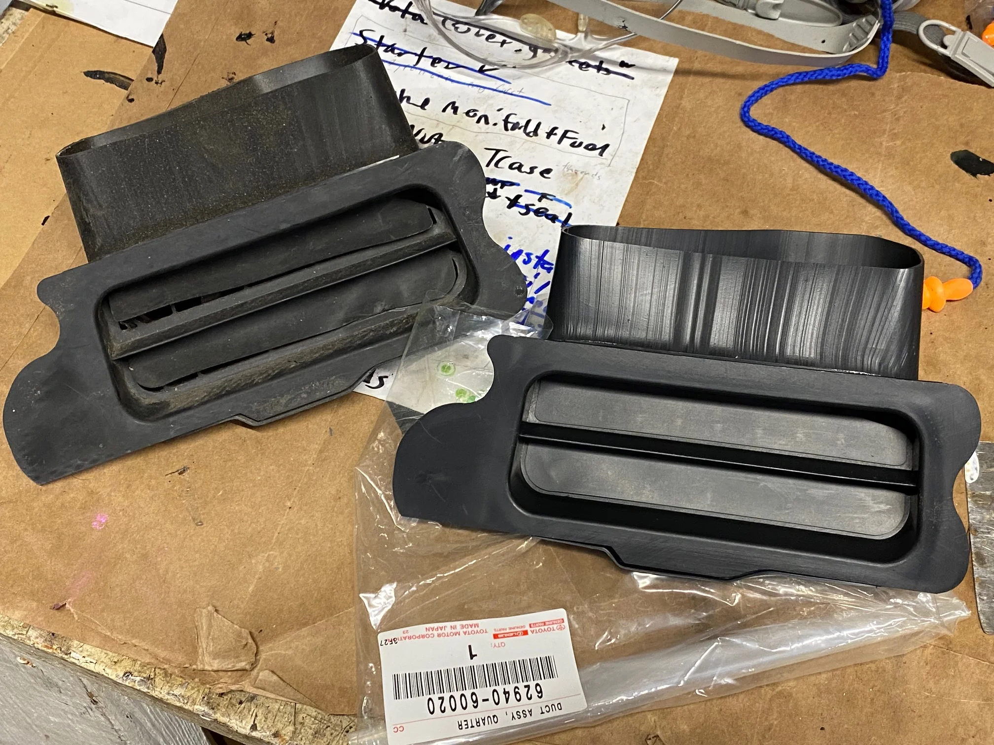

Finally, i traced the leak down to the drivers side rear vent. Over time, the rubber had deteriorated and allowed water to leak down, rather than being directed away. I carefully removed the vent cover and replaced the vent with a new OEM one. Glad to see all these parts are still available. FINALLY leak free! Now, time to attack and clean the interior

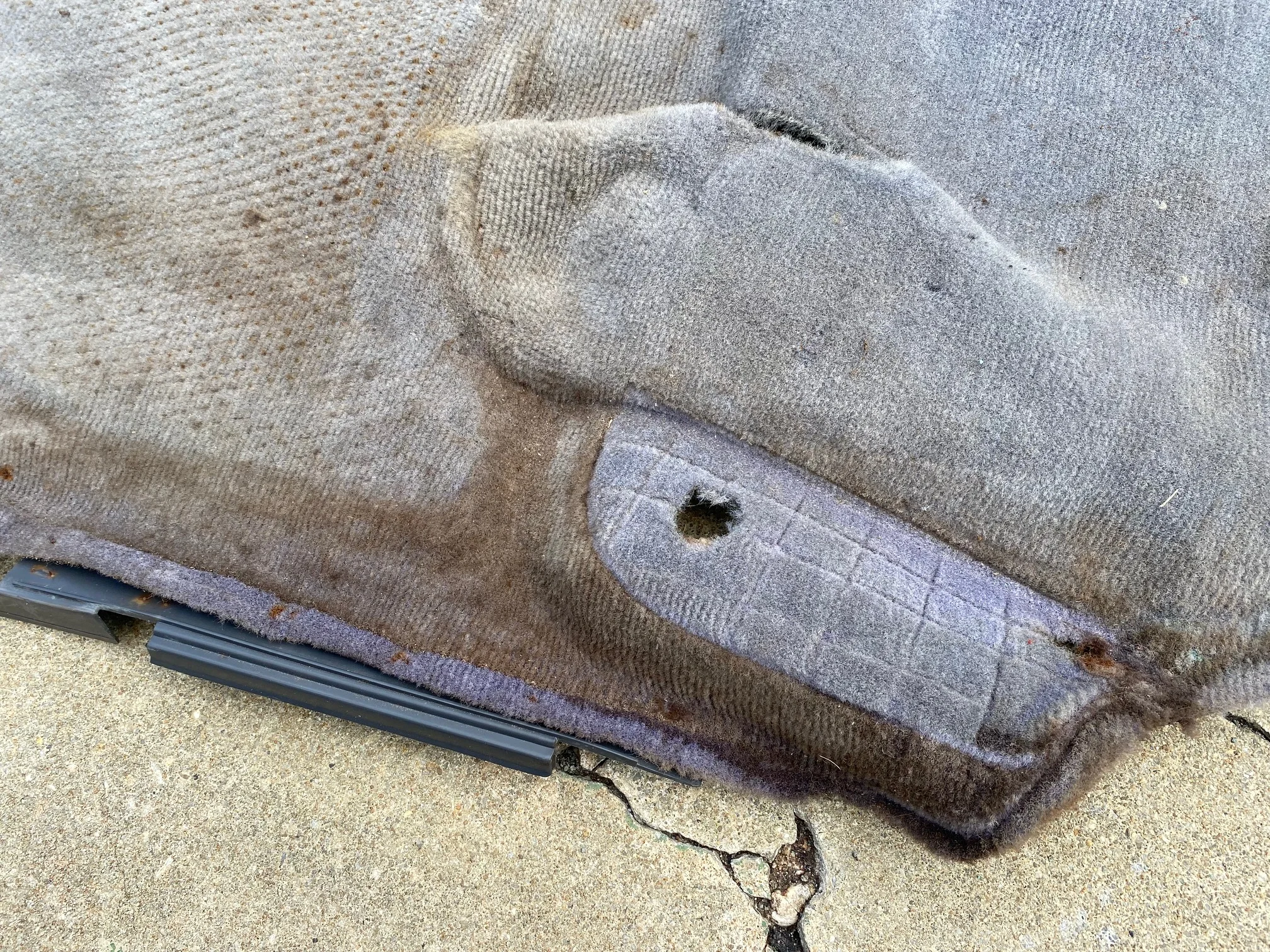

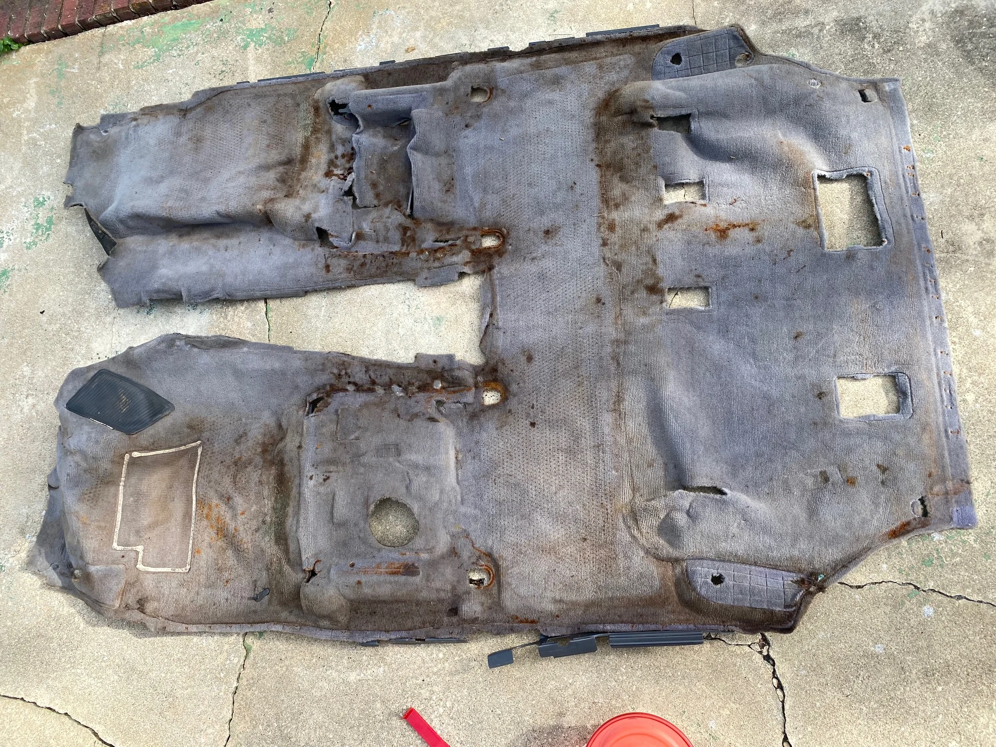

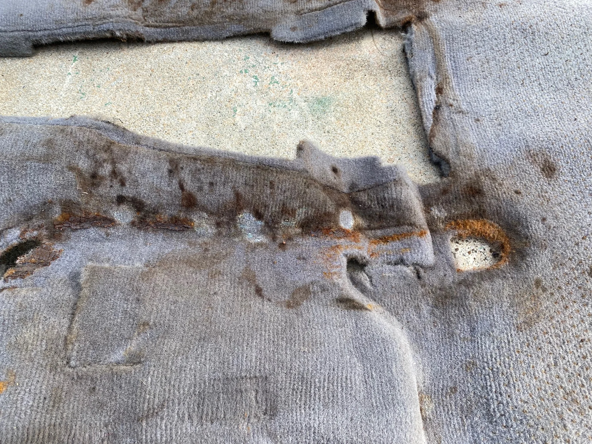

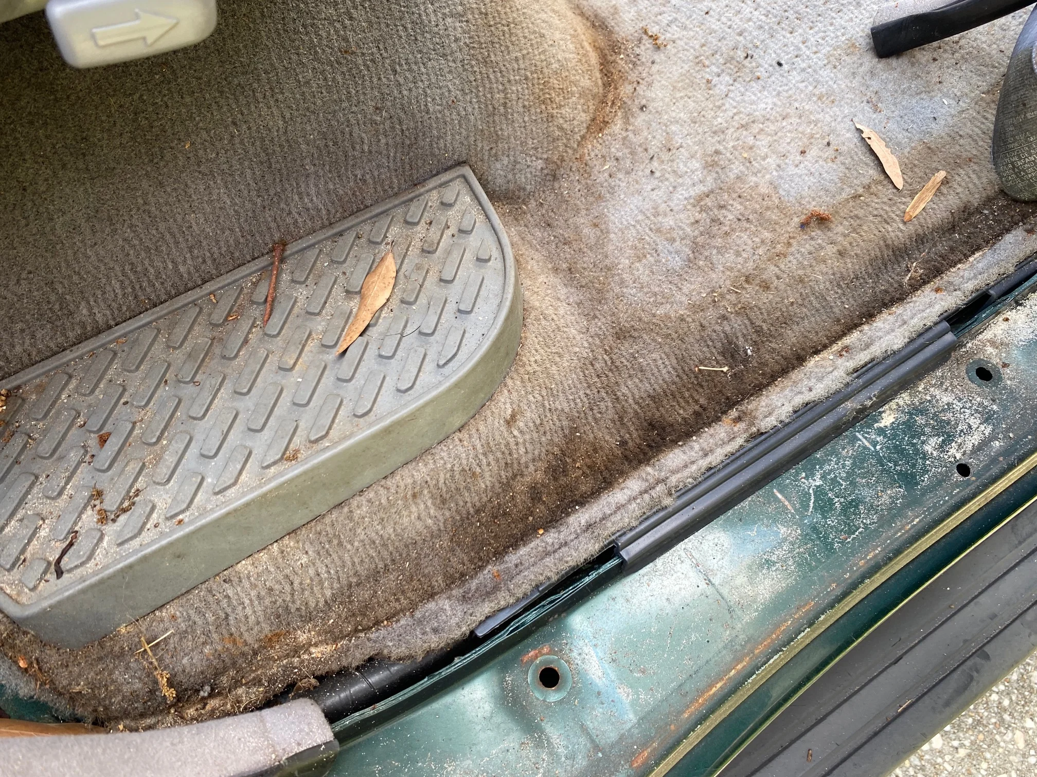

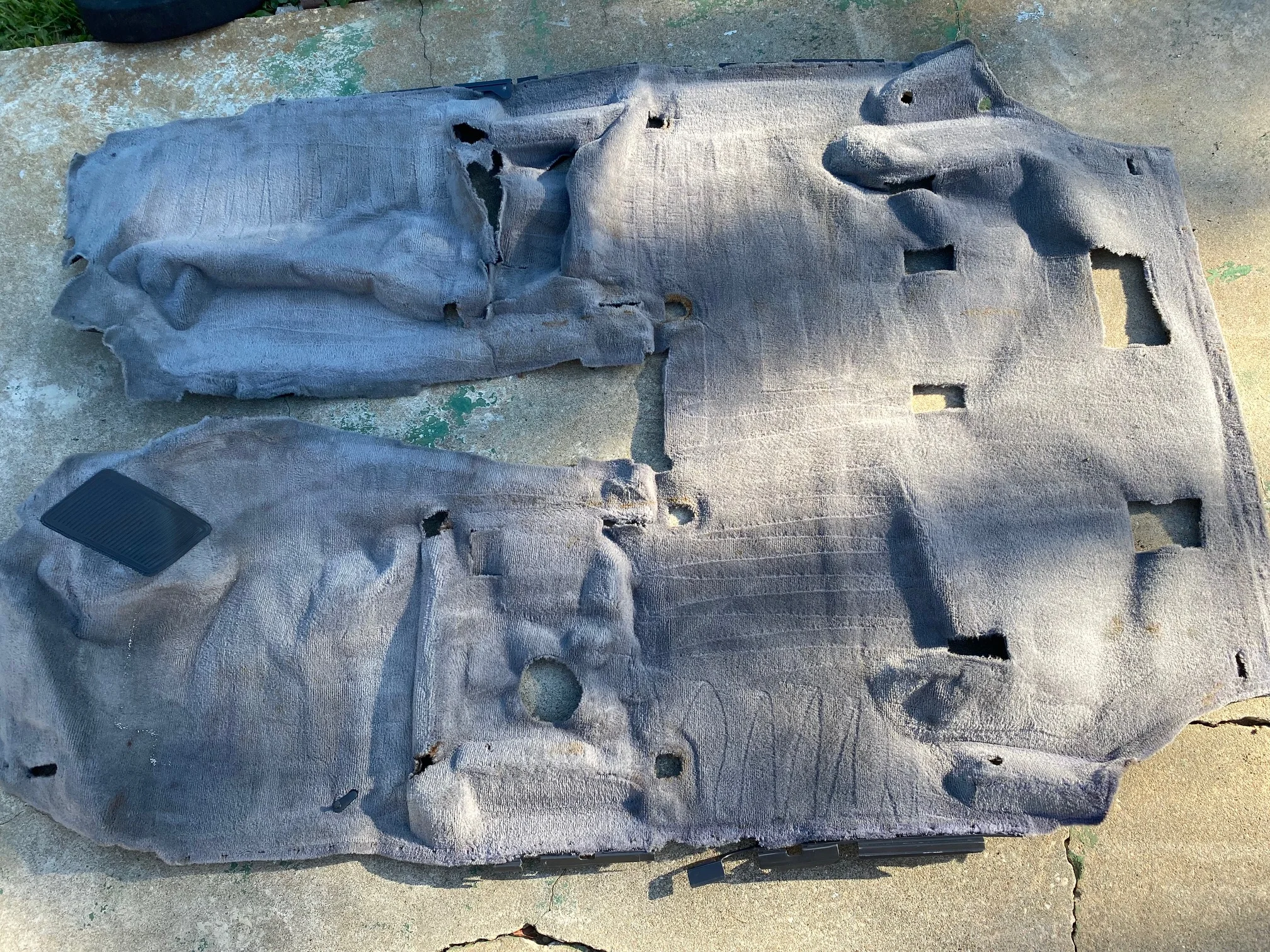

So I have been working on the interior. I pulled the seats, and then the entire carpet. The carpet is really gross, but no major tears or wear. I am thinking that with the right methods, this might actually clean up. I am also taking out all the interior peices and pressure washing them to get them back to freshness. here are the before pics
So here's the method I used. I first soak down the entire carpet with water, and then liberally apply a mix of dawn dish soap and powdered "oxiclean". Let that soak in for about an hour, then pressure wash with plain water. I could not believe the transformation! The carpet looks almost new now, and after it dried, has no smell whatsoever. here's the before and after.

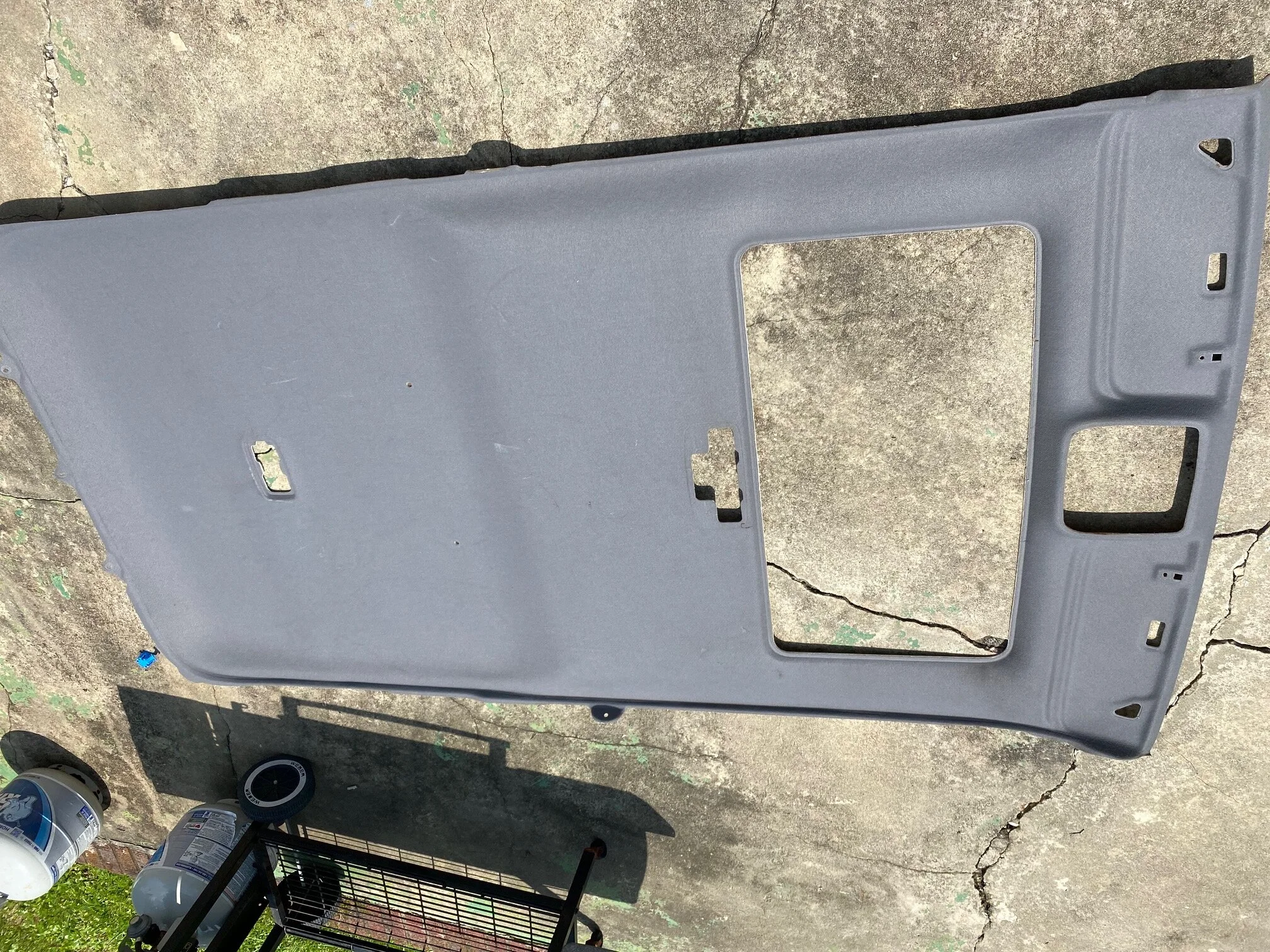

I also fully cleaned the headliner. This has to be cleaned more gently, but it also came out great. It looks almost new. I used a mix of warm water and oxiclean, applied gently.
