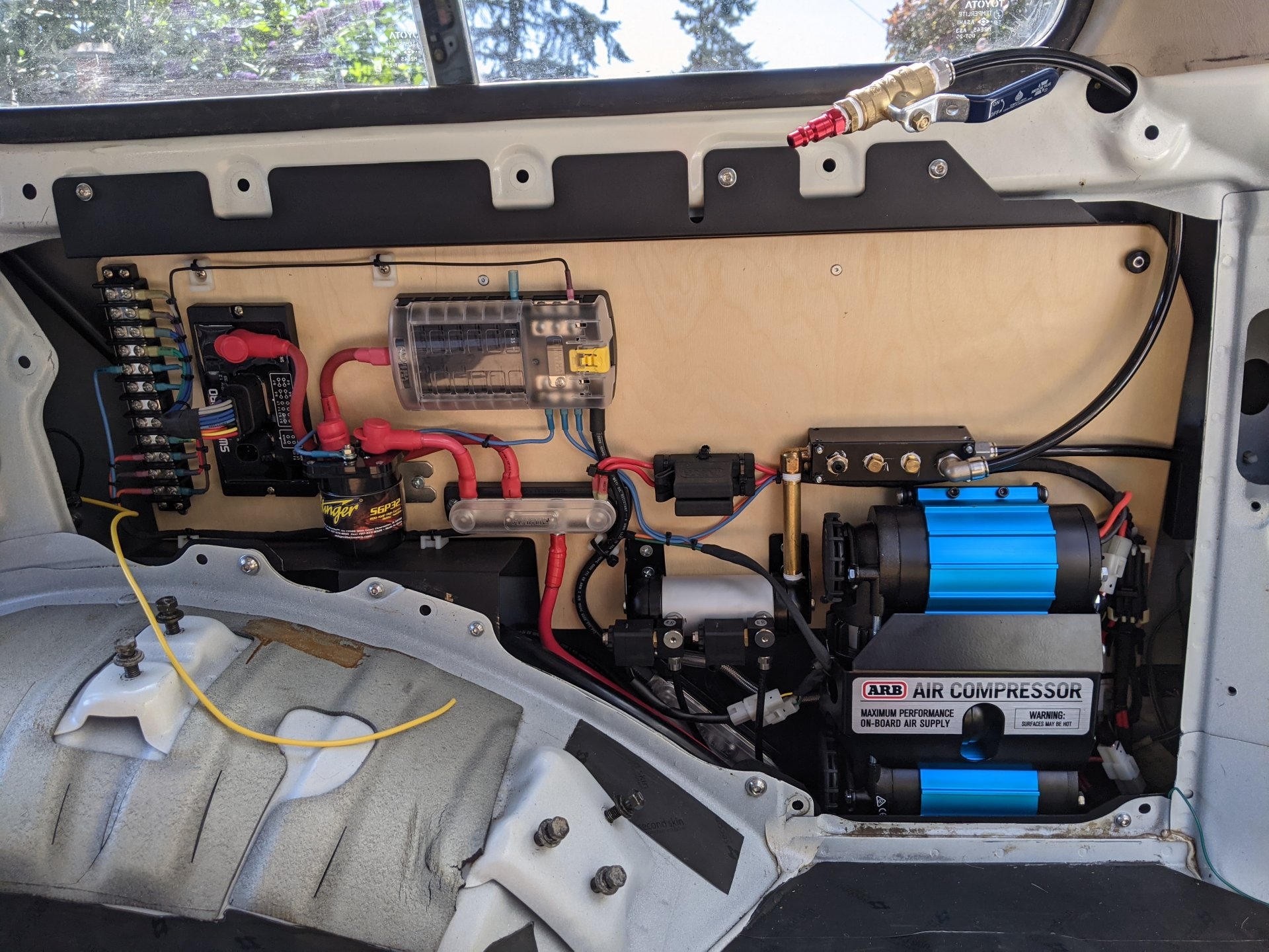

Mounted and plumbed the QPM today -

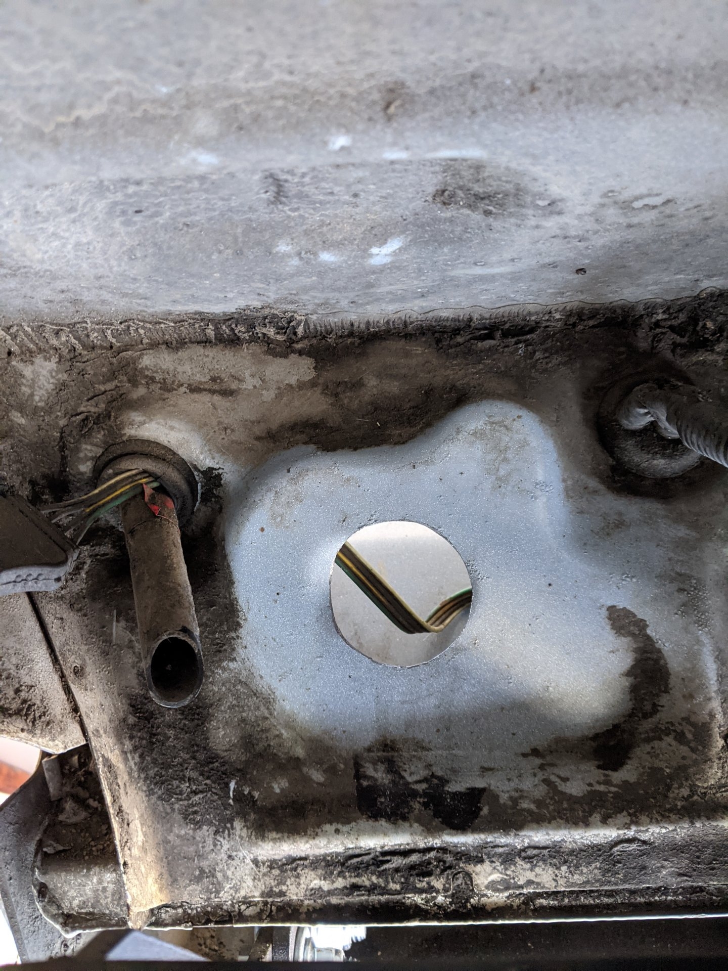

I hate drilling holes in good sheet metal. Finished the bare steel off with a couple coats of POR-15.

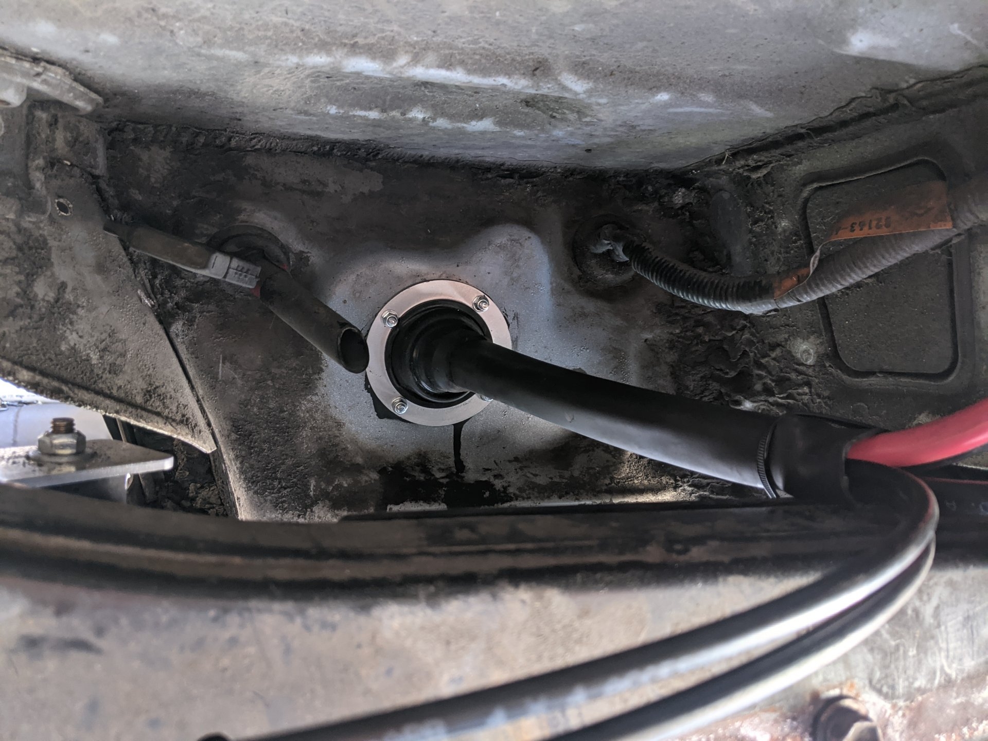

Ended up going with the cone grommet. I's origianlly thought I could double up with the battery box grommet in the hole through the panel and the cone grommet to keep the weather out. Unfortunatey the cone grommet kept pushing the battery grommet out, so ended up wrapping the penetration in sliced 1/4" fuel line.
Umbilical under the truck. Looks like the grommet sealed pretty well and is keeping the lines centered. 2" heat shrink around 2x 2ga marine cables, 1x 3/8" nylon DOT air line, 2x 6mm air locker lines.
Ready to go. OBA Passed pressure test and lost 3psi in a closed system in an hour. I'll give that a pass - Way too many fittings to chase down for that small of a loss.
Still some room left for future expansion, too.

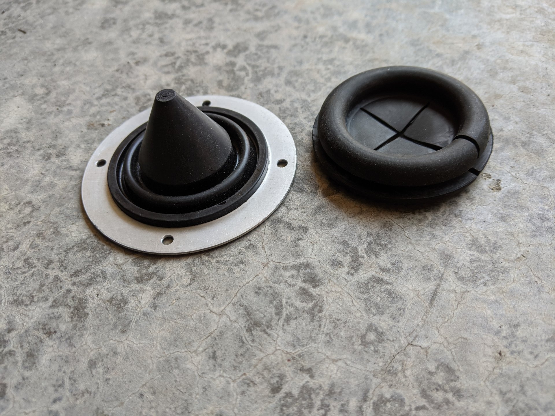

Nice work! Can you pls share specs on cone grommet?

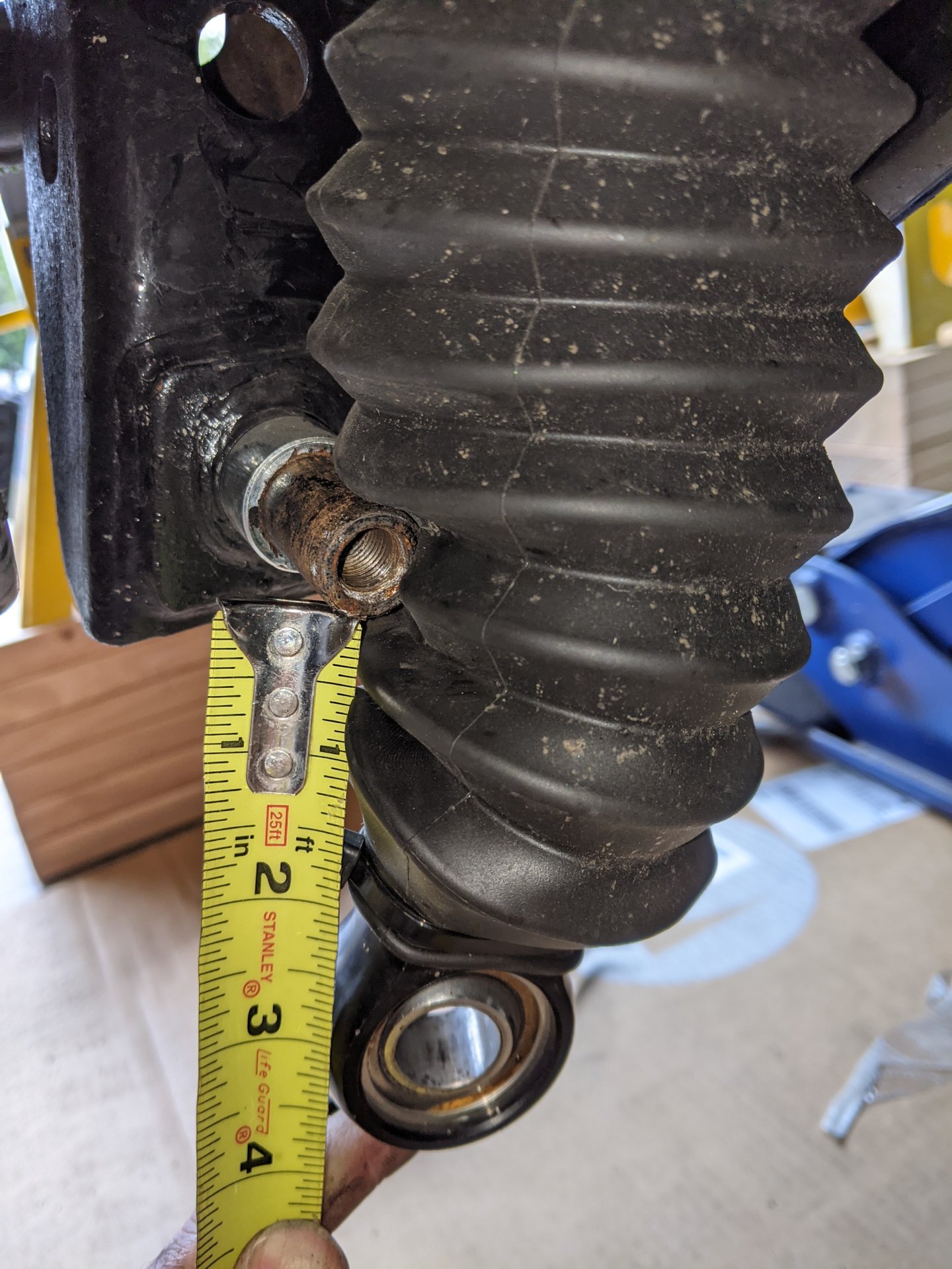

Loosen the bump stop collar bolt, slide the bump stop down 2", then tighten the bump stop collar bolt. That's the fix if I'm seeing it right. Once you install the shock bushings the shock should be close to bottoming out.
Would need a 2x bolt set up for that, at least from what I've seen previously. There's also a couple of button heads that pull the bump stop tight in to the bottom of the cavity of the holder. Assuming to do it right a spacer would need to be fabricated and longer button heads used to allow the top of the bump to be pushed away from the base of the holder.
Pulled the rear spacers. Looks like i have 3.5" of down in the rear after the change.
Ramp tests below. Full compression on the rear is touching the bumper, with a little room forward. May adjust the links, but tbh touching the smooth portion of the bumper isn't the worst contact point.
Didn't flex add much as I'd like, but i have the swaybars attached (including the HD rear). No issues with mechanical contact or any of the lines being stretched.
Is 3.5 down travel going to be enough? I figured the sweet spot is near 6-9 inches of droop. What are your thoughts?
Probably not, but at this point I'm going to wheel the s*** out of it and rely on lockers when i lift wheels. 🤷‍♂️ I figure 4-6" shocks still be in the future with bigger bump stop extensions.
