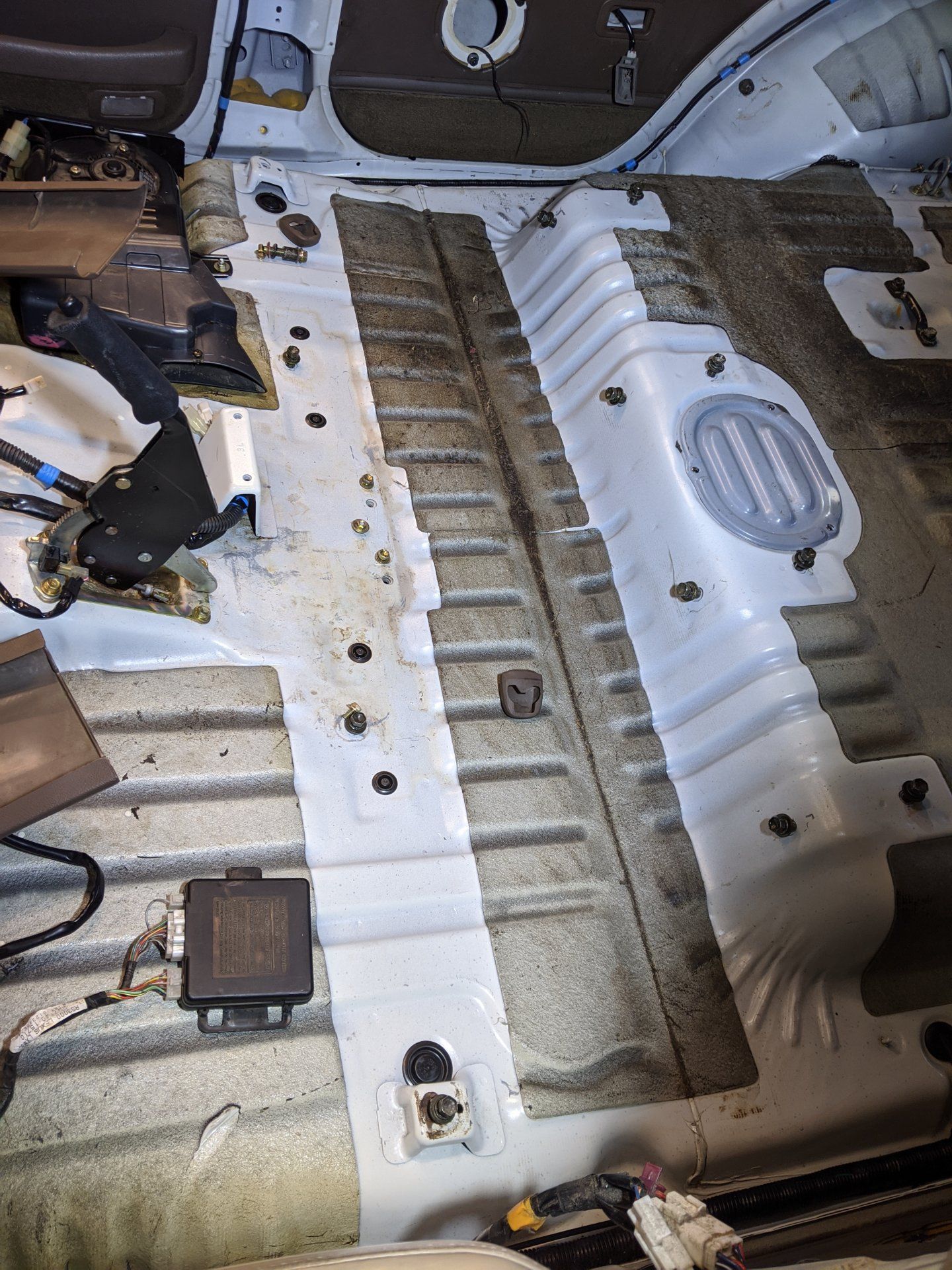

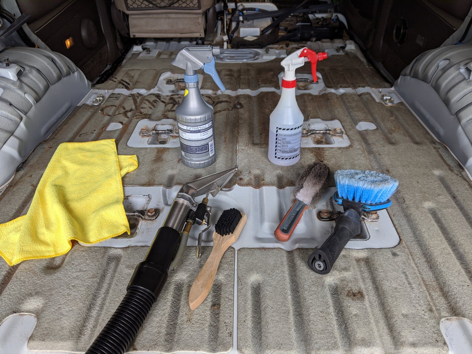

Finished most of the interior cleaning today. Removed the stuck-on jute carpet backing with a wire brush then scrubbed and washed the entire floor with a carpet extractor. Amazed at the nastiness that came off, especially considering the carpet had already been trashed. Looked like a lot of soda or some other brown, sweet-smelling liquid was all over the floorboards. I was actually pretty impressed with how well the extractor worked - accurate enough to spray down desired areas and avoid electrical, etc. Had a few challenges under and around the shifter because of the tight quarters, but managed to remove the shift knob, raise the selector housing and get most of the crud off.
Tools of the trade - butyl cellosolve based degreaser and an enzyme product to break down any remaining organic residue in the crevices.
Finished results looked pretty good. Definitely smells a lot better. Decided not to pull the rear heater and deal with the coolant lines. Managed to get around it well enough and extract all of the fossilized cheerios.
Removed some baggage while I had the rear panels off. Unused jack and holder, car phone receiver, 3rd row belts. Saving the bracket off the receiver - Looks like it might be useful to mount something else on behind the rear panel. Added some pipe insulation to the connectors I removed from the reciever so they ddon't rattle around inside the rear quarter.

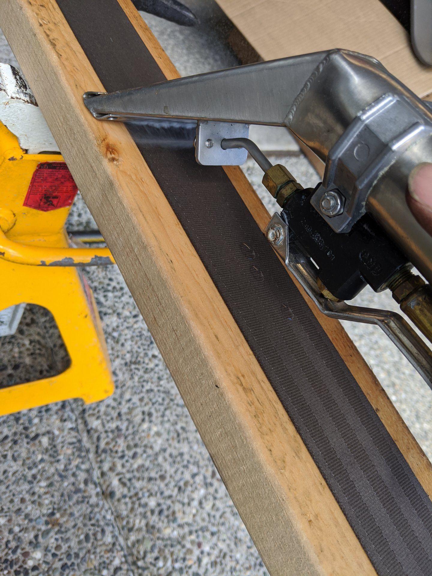

Cleaned the seatbelts with the extractor which worked really well. Mold was removed in one pass. Had to hit the back belts a few extra times - I think they'd been the victim of the same food spills as the floor. Extraction fluid did a good job. Keeping the extraction shoe pointed towards the tensioners kept them dry without having to bag. I'd originally considered pressure washing, but was worried I'd mess the tensioners up and was concerned the webbing may not stand up well to my washer. Belts are hanging to dry now. Hoping there's no residue - If there is I'l extract again with clean water.

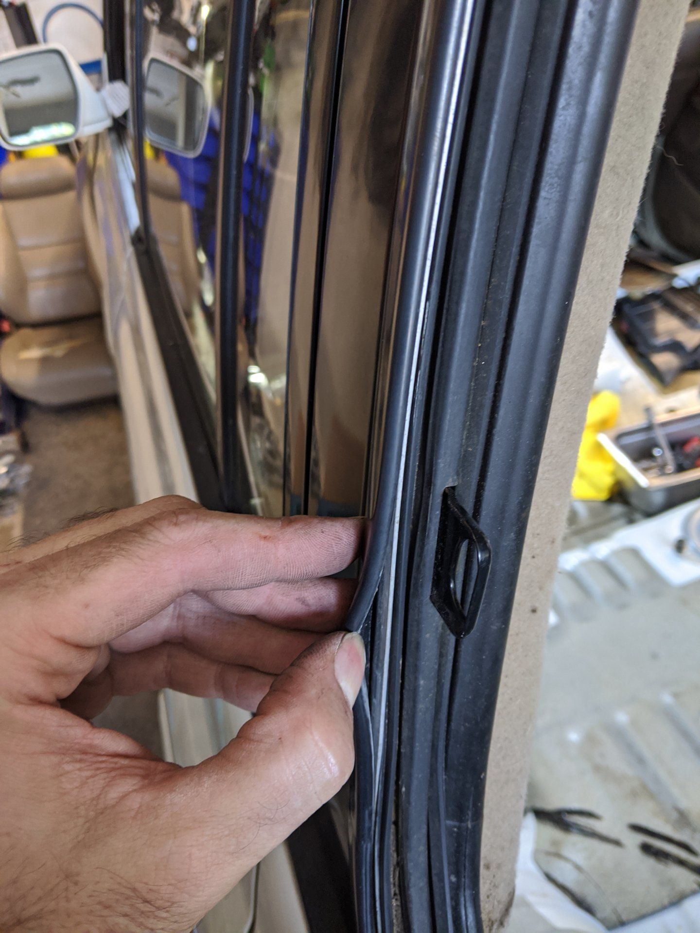

Noticed the window seals were jacked up on my rear sliders while I was cleaning the interior. Looks like the outer weather seal wasn't over the panel. Both windows were the same on the bottom horizontals and part of the way up on the ends. Assuming this would have been a contributing factor to the moisture in the cab. Pulled the seals back over the body lip, blew out the drains and lubed the rubber. Blew out the sunroof drains while I was at it since a few Members have mentioned the drains being problematic - Both looked completely clear, but cleaned for good measure.

Most general purpose degreasers will work. The more commercial products will typically contain butyl cellosolve. I used Diversey's Stench and Stain digester for the enzymatic action.
