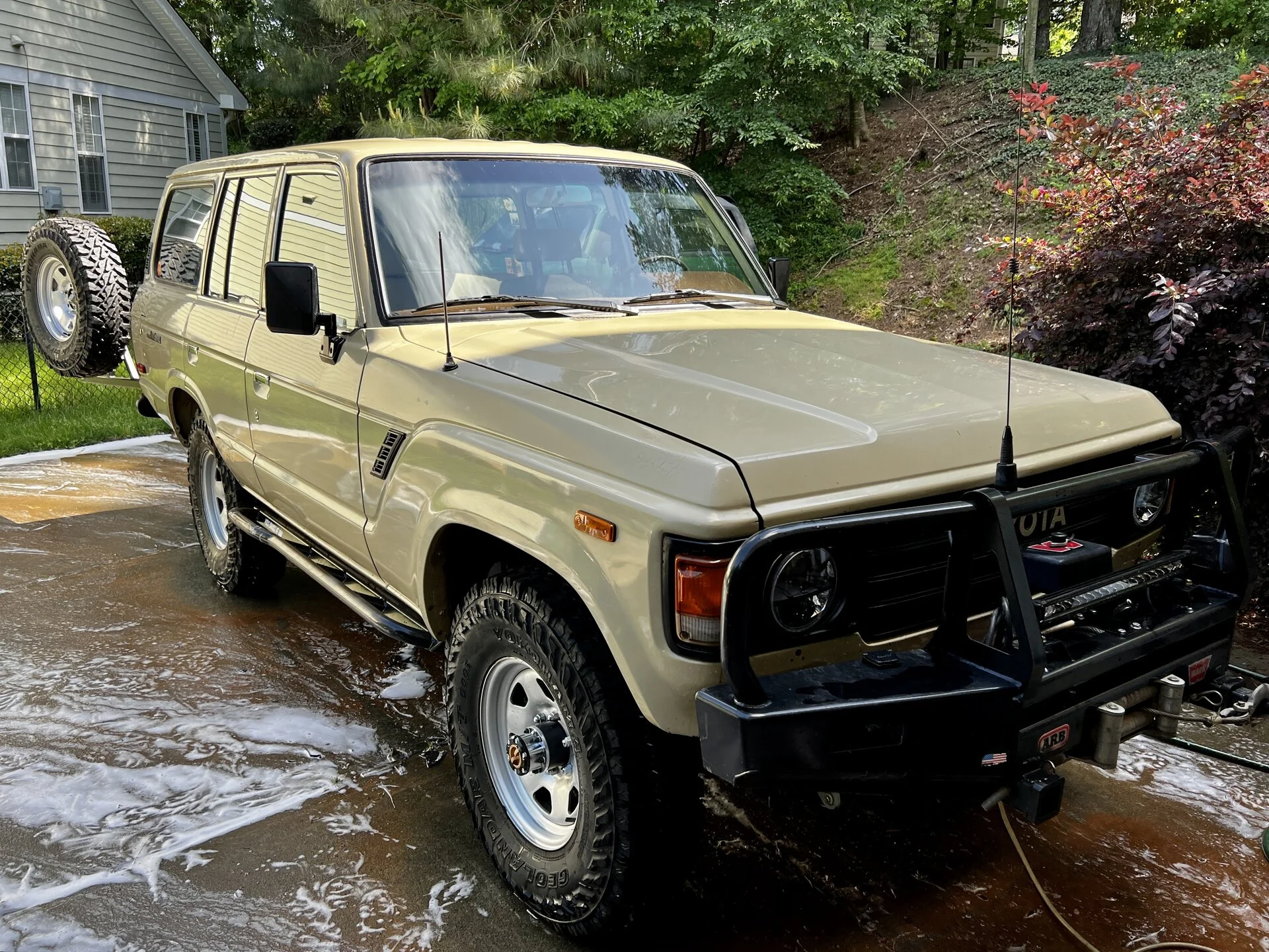

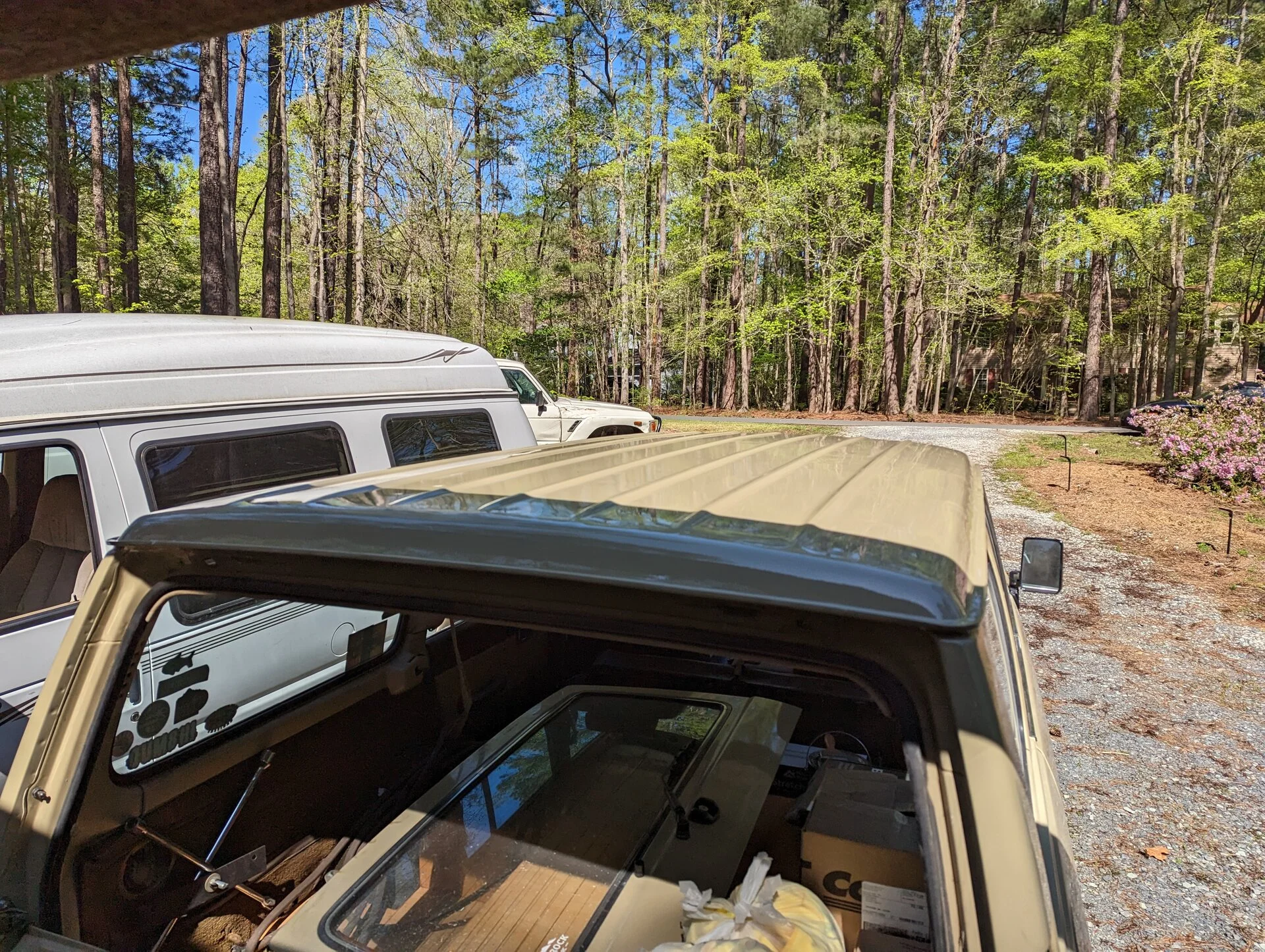

Look at sandy in the sun!! I'm so stoked with how it came out.

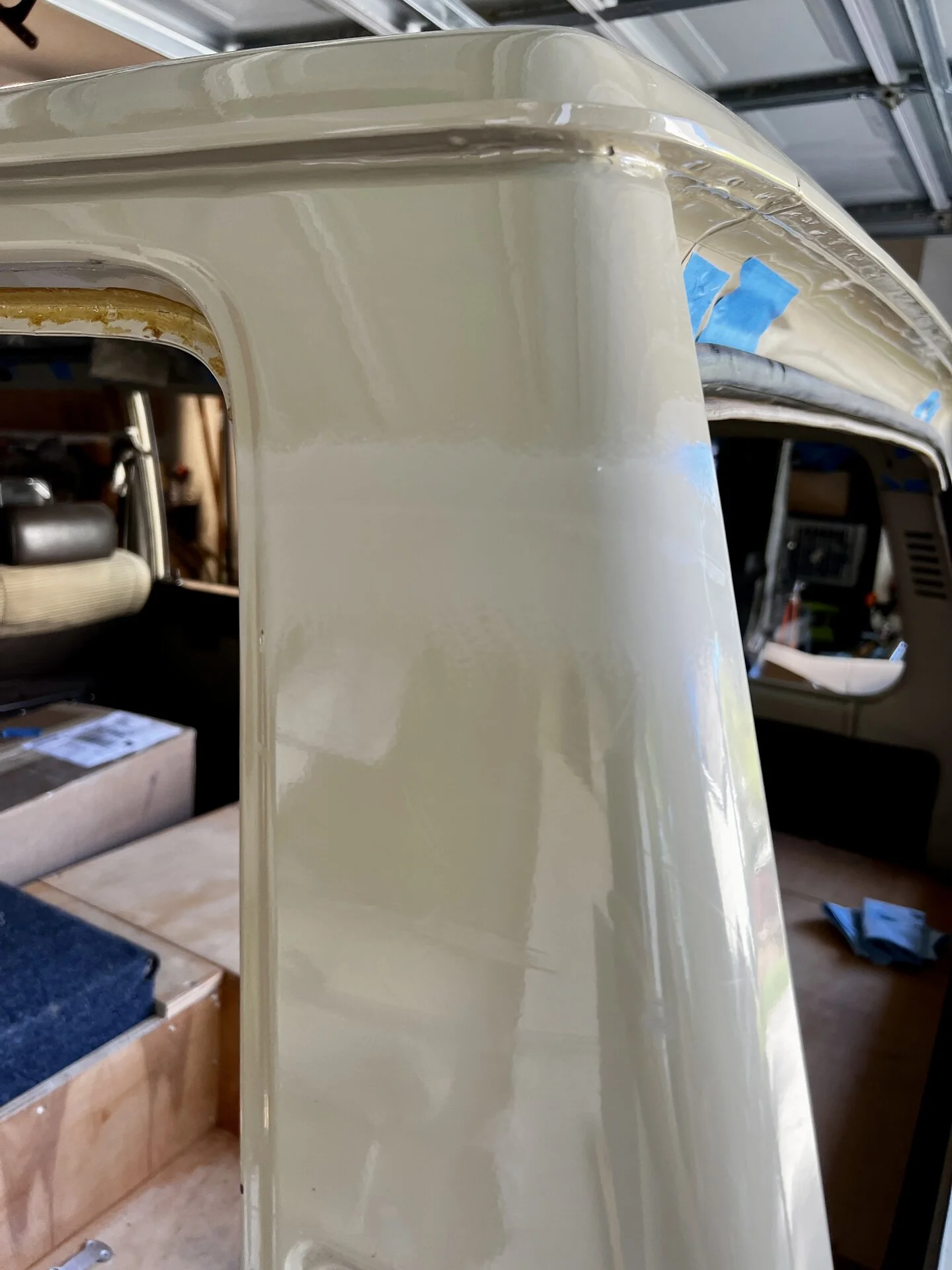

Got a couple more things done today. Pulled the rear quarter glass in preparation for the new headliner, started wet sanding the transition between the new and old paint, and flooded the roof skin / inner structure seam with Ospho.
I knew going into this that the paint was going to be horribly mismatched to the old paint as the old paint is not good at all. My goal is to knock down the transition and make it less noticeable. At some point in the future the truck will get a proper repaint but likely not until I stop wheeling it.

Sanded down some. Needs finishing but got it pretty close

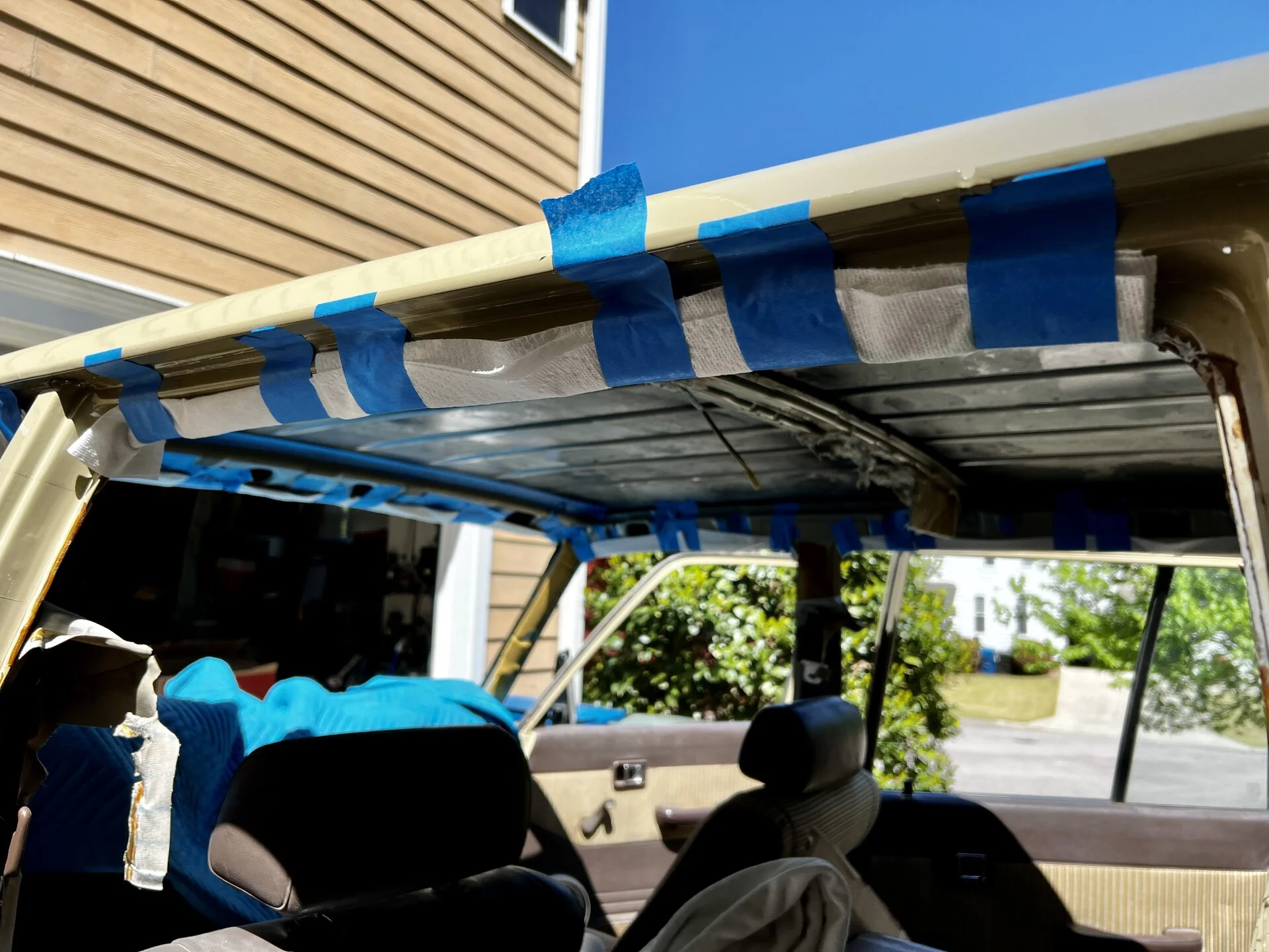

The bottom seam of the inner structure is also the door jam and is not water tight so I taped up some towels to catch the runoff ospho so it won't drip everywhere.
I was squirting ospho mainly above the roof structure between the skin and the structure. I also sprayed it all inside of the inner structure to address any inner welds that we may have missed.

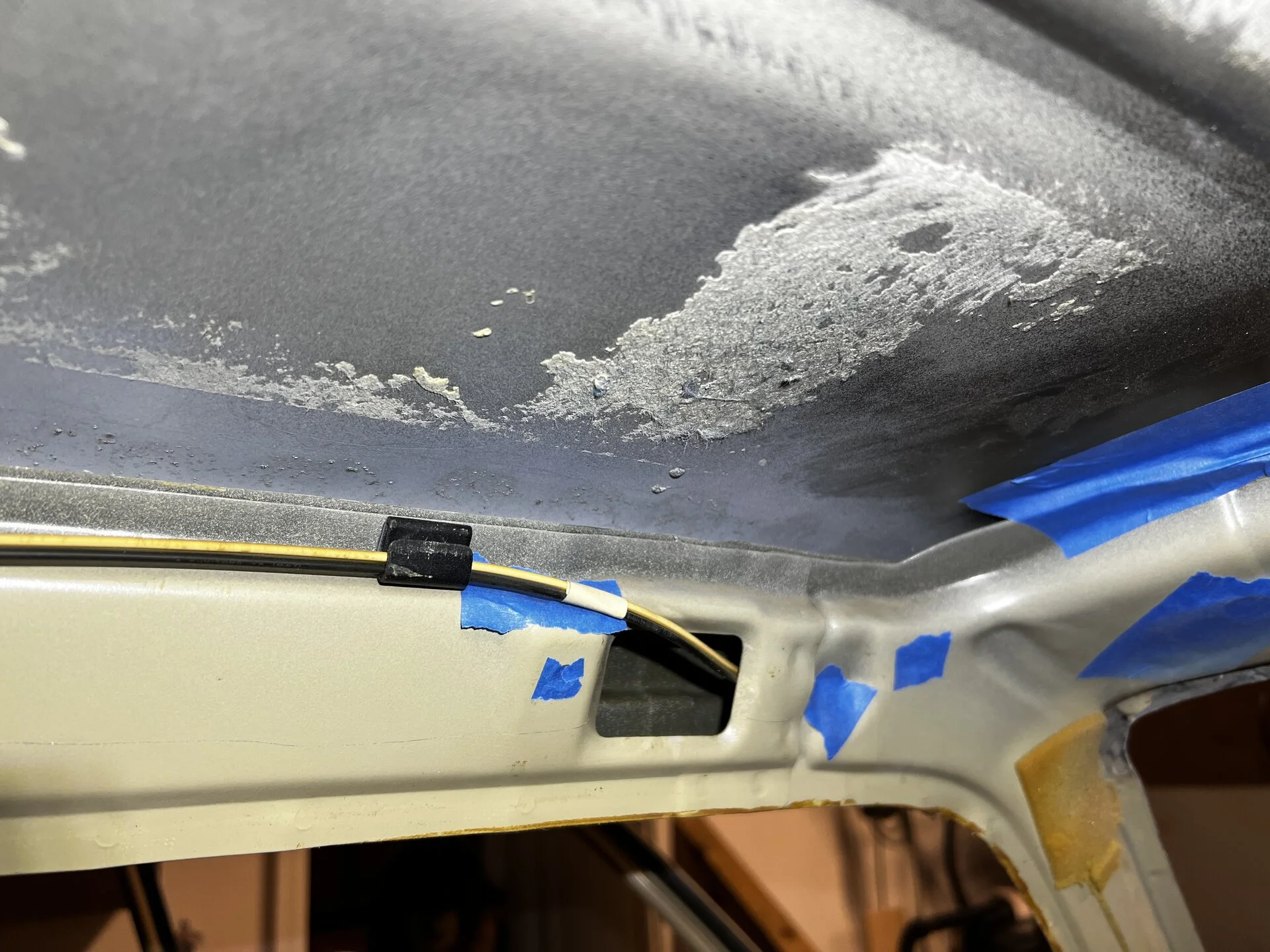

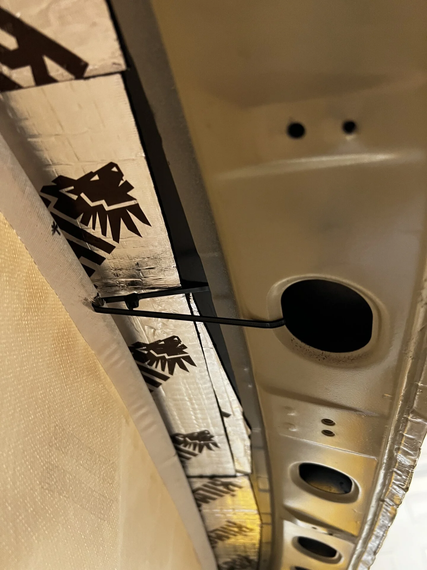

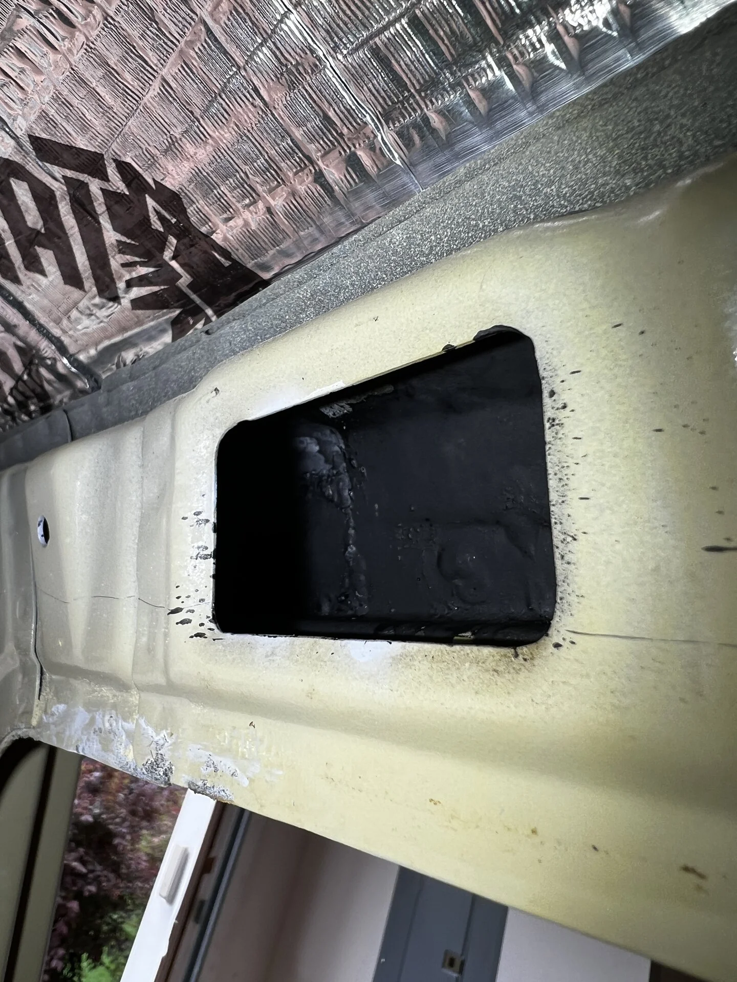

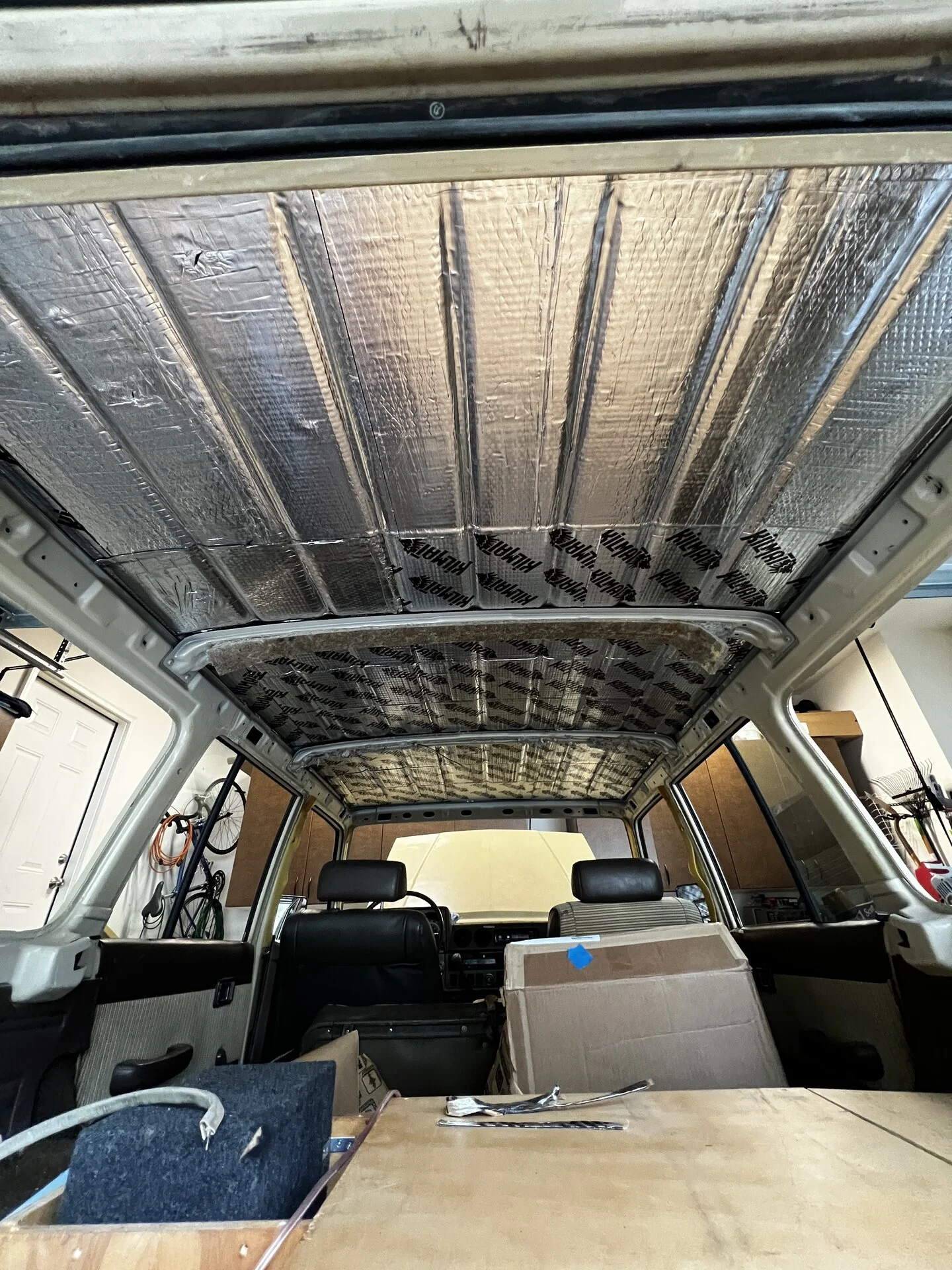

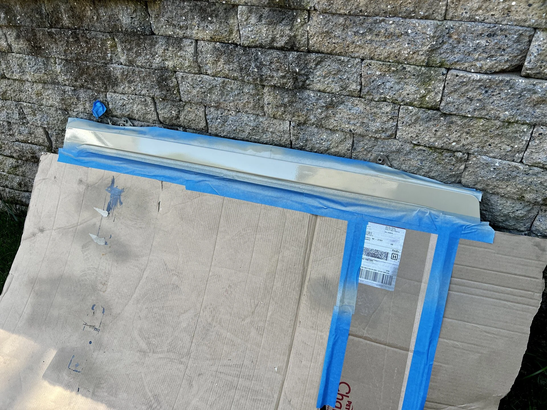

Got some more stuff done yesterday. Sprayed eastwood internal frame coating inside the inner roof structure and between the roof skin and gutter where it attaches to make sure the backs of the welds we did are protected and won't rust in the future. Also got the windshield flange on the header painted on the inside where we welded and got the sound deadening applied to the roof. Lastly I seated the roof panel onto the butyl strips on the inner supports via a ratchet strap and some leverage.

Inner structure before:
And after Eastwood Internal Frame Coating
Header after being painted
Roof sound deadening

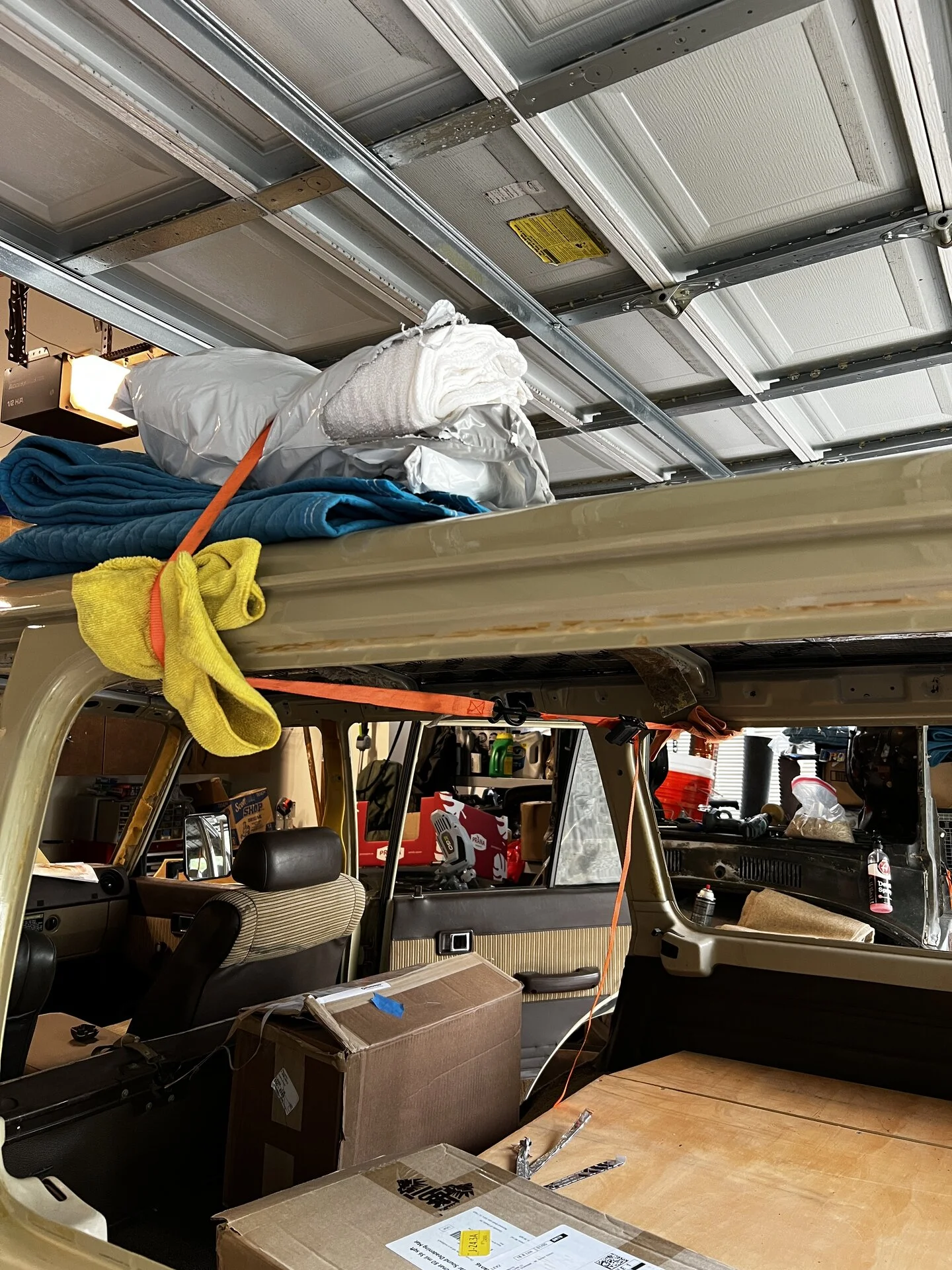

Seating the roof
Pulling the skin down probably won't work. If anything we probably didn't put enough butyl tape up there.
IMO let it relax in the sun for a bit then squirt some heavy body seam sealer between the butyl and roof skin.
The goal was to seat the center which makes good contact. The sides aren’t far off. When I put sound insulation on the roof I filled any gaps with it so all good!

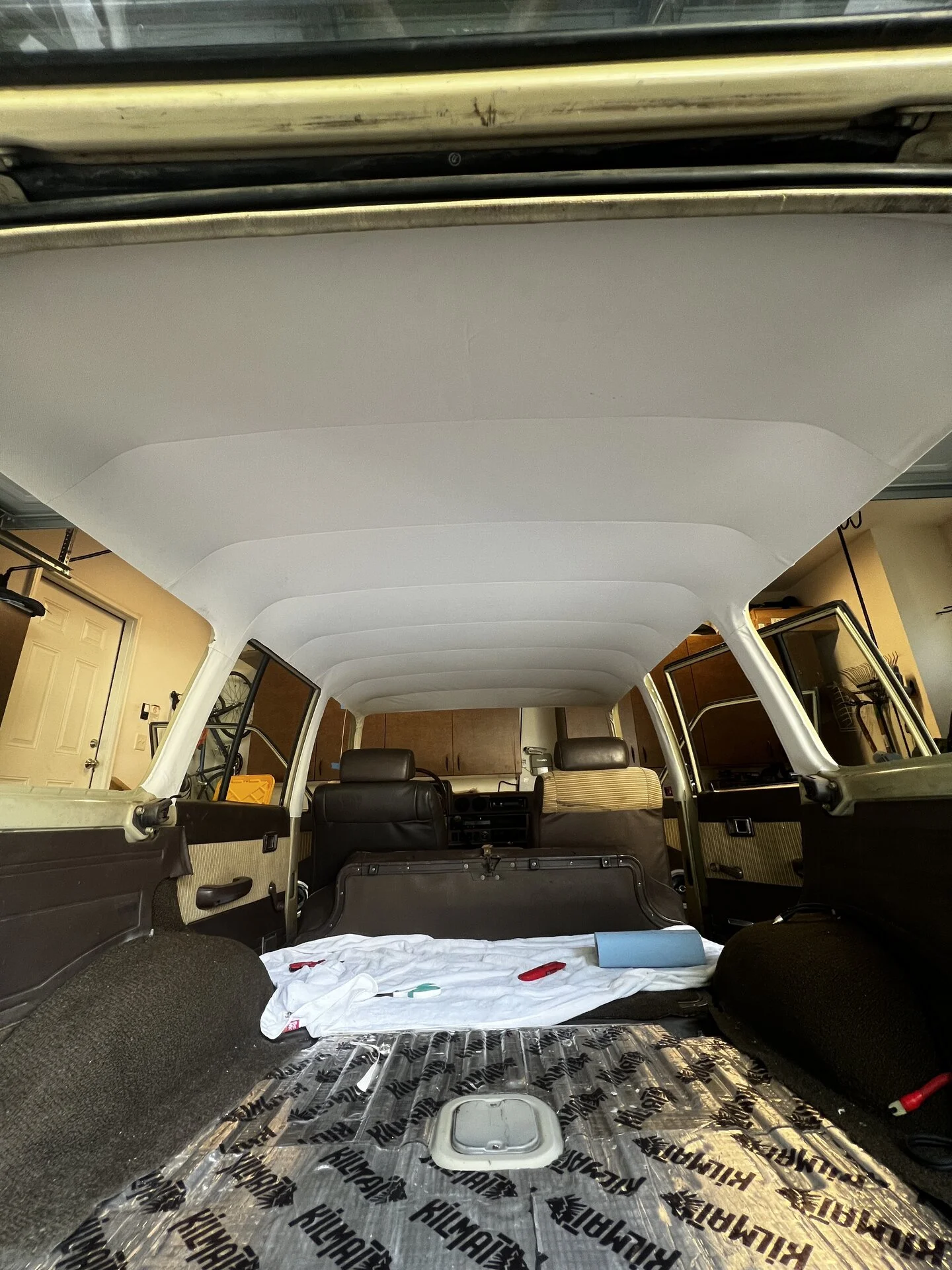

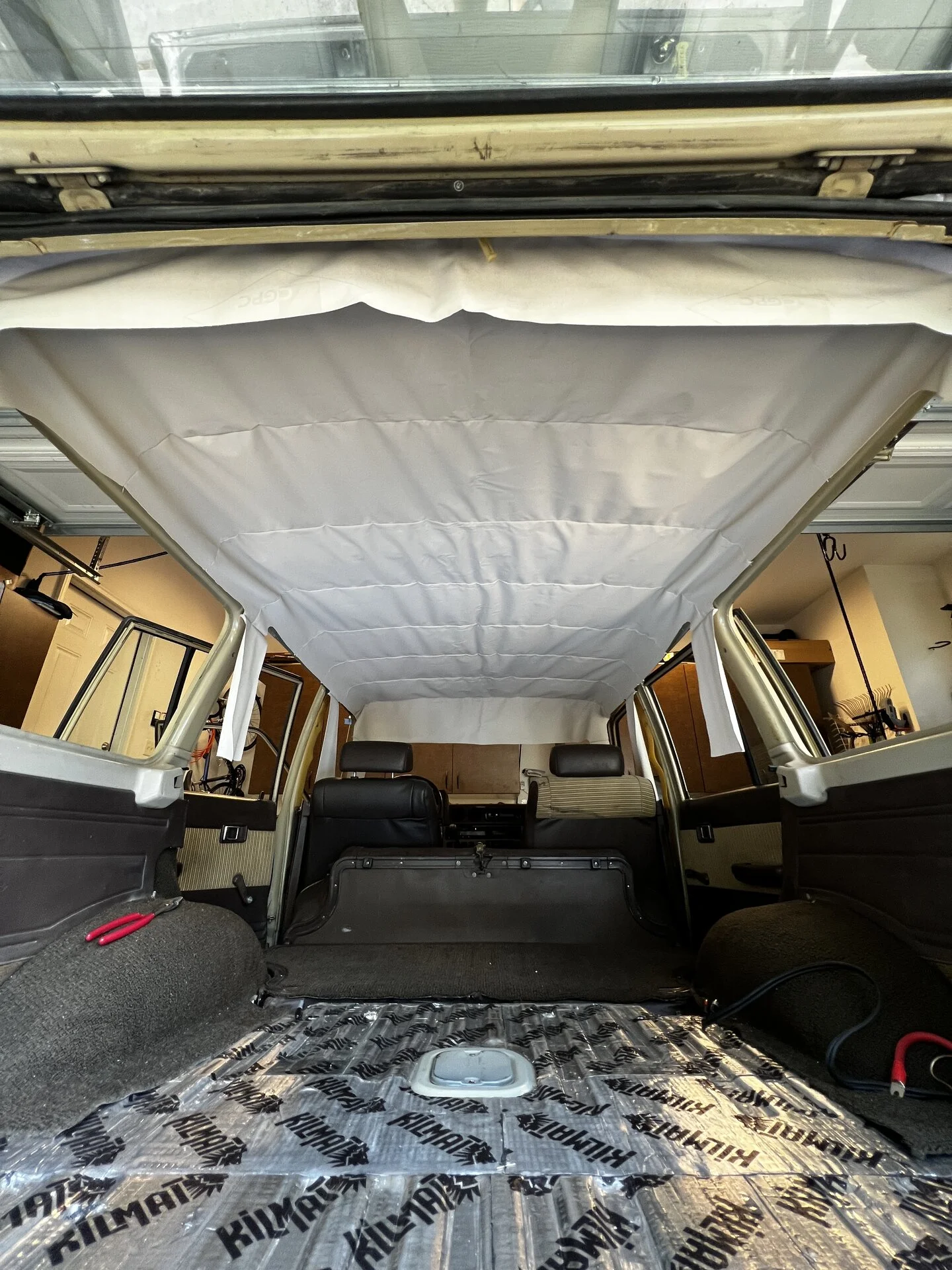

I ordered a SOR headliner to replace the stained and disgusting one that came out of the truck. Once the roof sound deadening was in, the headliner went in. It was my first attempt at putting in a headliner, much less a bow style headliner. Overall it wasn't bad, just tedious. The video from @CenTXFJ60's thread was invaluable in giving some tips. Tying the front bow to the header panel was an excellent tip and made the job easier since I didn't have to hold the bows forward. The one hitch I had was that the front pillar fabric was 2-3" too far forward when I got to the front. I'm assuming it was some install error on my part and not a pattern issue with SOR. All of the other pillars lined up great but the A-pillar was just was too far off to make it work so I had to put a small crease in the top of each pillar to tilt the fabric back so it would fit. Overall I'm very happy with the result!
Hung the headliner:
Tied the front bow to the header

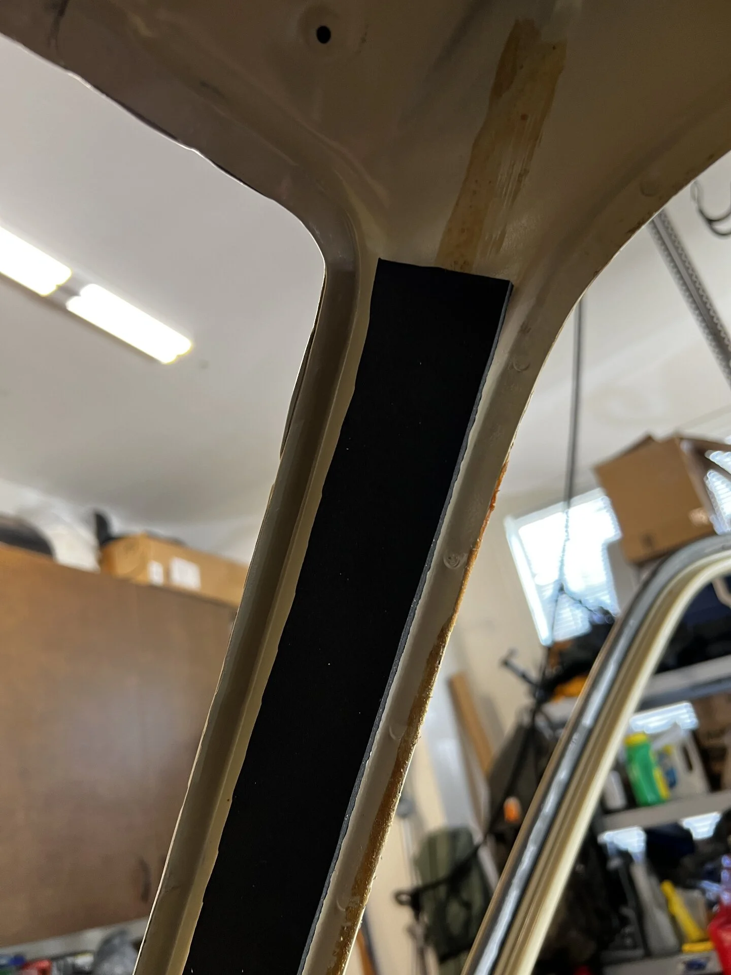

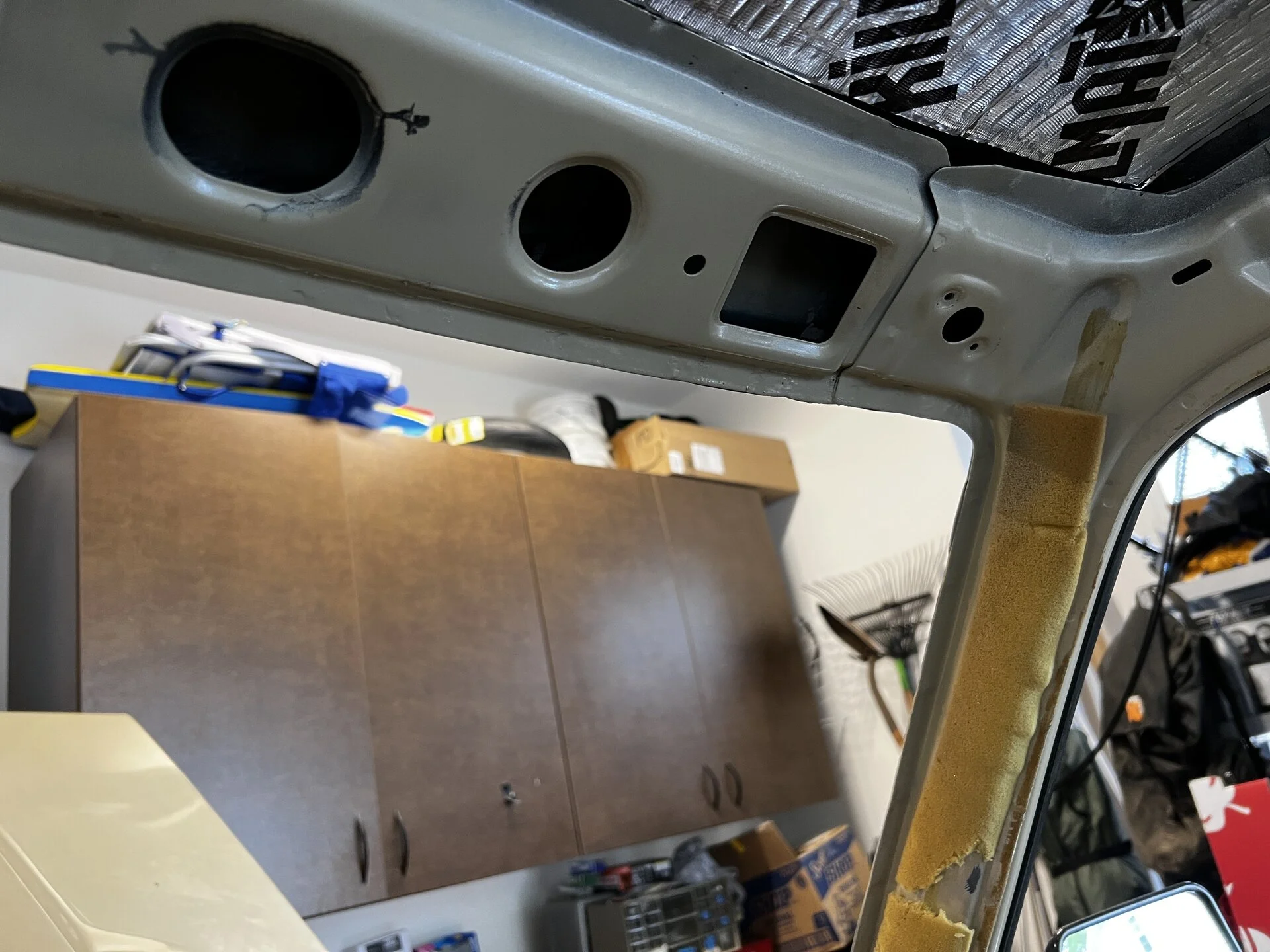

New foam on the pillars
Aaand installed! The wrinkles around the windows were taken out when I put the windows in.

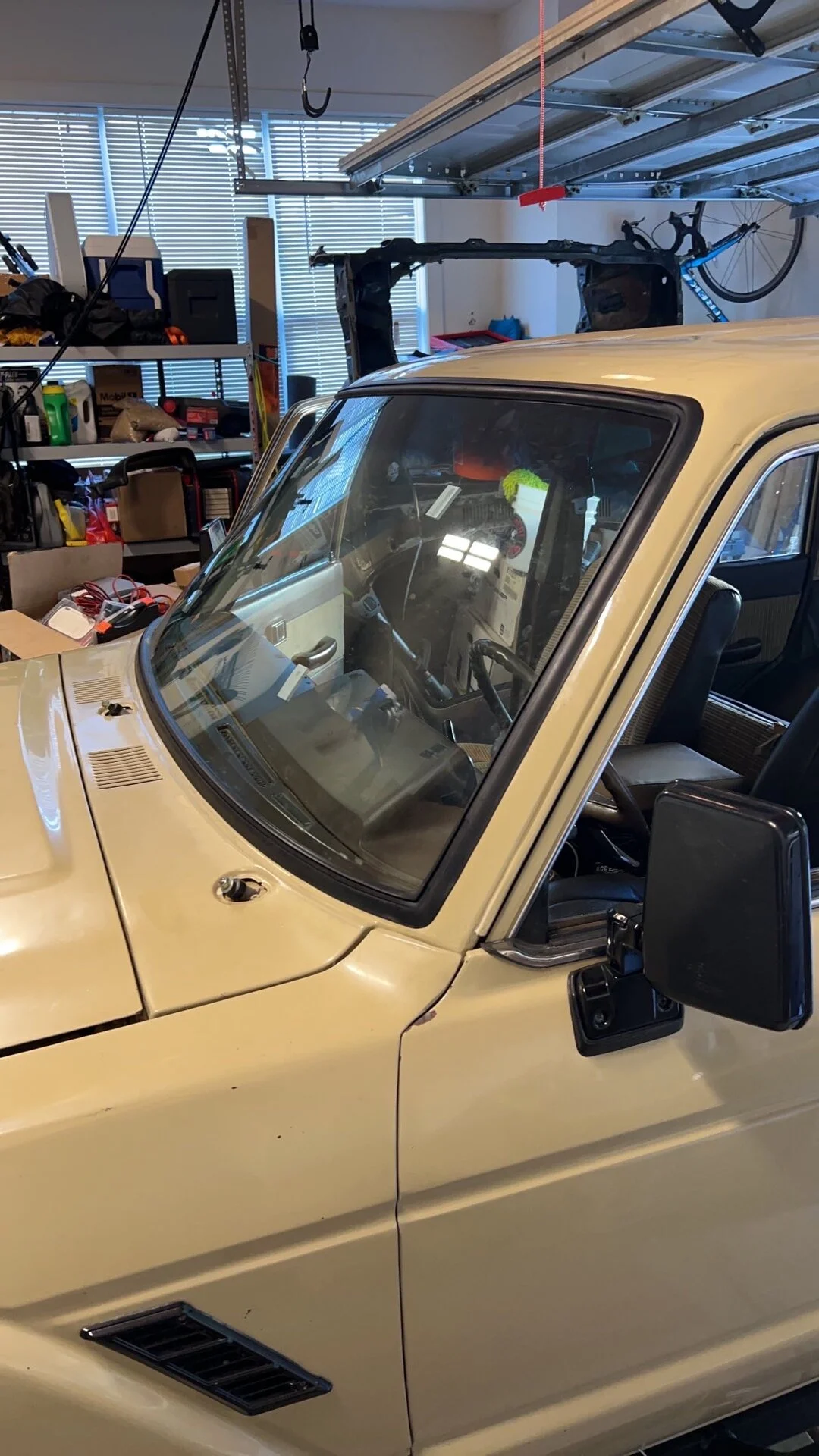

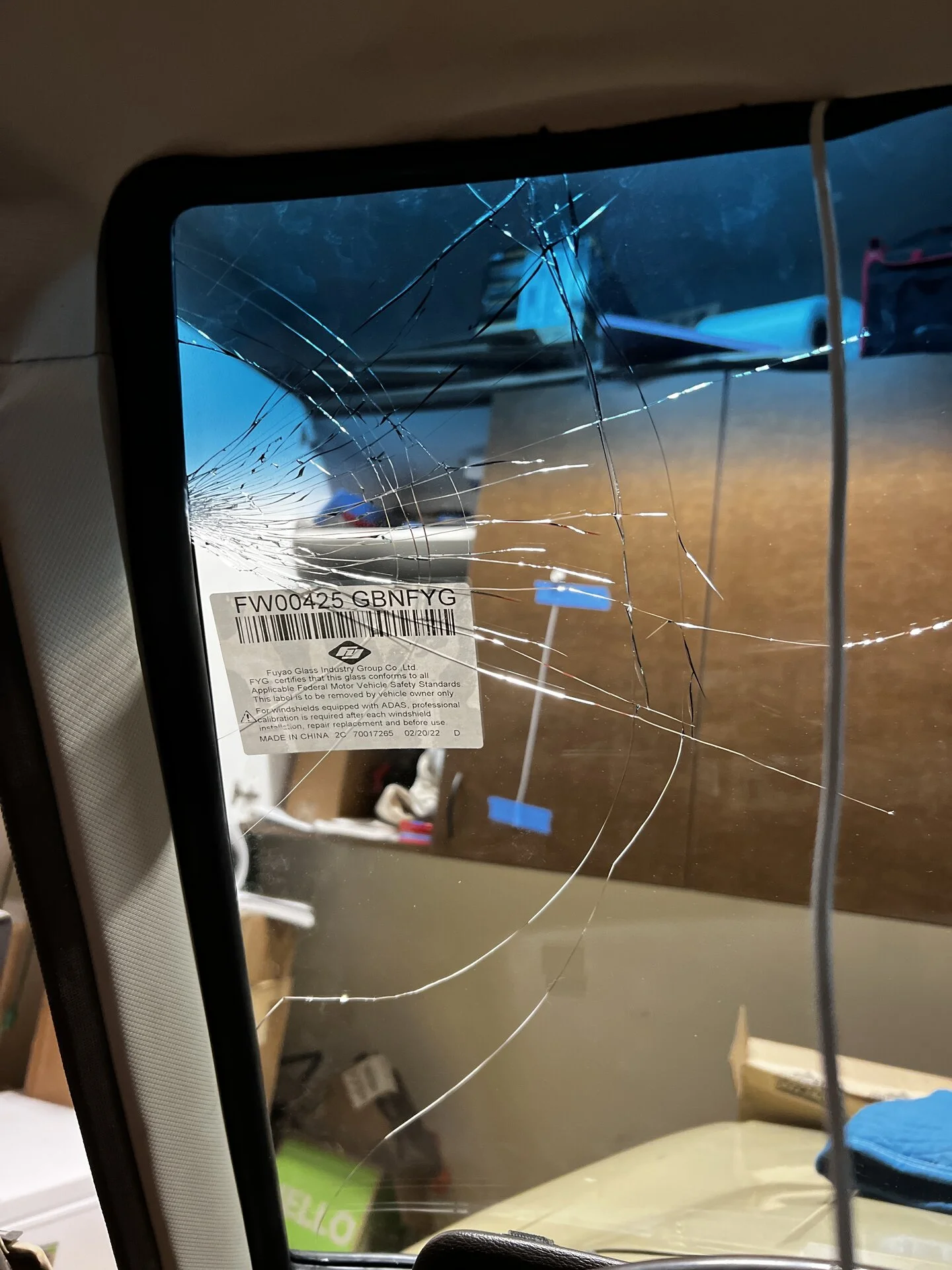

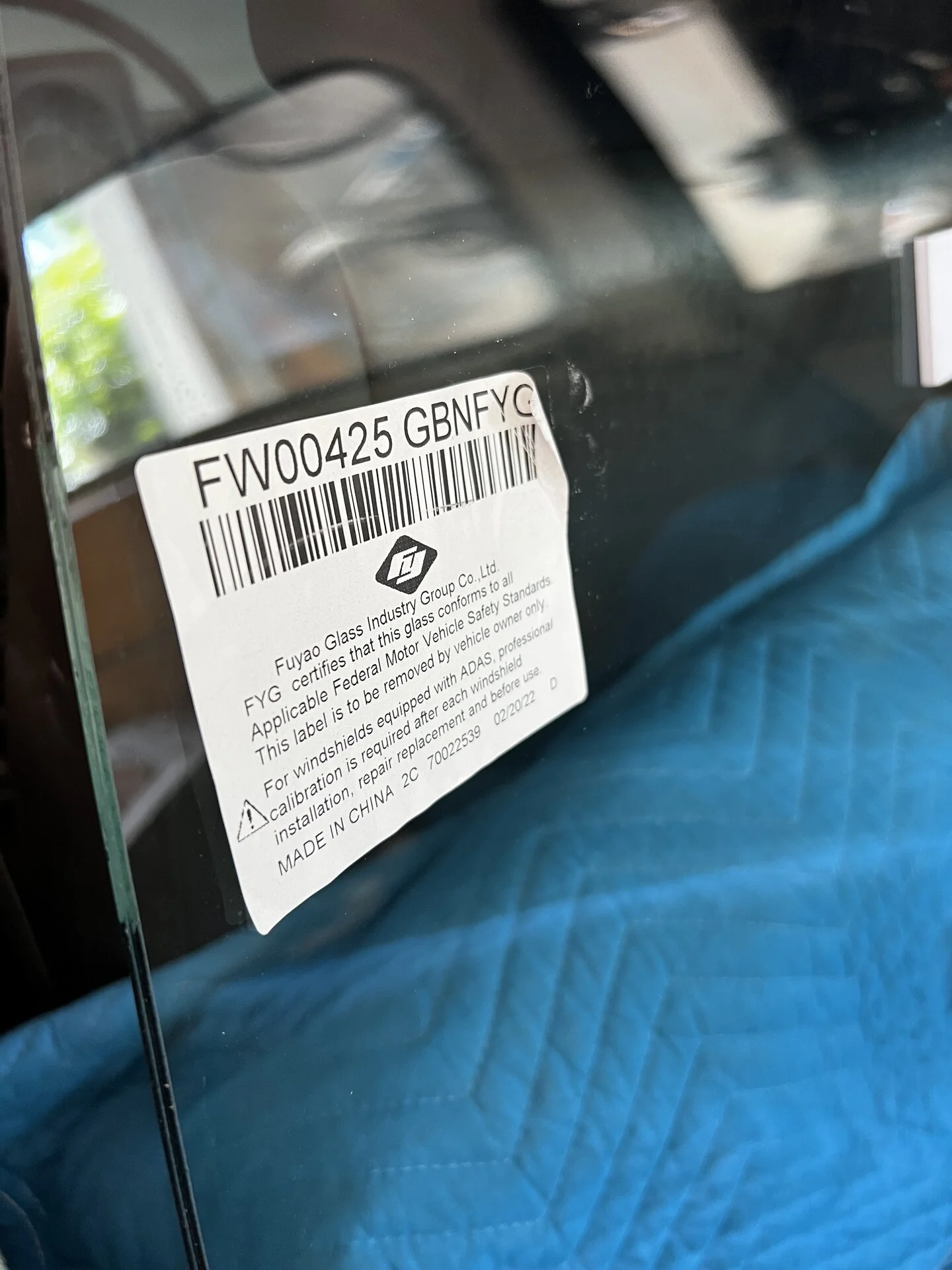

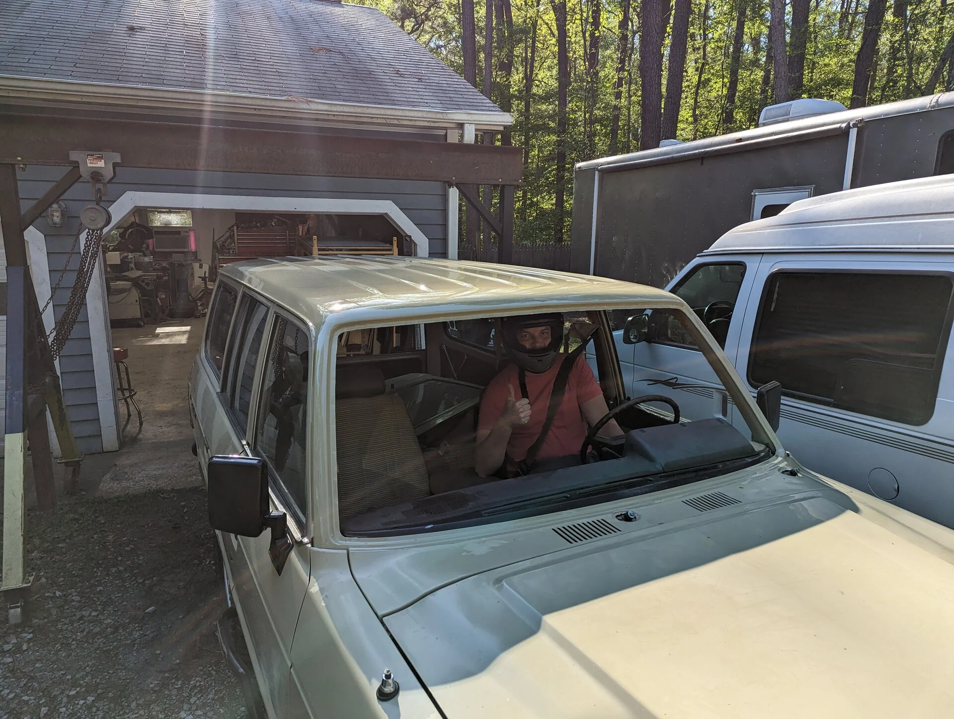

I was leaving Thursday for Relic Run and had ordered a windshield from a local glass place which arrived Tuesday afternoon. I went to install it and due to my complete lack of experience putting in glass, I cracked it...I seated the bottom lip of the glass and when I got up to the corner, I think I gave it little too hard of a tap and CRACK!

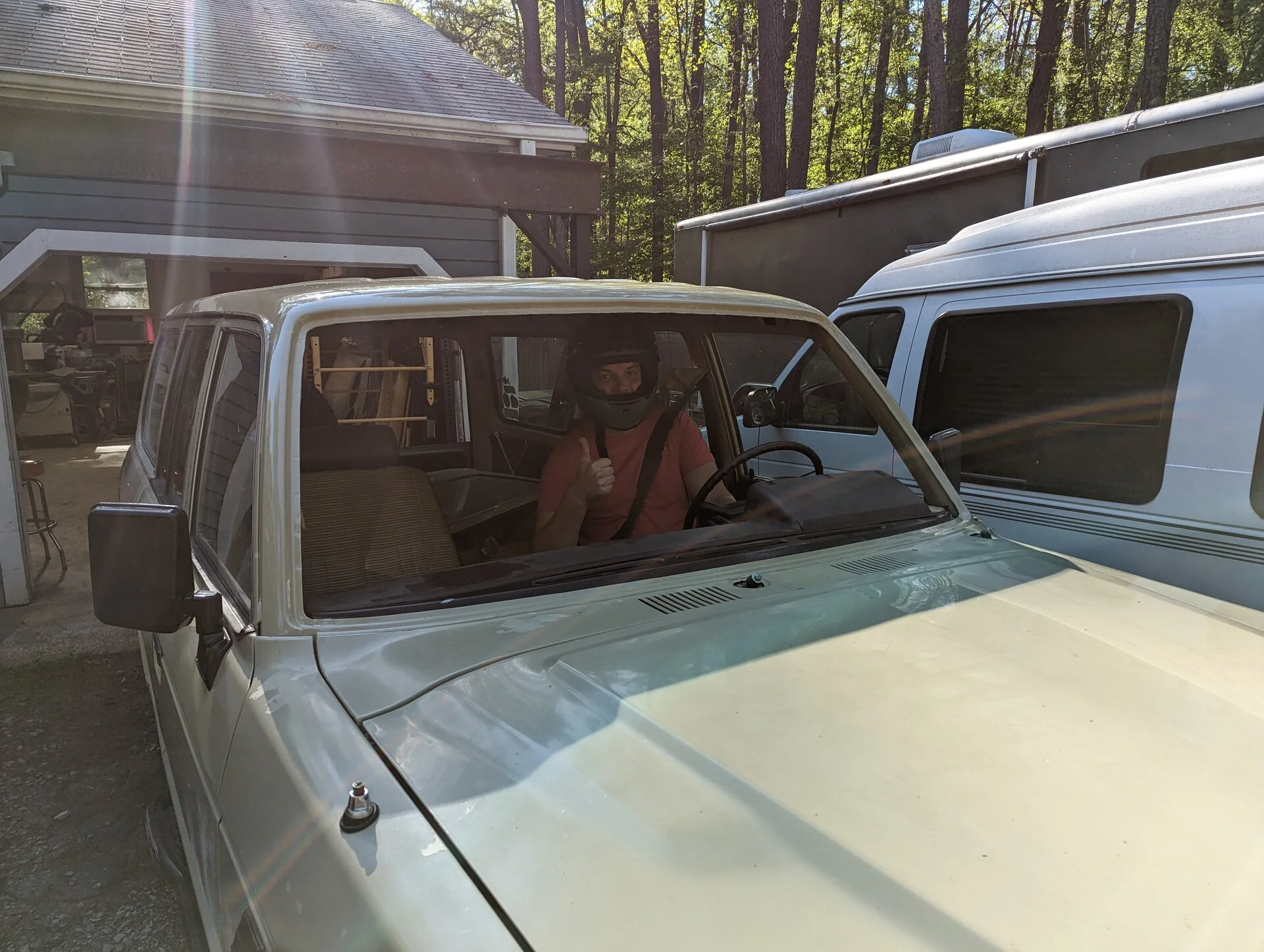

Being late at night I was convinced that I was not going to make the event since I had bought the "last" local piece of FJ60 glass, or so I was told. After calling ~18 companies Wednesday morning I found one that could deliver one Wednesday late afternoon. Luckily it worked out and I got new glass ($109) and got it put in (correctly this time) with minimal fuss. I used 3M Windo-Weld to glue the glass to the gasket and gasket to the windshield frame.

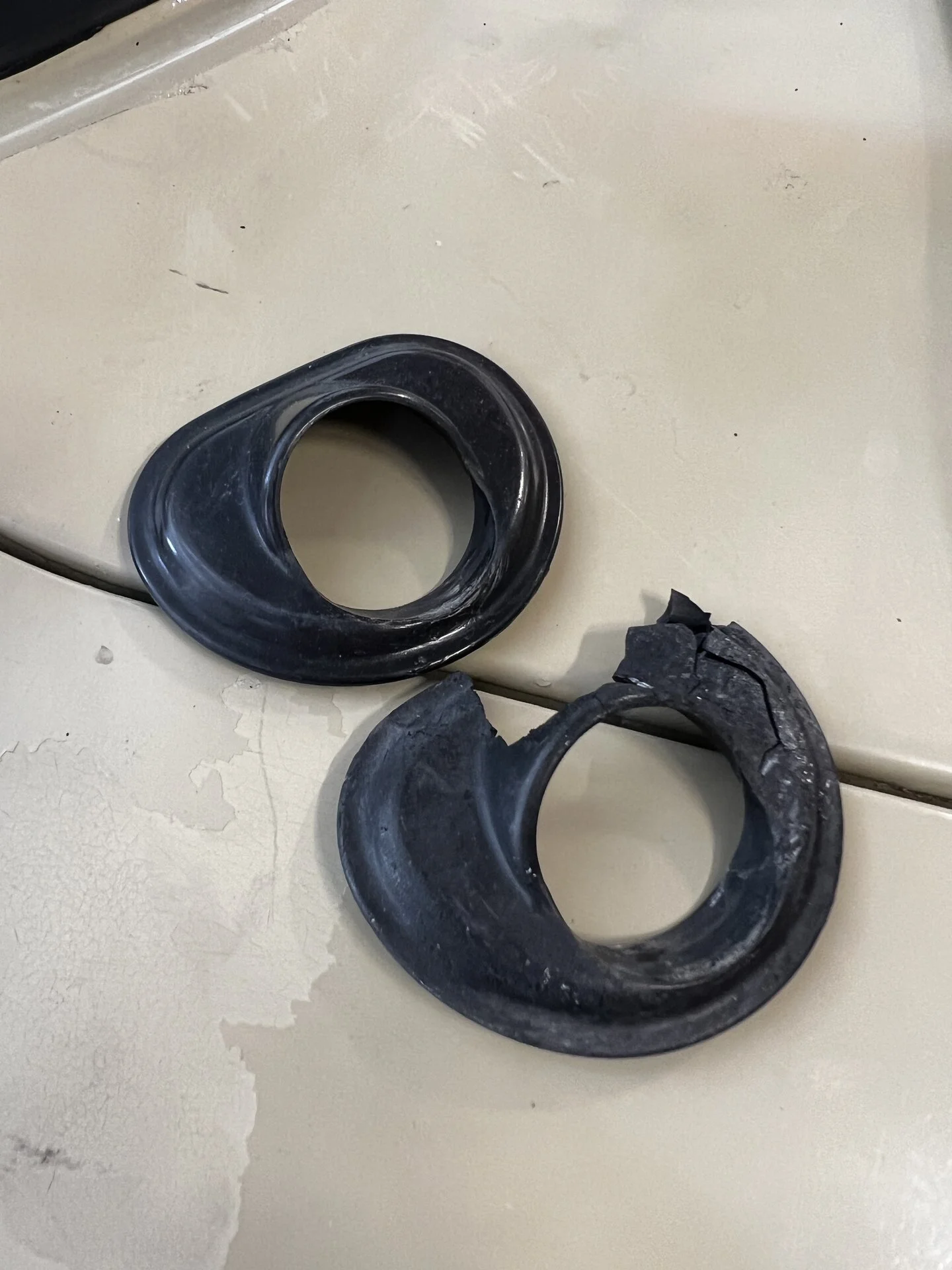

Got the quarter glass put in with minimal fuss and used some Precision Rubber lockstrip (WLS 466) to replace the chrome. I also finally replaced the cracked wiper covers.

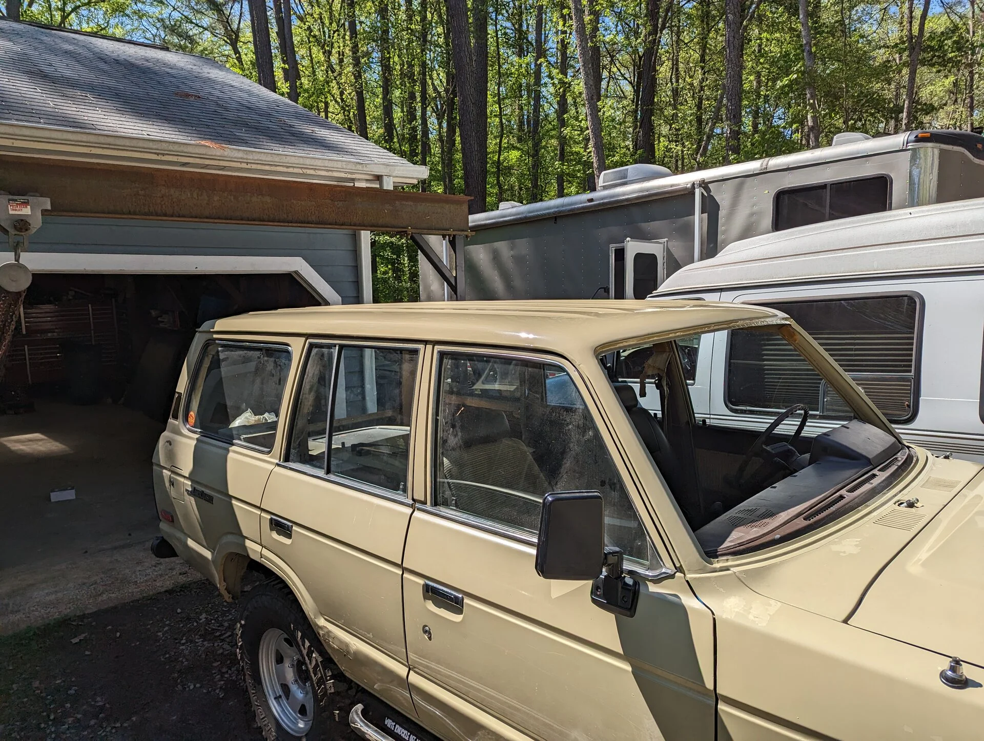

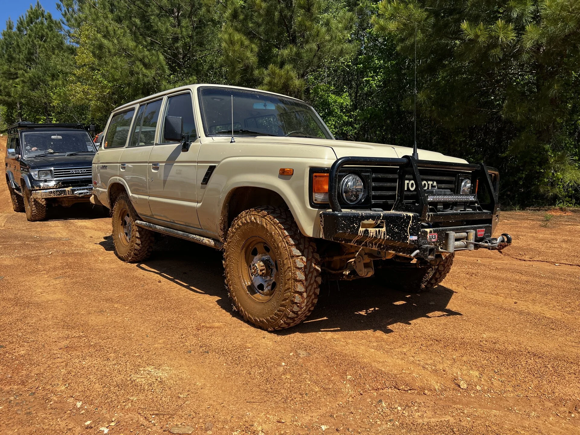

The Relic run event was amazing as always with the Olde North State crew and visitors from as far away as Northern Canada! Last I heard we had around 105 trucks registered. We had rented out the private training facility across the street from Uwharrie which had a lot of great trails and, since we rented it, it was empty and everyone had a blast wheeling around in there as there was everything from easy dirt roads to some pretty hardcore trails meant to make the trainees fail. Got Sandy plenty muddy. Then we did some night wheeling around Uwharrie and overall I think I was on the trails for 10-12 hours Friday.
Sandy got some love at the event too and several folks came up to ask about the roof work and to see it in person. It came out great and I can't thank @GLTHFJ60 enough for his help in making it happen. Dedicated thread coming soon for others to reference.
Hung the headliner:
Awesome job on the headliner. Ran into a similar issue as you on the APillars. Was able to release it back far enough (somewhere around the c pillars) and readjusted. Good news is the sun visors should hide any wrinkles. Hell of a job overall with the roof. Very inspiring many of us. And thanks to you and Johnny for sharing in such great detail.
I'm glad I was not the only one then. I had thought about releasing the headliner to readjust it but I was under the gun time wise so I opted to not backtrack too much. Luckily the wrinkles around the visors were helped when I bolted the visors and grab handles back in so it looks way better.
