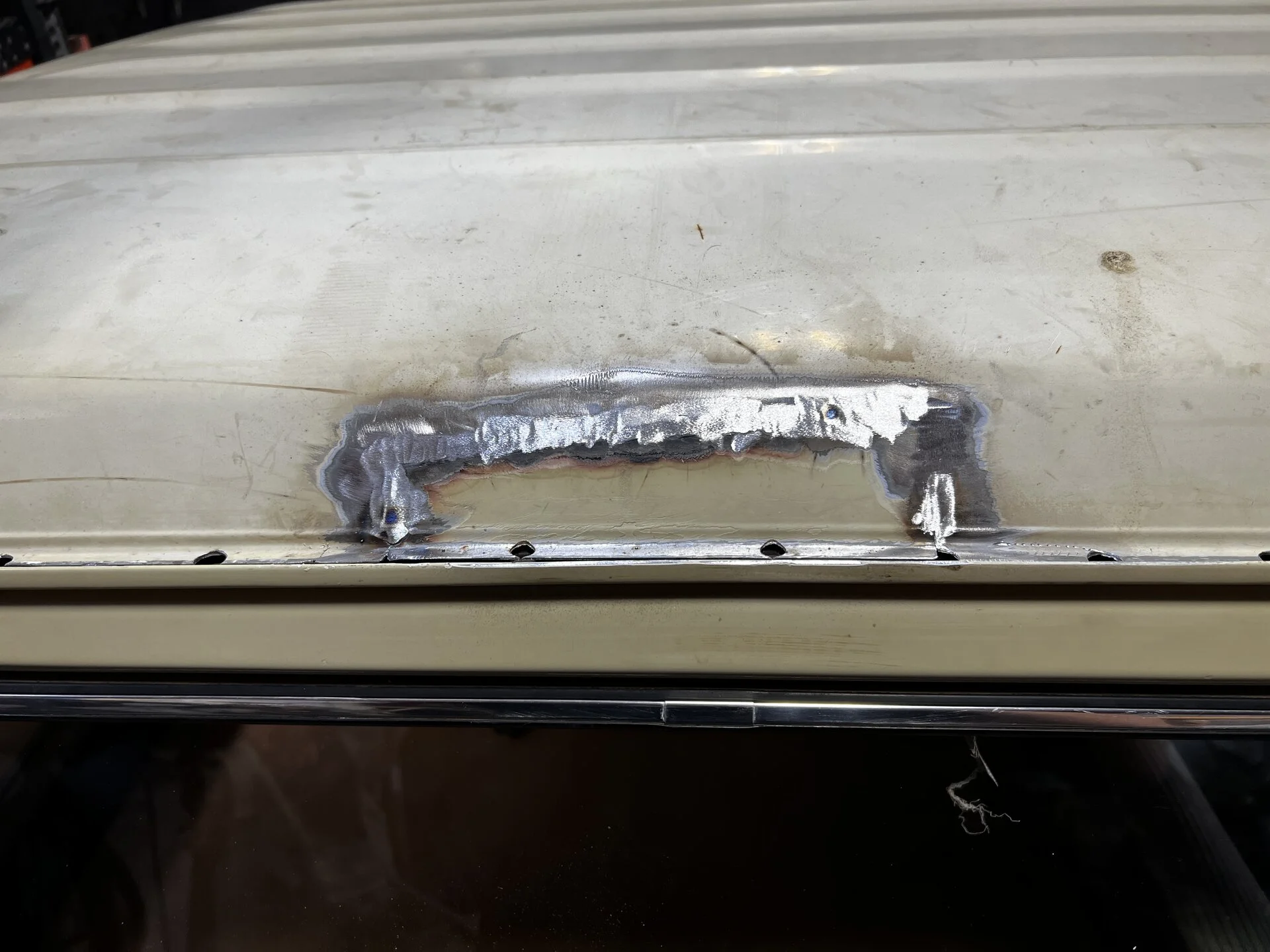

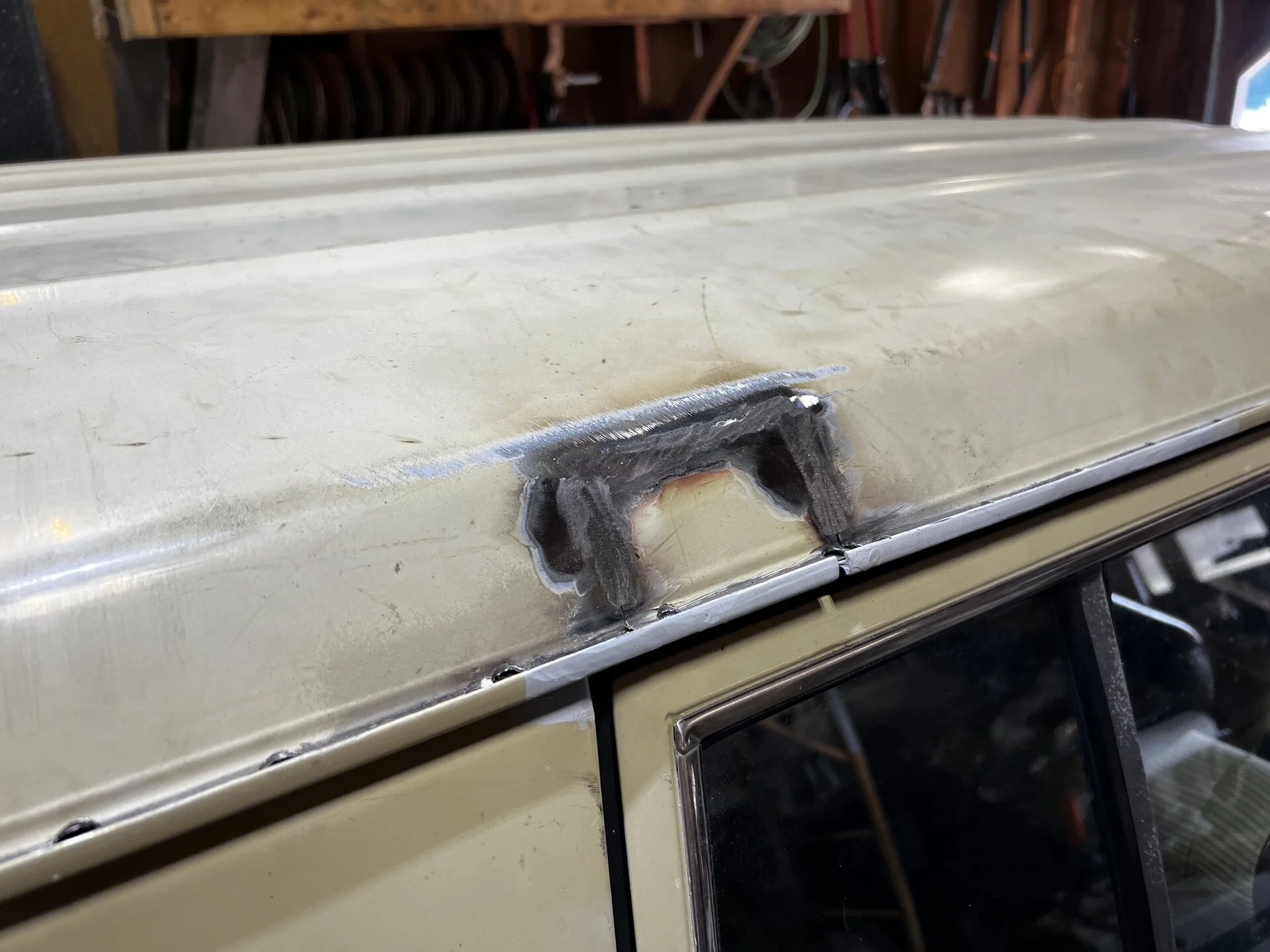

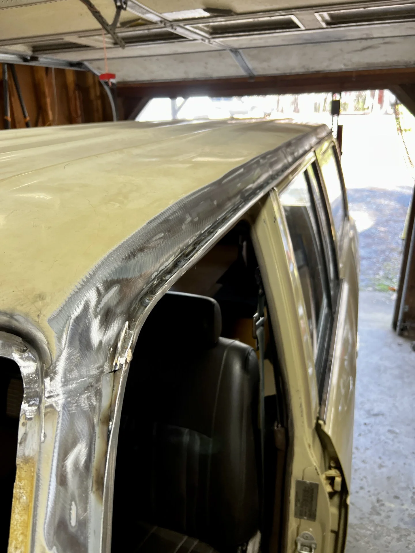

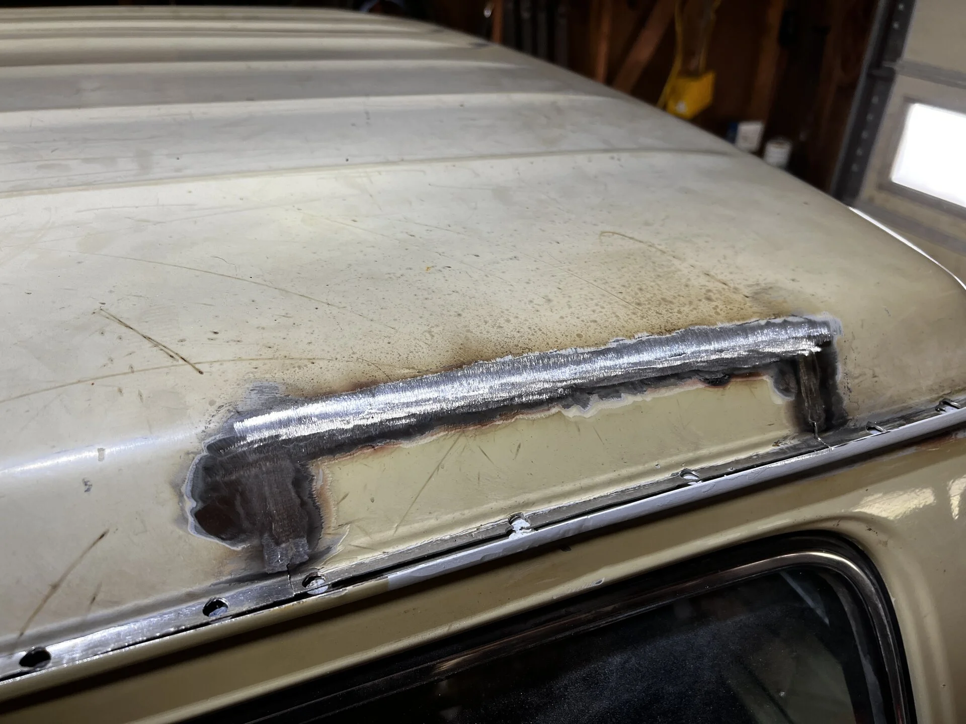

Welding in these long patches into the thin metal meant the gutter edge was deformed from the metal shrinking from the welding. You can see it here. These will get addressed when the roof is put back on next.

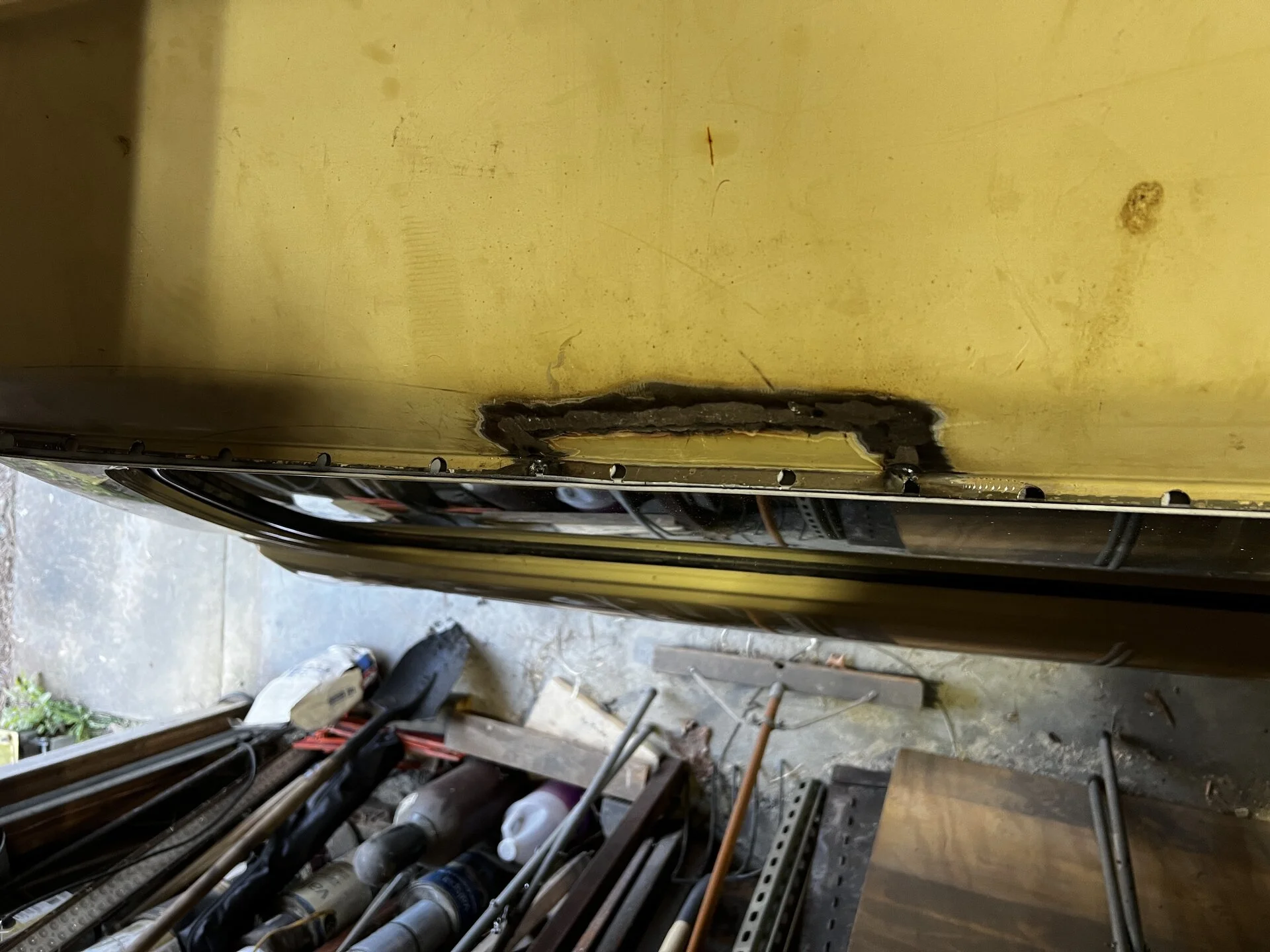

Then we worked on sanding down the patches inside and out and Johnny bodyworked the sides of the roof back to shape. His air file is the perfect tool for finishing off the sanding after grinding the majority of the weld bead down.

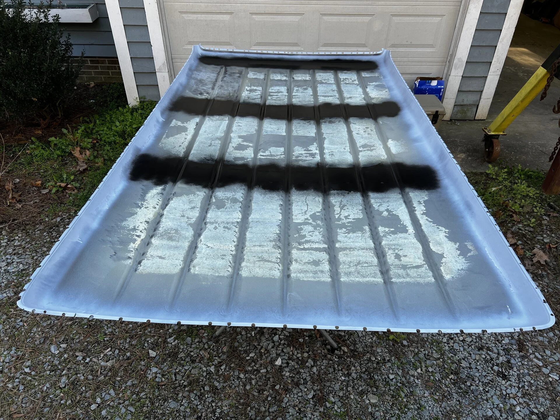

We primed the inside of the hood after grinding down the welds with weld through primer and sprayed some paint on the areas where the cross braces had contacted the paint on the skin. The new skin will get completely covered in sound deadening before the new headliner goes in.
We also primed the gutter and inner structure with weld through primer to prep it after wire wheeling the gutters once more to make sure they were clean.

You can see how the gutter where it was preveiously shrunken from the welding has been shaped back to normal.

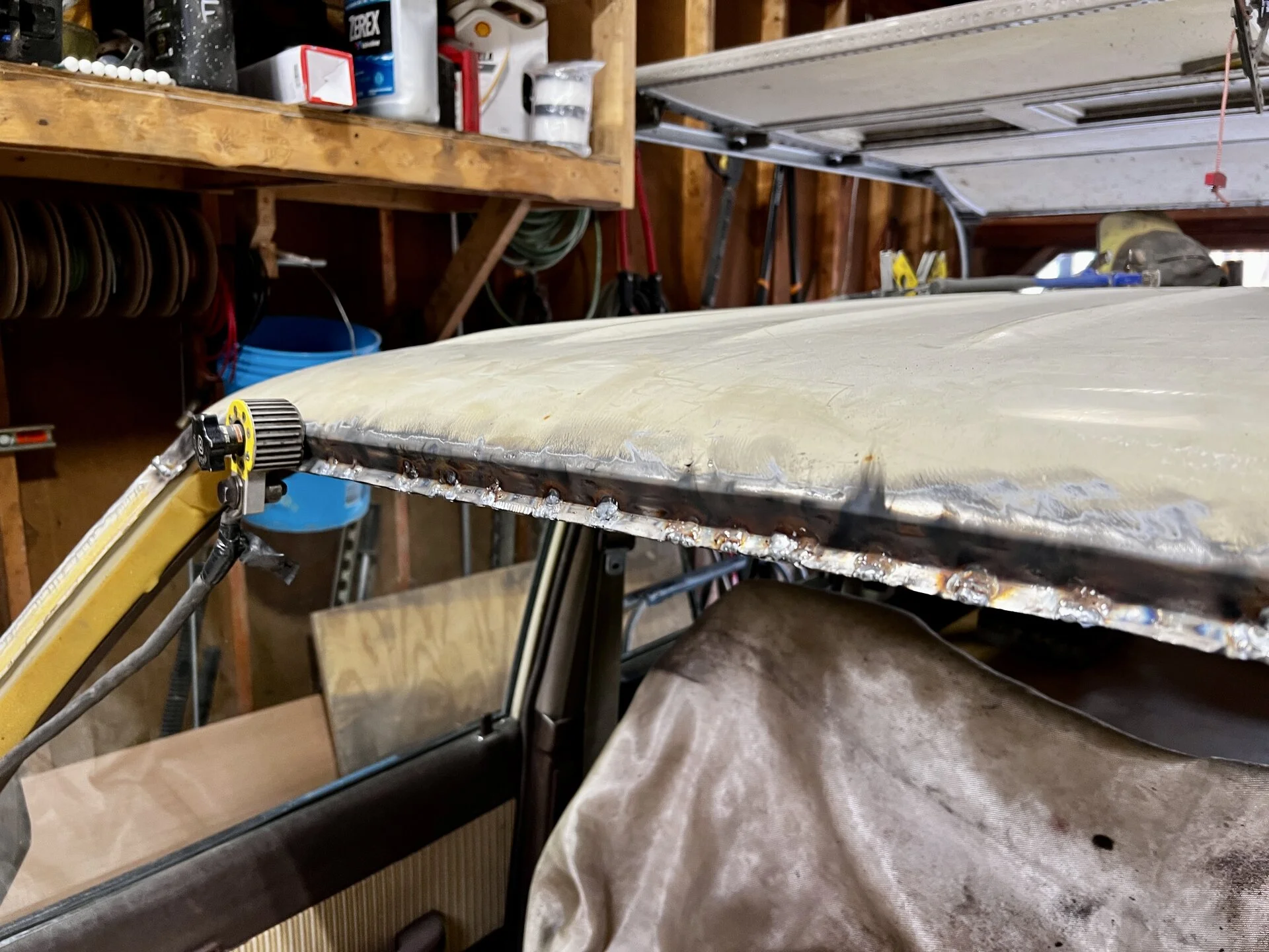

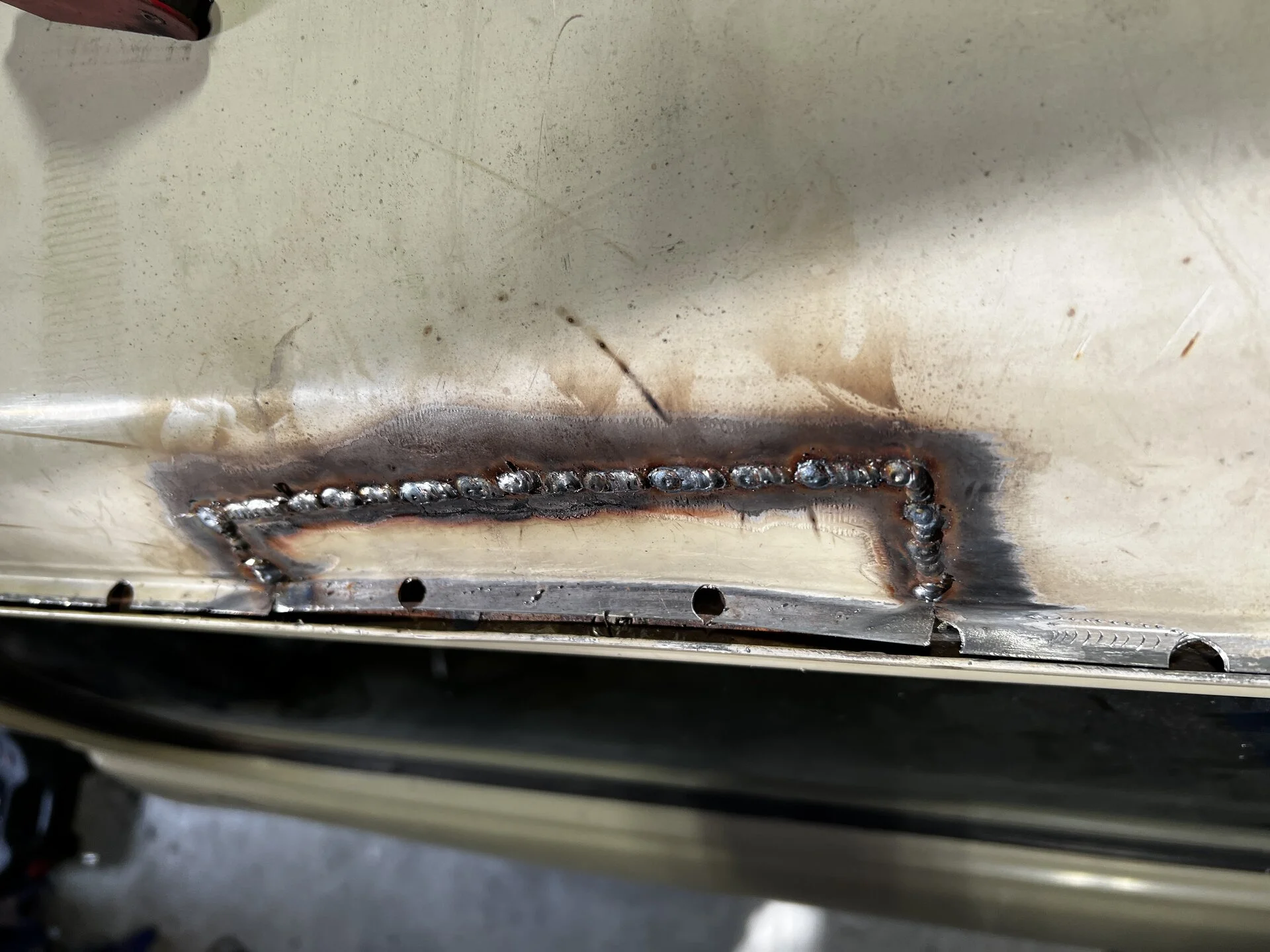

Here was the process we used to weld the roof back on with the intent of preventing any warpage of the skin due to welding. The roof skin got a little wonky with our on, off, on, off and bodywork so we made sure it was square and ready to go when we put it back on.
1. Clamp front edge and press the outer corners into the upper corners of the window frame to ensure the contour matches.
2. Weld the entire front edge after tacking the front corners.
3. Weld every 3rd hole down each side doing about 1/2 of each side at a time.
4. Once the entire roof was tacked in at every 3rd hole, the rest of the roof was welded in hole by hole.

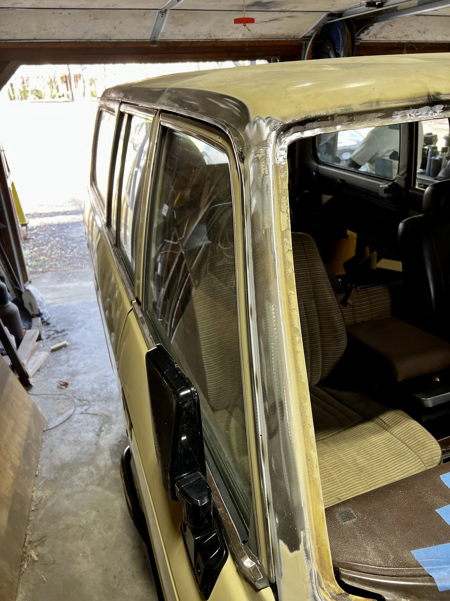

Here is the front edge welded and every 3rd hole. The intern who cut off the roof caused some extra work for the welding team on the roof skin so there's some pretty large welds to fix *someone's (read: my) mistakes.
Many hours of using the mini air sander and the front edge was cleaned up and ready to go!
Entire roof skin is welded!!

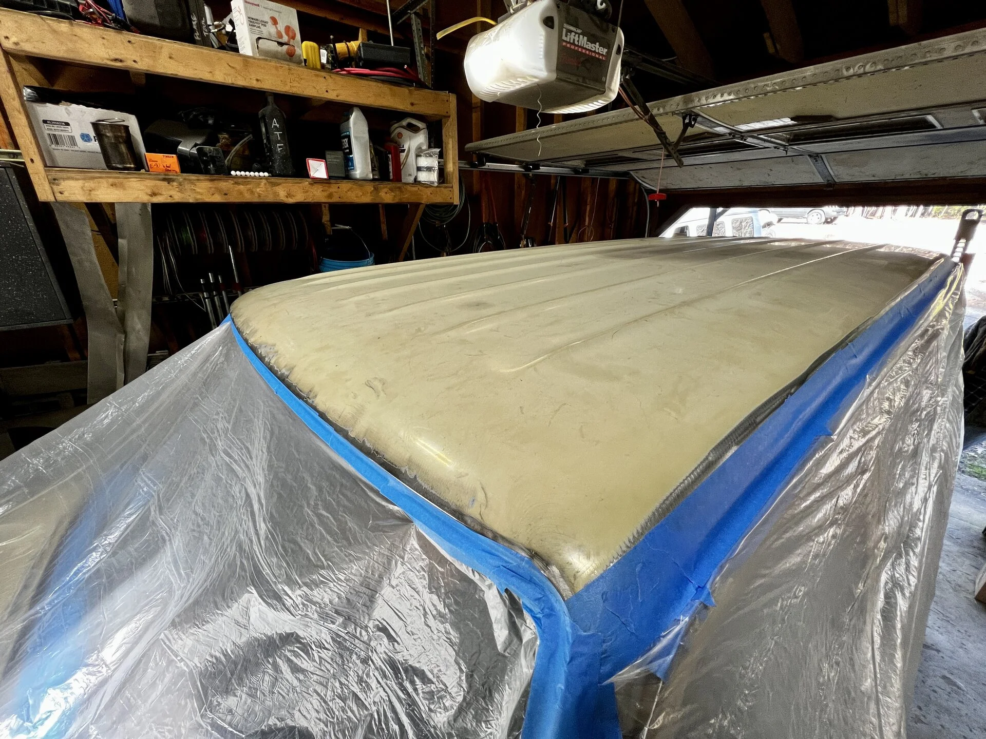

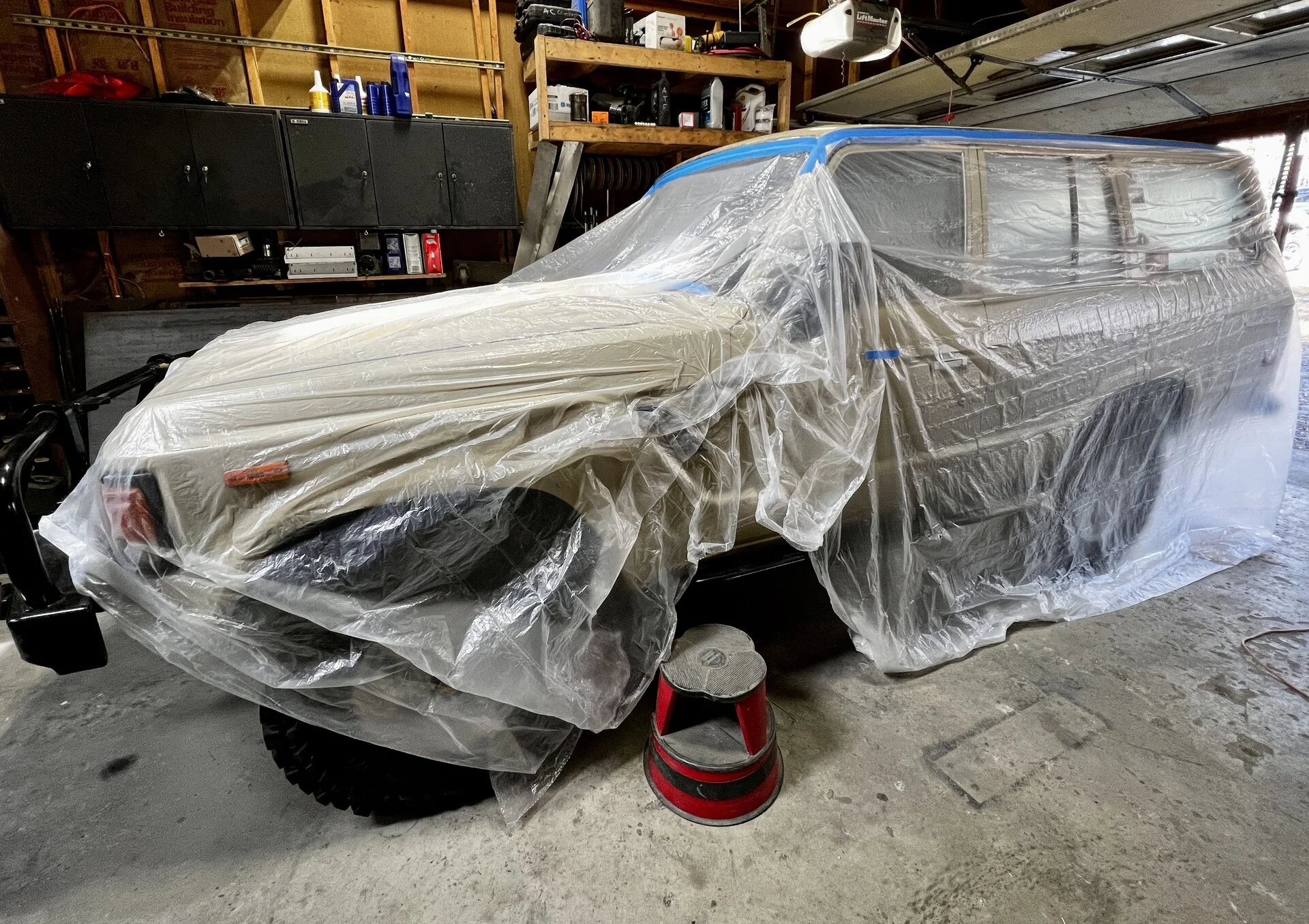

Then we stripped the paint off the outermost part of the roof skin to make a clean attachment area for the masking tape. We masked off the truck except the roof skin in preparation for chemically stripping the existing paint.

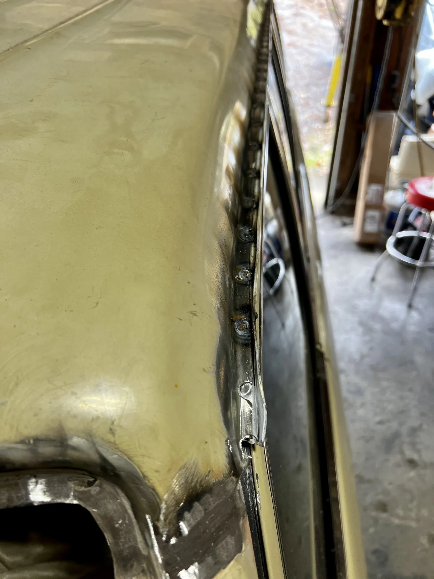

I also spent more hours with the mini air belt sander grinding down the welds on the undersides of the gutters. Still need to spend more time with some other sanding tools to get above the pillars, quarter windows and back window.
Paint stripped in preparation of masking.

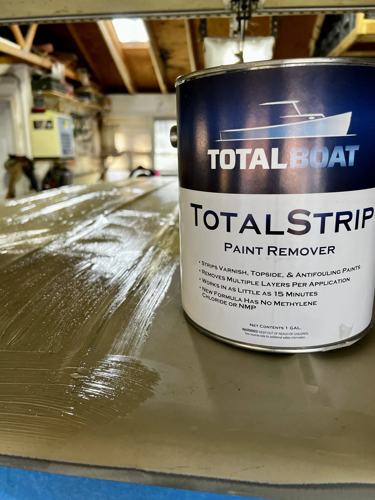

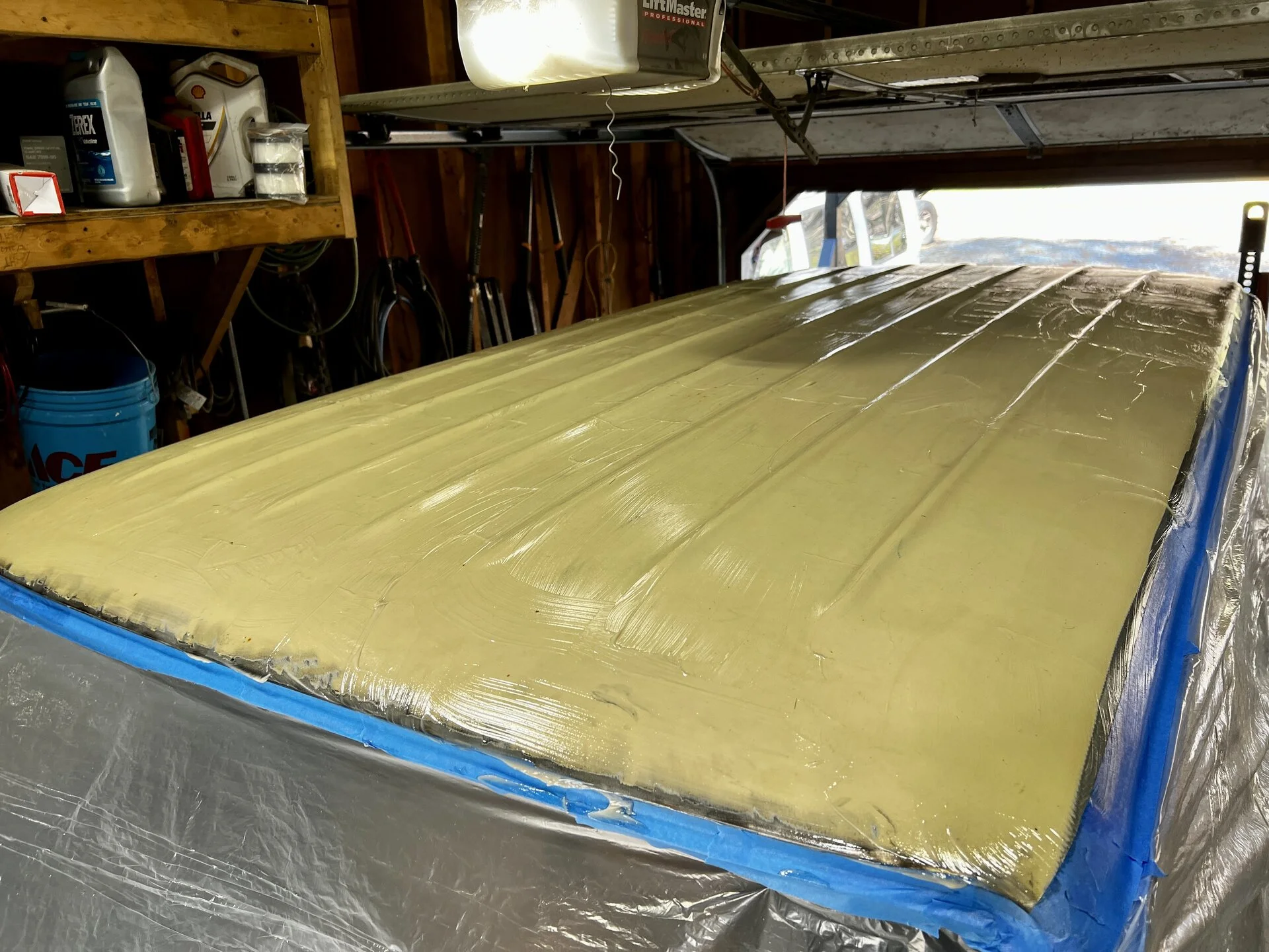

Masked and paint stripper applied! It goes on like a jelly so it sticks pretty well and the plastic sheet was probably overkill but that never hurt anyone. We then covered the strip with stretch wrap to prevent it from evaporating too quickly.
