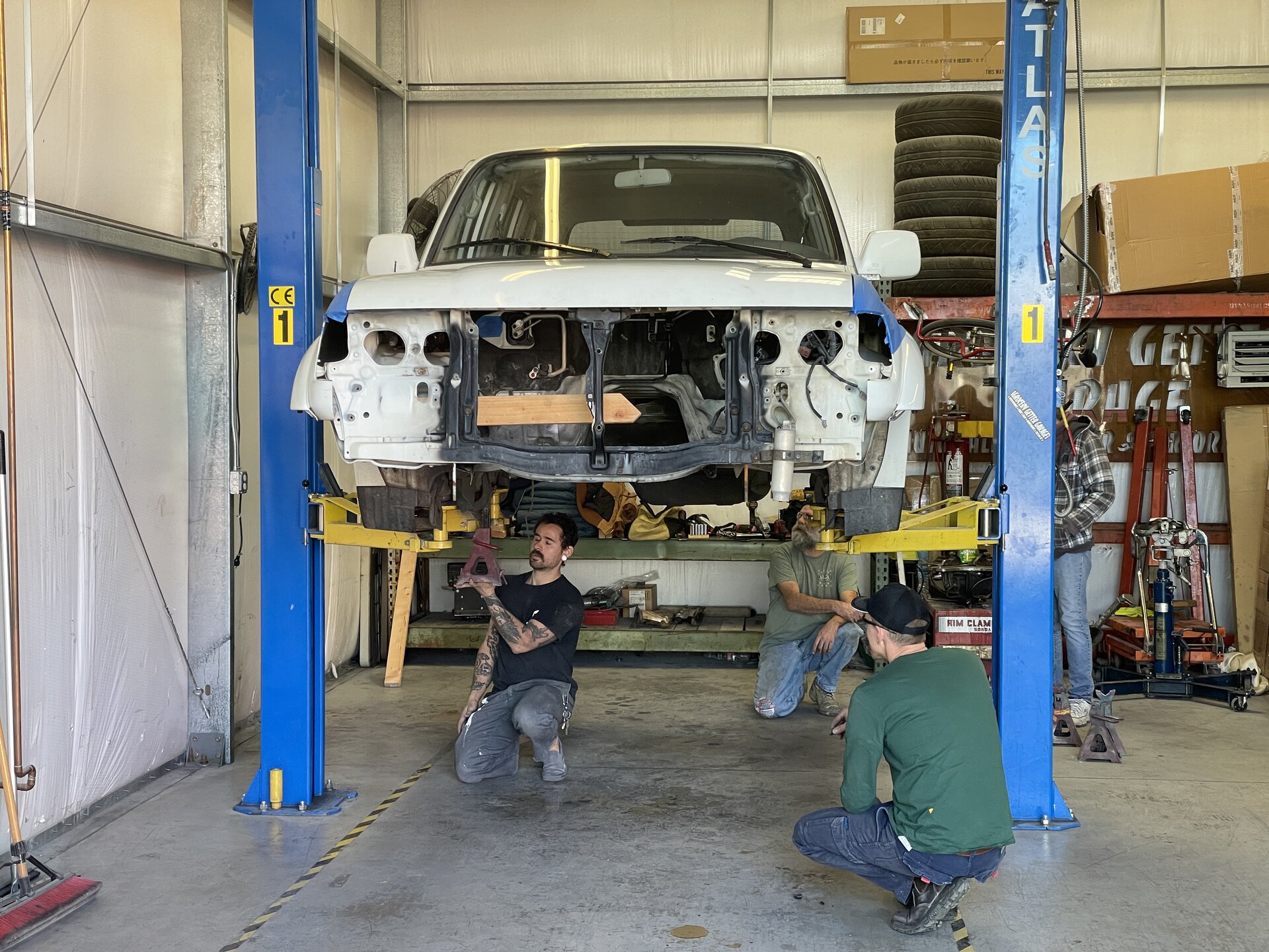

After a week of calling in favors for more free-ish labor and booking a lift at U-Wrench in Vail, AZ, I was ready to pull the body. If you ever need a lift or access to a full shop, give them a ring. Tell them Jason Neeley told you about them. They are cool dudes who have a unique business and are happy to help out if you get stuck on something.
I rallied support from @D_Web and another buddy Rod, and we met early morning to pickup a car dolly from U-Haul and make our 8:00am reservation on the lift. I had the 80 loaded the night before, so off we went.

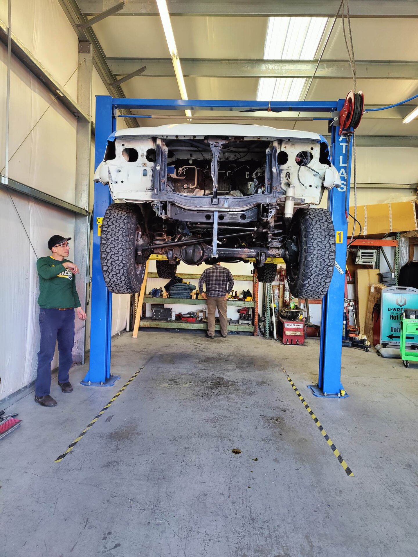

Fred at U-Wrench helps us get Rufus on the lift ensuring we weren't going to see it do a floor routine onto its lid. Once in the air, I was reminded again why my next project after this will be to move into a place with a shop or room for a shop big enough for a two post lift. Nothing makes the work easier than being able to standup and walk under you rig.
Ben negotiating with...I am not sure.
Some goober playing with the lift.
Divorcing the body and chassis was actually quite easy due to all the pre-work. disconnect one missed harness, pull the body bolts, pull the steering shaft, and a few bolts on the rear bumper trim...simple. Many thanks for the extra eyes and hands on the effort. The real challenge was figuring out how to get the body off the lift.
Processing...processing...processing...
Plan forming.....

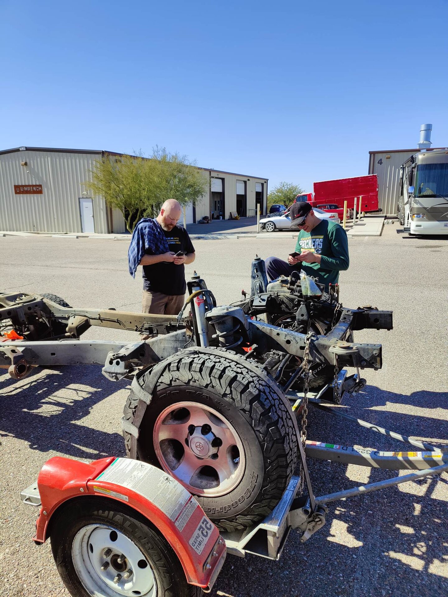

Action plan! We ended up doing a bit of shop time ballet. We had to drop the body onto some jack stands due to the lift arms hitting the trailer tires. Once we got hte body off the lift, we cut some cribbing, repositioned the arms and lifted it off the stands. The cribbing was made of framing studs which allowed the running board brakets to bit into the wood, giving a bit more security in transit home. Two giant ratchet straps through the cab, one through each door opening, and we were done.
Ben hauled the aforementioned car dolly in order to drag the chassis home. This is us trying to figure out where to find a good cheesesteak sandwich. We ended up chowing down at Luke's Italian Beef on Alvernon. I recommend the Italian Beef wet with sport peppers. If that's not your pace, grab a pastrami. Killer grub!
What was planned to be a morning's effort, ran only slightly longer getting us all back to my place around 1:30pm. We unloaded the chassis and pushed it up in the garage, and I parked the body on the curb for some clean and storage prep work.

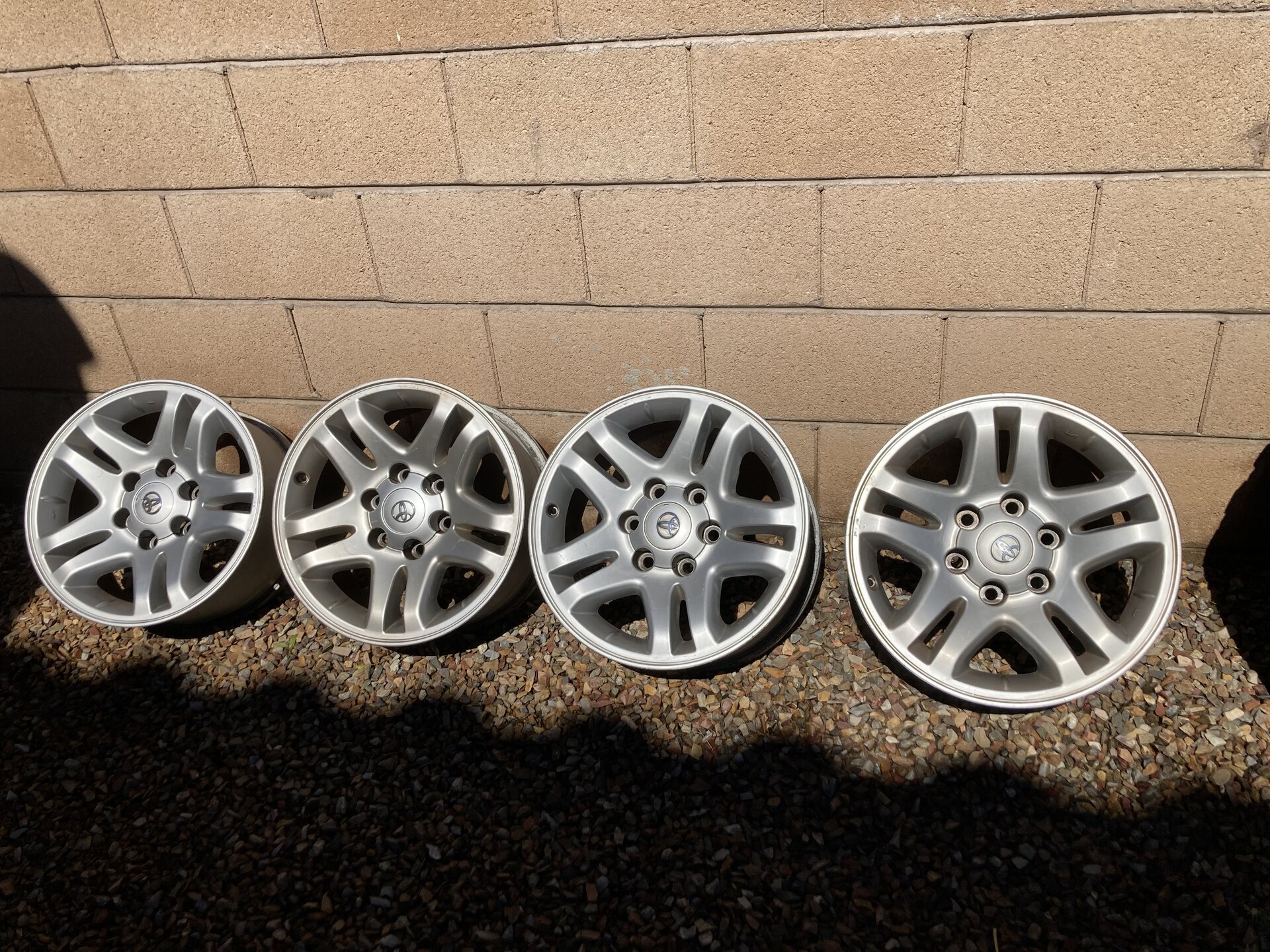

BRONZE WHEELS.........?
Black wheels... never liked the bronze look... but it's all preference:
1652314746846-png.3006427
These are the summit racing raptors in 17x9
I think black has my eye.....
@GeoRoss you have been tagged.
Stick to greyish sliver, the truck is from the 90's after all - I have 4 Sequoia / Tundra wheels - I'll trade them for that skid plate you're trying to sell. 17x7.5 15 backspace. You'll need 1.0 to 1.25" spacers to run these.
Thanks for the offer. The plate is currently promised to someone and on hold. Ill check to see if they still want it.

not a fan of the bronze. at all.
I vote for staying with the silver (or whatever they call the OEM color)
