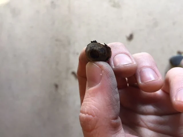

I also found this in one of them.... Does anyone recognize what this might go to?

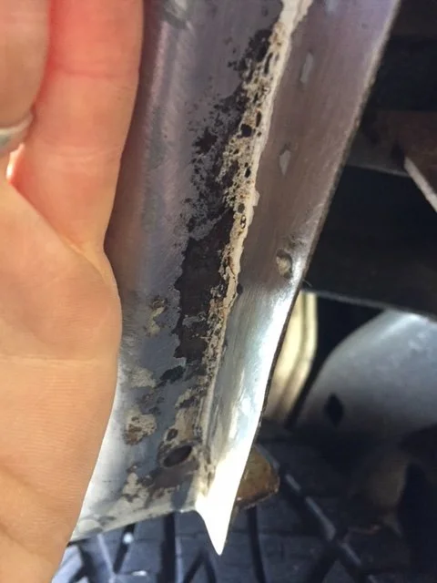

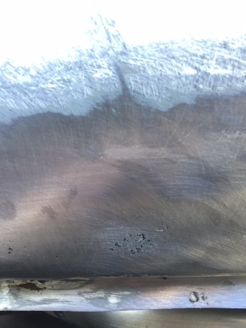

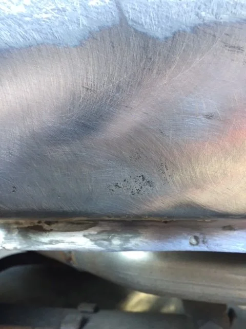

Alright guys I spent some time grinding and there seems to be one problem spot on the face here:

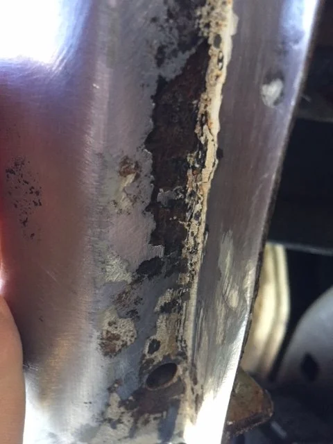

And the underside here:
the plug had been painted over by a previous Owner.... Yikes...

I think the underside will need to be cut out at some point, and I am going to continue to grind the spot on the face to check its strength.

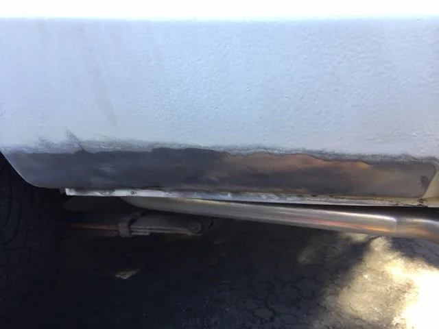

Its like 50... Not in a shop, but also I am not doing any repair today just had time to take it down to the metal.
Wait for warm weather to paint. You could just spray some cheap spray paint on it until warm weather ...then finish it. Filler doesn't set up that well either in cold. So you'll be waiting a while between coats.

The picture of your QP underside is rust from the inside coming out. Mine was exactly like that ten years ago. I did a modification where I trimmed the QP shorter. It's pretty common.

That panel is actually in really good shape... Like @g-man said, grind down that area that you can see the rust has pitted. Either it will blow through or it will take it out. Once you get down past that stuff then just throw some primer on it and call it good until you can get some days that are above 55* for a majority of the day to paint.
