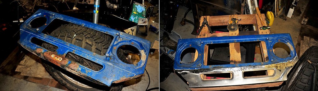

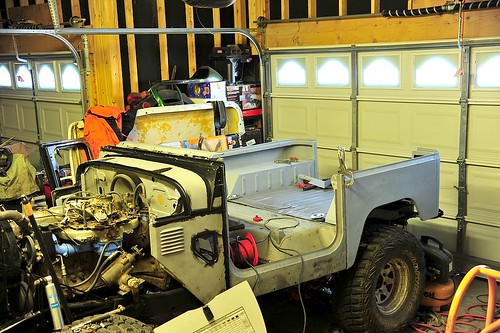

Got the apron patched with the help of my friends...Hobart and Hypertherm.

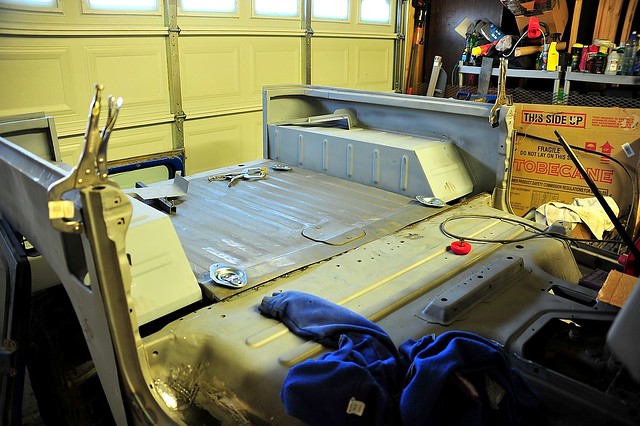

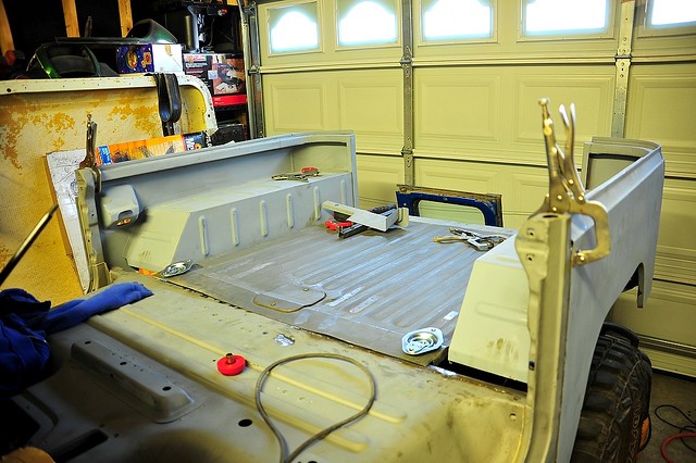

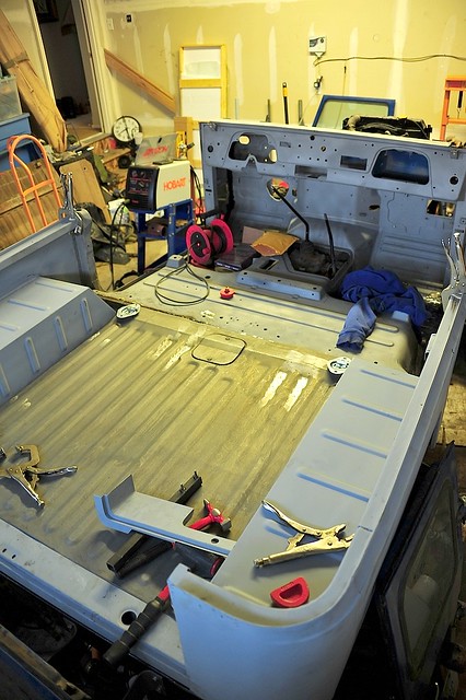

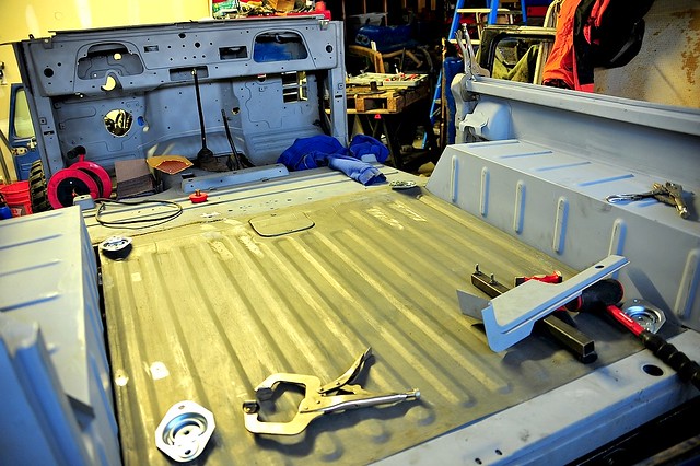

Mocked up the back side of the tub today, trying to get a picture of what needs to be nipped and tucked...

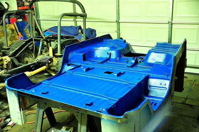

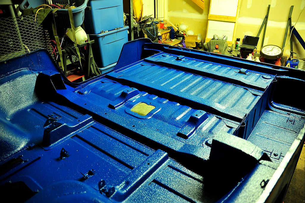

Thanks Man...I'm a bit further now, the tub is upside down on horses, getting ready to spray the "chassis saver" rust preventive paint and the U-POL Raptor bed liner on it...hope that will save it from getting rust any time soon.
I'll ask....How the heck are you moving that tub around? Are you getting your wife to help? My wife can barely pump brakes for bleeding, much less help me flip a cruiser tub over!
Well, she was helping move it around when it was a half tub...now being a full tub, I asked a buddy to stop by and help me take it off...it's still a bit heavy for two people, especially when you have to tip it over the shift lever. Hopefully painting will be done this weekend and I can put it back on the mounts and start painting the inside...then the outside...then...you get the picture.

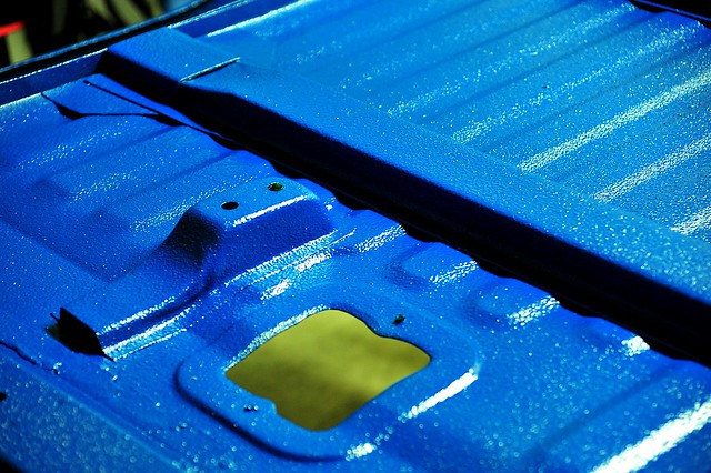

Of course everything takes longer than anticipated, I had a grand old time getting the wheel well supports put in so they would line up with the roll bar...got that finally done, shot it with a coat of chassis saver then shot it with tintable raptor bedliner...wait for it to cure and back on the chassi it goes, while it dries I will get the exhaust back on the frame and replace the back brake line with a longer run to accommodate the 4" lift with the 33's...it was stretching out before...replace the front transfer shaft seal...and we are in business...
Would you recommend that chassis saver for axles? I'm going to be working on the new set I got this weekend and figure I might as well paint them while everything is apart. Can you get it locally?
Yes you can get it localy, it is at Dale's Paint Supply, 515 North Circle Drive, Colorado Springs, CO (719) 636-2635 ‎
they have a regular one, which is in a yellow can and one in a red can which is the industrial (glossy)...if you get the glossy you need to be careful that it gets ZERO sunlight on it, since it is not UV protected (it will turn gray in color). When I painted my frame with it, I just got some black spray paint cans and rattle canned the top coat on...
You can also get some reducer to paint it with a gun, thats what I did on my undercoating, before I put the blue bed liner on it.
