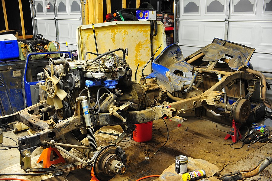

The cab is off the frame, there is a little more rust damage than I thought, but these projects are all the same...you always get more to do than you expect.
I am moving on now to get a Cherry Picker and try to just lift off the engine, tranny and transfer case all together, then just un-latch the axles and take some of the brake lines off...off to the sand blaster it goes...(anybody that can help me on the cherry picker issue and transportation to and from the sand blasters...would be greatly appreciated). "sorry I don't have any stickers to compensate with...but I did make a lovelly club logo...":p

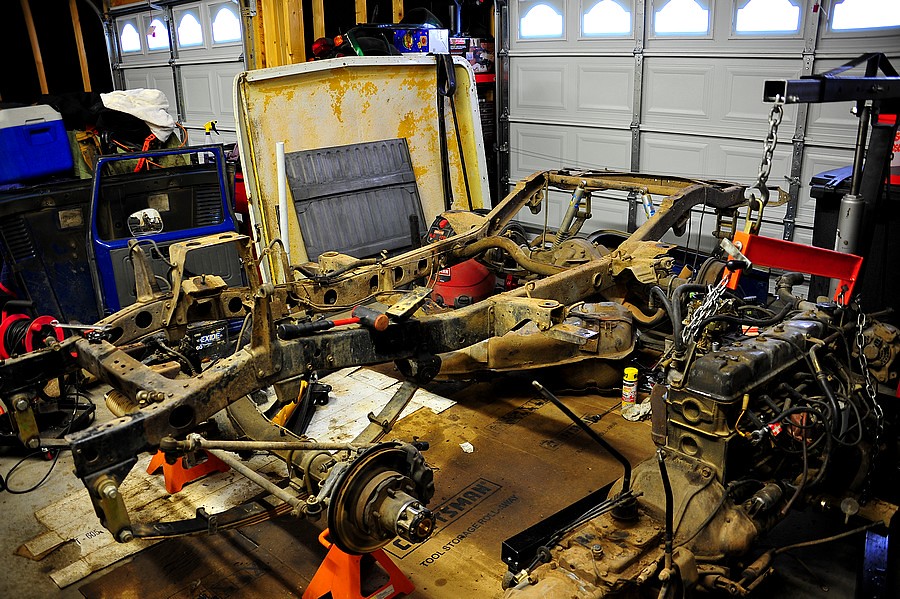

Work continues...thanks to Luke for letting me borrow his cherry picker.

Frame is at the sandblasters...thanks to Chuck for using his trailer.
You getting it powder coated? Spray paint is just not going to hold up, but make sure you do all your welding first, like for sliders and bumpers.
I am not going to powder coat it, I am going to use "chassis saver" it's well known and I have not heard anything bad about it except that it does not have a UV blocker...it's exactly the same as POR 15, but without the UV...which makes it cheaper...it's going on the frame so I'm not worried about UV under the vehicle. I am going to dilute it by 2 parts and spray it on so I can get all the nooks and crannies...the frame has some circular holes in it that I just can't get with a brush...so I think this is best.
I am getting it sandblasted so I can see any stress fractures and mend them...if I powder coat over the frame without looking at it, I could be overlooking potential problems.
