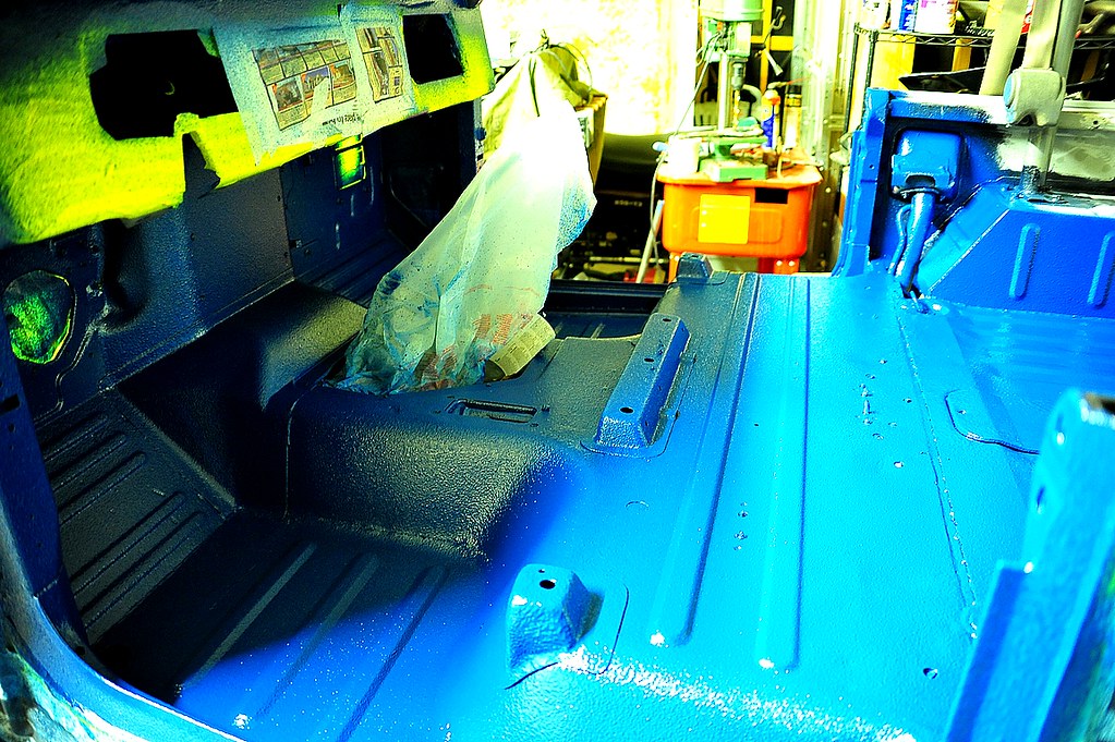

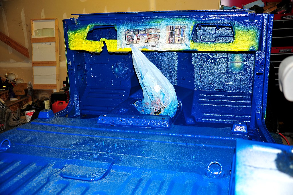

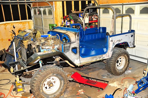

Got the tub back on the frame, put the roll bar back on and chassis saver painted it, prepped the tub for paint and installed the gas tank and fuel lines, replaced the leaky front output seal on the T-case, mocked the fenders for correct fitting and prep for undercoating...waiting for more U-Pol undercoating only got half the tub coated...:doh:

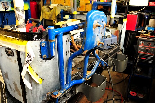

It was a working Easter weekend.

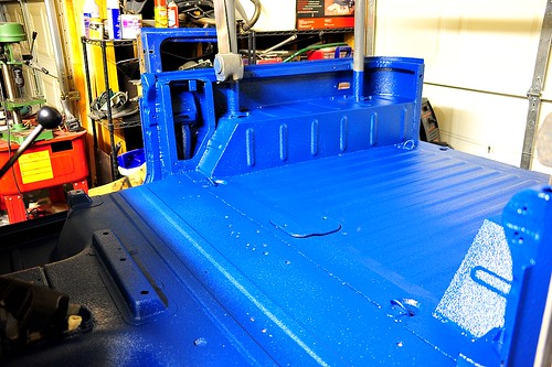

Saturday...
- Got the nuts welded on the tub, to secure hard top.
- Re fabbed the gas neck housing and installed it on the tub.
- Installed the E-brake.
- Patched up the hole between the wheel well and bed
- drilled the holes for the tire carrier and welded the support for it.
- Cut the holes for the side mounted lights on the rear quarter panels.
- Welded the jack rod supports on the wheel well.
- Bed-lined the rest of the tub
- Installed the drive shafts.

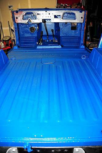

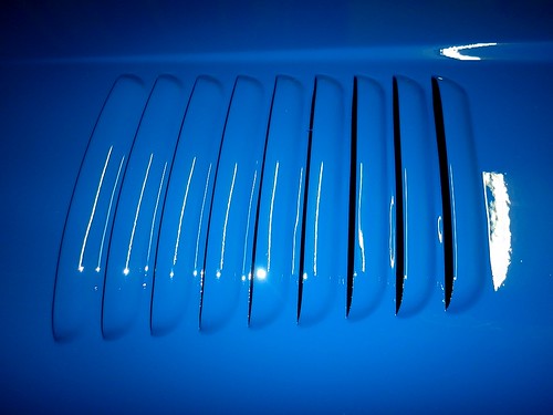

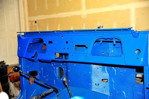

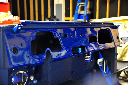

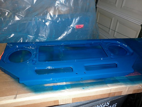

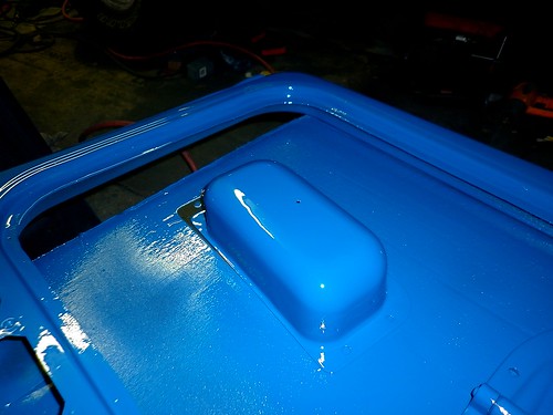

Dash has been painted...got a little chunky on the paint...think I put 5 or 6 coats on...but looks good to me.
with flash...
without flash...you can see the gloss...

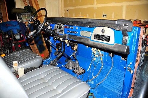

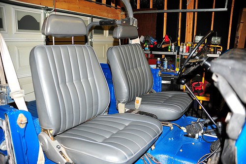

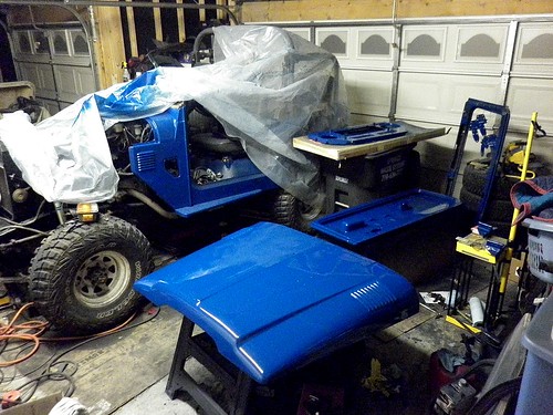

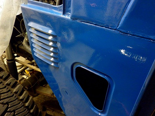

Got the wire harness in, she has life...but no turn signals :confused:. Need to put some fluids in so she can start her engine...Need lots of fluids...brake, radiator, oil, gas...parts came back from the sand blaster, got almost everything painted except the hard top and fenders...fenders should be next.
blue, blue, blue...
