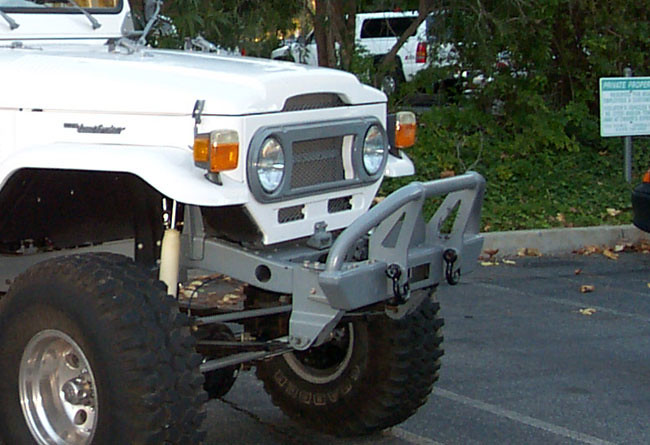

I think I will put it on a 4plus bumper from Man-a-fre...something like this...
If anybody in the club has any Fab skills that would help me build something like this...I sure would be interested...:hhmm:

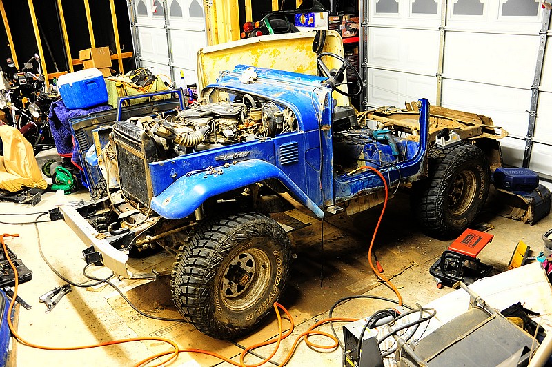

Oh my...I'm guessing it's rust repair time. That's a lot of pieces missing on your 40.
I'm debating getting it down to the frame and have it sand blasted...that would be a great start to rust prevention....but again...it's gona take a lot of work to get down to the frame...

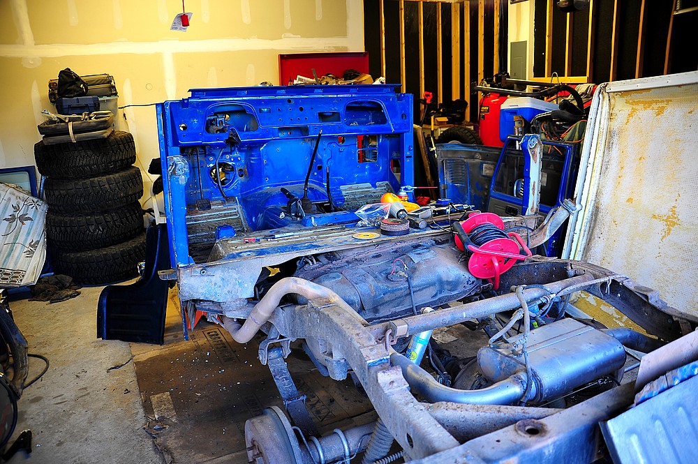

Thanks! I'm here in Colorado Springs. My next thing to do is get the brake lines off and remove the master brake cylinder and the booster...trying to get all the stuff of so I can take the front cab off and get it upside down...get all the rust cut and replaced, lather on some Chassis saver, put some Raptor bed liner on it and get the frame to the powder coaters so they can sand blast the the thing...then I should have a good frame to build it back up!

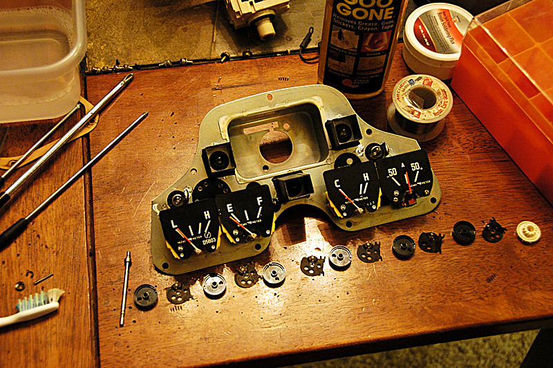

Working on the odometer right now...they are notorious for getting stuck...I see why now...the lubricant they put on there has dried and solidified to point of not moving :frown:, mine got stuck at 111k miles...I have no idea what it actually has.
