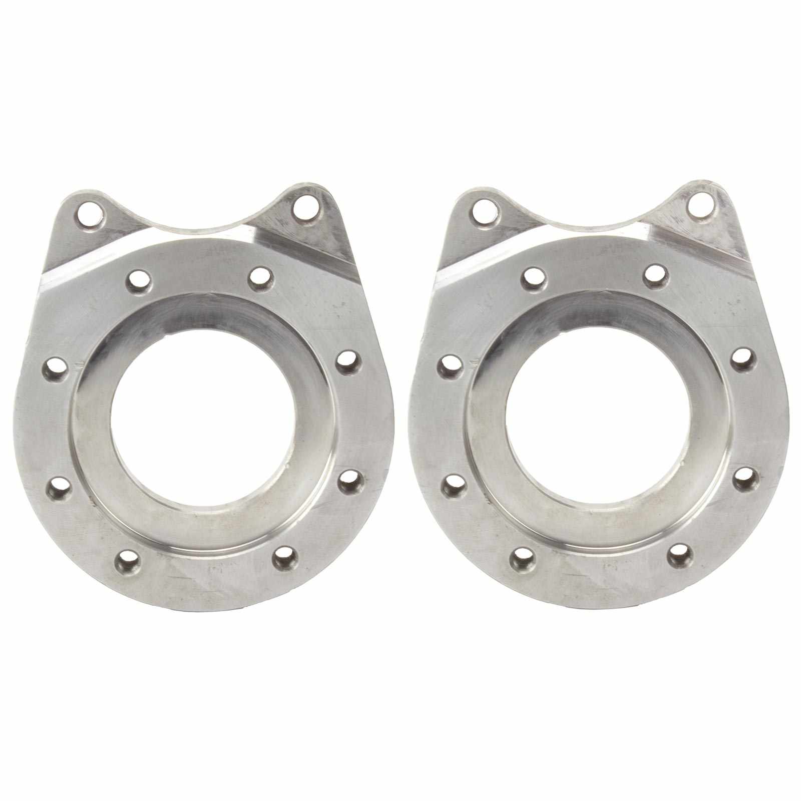

the brackets above are for the disc brake conversion on a full float axle

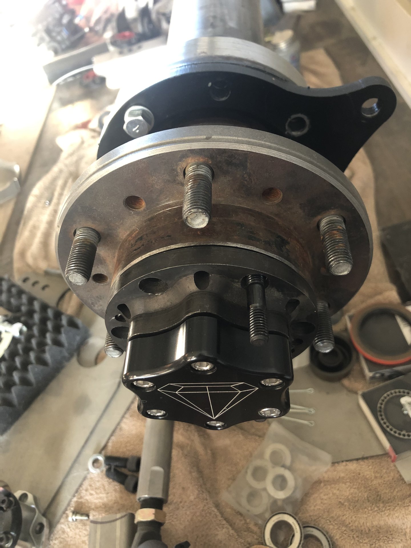

I myself have a Diamond housing that is FF. same set up. You would have to get custom axle shafts made . Think of it like your front axle just without the birfs

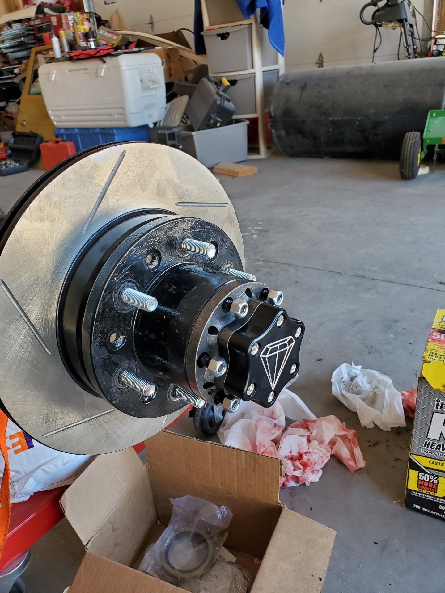

Here is a picture. You use the spindle and hubs from a front axle
I’ve seen a number of people covert SF to FF. If you read further down in the description, the main purpose of these flanges is to do that very thing. The disc brake conversion is merely a convenient by product of the custom flange.

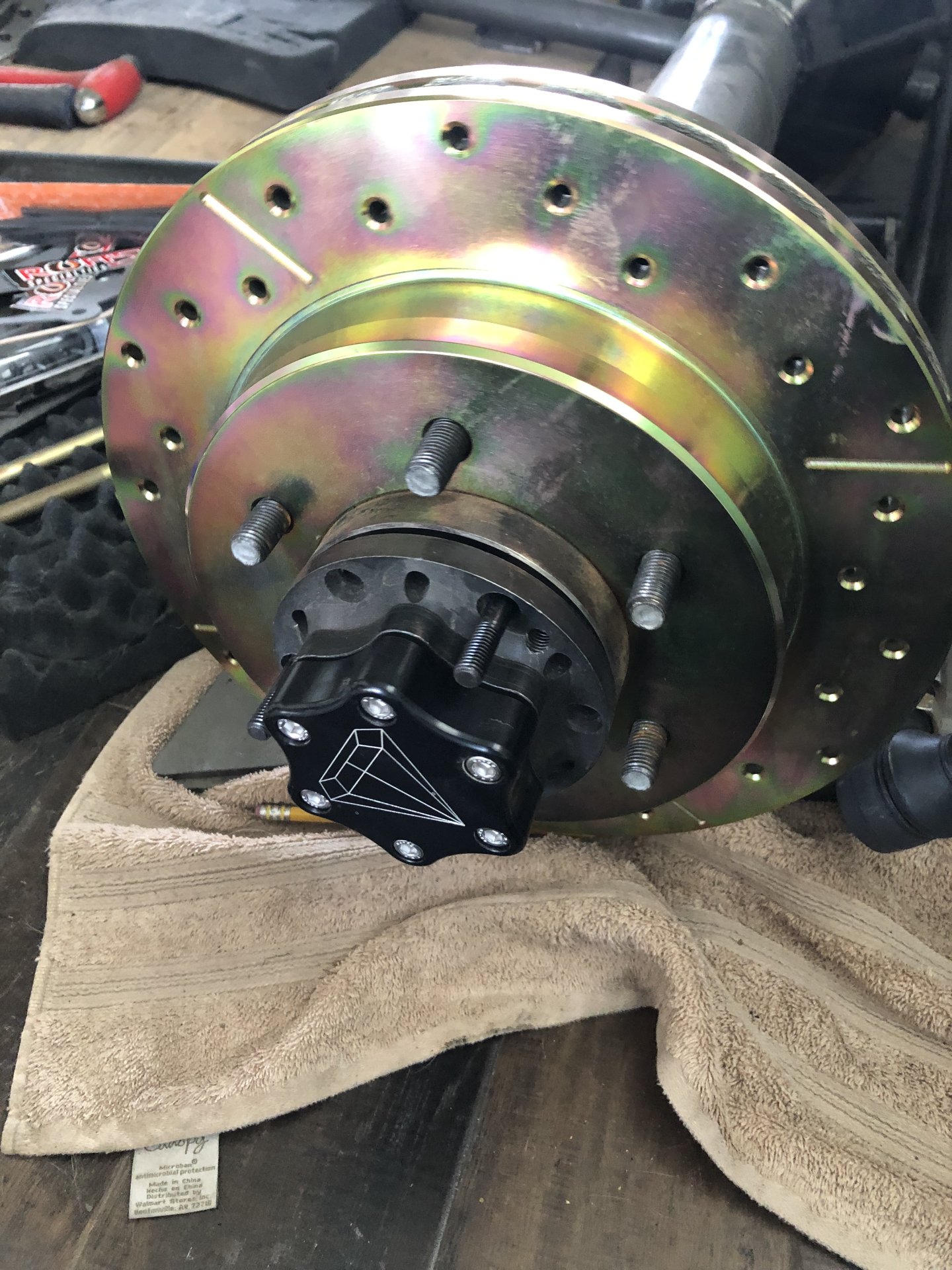

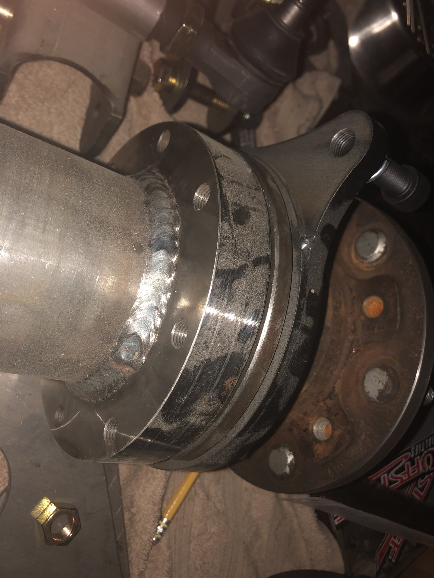

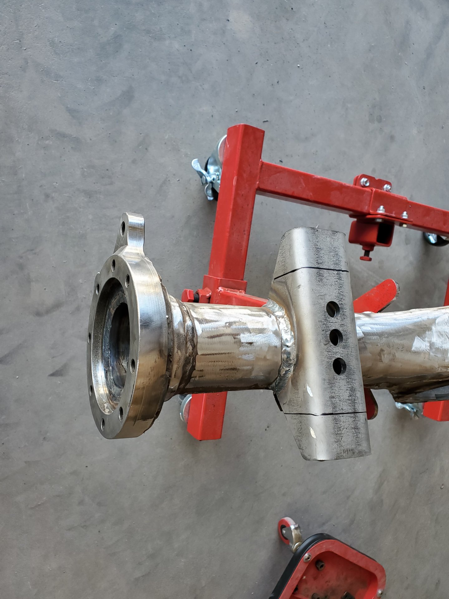

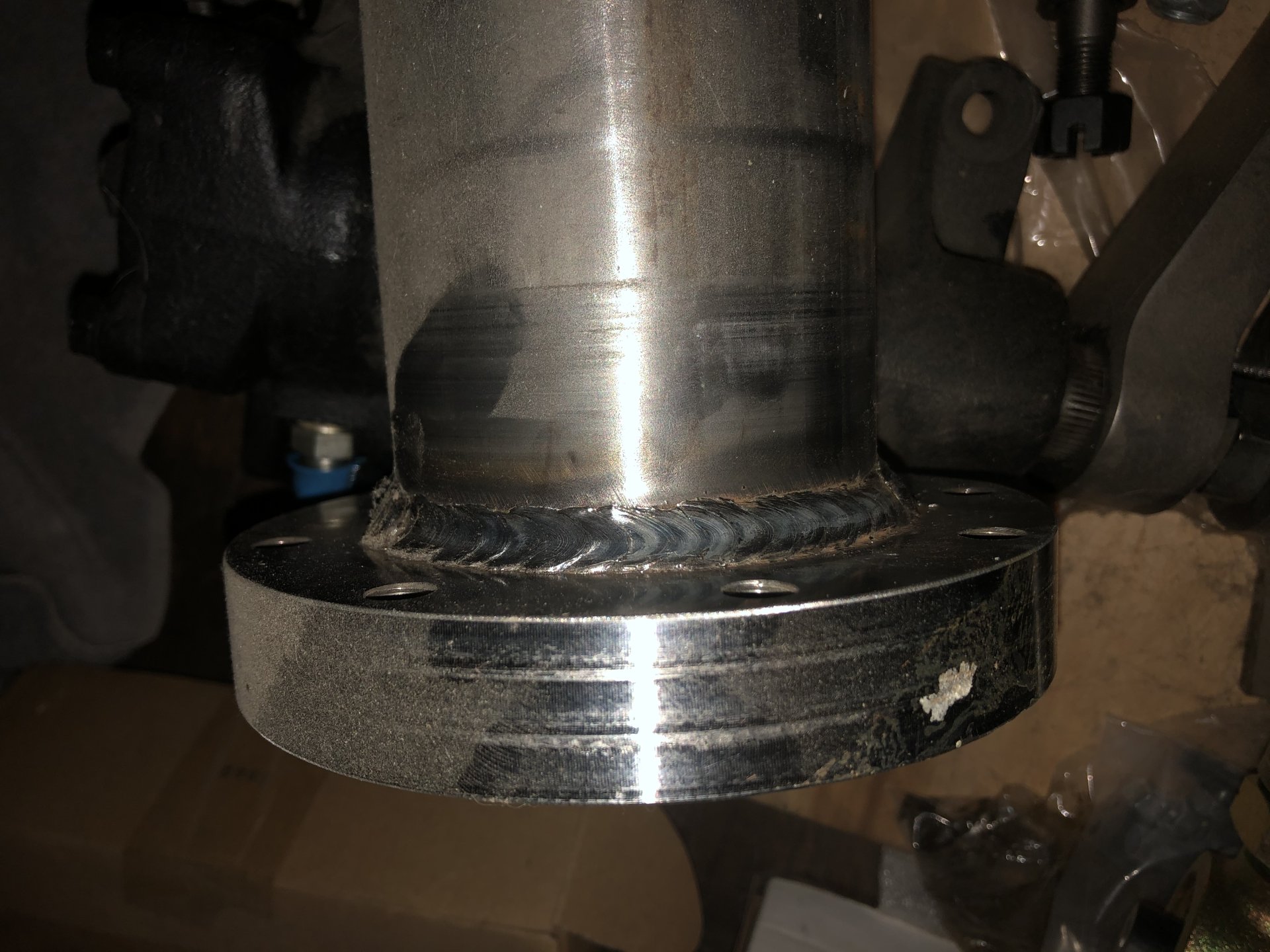

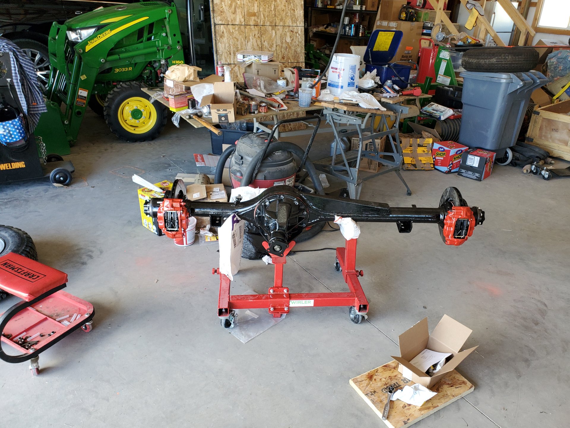

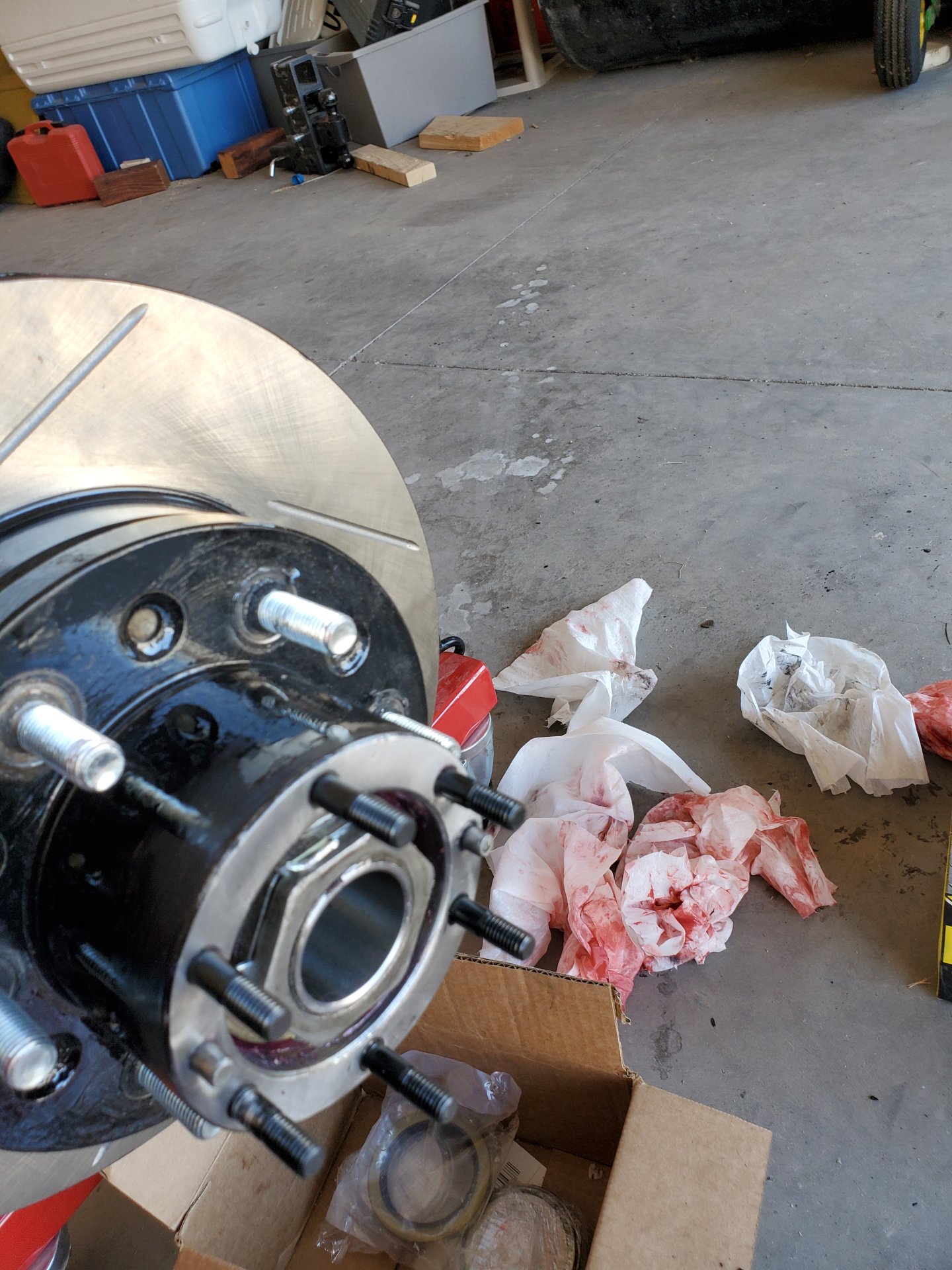

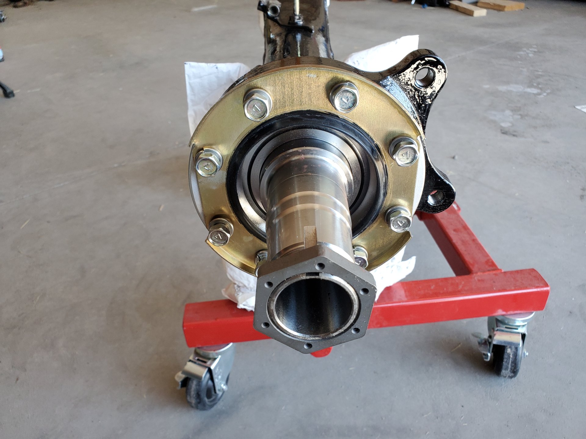

I used FROR brackets a had them welded to an FJ60 rear axle. I used new spindles that bolted to the bracket, remanufactured FJ40 calipers and new rotors that are slotted. I also used the wheel hubs from my front FJ40 axle. Before welding the brackets on the existing axle flanges were machined round to make welding easier. The new flanges were welded on the outside and on the ID inside. Then I was able to build the hubs.
