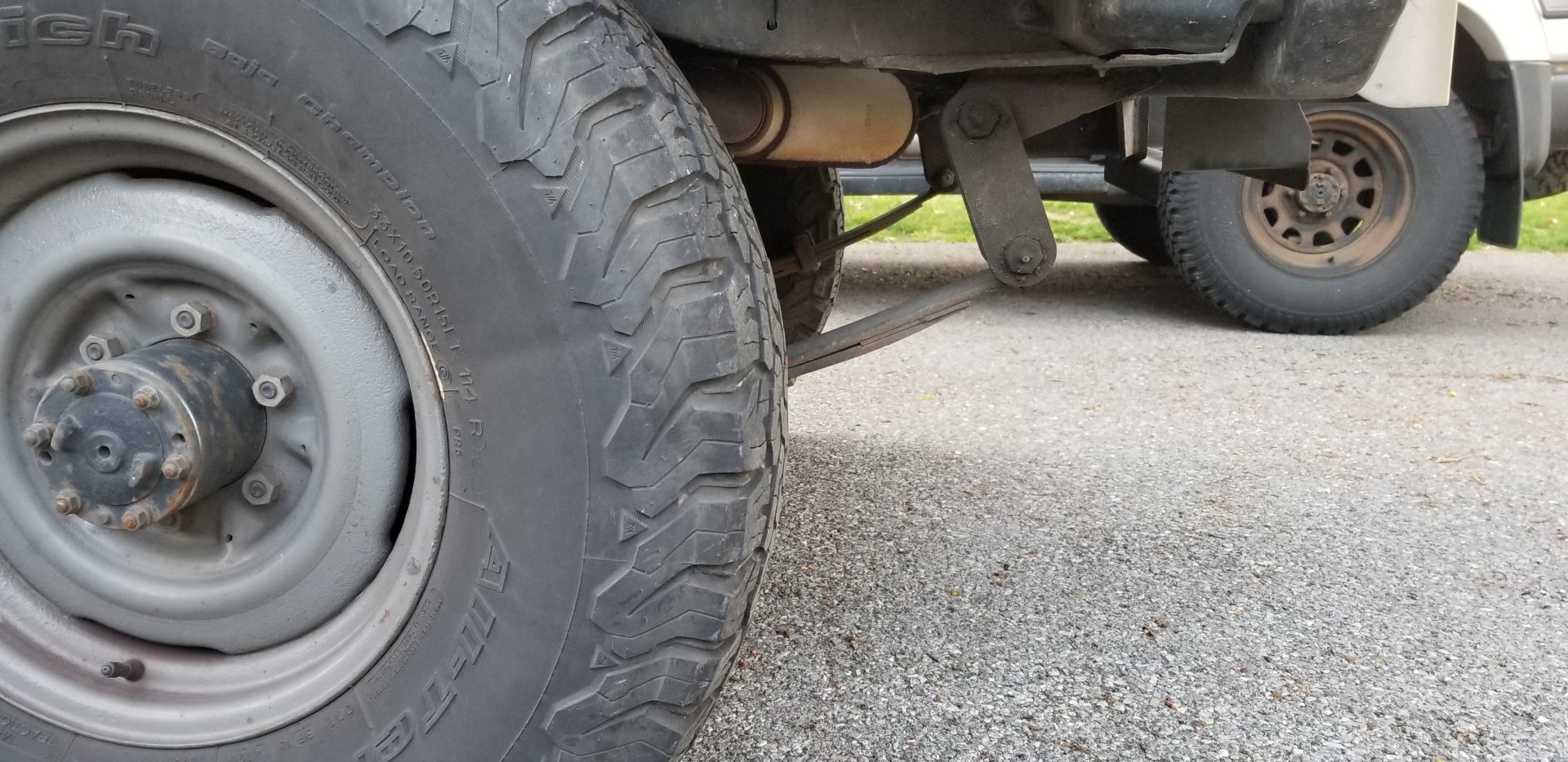

You also have the option to put a freewheel hub on if you choose, but did not, so I put Diamond axle drive flanges on mine. Just waiting for the shafts to show up and the rear axle will be complete.
Yeah, I actually like the idea of putting a free-wheeling hub on the rear. You get a lot of double-takes with that. My Suzuki Samurais had semi-floating axles, but I always mounted my extra hubs on the back, and people always thought I had a Samurai with a FF rear axle. It was pretty amusing.
