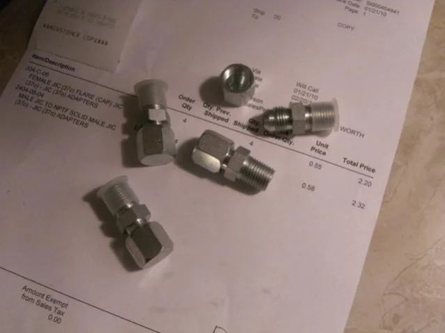

ok well got the gear box drilled last night, then tapped it today after i picked up the fittings. they were 1/4 x 18 pipe male - #6 flare I picked up 4 of those and 4 caps and it cost me a whopping like 4 bux and some change. got the ram halfway mounted to the axle tried to do the cool clampy thingy like boots revised his to but royally screwed up and tossed that idea, i have another type of sleeving idea i think i will give a shot that will be much much easier to do and should be plenty strong.

I got some pictures of the part numbers and prices for the fittings but i will post them later with pictures i have yet to take of the ram and junk.
1.) Fitting part numbers and prices
2.) total
3.) what i bought

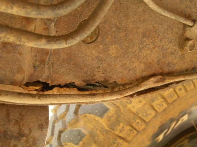

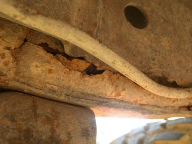

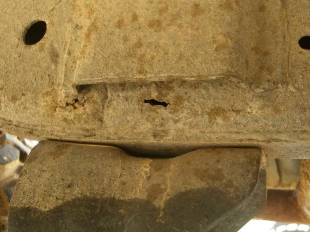

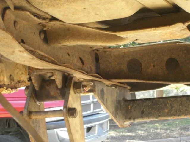

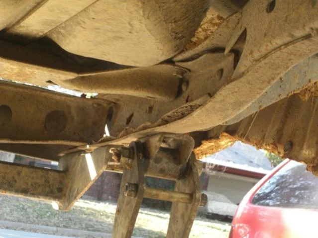

1.) then looking around i see this.... very very depressing... It goes all the way through and is right above the passenger spring hanger
2.) nother
3.) driver side rear spring hanger.

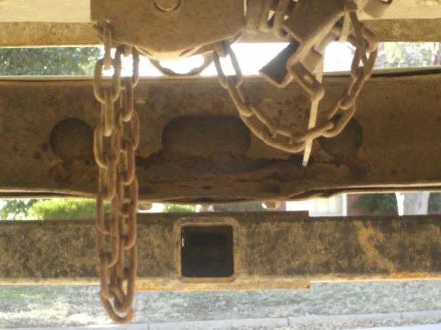

I was aware of the crap further back in the frame and didnt really see it as an immediate issue since it had no holes... well now i have holes... and further forward then i anticipated. It is fixable but im not to excited about having to cut a chunk of frame out to fit it... could be a good time to move the rear axle where i want it when i take out the frame to build new. still sucks, we will see how long it last like it is i guess.
1.) what i knew about
2.) passenger side
3.) knew this was here but didnt know it was that bad, not concerned bout it tho, easy fix where it is at.

I got a frame set up for a veeate ... Sorry to hear your frame is rotten
other Offer still stands too ;)
that is honestly the first thing that popped into my head to:doh:
But i really think since it only appears to be the back half i can just fix it when it gets a little worse I figure i have a year or 2 before it becomes a major issue. the out side and bottom portion are not (yet) cancer, so it still should be as strong as c channel can be. then when i replace it ill use some good rectangle stock.
I chopped a rear portion of my frame from one of my s-10's to notch it so it would clear the axle and be able to lay the frame on the ground (it was bagged) so i figure this is similar.:meh: we will see i guess.
did you ever find anything else on them tires?
Ouch. Welcome to the club I guess. Repairs under the truck like that are no fun.
This summer when I pick up a frame to remedy that very issue, I intend to remove the rear inner c-channel, box the rear section, put the rear springs up front and some chevy 63" springs in the rear with the axle moved back a bit.
my buddy actually has a 100% rust free frame sitting in his driveway right now from an 85 FJ60 that i could likely get for cheap but not sure i wanna do an entire swap. it seems easier to just take care of the back half since the front half seems good still.
guess time will tell if i need an entire swap or not. i just dont think i could part her out due to some frame rot, id rather fix her as we have alot of memories, after all ill of had her 4 year this july and that is over a year longer than i have kept any of my 29 vehicles ive owned. besides if an entire swap is needed i guess that would be a good excuse to play with some links and if nothing else see how low i can get her and do like you say on yours.

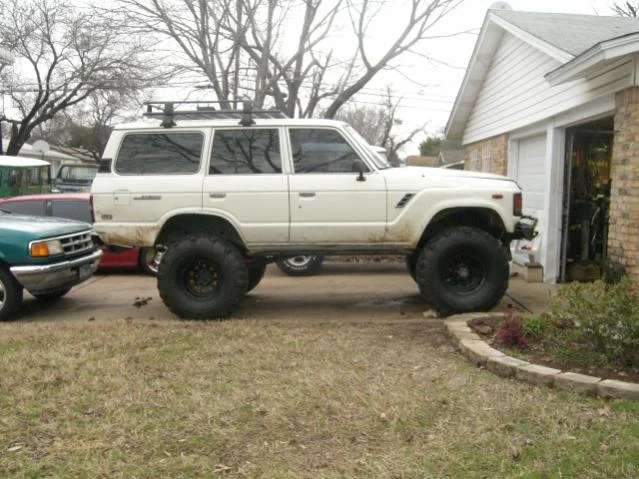

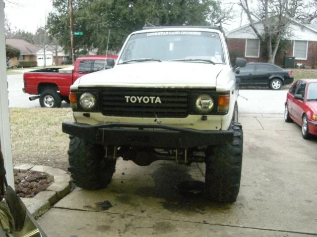

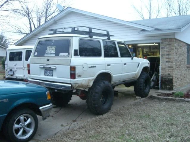

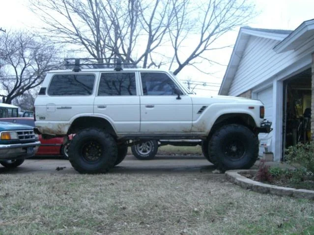

I picked up some 38.5's yesterday on craigs list, i think i could have gotten a better deal but to late now. they are in reasonable shape and should be fine for a season of wheeling as they are Bias ply and are going to be more resistant to cuts and coming apart.
anyhow got em off of the wheels they came with and mounted up on my 2.5" BS black wheels and on the truck.

Looks great man. I gotta get some bigger meats for moonshine:bang:
