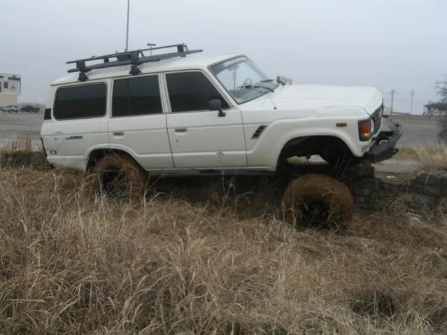

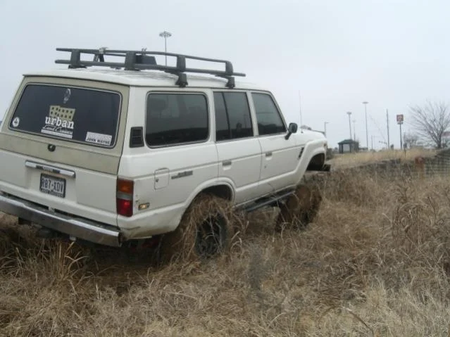

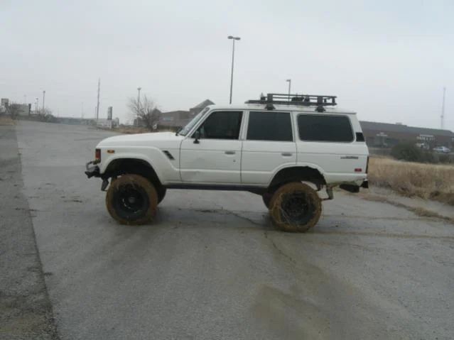

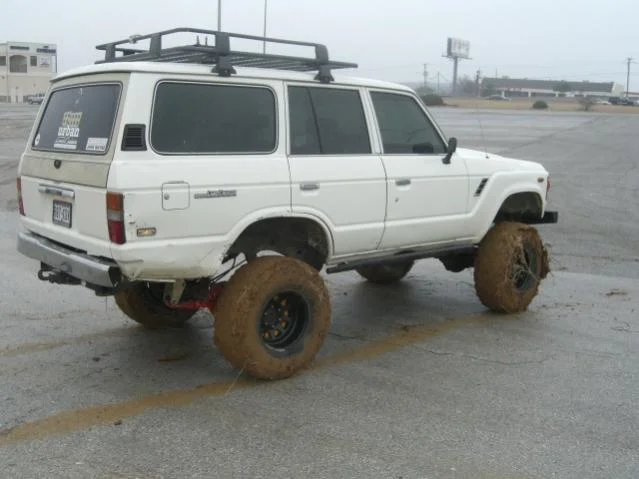

1.) RR starting to invert a little
2.) LR still looks like it has some droop left by shackle angle
3.) it was pretty soft just my weight on standing on the grass i would drop about an inch or so, obviously the truck sank a goot bit more.

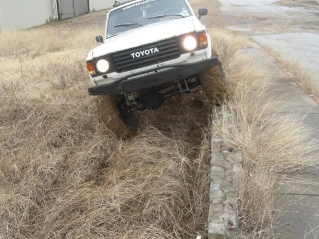

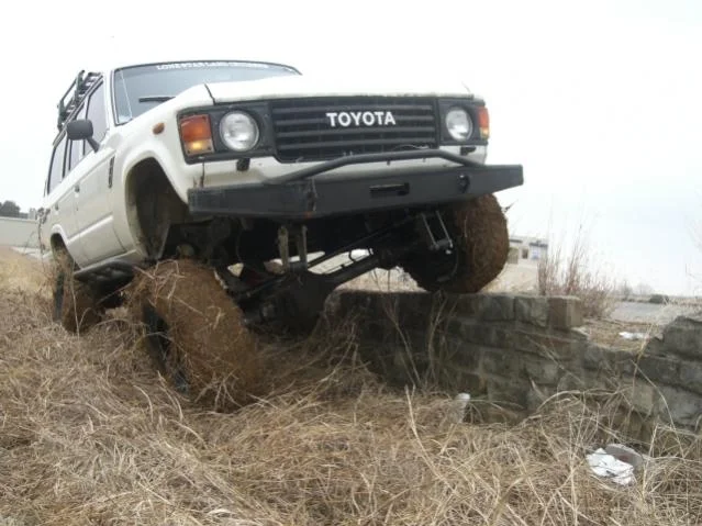

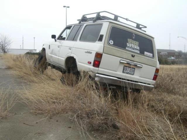

1.) just another angle, you can kinda see the depth of sinkage.
2.) it wasnt bad but i figured i could still do better...
3.) so i pulled forward some more and the wall got taller and i stuffed the LF another 2 inches or so.

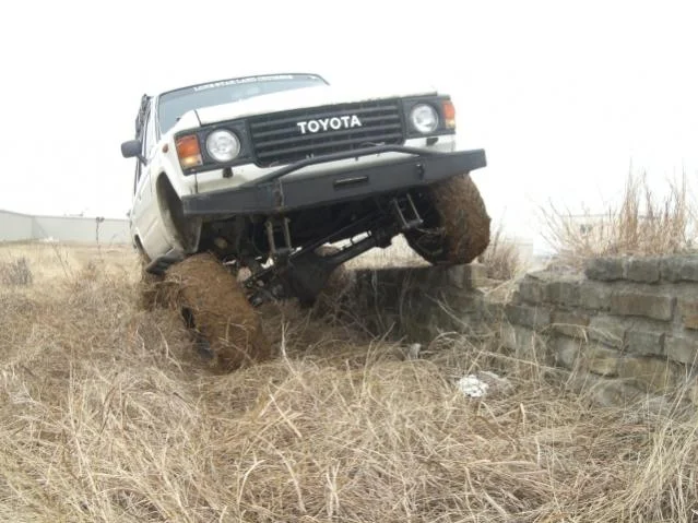

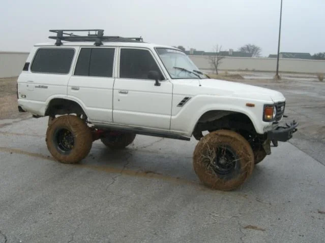

1.) starting to look like some real flex now!
2.) not a whole lot left judging shackle angles... but still some...
3.) she is still sitting pretty level, which is a really nice change for the amount of lift.

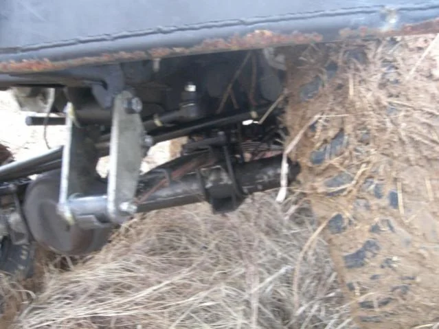

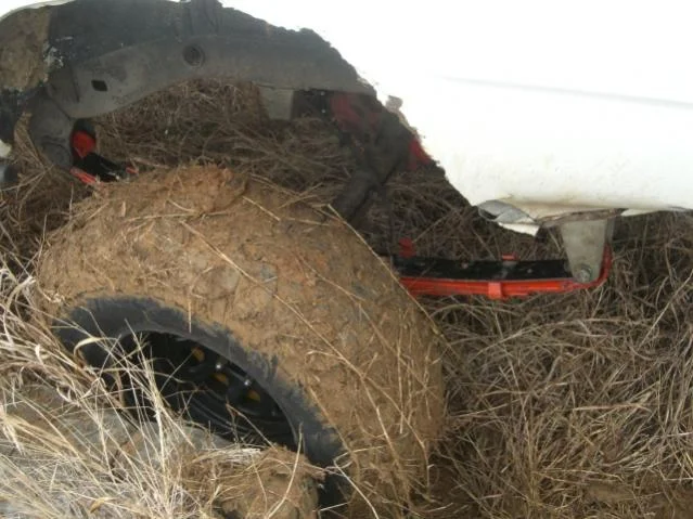

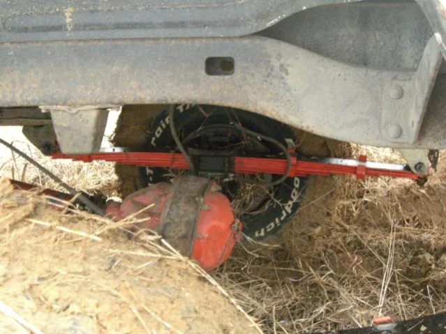

1.) as you can see really quite level
2.) :D
3.) Id say the spring is inverted pretty good, that is a bone stock un modified FJ62 spring

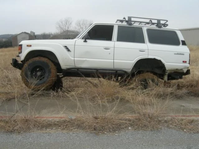

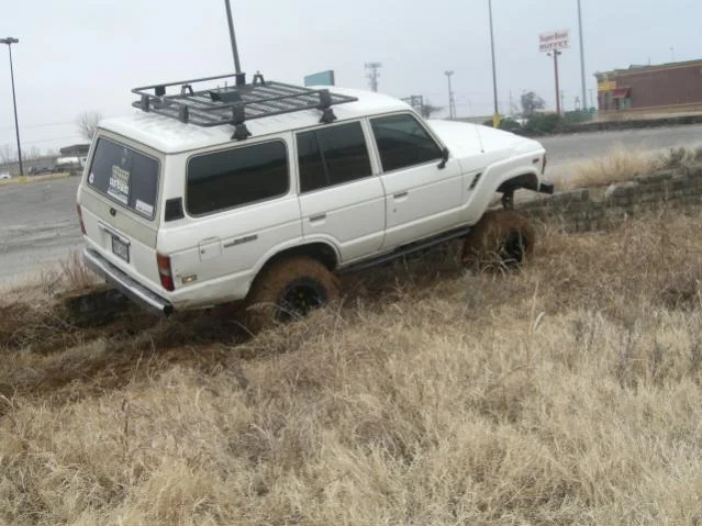

I still really felt like she still had more flex in her tho as it wasnt leaning to bad and still felt reasonably stable.

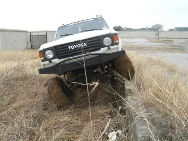

1.) so i pulled forward some more, doesnt look like i gained any more stuff up front but maybe a little more droop in the rear.
2.) absolutely beautiful.
3.) :grinpimp::grinpimp:
dont let the pictures fool you that LF is every bit of 33" off of the ground with all 3 others still on the ground after taking in account of the inch or so of tire sinkage due to the mud.
and if you look at the first picture remember that is a 33" tire inside of that wheel well and i plan on runnin 37-40's. I feel like that much travel with tires that large will take me pretty much any place i aim her at.

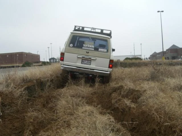

1.) RF is lower than the retaining wall the LF is on top of
2.) it was muddier than i thought. lol if you look real close you can see i banged the lower portion of the pumpkin as i decided to try and just back up a little and climb the wall to get out, it left a decent dent in it :doh: but no ring gear interference. I cant believe i havent banged it up worse than that by now. need to do some diff protection either way before i hit any rocks
3.) I think this height is gonna work for me pretty well given the flex it has and also my target tire size.

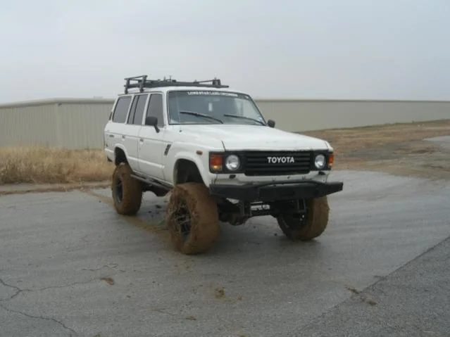

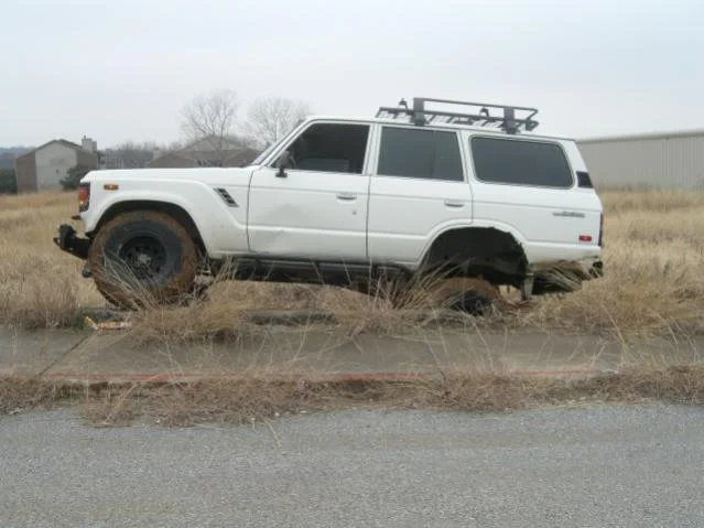

1.) the butt
2.) other side. you can kinda see some blue smoke as she idles... gotta love the 5 banger.:lol:
3.) i think she looks good even tho the tires are to small

over all im pretty pleased, she drives as well as can be expected with no shocks and no steering stabilizer. i think if it had the stabilizer it would be decent other than being bouncy, but the 2 combined make for something i would not want to drive at freeway speeds on a bumpy road, not to mention my rear shaft is still bent so at about 50 or so i get a good little vibration but it is manageable.
after shocks, ram assist / steering stabilizer, and fixing rear shaft i think it will do just fine on the street. I think caster is in a decent place but with the other issues still hard to judge tho.
