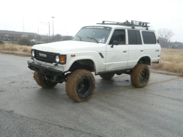

you know now that i got it out of the driveway and got a couple of pics of it they really dont look horrible (also note it is no longer on lift springs) im pretty sure i can make the 35's rub by looking at how close the 33's are to the fender but i still want 37+:grinpimp:
attachment.php
this pic makes me think mine with the 33 will look ok

WOW Trent....she looks like a different truck from i first had her. You have taken that from completely stock to completely badass....nice job.

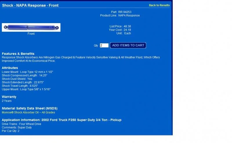

so basically you are running the fronts in the rear and the rears in the front. (pictures below) also the front (or your rears) are only 8" travel, i take it that is why you have them angled?
do you have the ford shock tower part number?

Thanks Jason, Its been alot of work getting her here to this point but im glad i did it.
i found an ok pic of the rear shocks... ]
yup and nope

i actually have a single f250 rear shock i had saved as a take off it measures right at like 28" but it will give me a good idea on placement of the others. I pulled this off a couple years ago to do this exact thing.
Thanks Joel.
I am liking the looks (more the price) of those shocks you posted up. I need to get the ford shock towers, too. I'm glad you pulled ahead of me in the springover race. Now I can let you do all the figuring for me and I'll just go buy the parts. :hillbilly:
