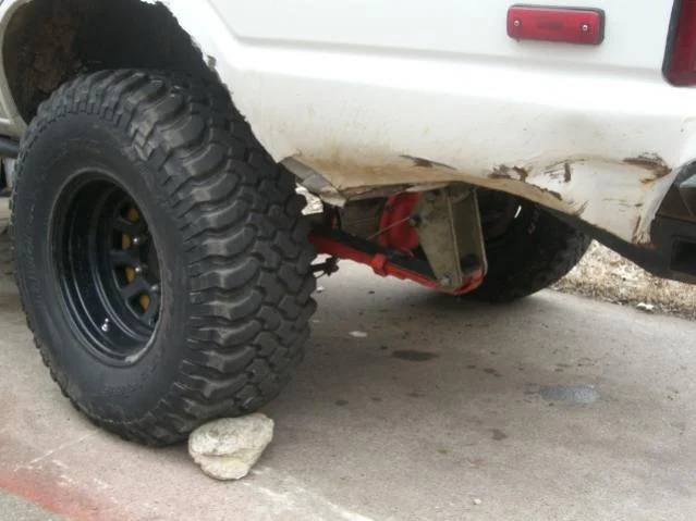

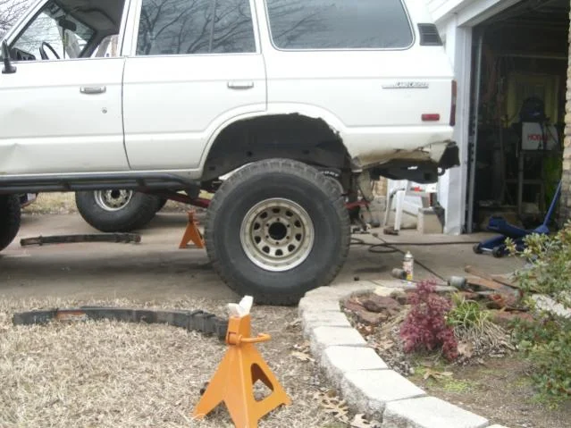

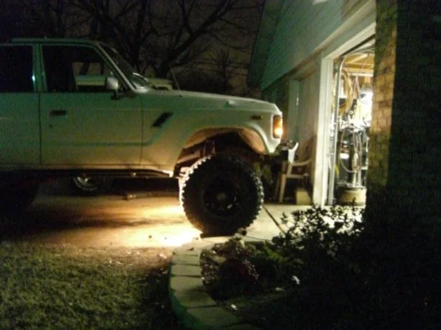

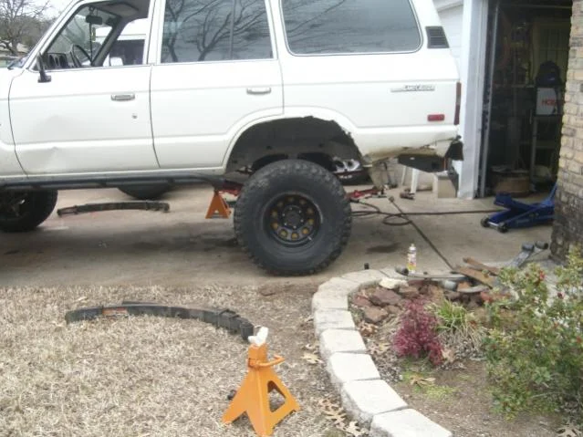

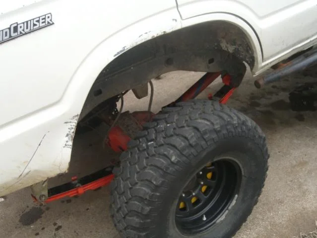

1.) got the bling rear springs on the rig
2.) current ride height on 33's
3.) and with the 35's for comparison

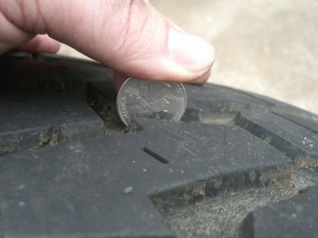

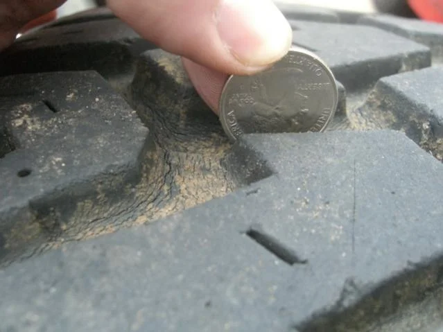

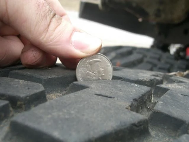

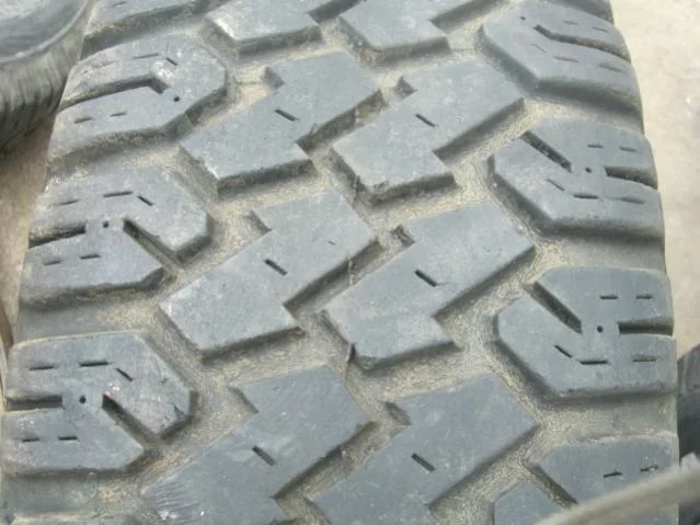

1.) one of the 35's
2.) what all the 33's look like
3.) I did wheel the 33's at mason at about 8 psi, they did pretty well, no major chunks missing this is prolly the worst.

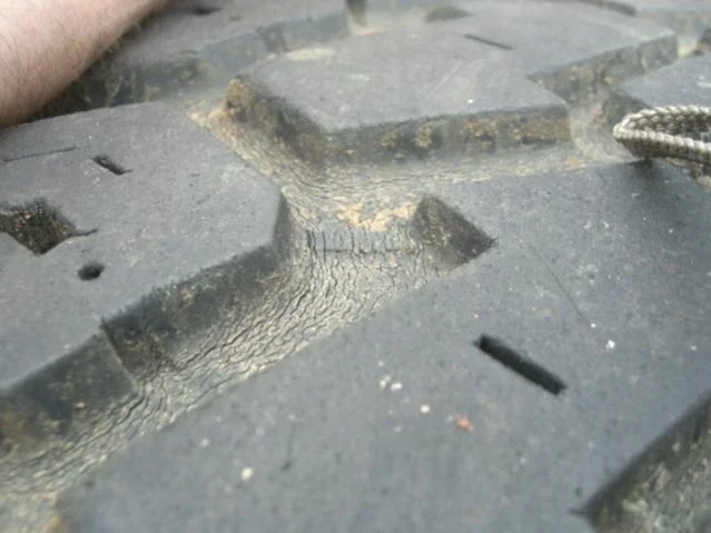

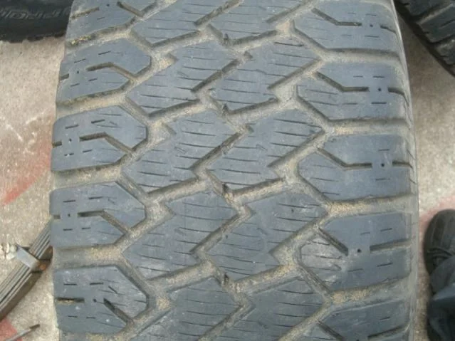

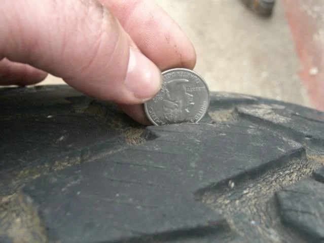

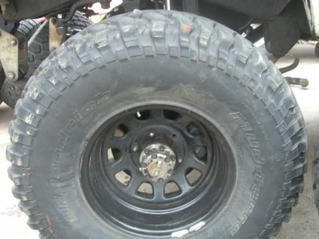

1.) what the 33's look like.
2.) the worst condition 35 (it was a spare but a side wall puncture put it into duty)
3.) this shoulder has a little more wear than the rest of the tire, it is still above the wear bars tho, wear bar pictured (tho i know you know tires being where you work and all)

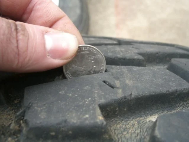

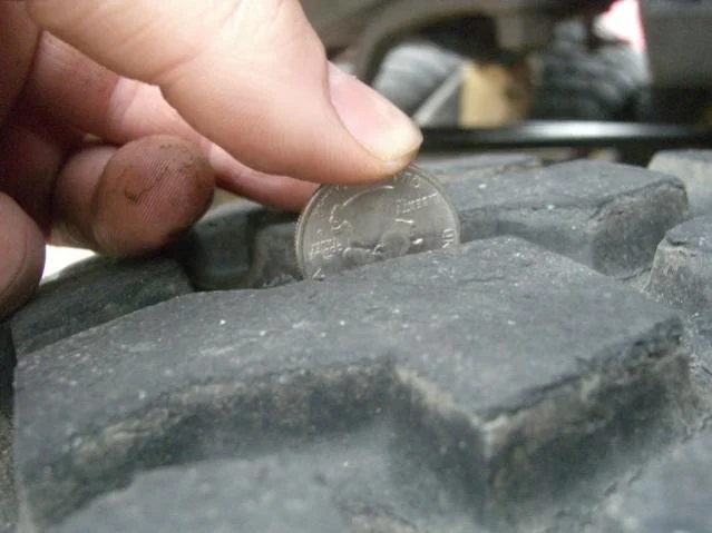

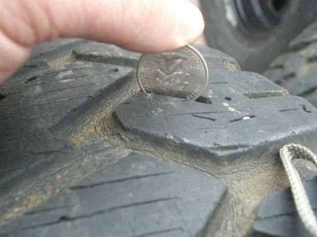

1.) other side as you can see more rubber
2.) another of the 35's (i have a tread depth gauge around here if you wanna see the numbers, 3 of the 35's are about 7-8/32nds i think and the 33's are closer to 11-12/32nds both are 12.50 wide and 15" wheel)
3.) you can see the wear bar here (we all know the wear bars are 2/32nds above being a slick)

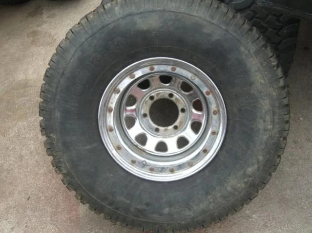

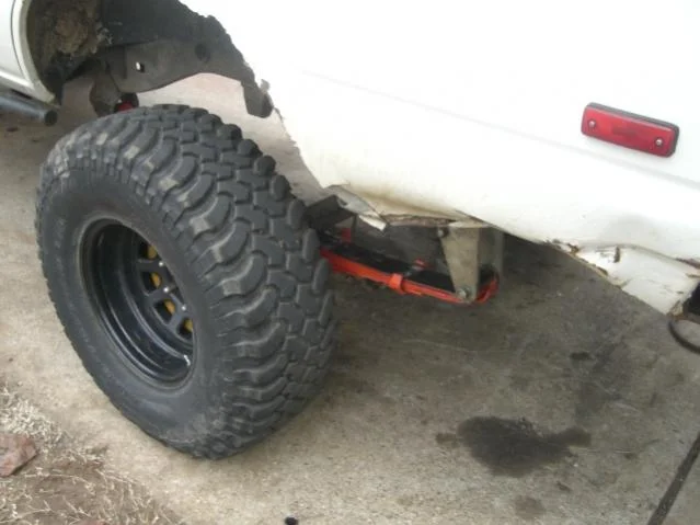

1.) street lock wheels with 35's mounted
2.) nother 35
3.) last one

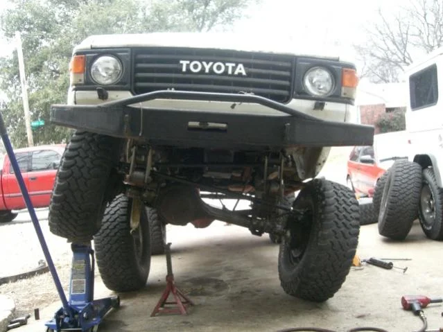

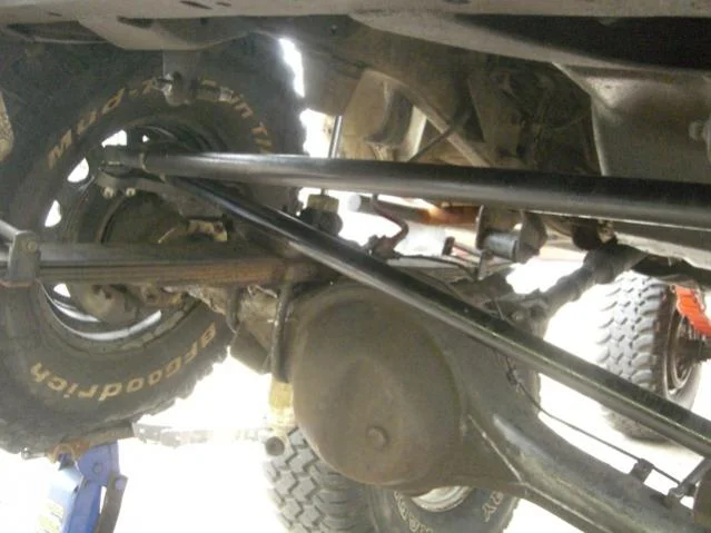

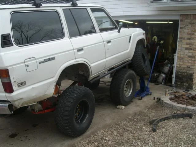

1.) 35" thread pattern
2.) the one siped one
3.) me being stupid and dangerous wanting to get an idea of flex
the jack was maxed out here but still had more to go (these were with modified stocks out back and OME up front still)

1.) do NOT do this it is stupid
2.) pretty
3.) still has more.

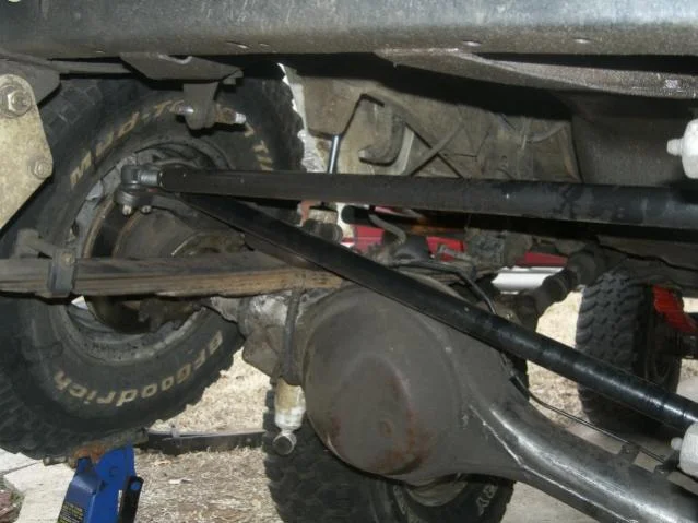

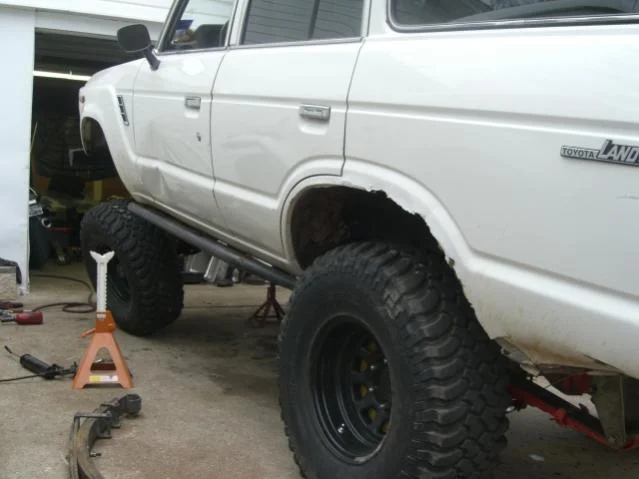

1.) lots of droop left
2.) meh
3.) it will be better with stockers again.

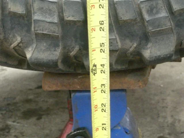

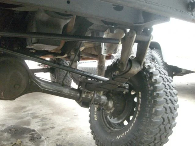

1.) stupid OME springs
2.) with flash
3.) lift of jack maxed out. SUA i could get 1 tire up 30 inches (maybe a tad more) with other 3 still on flat ground...

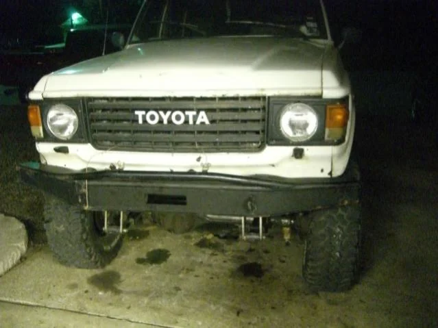

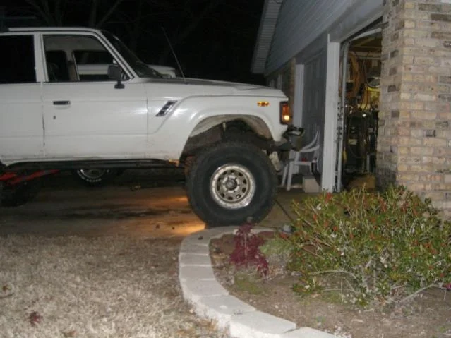

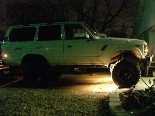

1.) 35
2.) 33

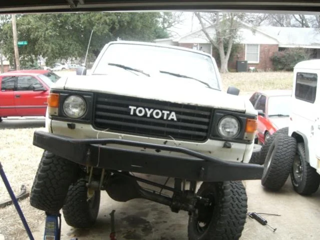

3.) new ride height front springs are bone stock un modified FJ62 springs
1.) 33...
2.) 35...
3.) front height

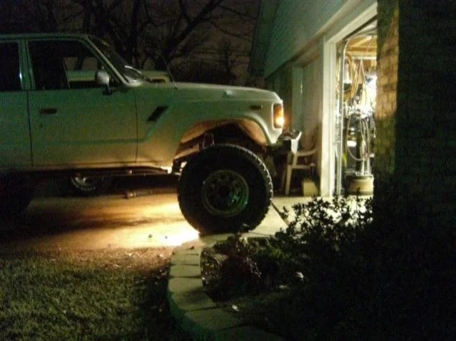

and thats all for today, overall id does sit lower and im much happier with the height it rides at now, i will still be moving spring perches around to better my shackle angle and move rear axle back, but for the time being i think it will work pretty well.:beer:
now i need to get some shocks on there, and get the gear box off so i can drill and tap for ram assist and get ram mounted. then it will pretty much be wheelable again for a bit.
front ride height is right around 28.5" at bottom of frame to ground and rear is like right at 30" so swapping springs did bring it down a good bit so not a waste of time IMO.
