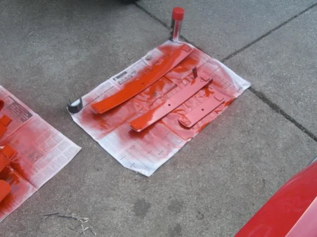

well went to a friends today and picked up what i thought was gonna be a set of stock 85 FJ60 springs, come to find out both front and rear spring packs have had leafs removed 3 leafs from the rear and 2 or 3 from the front... i was slightly disappointed to say the least, none the less i took em home and made the best of it.
i had a complete set of FJ62 springs and i was wanting the long spring from the FJ60 to add as an add a leaf but so it would not add as much lift or as much spring rate and they would be plenty flexy still. well on the rear 62 springs i had taken 2 out to add to my 40 since apparently some genius P.O. had taken leafs from the rear pack of the 40...
anyhow so after i robbed the 60 packs to make a complete packs out back i then took the 2nd longest leaf from the 60 (one with military wrap) cut off the wraps and used it for the added leaf. come to find i was still missing the second to the shortest leaf but i figure being it so short it wont make a big difference.
ok well took the packs apart and decided to clean em up and paint em then after cleaned and all painted i will grease em and re assemble.
on the paint i decided to continue on with the running theme of painted things...
I did however leave the spot where the part numbers are at un touched since i thought it cool the numbers were so easily visible still, also it will add a little difference to the springs from the painted to the un painted.

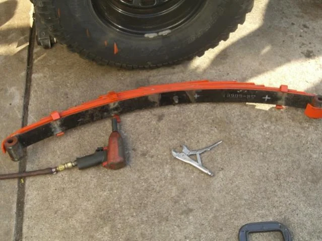

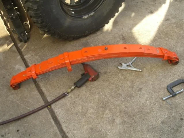

ok well painted the other side of the springs then finished cleaning another pack and got 1 side of them painted as well.
1.) one of the rear packs assembled and greased up
2.) the side i left un painted cause you can see the part numbers (stupid i know :flipoff2: yall)

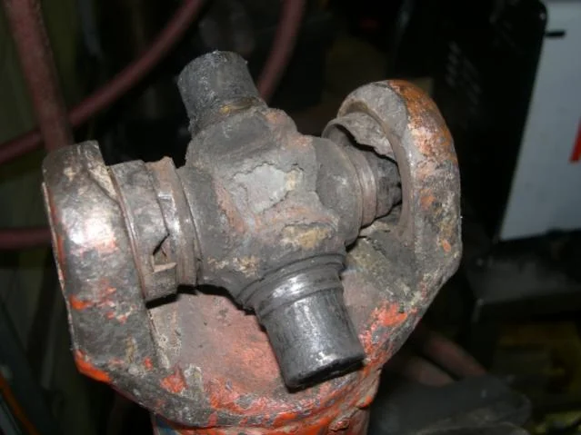

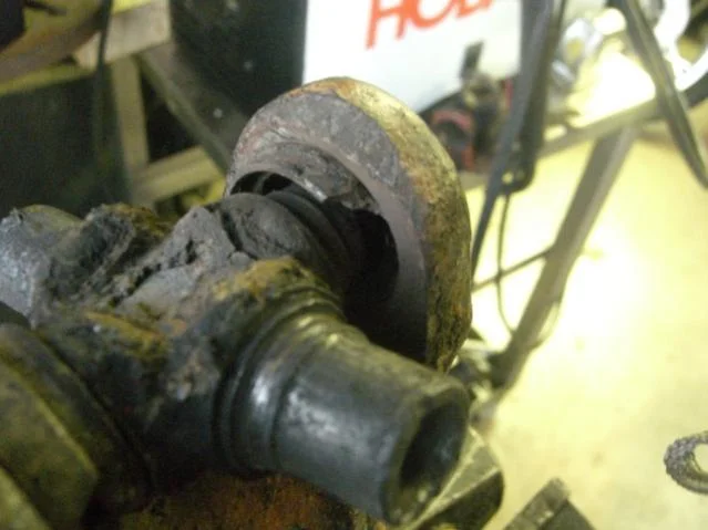

3.) then decided to replace the u joint in the rear drive shaft.

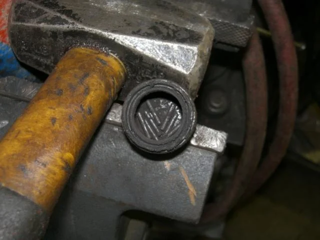

it was pretty bad, only 1 cup had any thing that resembled some sort of lube, then obviously part of the cup and joint were gone.
I did get the new joint in and drive line bolted up but i damaged one of the caps in the process... it has a lifetime warranty so i figure in a year or so ill replace it and not half ass it (yoke was bent and instead of lining it up properly i forced the joint in and cracked cap on opposing side.:meh:) that said if this wasnt my truck i would not have let that slide and would have made 100% sure all parts were in correctly with no issues and would have straightened the yoke back out.
