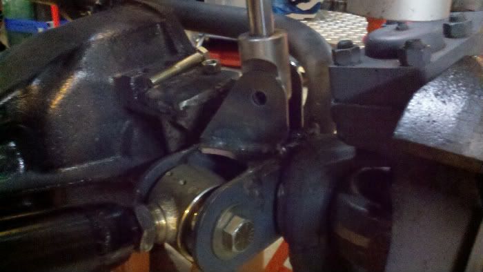

re-did my shock mounts:

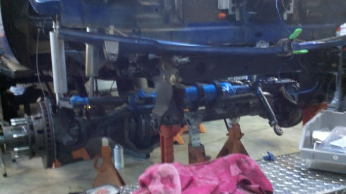

got the axle back under the cruiser:

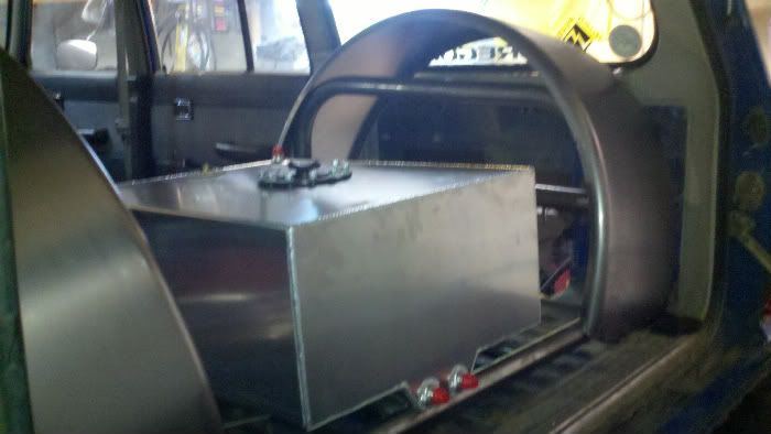

got a fuel cell and some trailer fenders from six states cheap. I'll do some cutting and fitting to make them work:

I too like the trailer fender idea for the wells. That powerjection unit is futuristic in a 1950's kind of way. I like it. Let's shoot for a work party on May 7th or the 21st. Maybe Clint will be on the road by then and we can show up and smoke you out of the house :D.

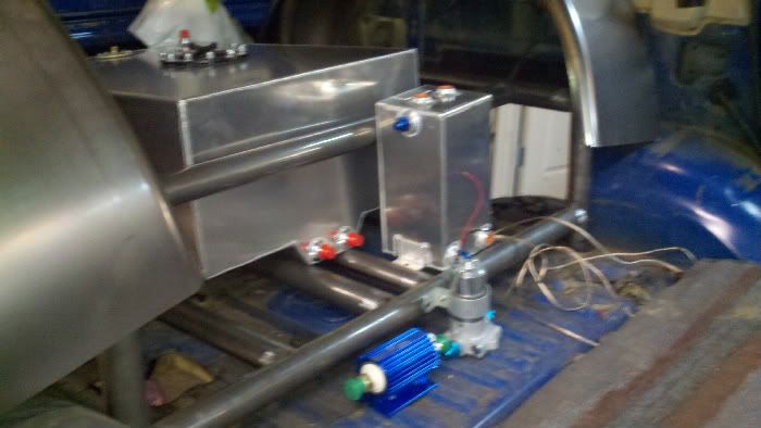

got my surge tank and "lift pump". The idea of that is that the lift pump fills the smaller tank constantly and recirculates the extra fuel back to the bigger fuel cell. That way the small tank will never starve the efi system of fuel in off camber situations. This is a pretty popular method used in rally cars and drifters.
Where you gonna mount those? I remember Mace talking about noisy fuel pumps so maybe under the rear would be better than in the rear.
