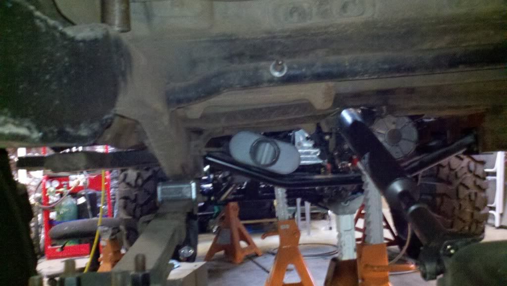

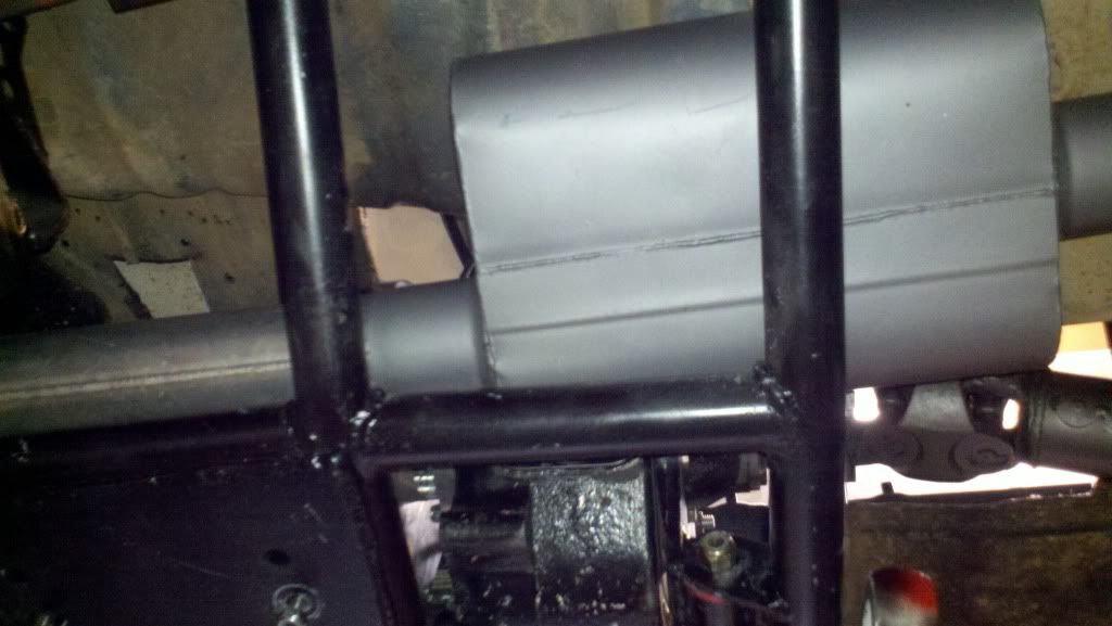

The muffler showed up today... Looks EXACTLY like a flowmaster. It was like it was meant to fit it up in the cross member. The extension tube needs to be shortened and I need to add some hangers but this is the general idea.... Just need to cut a turn down.

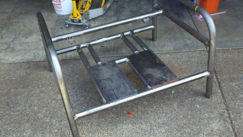

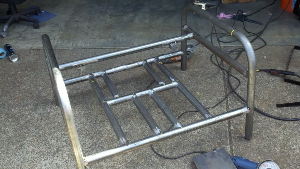

Some more to add:

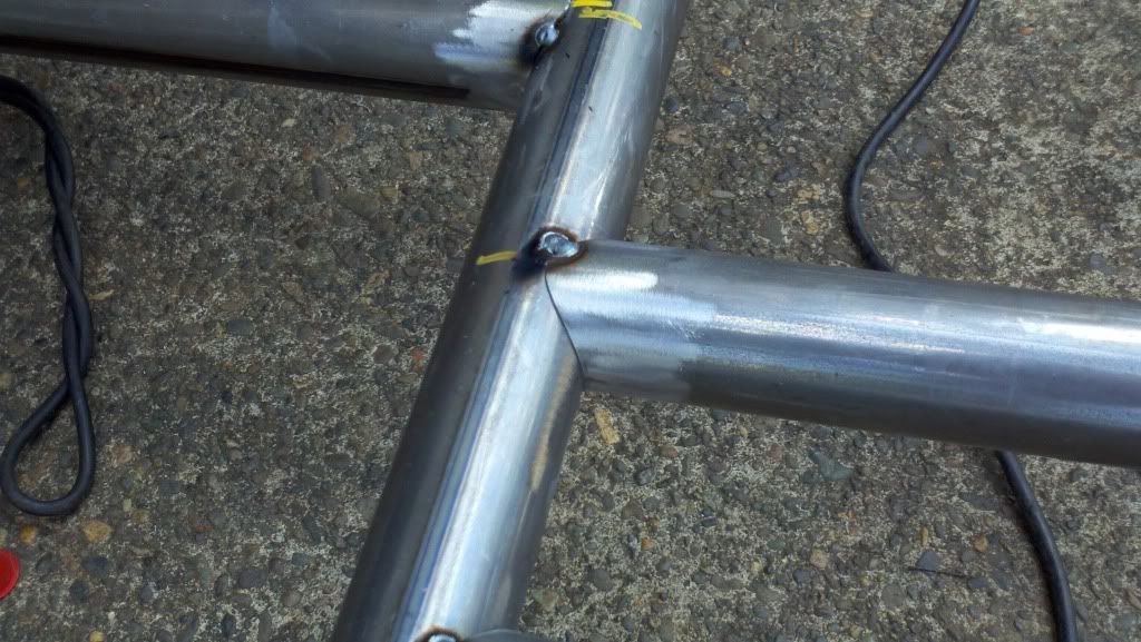

I love my notcher and I discovered sanding wheels Vs grinding disks for a nice fit.
Since I switched back to gas I had to redo the shock mount/fuel cell/small children's monkey bars thing-a-ma-bob

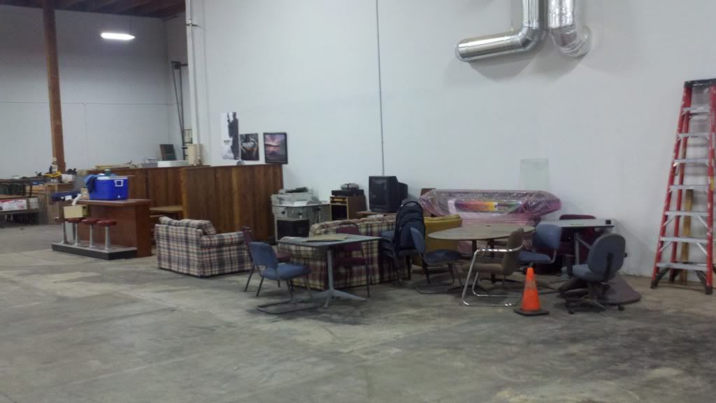

The best news though is that I talked my boss into letting me use some of his warehouse space to move my build and toolsover there. Even though I am getting close to getting this thing to driveable I still have a long way to go before it'll see the trail. Moving my junk 35 mins away seems like it might be less convenient but in the long run I'll get more done there. This is my new work area after I get rid of the junk furniture that has just been accumulating there from our work office:
When are you planning the move? One big hit or a couple of things a day when going to work? Why is this better?
I am going to move my stuff this week and weekend for the most part.
Its better for a lot of reasons.... obviously the first part of it is simply space. The picture only shows where I plan to store my crusier, bender, press, hoist, etc... what doesnt show is the other 20,000 sq. feet that I can use for projects. I also dont have to fight the ceiling in the warehouse. It'll also make my wife happy as she'll get to park in the garage again. Honestly, I'm just as tired as she is of fighting all my junk in the garage to get in and out of it. Heck we might even be able to get two cars in there!
The other reason is actual work time on the cruiser. You've been at my place when the kids and wife are home.... they are constantly on top of me. I love them dearly but being interrupted all the time makes very slow progress (obviously). The other problem is that the garage is directly below the all the kids bedrooms so I cant bang around or grind after they go to bed. I figure I can at least get to work a few hours early and work on the cruiser in the moring before work or stick around for a bit after work too... heck probably could even get some wrenching done during lunch. On the weekends I can just cruise out here and start working instead of spending 30mins unpacking my garage into the driveway to get anything serious done.
I know it sounds like its less convenient but honestly it will make for more wrenching time in the long run. Right now I'm lucky to get in an hour a week and half of that time is spent trying to figure out where I left off from the week before. It'll also be nice because when we decide to do another work party. We'll all be able to get the rigs in there and have enough space to work on stuff without being on top of each other.
Did I mention I'll have access to a forklift too? :)

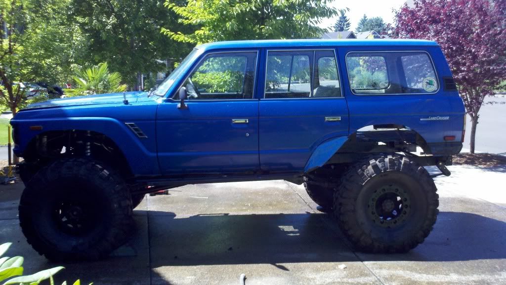

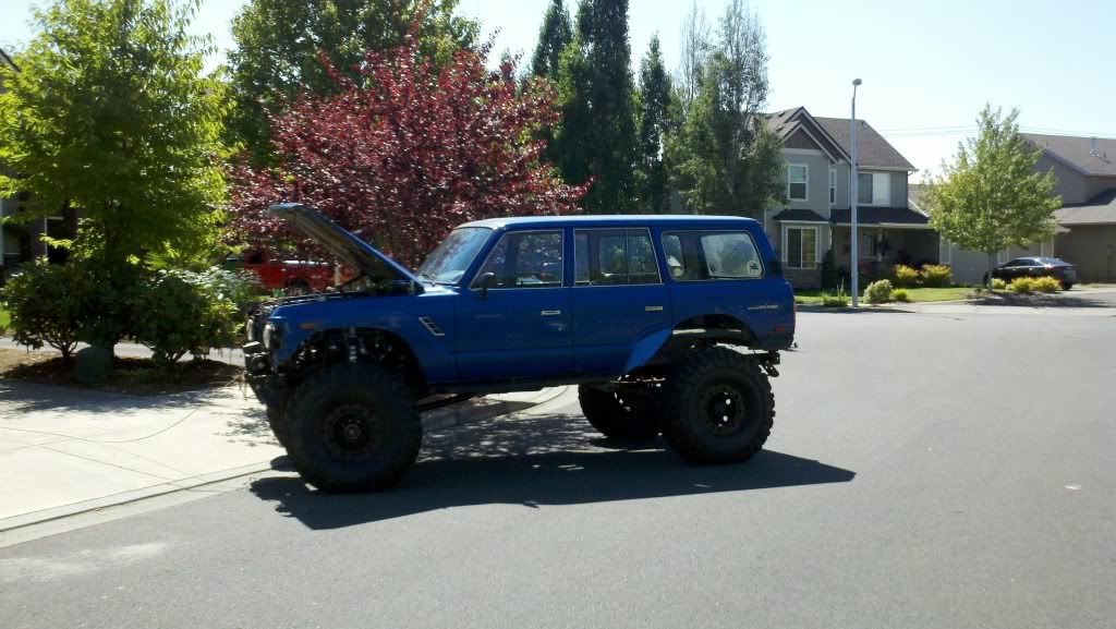

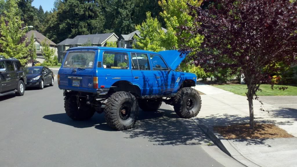

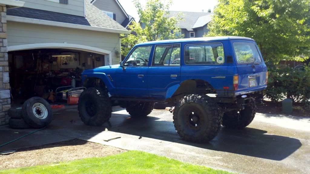

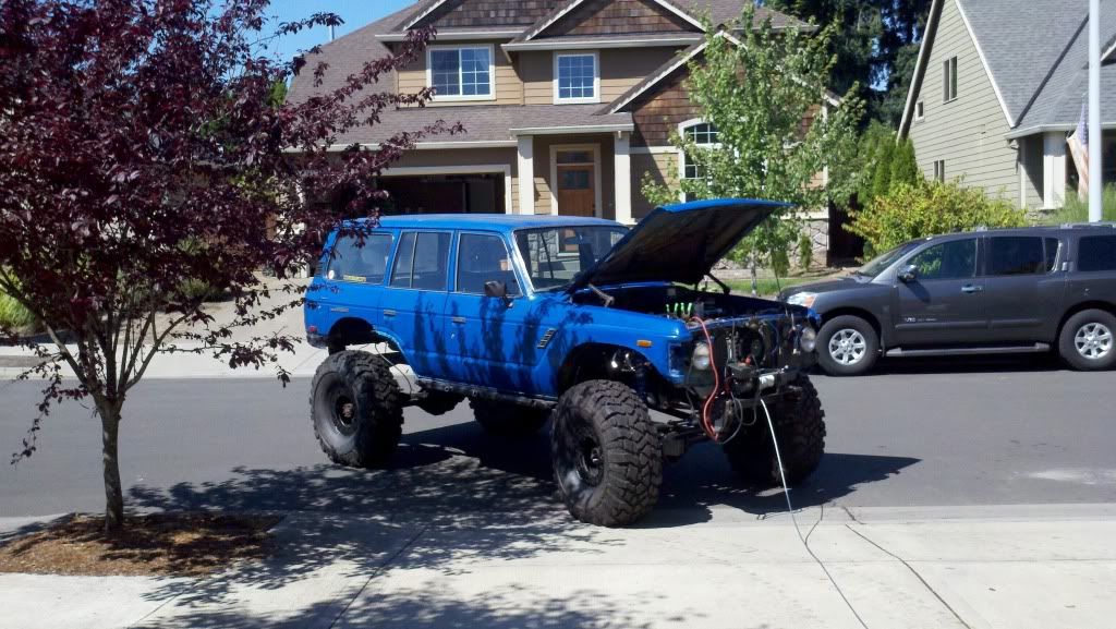

so after nearly 3 years of being stuck in the garage the swagger wagon finally got to sunbath for a few hours and even got a wash...

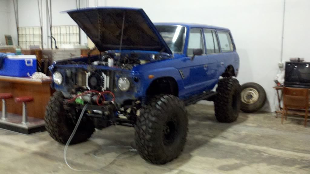

and she's in her in new home.
I have some more stuff to move over the new work space and have to move some stuff around but this is going to work out very well.
Nice to see it out of the garage. Been one of my favorite 60s ever since our trucks crossed paths at W's. :beer:
That's sick. Having it out in the sun really shows how different of a truck she's gonna be.
It has been said but it is great to see it out side.
Looking forward to see what you do with the sheet metal around the rear wheels.
