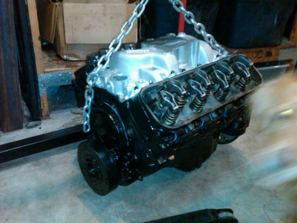

Picked up my motor from the machine shop. Here is the work that was done and the final specs:
454 previously bored to a 460
Estimated Compression ratio 9.5-9.8
x4 262h Cam (new lifters, springs,timing chain, etc)
milled 049 Heads with 2.19/1.88 stainless steel valves, pocket ported bowls
Edelbrock Performer 2.0 intake-port matching and milled for correct head geometry
TRW 30 over forged pistons
Comp Cams Magnum roller tip rockers (1.72)
New Rings/hone, bearings, cam bearings, oil pump
crank polished
Zero decked block
ARP bolts for Assembly
Comp Cams desktop dyno puts it right at 500hp @5000 and 565 ftlbs @ 4000 on gas and 473hp/533 ftlbs on propane.

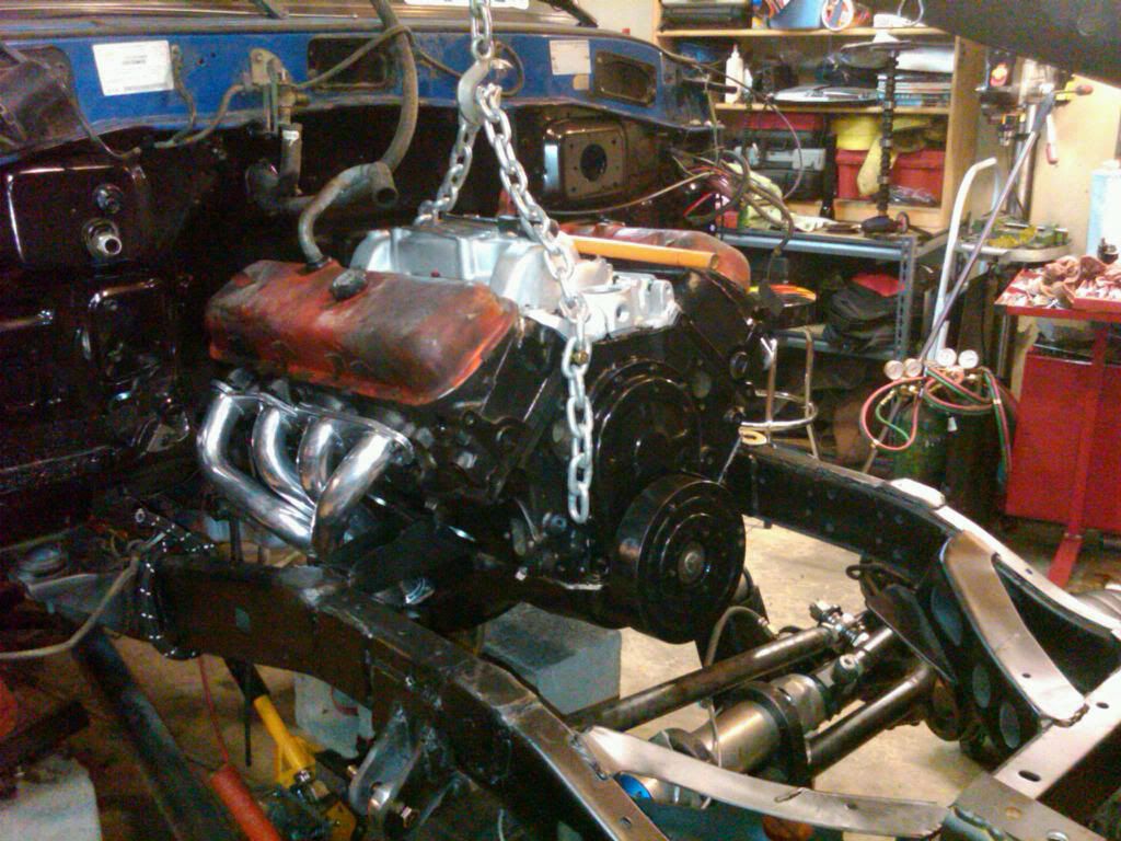

...Big Blocks are heavy for one person to shoe horn into a yota. I'm tired.
I know the feeling. My diesel is about the same weight and I didn't take off the fenders or radiator support which necessitated the use of two people. Great to see the progress! You will be sniffing fumes soon!
What color you gonna paint the valve covers? I say smurf blue or bright orange.
I tried getting the 350 out with the fenders on and it was a pain in the rear.... The fenders came off to help get the big block in and because I really need to re-work the three link now. Having the fenders and tires off really will help with getting the right angles to weld Its actually looking more and more like I'm going to 4 link it now. The panhard really is getting in way.
