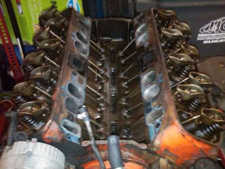

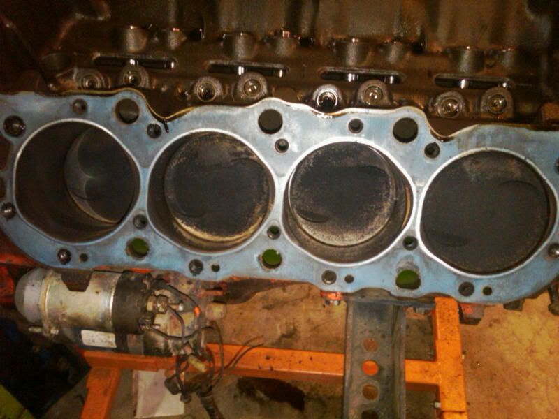

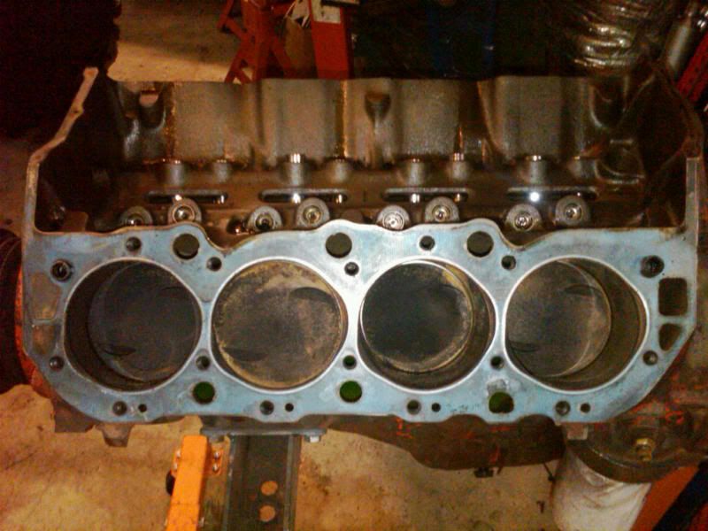

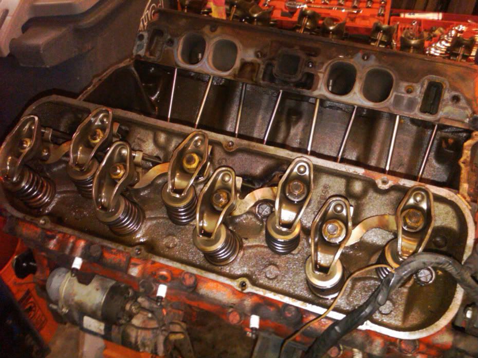

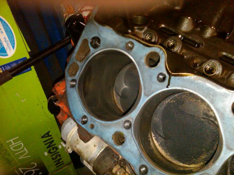

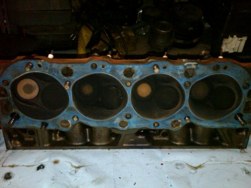

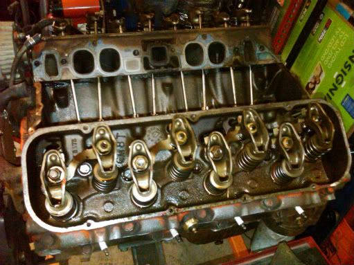

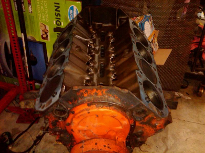

Popped the heads off tonight and took a look. Looks like the everything is in pretty good condition. You can actually see some cross hatch and there is no ridge what so ever. I think I may just take the heads to the machine shop since the bottom end looks pretty damn good so far. The valves are the stock 2.08/1.73. Measured the bore with my crappy HF thing-a-ma-bob which was about 4.3.
one head:
Hey, our pistons look about the same size but you have another row of them.
haha... this motor should be fun. I'm taking the heads to the machine shop tomorrow to have them ground for 2.19/1.88 valves, do some port/blending the bowls, and have a bit shaved to increase the compression a bit. Hopefully he machine shop wont take too long. This rig is really shaping up to be really fun in the sand....
